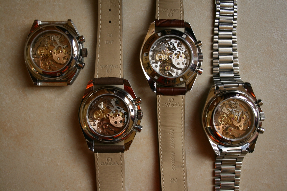

I put the hands up against the pictures in the '2998 alpha hand length' post of sp101 (the Holy bible...or is that MWO? In spacefruit we trust!) and I think that the hands are OK. I'm happy I got the stick hands too, though. Sadly I can't try placing them on the dial because none of the parts are with me right now. I can though supply a picture that proves the OEM sapphire caseback fits straight lug cases:

The original case for the sapphire case back uses a different movement spacer than the standard one so I'm not sure how well the sapphire case back will fit with the 321 movement as the movement spacers are different between 861 (1861) and 321.
Thomas Preik makes sapphire case backs which fit the 321 movement and I've fitted a few of his to my Speedmasters. It obviously doesnt have quite the look of the Omega Sapphire case back but it looks good and shows off the movement nicely.
His method of fitment is simply a thick metal ring which fits between the movement and case back and holds the whole movement in place.

Yes you're right- as far as I know, the spacer used in the 1863 version doesn't work with 321, though I've found at least one source that says the 863 spacer works, which I can't get anyway so it doesn't really matter...
People have made the OEM display back fit before Preik arrived by a similar method to Priek, which is to add a ring that fills in the space between the movement and the back. Some people like Maddox have done it with an O-ring, while I've also seen others make precise-fit spacers for this purpose. I plan to do the latter and this should keep me busy while I wait for a 1450012 caseback to pop up for sale. The Preik spacer apparently also doesn't fit with the OEM one, so I'll need to find some machining person to make the ring for me.

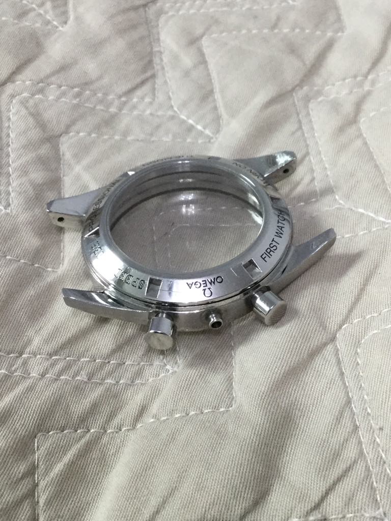

So @padders would a service 145.0012 caseback fit the straight-lug cases with no rattling issue whatsoever?
