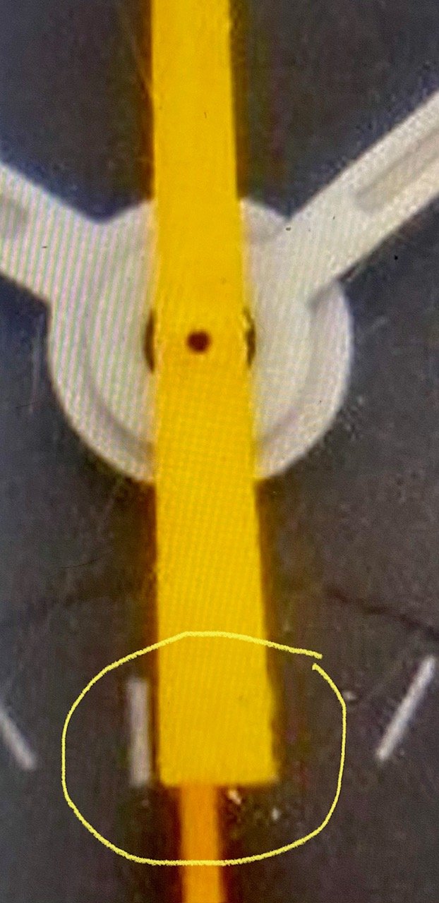

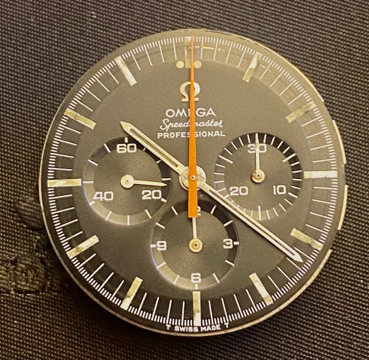

Unfortunately the watch is already in the hand of a qualified watch maker, who is referring to have a problem in taking the hand away, before servicing the movement.
Here a picture of the seized hand:

So what exactly is the watchmaker's problem with removing the hand? Chronograph hands are pressed on tightly, so they don't slip during the forces of the reset, which can be considerable. There are 2 options - pull it off or pry it off. I'm sure your watchmaker knows how to remove a hand, so this is puzzling why he would ask you to post here for help...
If the tube comes away from the hand and stays on the post while the flat portion is removed (which is not uncommon) it can be repaired.

It's either going to come off intact, or the tube will stay on the post when the rivet fails - if the latter happens again it's not a huge thing to repair, in particular for an expert.

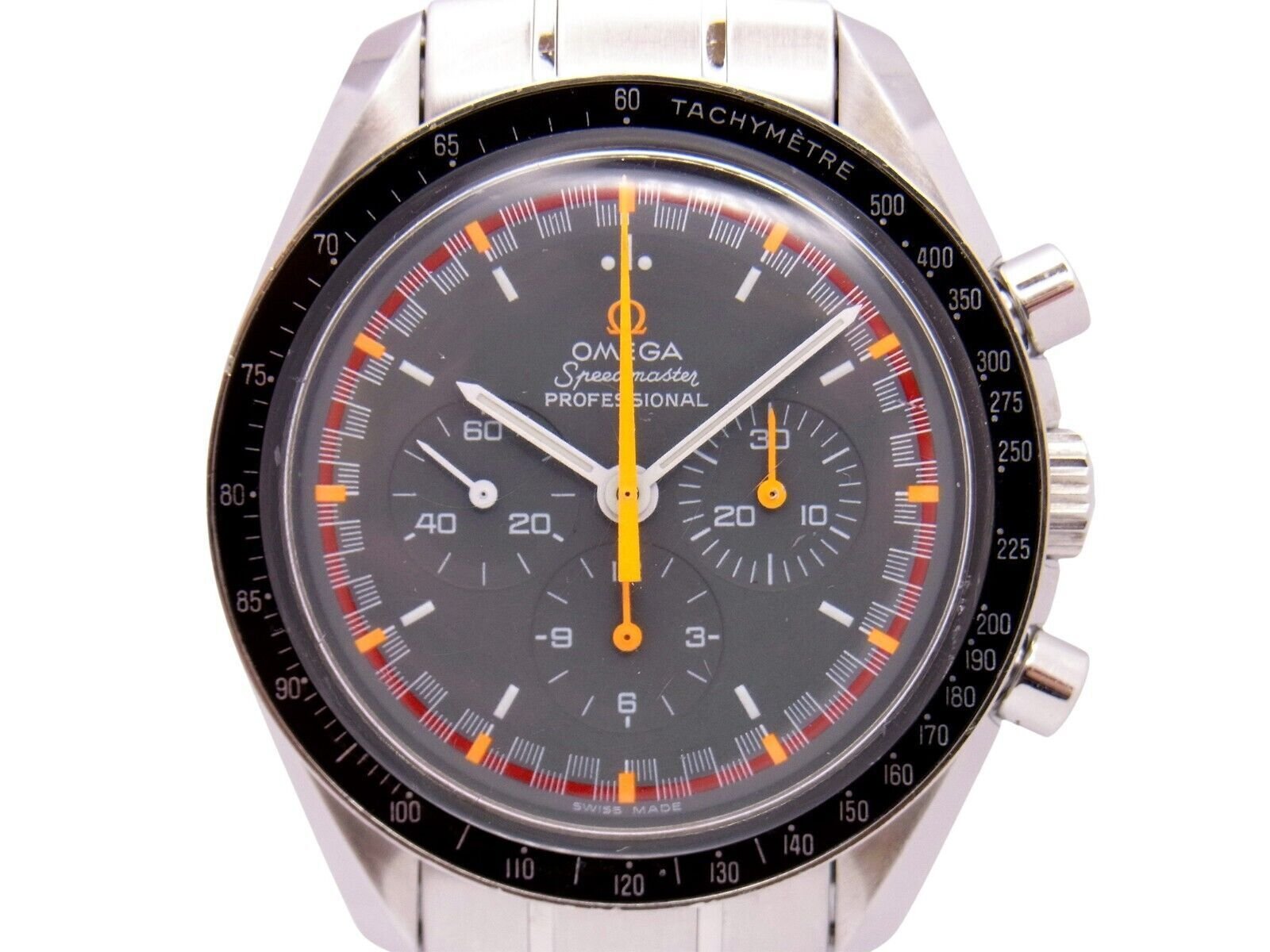

could this be an option, even though that I think that the "Ultra Man" hand is a little bit longer
Ref. 3570.40 from 2006

What is your question? Can you replace an ultraman hand with the Japan racing?
You must realize the difference in monetary value between the two? You can make it fit but it will dramatically reduce any value.

The question was, if during the dismounting of the original hand it will be ruined, I could replace it with a Japan Racing hand,
if this part would be still available?
Cheers
You could, but you shouldn't. Try discussing this with @Spacefruit, who is likely the most familiar with your reference.
