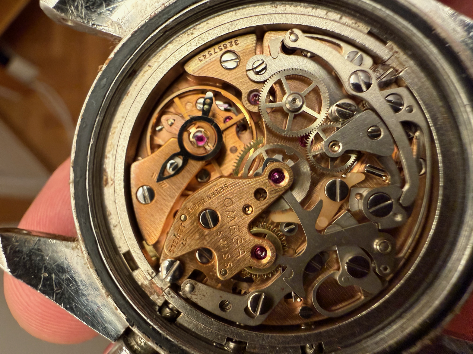

Hello everyone,

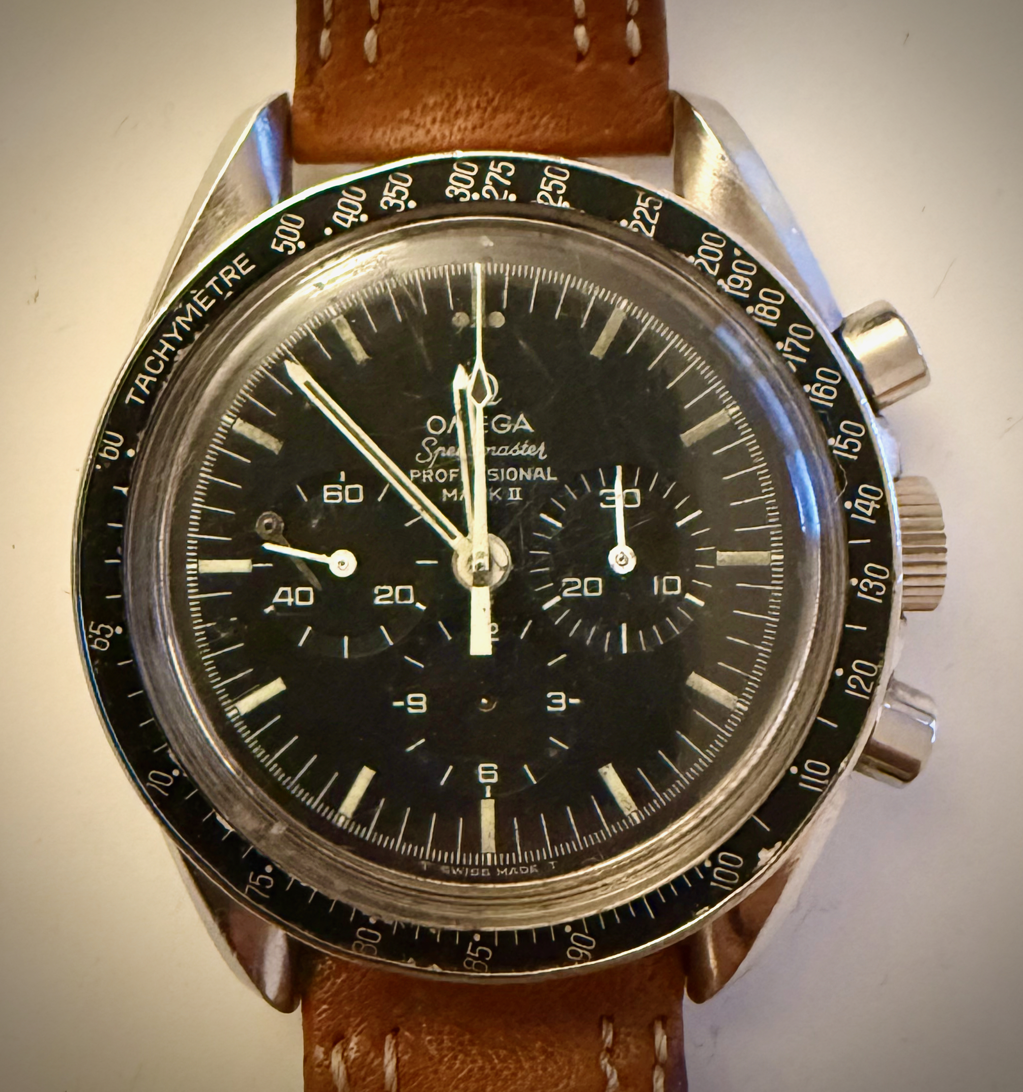

I inherited this Speedmaster from my father and I'm trying to understand its history before considering a restoration.
Any expert input would be greatly appreciated.
KNOWN HISTORY:
  • My father bought it during his military service in Germany, most likely 1968-1969, at the latest very early 1970.
  • He had it serviced at some point (date unknown) but I have no service records.
  • It has been sitting unused for many years.
WHAT I CAN READ ON THE WATCH:

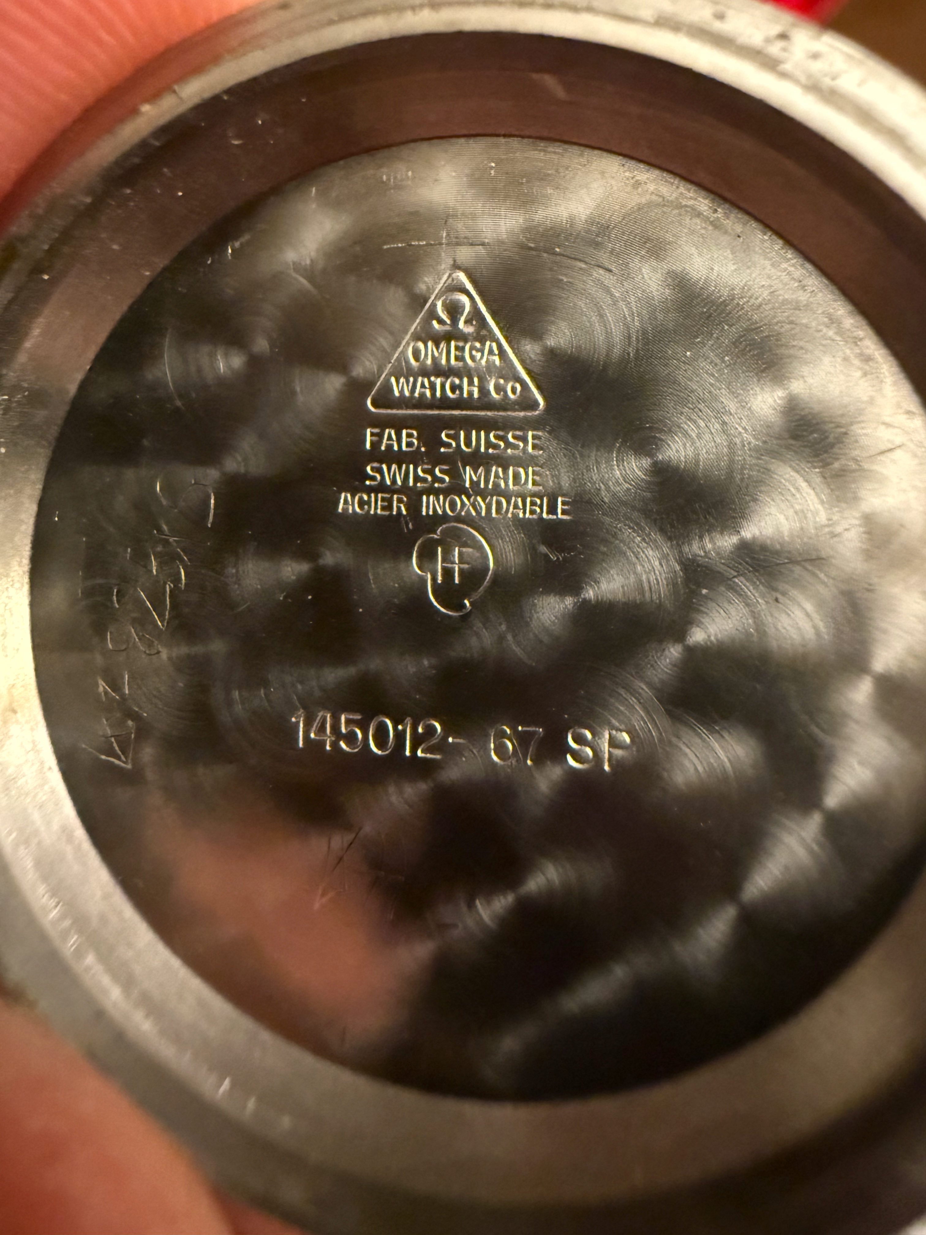

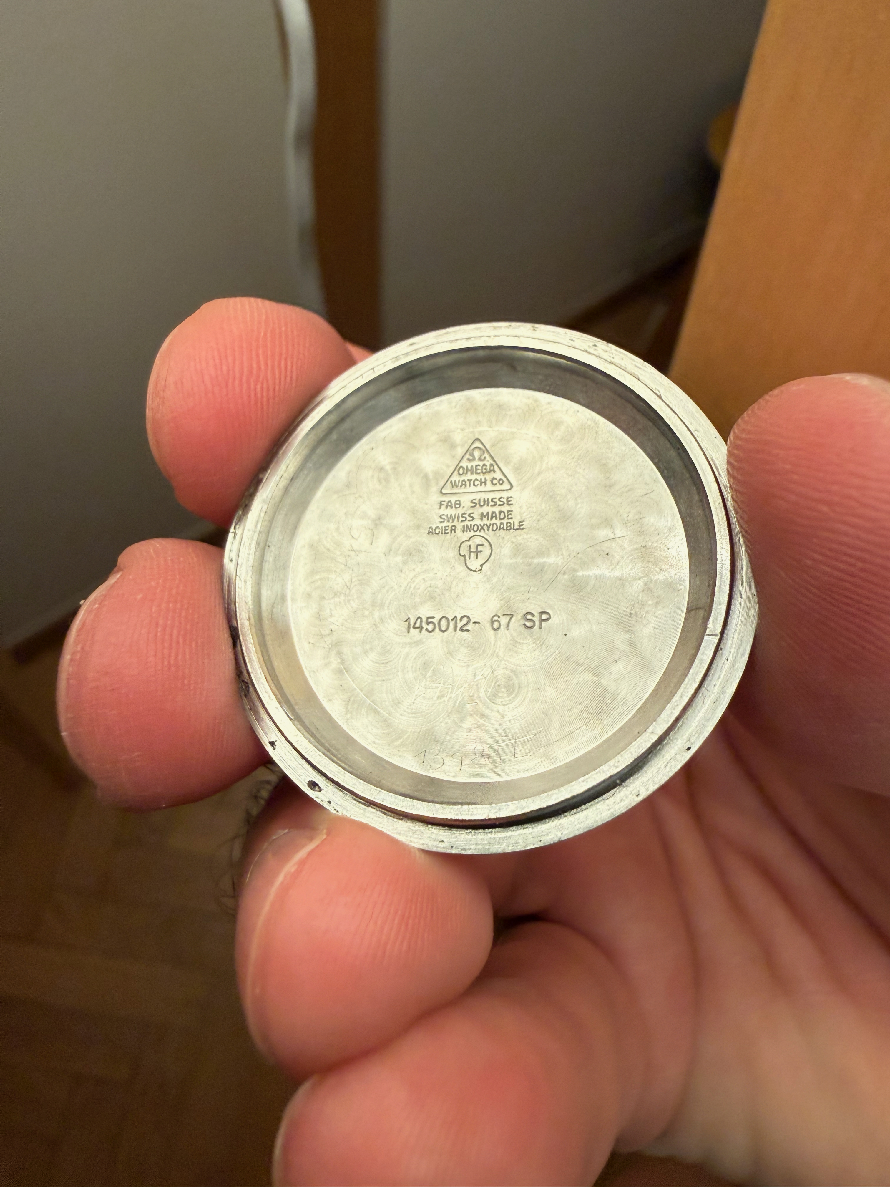

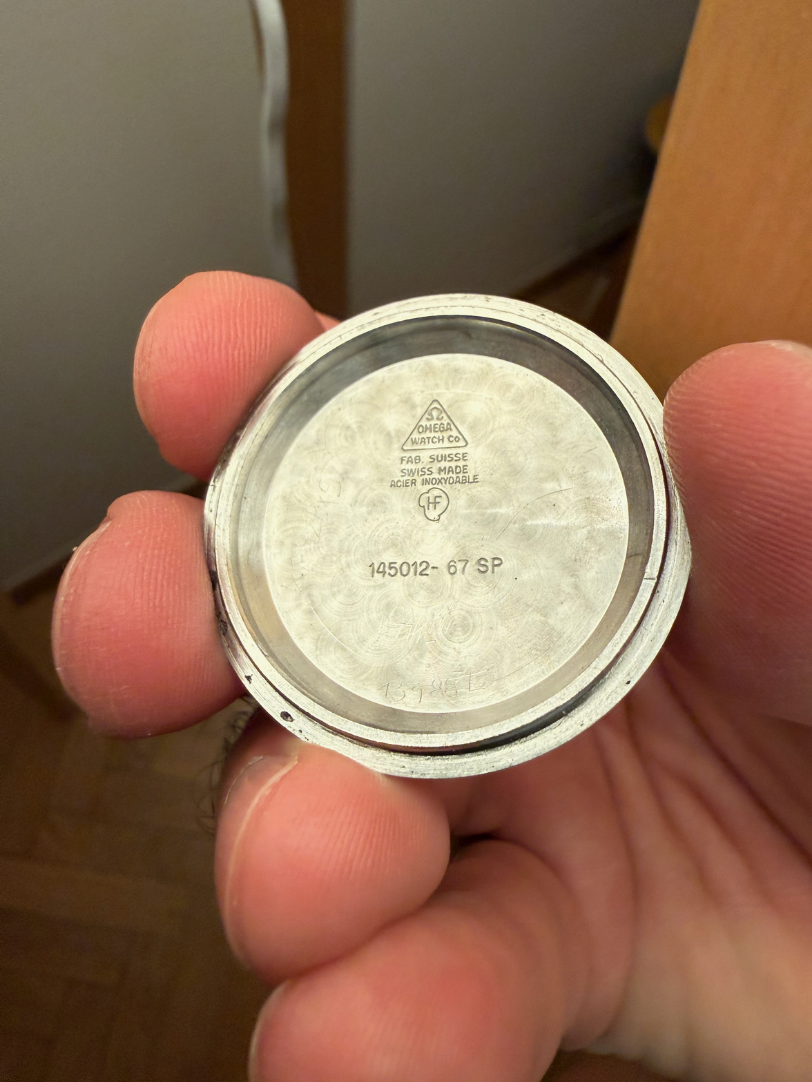

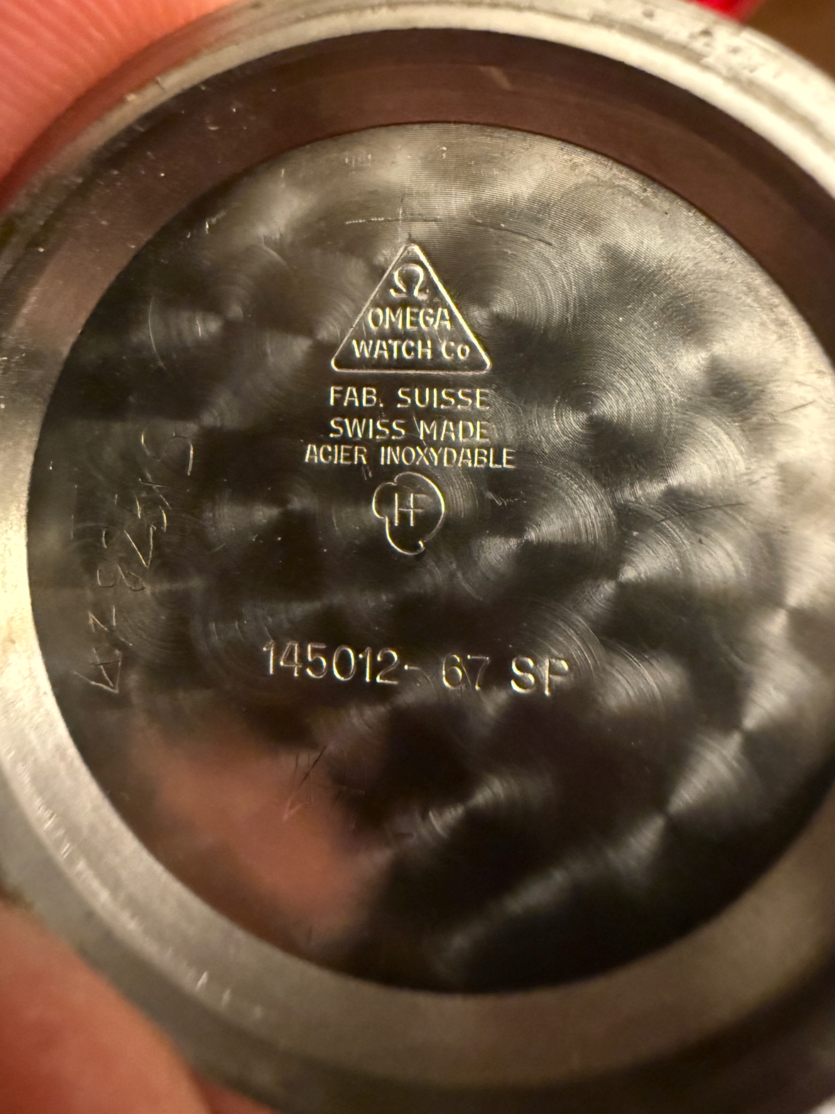

  • Caseback: 145.012-67 SP, HF hallmark

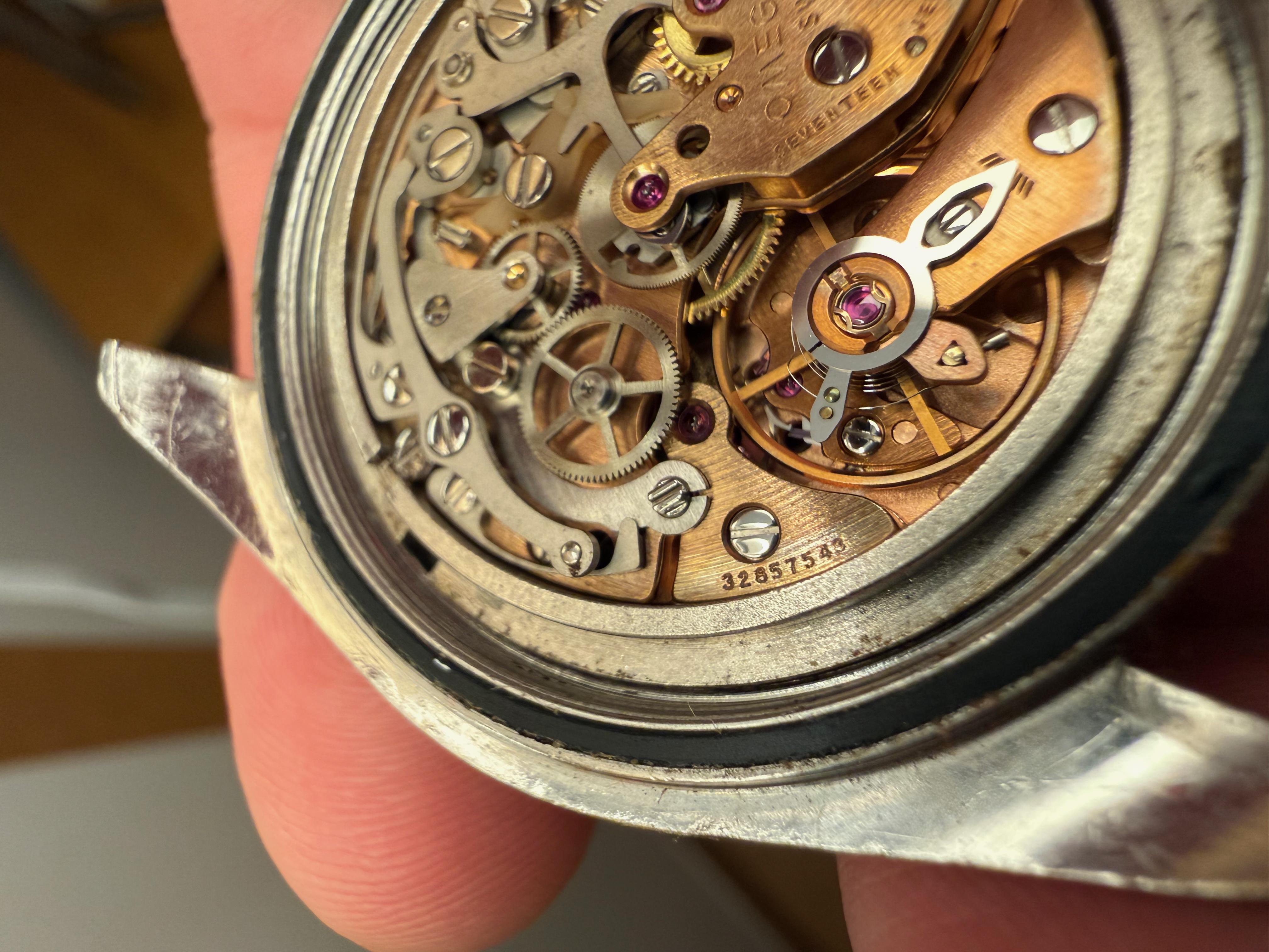

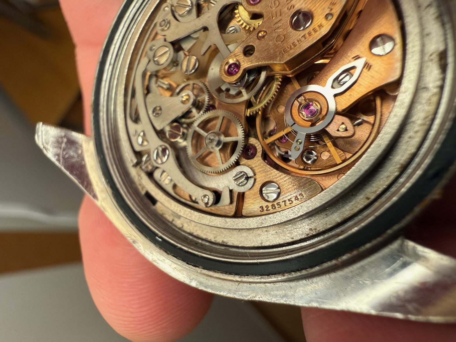

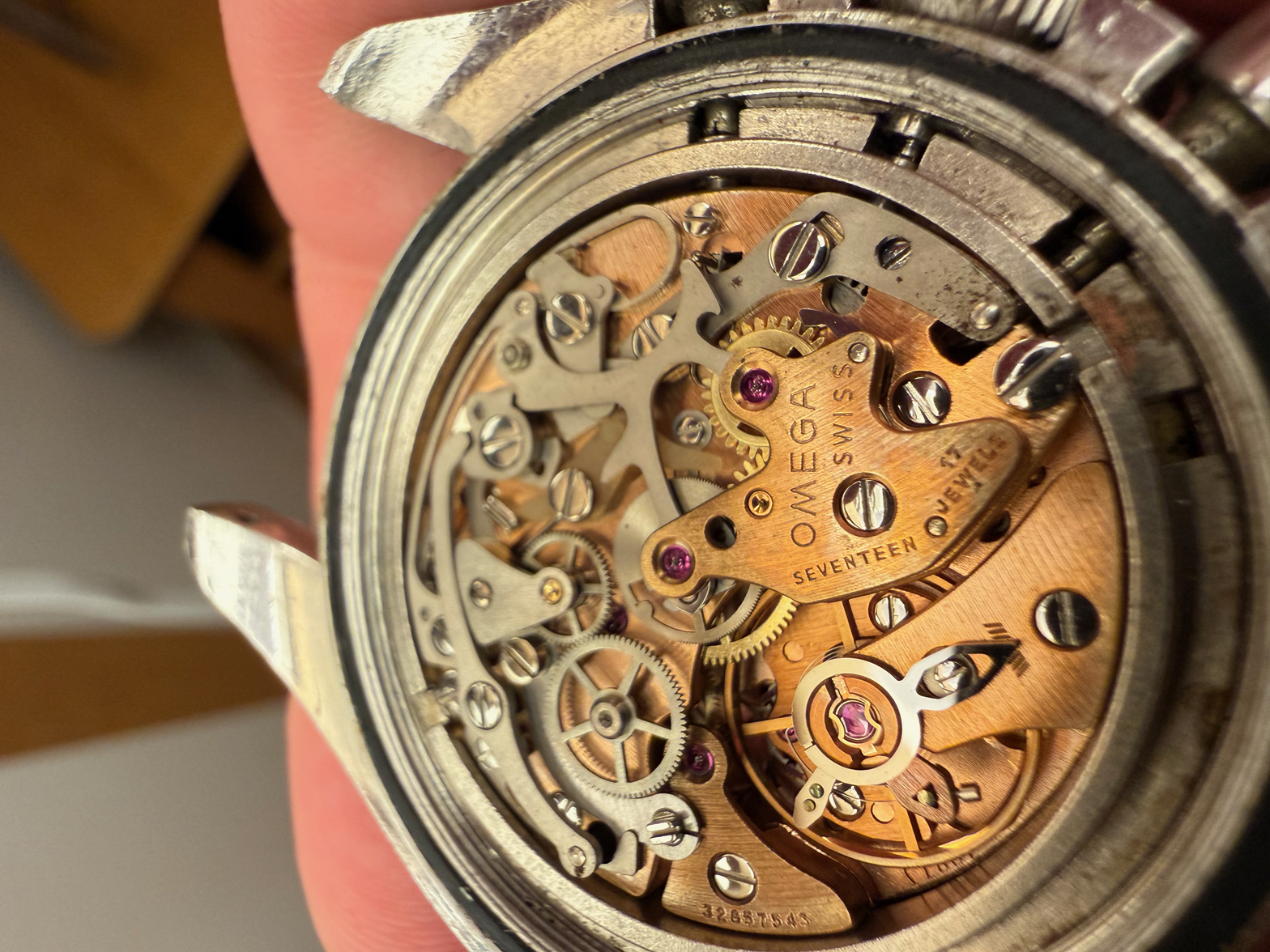

  • Movement: serial 32857543, signed Omega Swiss, 17 jewels

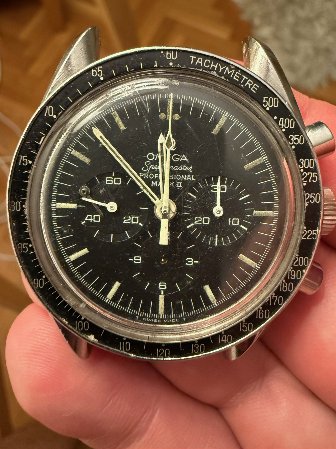

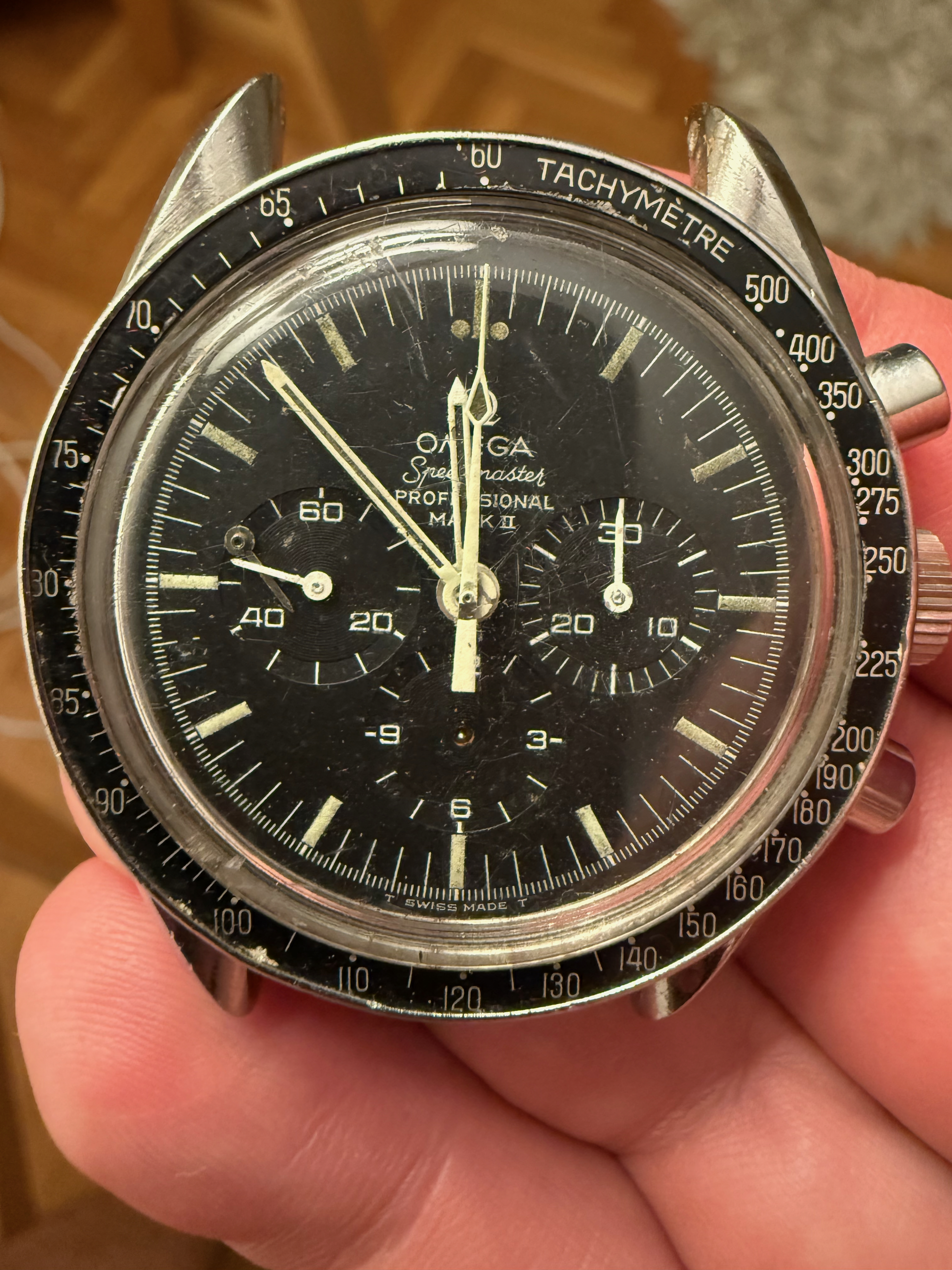

  • Dial: OMEGA / Speedmaster / PROFESSIONAL / MARK II, T SWISS MADE T at the bottom
  • Hands appear to have tritium lume aged to beige/honey
MY UNDERSTANding (please correct me):
  • Case is original 145.012-67 SP, consistent with a 1968 delivery date.

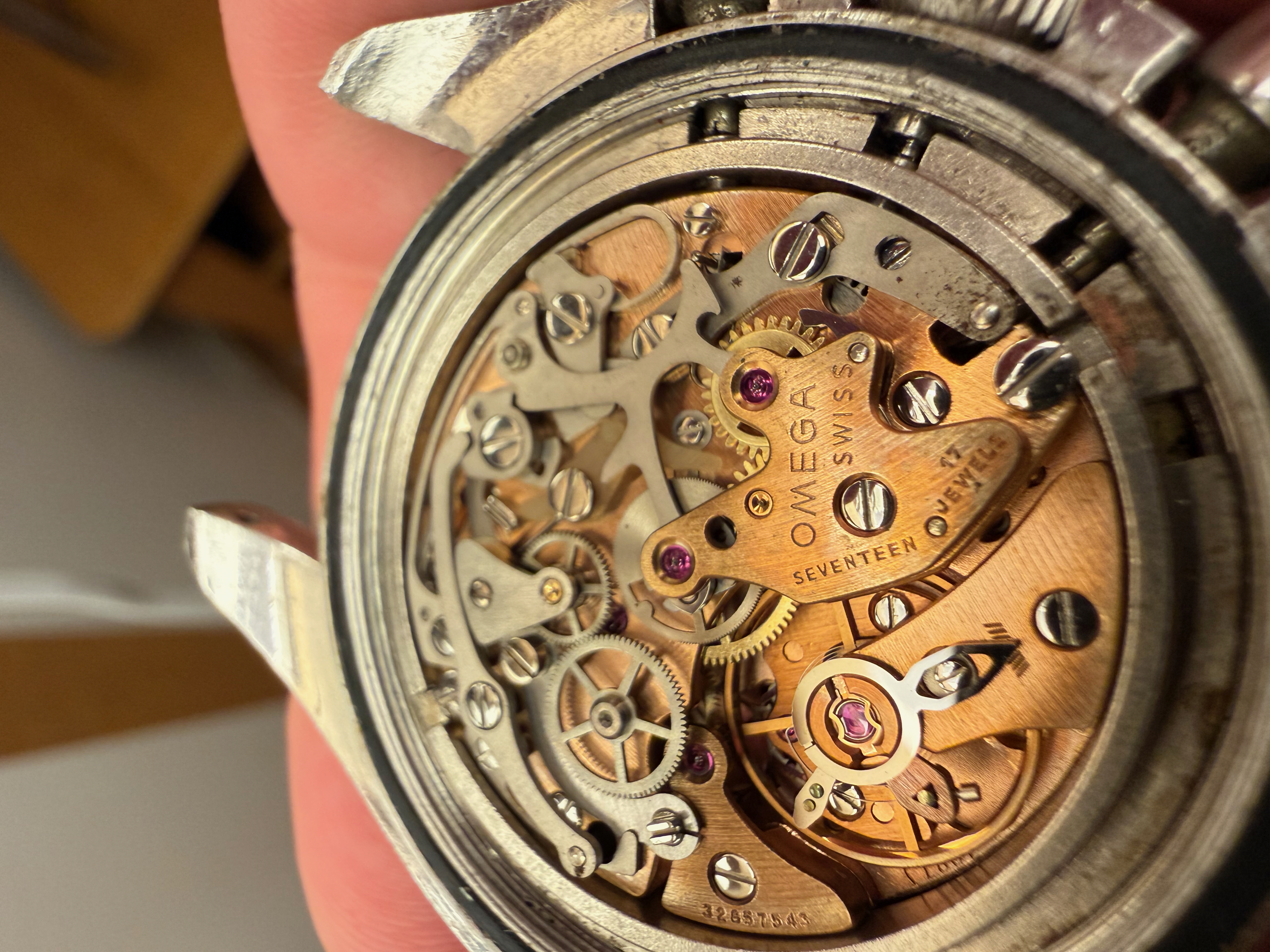

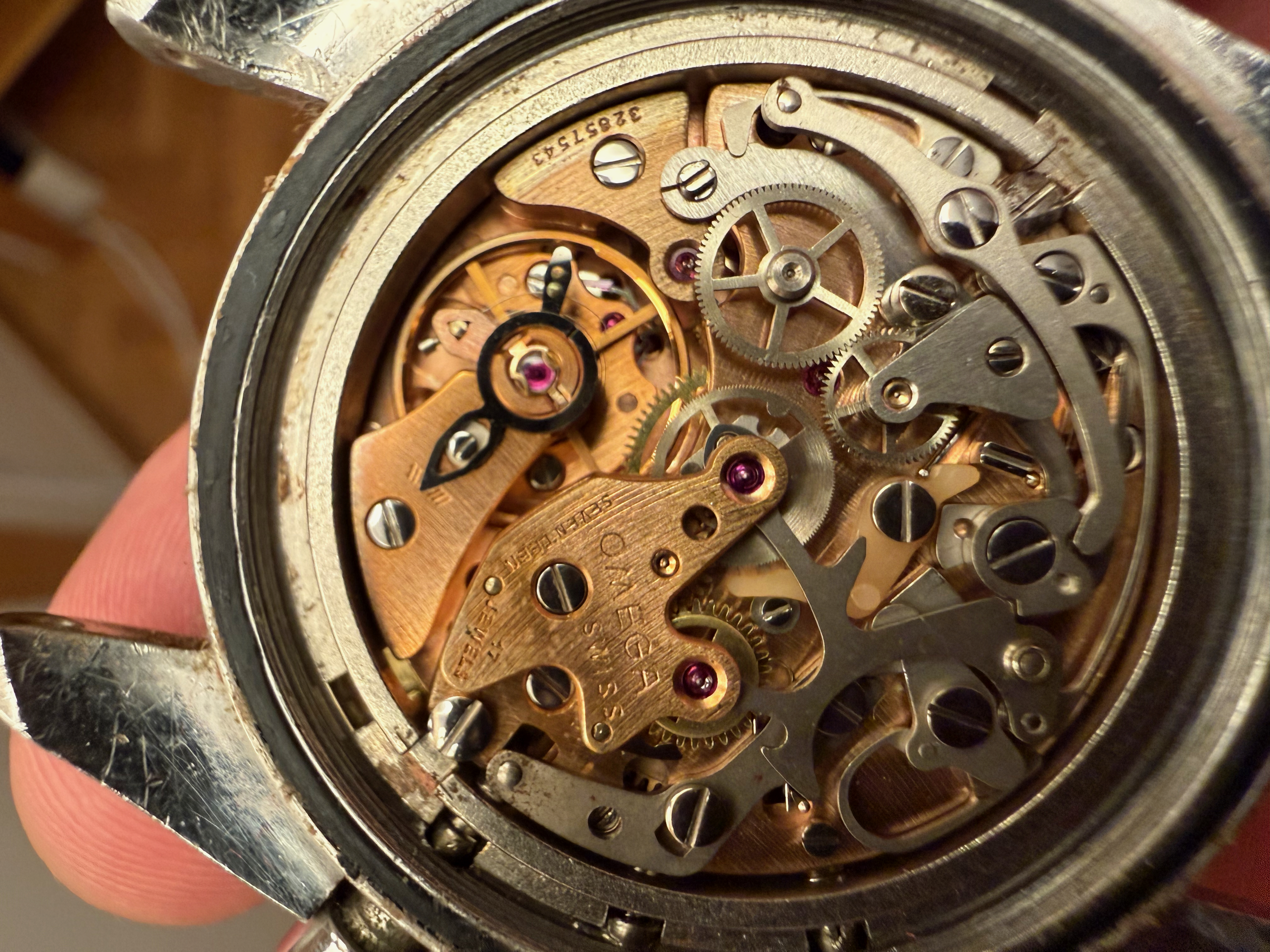

  • Movement serial ~32.8M points to ~1970-1971, suggesting this is NOT the original cal. 321 but a replacement cal. 861 installed during a later service.

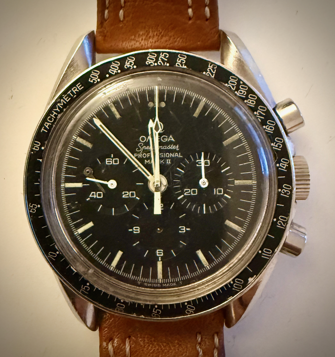

  • "MARK II" on the dial is not standard for a 145.012 - it looks like a service dial from a 145.014 Speedmaster Mark II was installed at some point.
  • Hands likely also replaced during the same service ?
QUESTIONS:
1. Can you confirm the movement is indeed a cal. 861 from the photos?
2. Is the dial confirmed as a Mark II service dial, or could it be something else?
3. Are the hands period-correct service replacements, or later still?
4. Any guess on when this service intervention took place?
5. For someone who wants to bring the watch closer to its original configuration, what would be your advice - leave as-is (honest service watch), or hunt for correct parts (cal. 321, correct 145.012 dial, hands)? Photos attached.
Happy to take more if needed (specific angles, macro shots, etc.).
Thank you for your time and expertise !!

Questions:
1. Yes cal 861 doesn’t belong in this case
2. Yes Mark Ii dial doesn’t belong in this case
3. Hands period correct
4. Who knows?
5. IMO leave as is it will be tough and expensive slog to buy expensive parts 321 movement and correct dial. And it will still be a put together watch not original. Just get it serviced if you want to wear and enjoy your father’s watch as he saw it.
It probably had water damage to movement and dial prompting this cobbled together service.

Yea that looks like a parts watch at this point, some decent value in the parts mind you, but best part it out imo

A movement service will cost around $1000 maybe more depending on parts needed. That’s minimum cost to get it wearable. Alternative is sell as parts as Ash suggests above. Depends on how attached you are to it.

I think the question is what would they turn it into, given there isn’t a 321 serial id imagine it would end up as a Mark II if the movement matches the dial.
That would probably be the best outcome imo, selling the case and bezel, keeping the movement dial and serial as a nice Mark II. I can’t imagine Omega will supply a new 321 and serial at this point

I can only agree with this, and don't forget the dial - that was how the watch looked when he had it, and how you have it now!
That’s why I would just service movement and wear as is
THIS!
It is not worth looking for a correct movement, dial etc,
and TBH - no one outside the "Speedyworld" will notice the difference!

Tough one. It’s pretty much a hybrid but as has been said, the serial number is almost certainly a replacement so if Omega used that for identification you may well end up with a mk2 which isn’t what your dad originally bought.
Personally I’d find a good independent watchmaker in your country, get the movement serviced, case cleaned, retain the dial and hands but get them relumed.
Then you’ve restored the watch to how your dad likely had it from c 1972 onwards.
5,331
24,388
Looks to me that it is as simple as a MkII internals placed into a 145.012 case.
So you could go ahead and make two watches, a Mk II and then source a movement and dial and hands for the 145.012.
You have a good DO90 bezel there.
The MkkII case should be relatively cost-effective - I often see complete cases with Crystal and pushers and crown, sometimes even a bracelet for around $600 (some less some more).
Of course the 321 movement and dial are going to be a lot of money - unlikely to be cost-effective, but satisfying. Also, the hunt is fun, and you might get lucky
