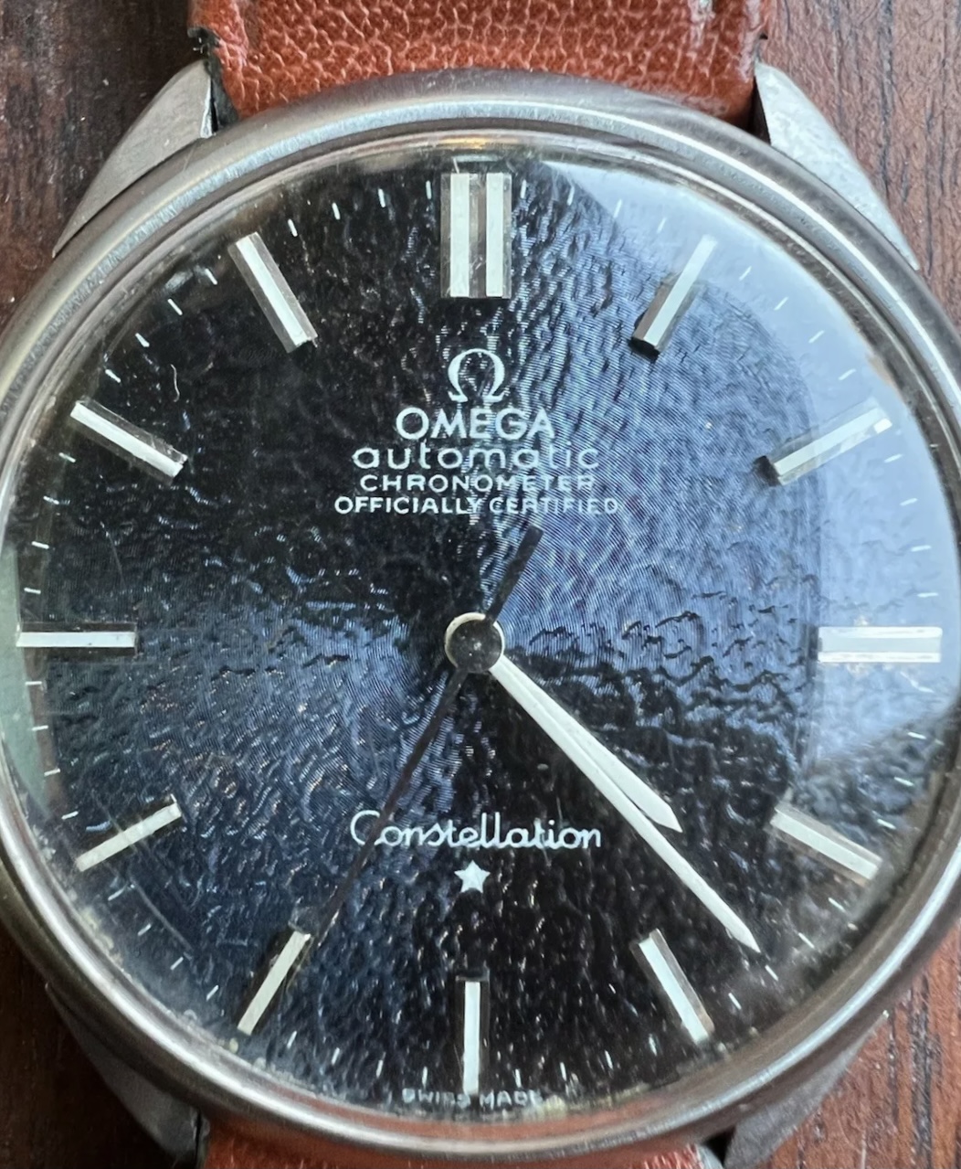

Good morning guys,
I’m checking this constellation ultra thin with
Ref 163.001 and caliber 712.

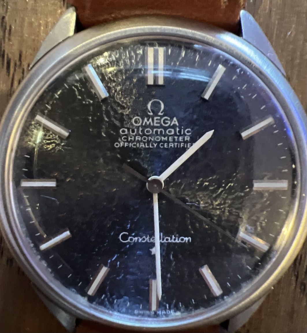

It have a strange dial and fonts, but seems that is ok with this ref. I think that the dial with sun? could have a transformation and the font too, but is only a my opinion.
I search other watch like this and I see that it s a particular ref, but with this dial colour (black to violet) there are no one on web.

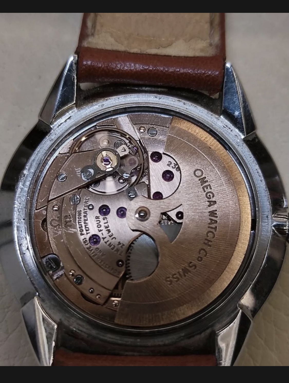

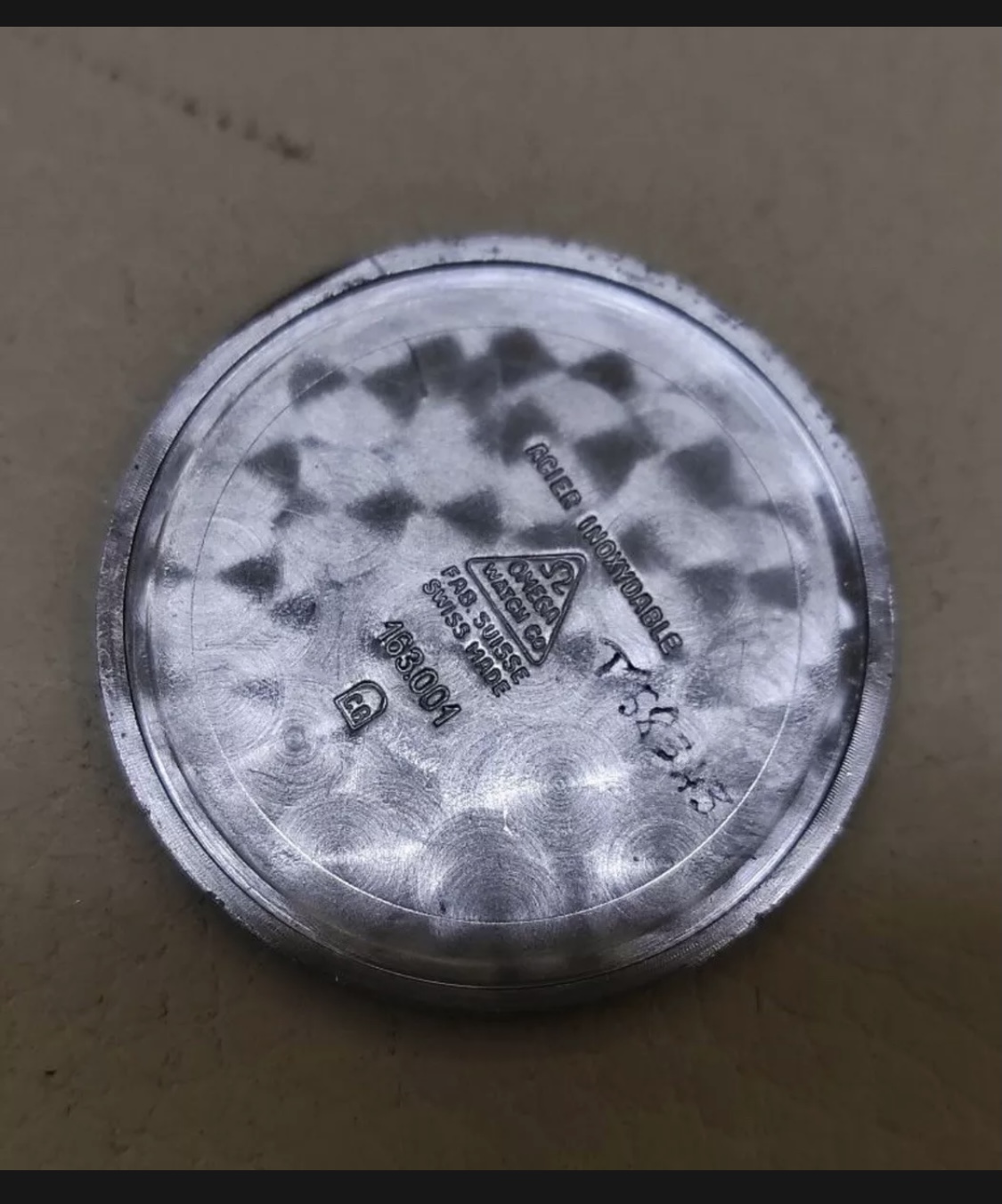

It have the original warranty with correct movement number, sold in 1983 but produced in 1966..
surely it isn t the most quoted constellations, and evidently it was not even before, but its peculiarity and low price lead me to evaluate it with you.
What do u think?
thanks guys

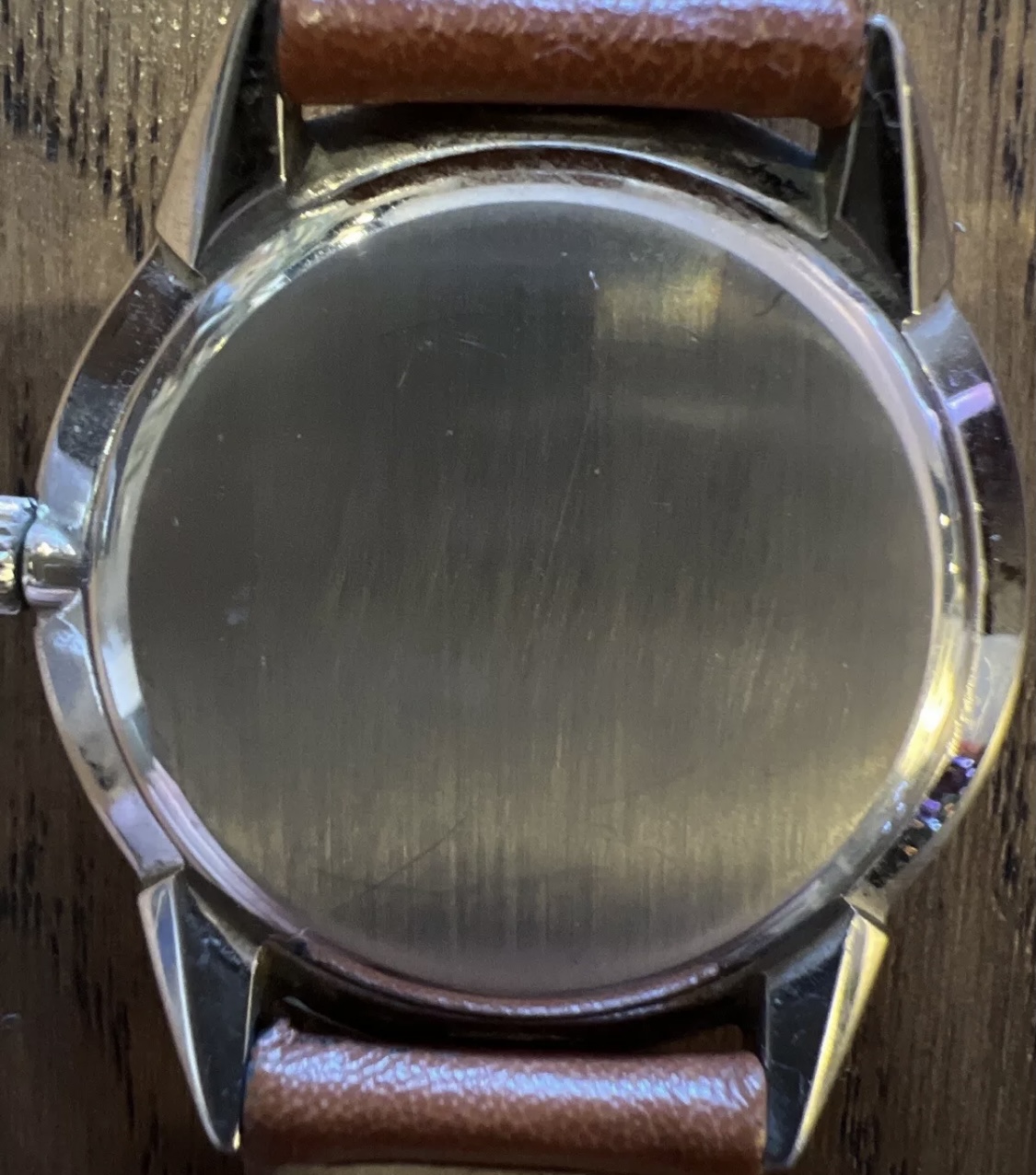

i have an issue with the upload, now there are some pics attached to

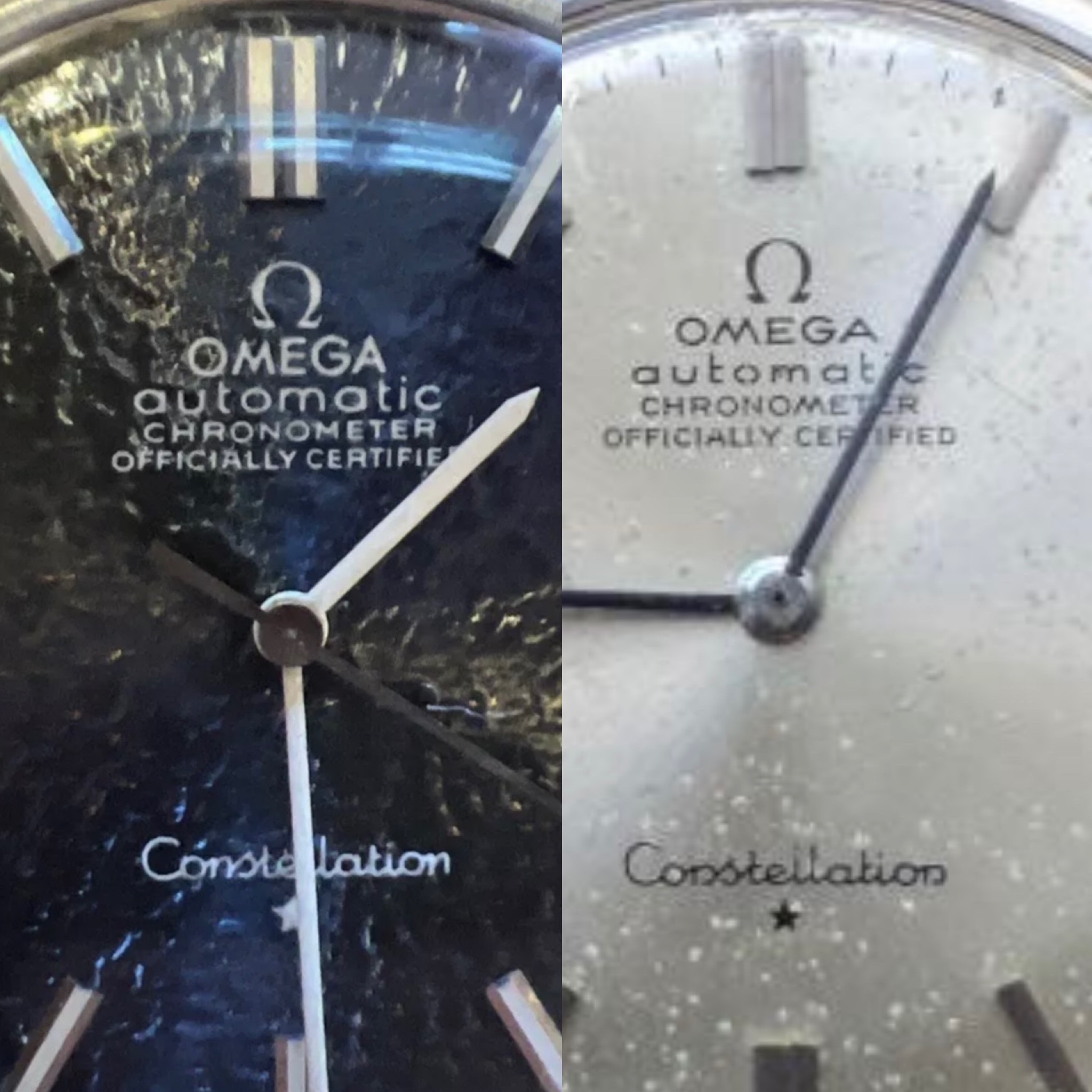

Hi, Bruno. I don't think either of the "n"s in "Constellation" can be right, and I doubt that sun action would produce that effect on dial paint. Also wondering whether the minute and hour hands are correct, or whether they should be even finer. You don't say what you mean by a "low price", but I would pass anyway.
You can see some good 163.001 dial pictures from an Italian forumite here - I hope that helps.

I always forget some details on font, I should improve my dial analysis 😀 “n” are a terrible tells. We talk about 300€..
