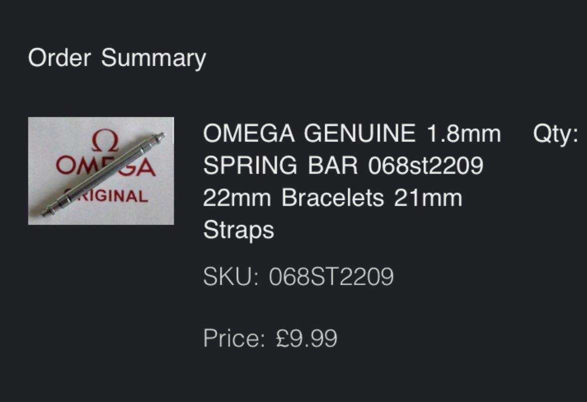

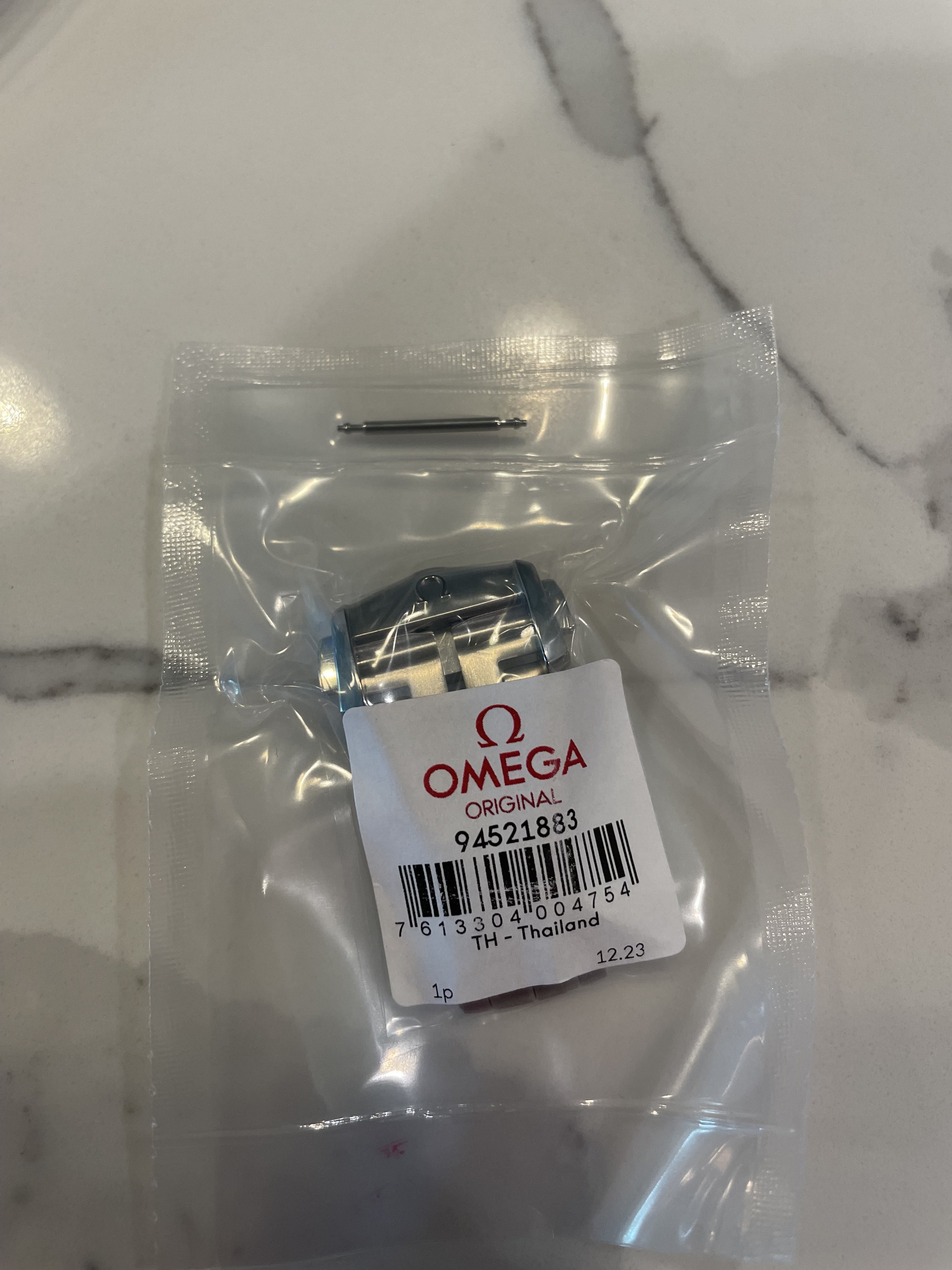

Sorry if this has been covered, I’ve looked but haven’t found any definitive answers. I just purchased a Speed Master Racing 44mm ref # 329.30.44.51.04.001 with the stainless steel bracelet. I wanted a sportier black strap for normal day to day wear and be able to put the stainless bracelet for more formal occasions. I purchased the DSOTM cordura strap and Omega stainless deployment clasp. My question is about the spring bars, so do I need a different set for the cordura strap that are slightly thicker (read that in one of the threads)? If so a reference number would be greatly appreciated. If not, would a second set of the ones in the stainless bracelet be recommended to have for each strap? Reference number for those would be appreciated as well.
6,487
31,960
the bracelet of your Racing with 21mm lugwidth uses the 068ST2208 springbars you'll need the 068ST2209 for a strap.
16
14
Thank you for the information and the ref #’s.

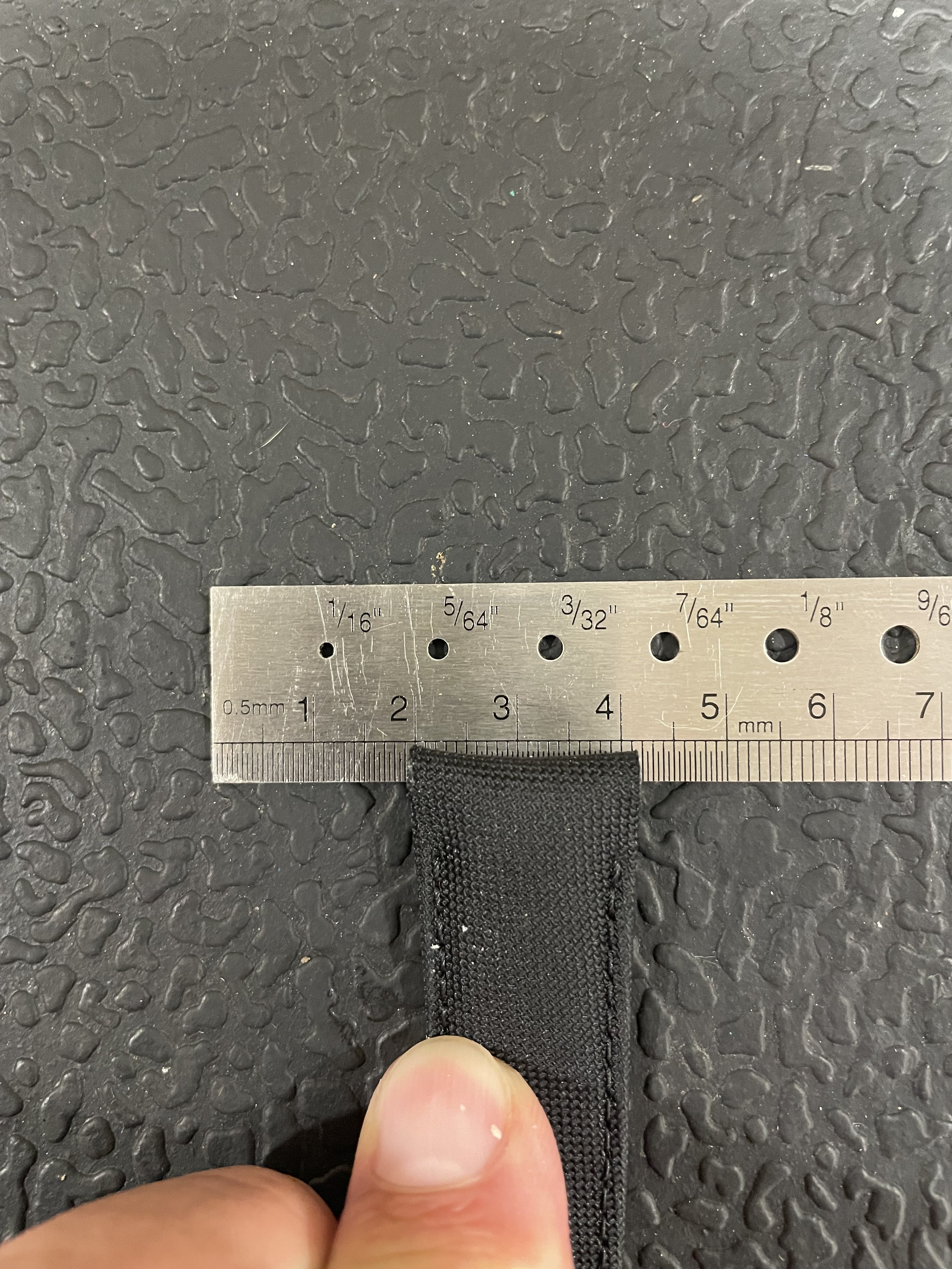

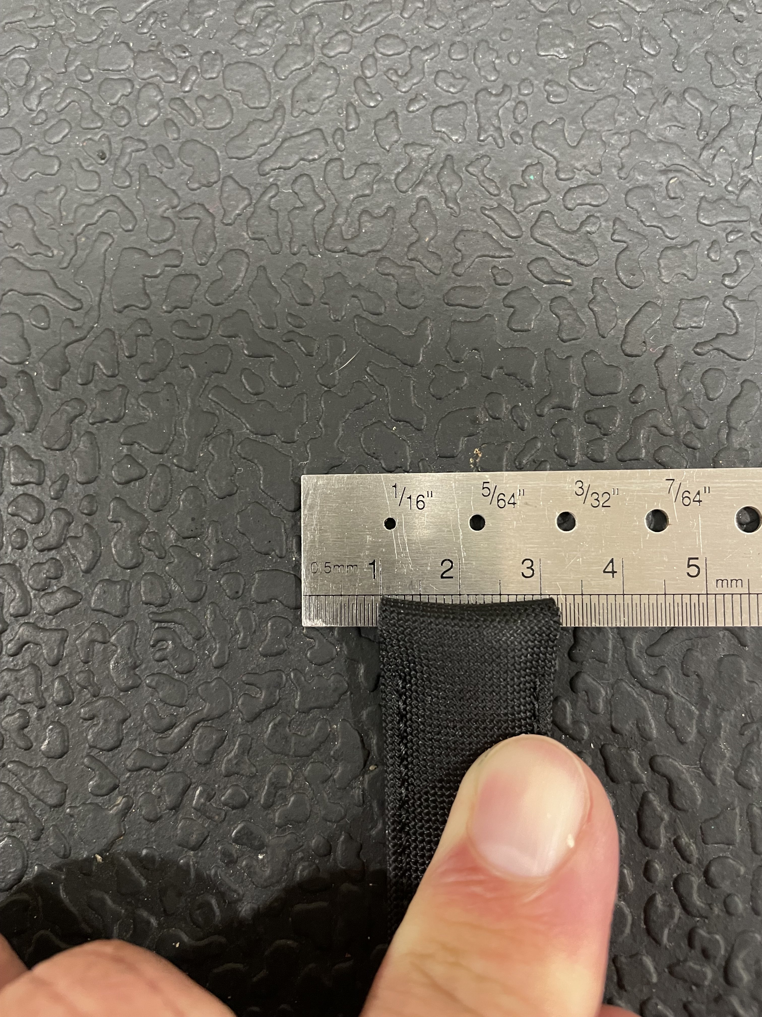

The longer side with the strap holes is normally on the 6 o' clock side. Are both exactly 21mm?
16
14
I don’t have a digital tool to measure with.
6,487
31,960
They are somewhat curved aren't they?
16
14
Yes I would say so, kinda contoured the same way the watch face is.
6,487
31,960
