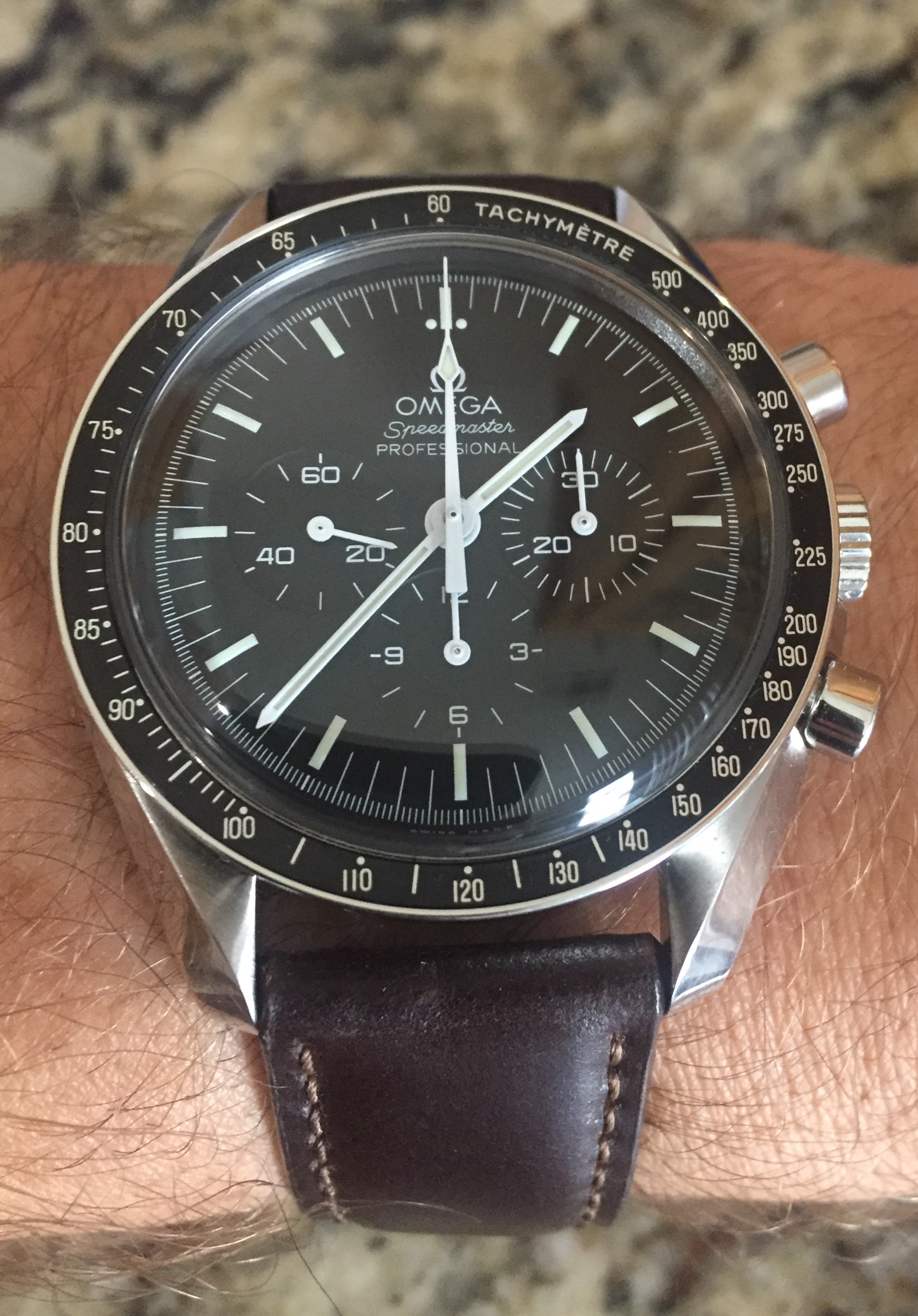

Meanwhile, she lives on a cordovan I had in the drawer...
That cordovan is gorgeous. Generally I prefer black to match the dial, but that dark reddish brown is spectacular.
Thanks! I'm a huge fan of the combo. I've been wearing it every day this week.

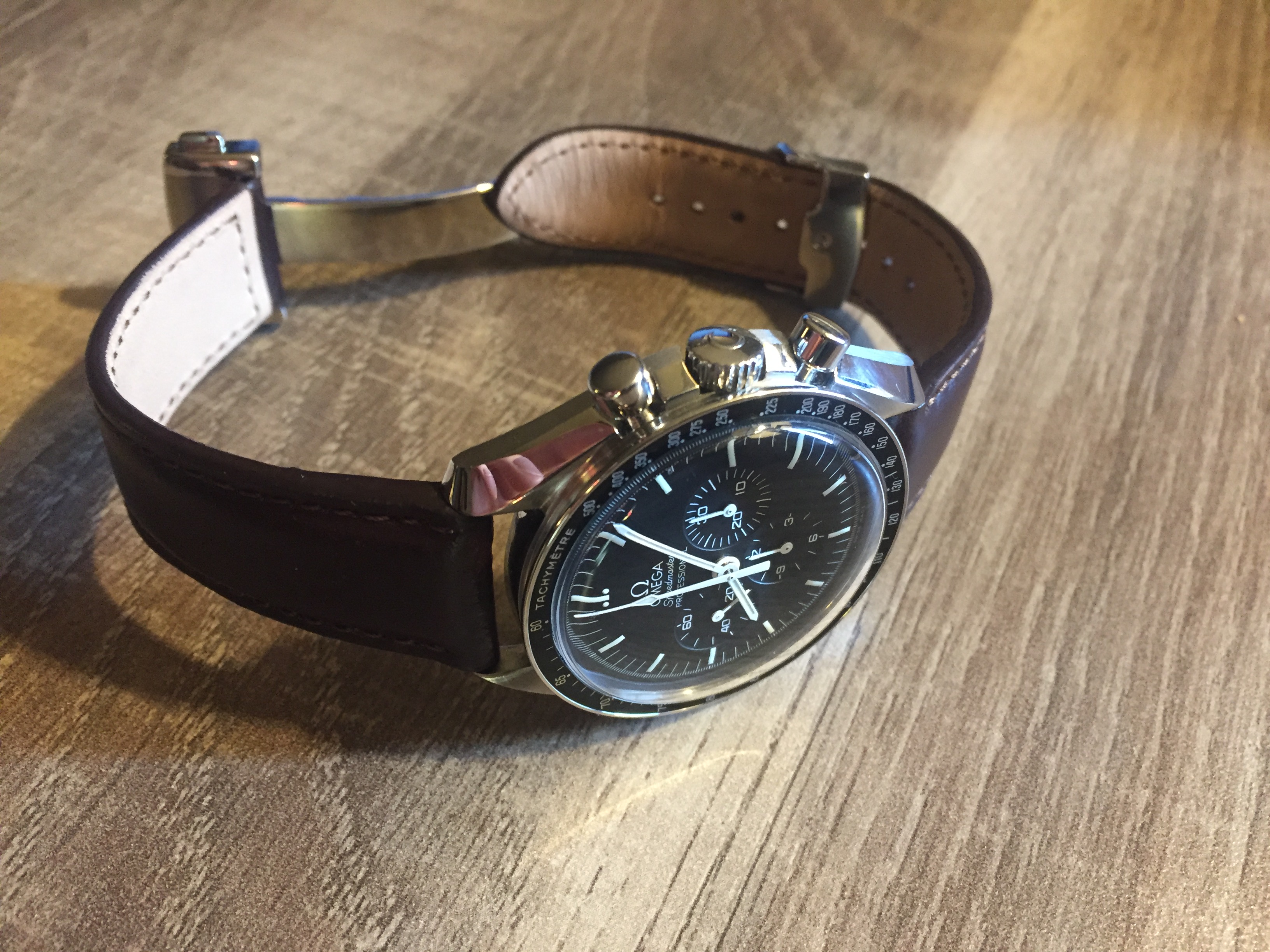

Regular buckle or deployment clasp?

Ok, I'm in! The deployment clasp clinched it. 😀
I'm amazed deployants aren't more popular. I've converted almost all my watches to clasps after dropping not just one, but TWO nice watches while trying to pin a buckle. Plus, I think they have a more refined look.

The clasp nearly vanishes when closed. They're a little spendy though and that may keep some people from considering deployment clasps.
Simple to adjust, easy to put on/take off the watch, and sleek.
