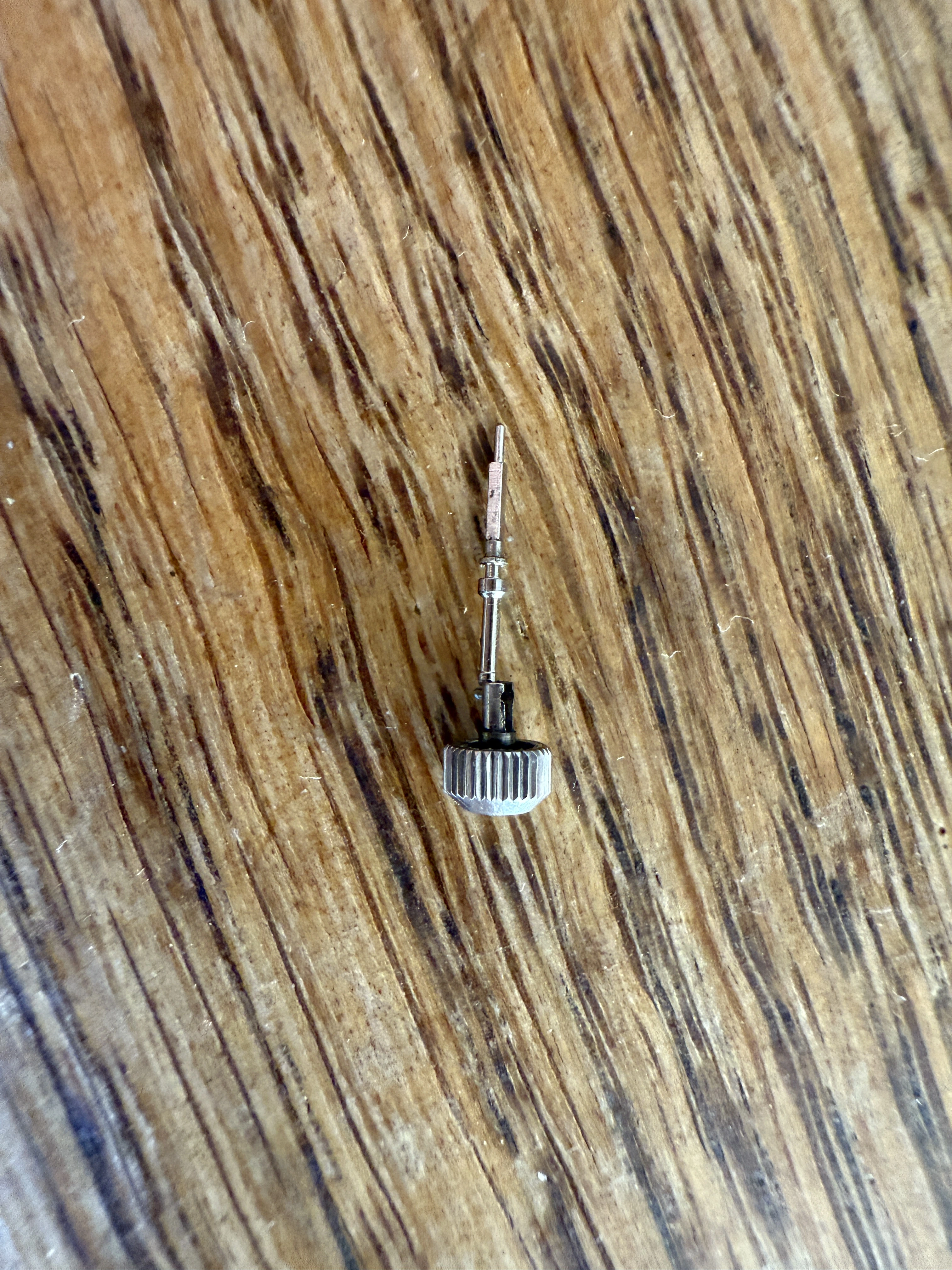

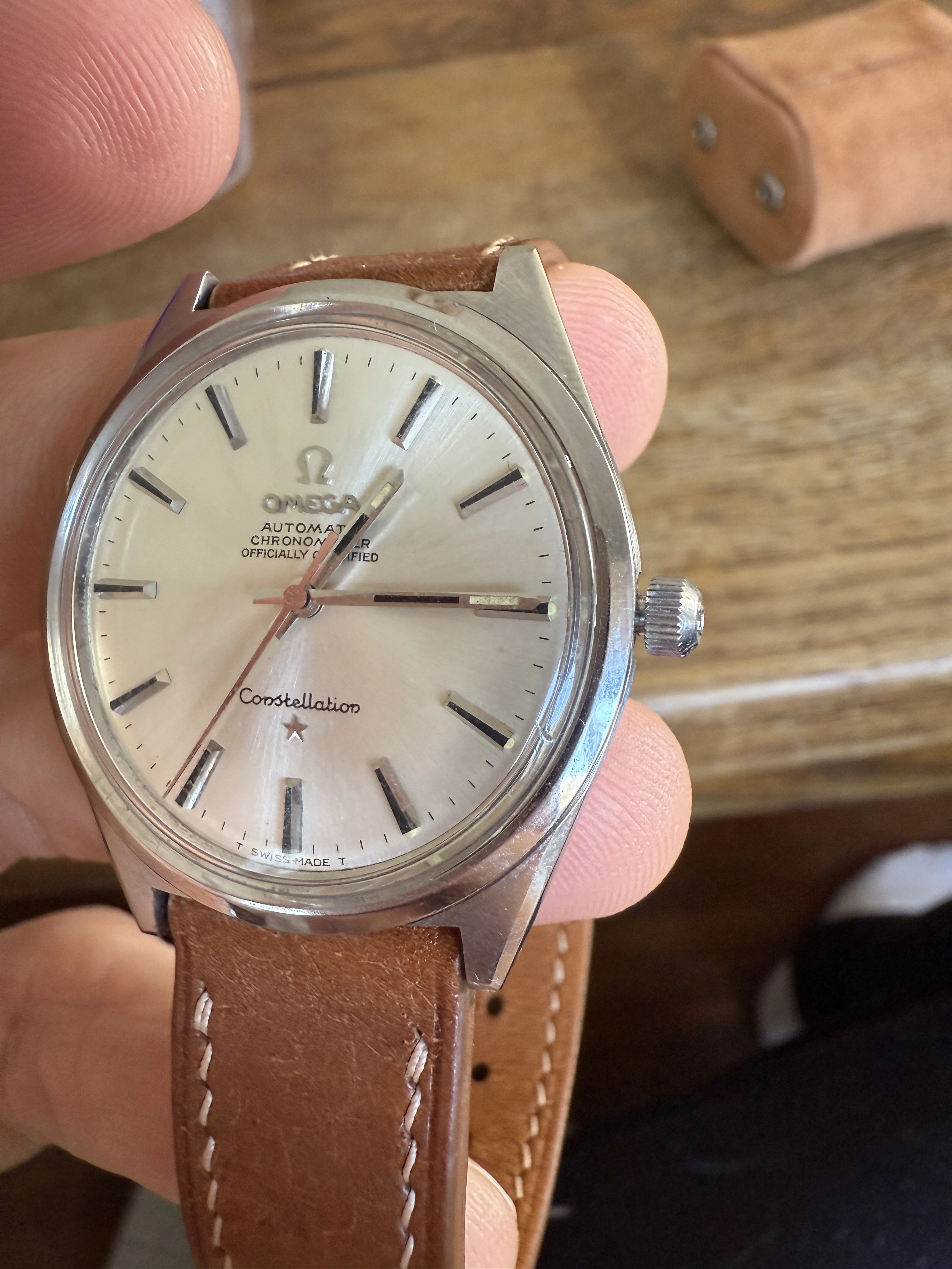

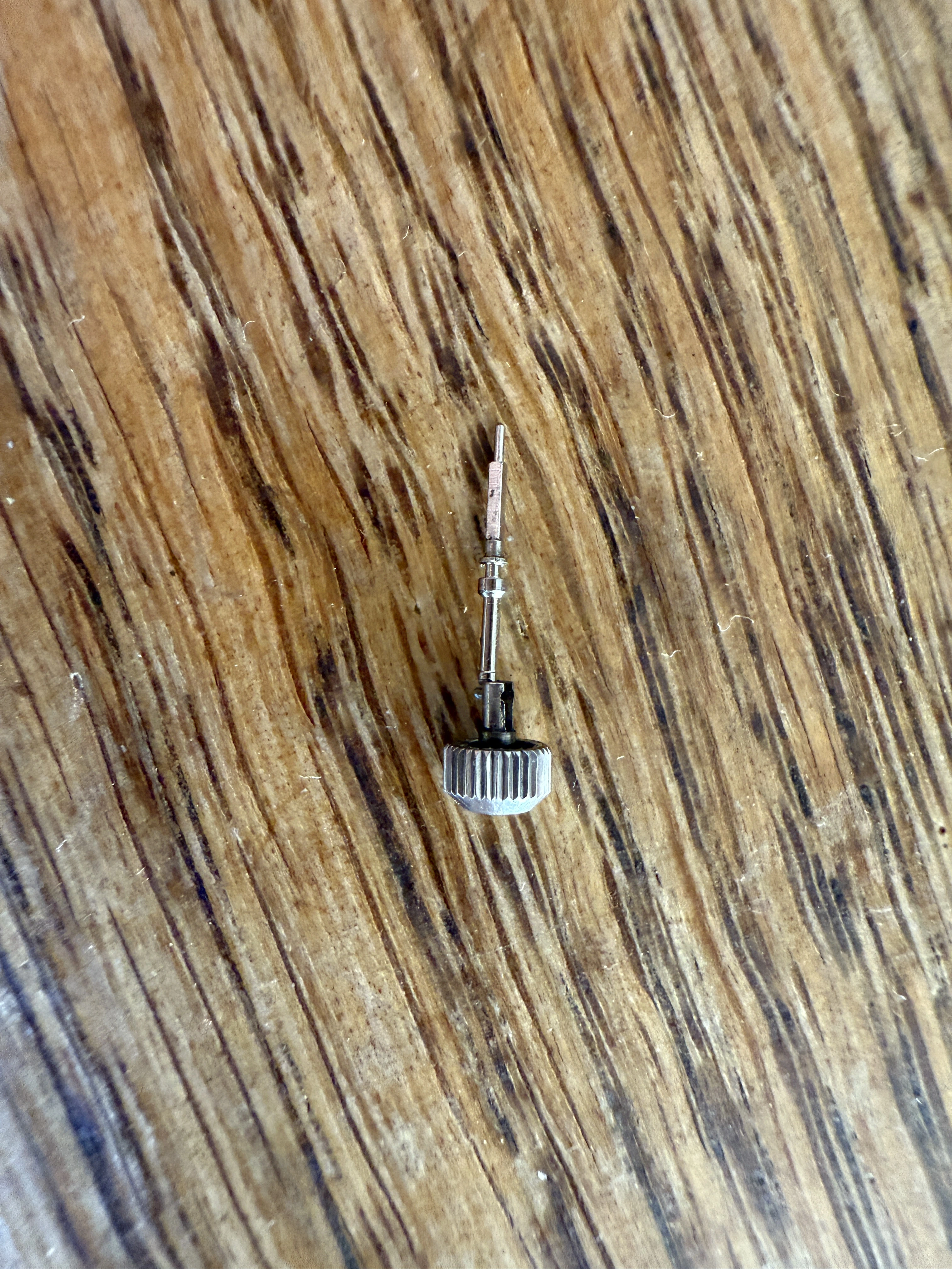

Hi All,
This has been covered before but I’m a little confused as I’m reading mixed info.
I’ve got a monocoque constellation ref 167.015. I went to set the time today and the split stem and crown have come out. I can push the stem and crown back in and wind the watch but I can’t set the time.
I read something about these monocoque cases where it’s common for this to happen. Can I just push the stem back in? Seems it would need a lot of force and I don’t want to damage the movement.
Or am I looking at a visit to my watchmaker?
Appreciate your help!

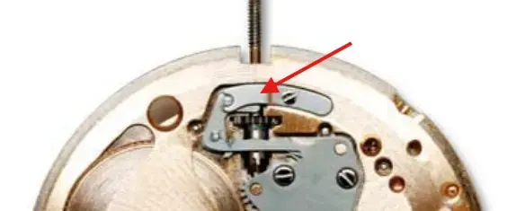

OP, hopefully you can get this sorted out with the watchmaker who recently serviced the watch. Just to note, this movement does not have a setting lever screw like most Swiss movements. Instead, it uses a setting lever spring on the dial side to keep the lever in place.

Thanks Rendo, seems likely this has failed then. I actually checked and the watch is still under warranty with the dealer I purchased from so will contact them first. Hopefully they honour it!
