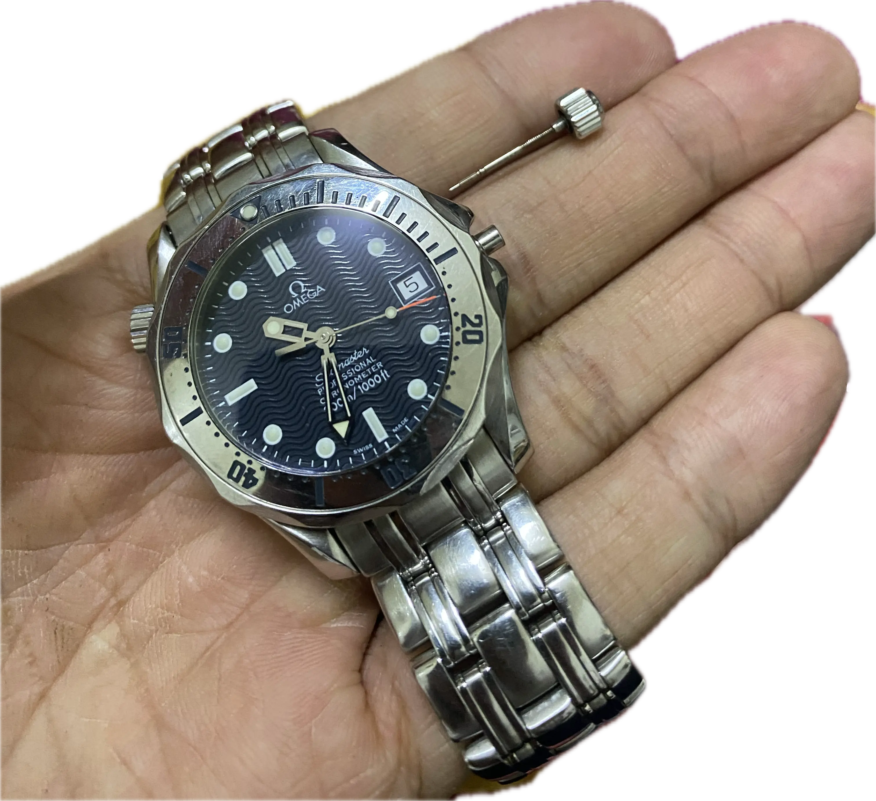

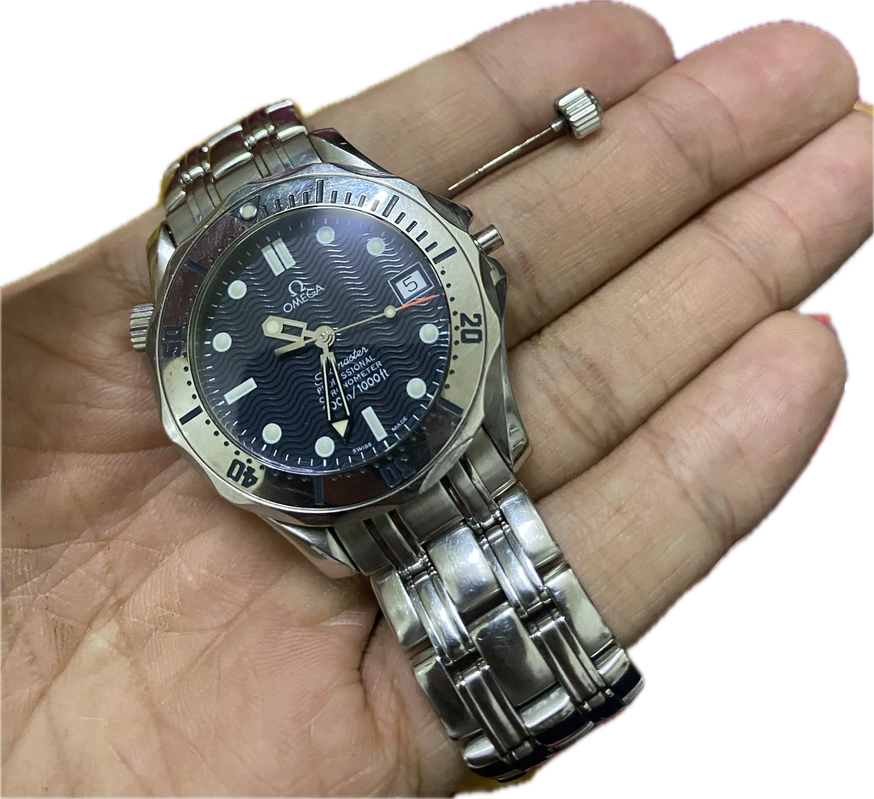

Greetings. I’ve recently acquired an SMP300 ref. 2552.80, cal. 1120.
After unboxing the watch, I unscrewed the crown and winding seemed fine, but when I pulled it further to set the date and time, the crown and stem came off completely. I re-inserted the whole thing and it could still be wound, the date and time could be adjusted, and the hacking function worked. However, with just a little effort the stem can still be pulled out. It is now inserted and screwed in.
This watch had been serviced before being sent to me. The seller said this should be an easy fix, perhaps due to something coming loose during transportation. I’m going to have it inspected tomorrow, but in the meantime I’d like to hear from anyone who has experienced this before. What else should I look out for?

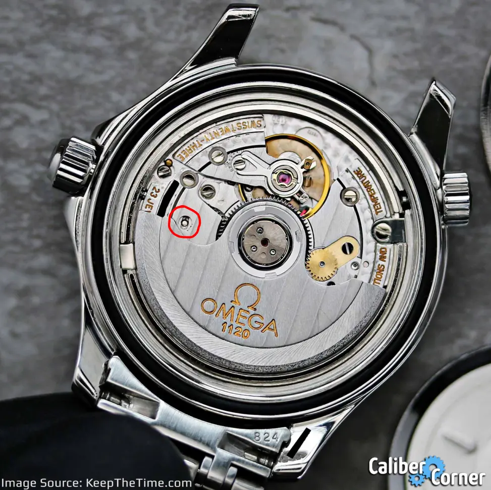

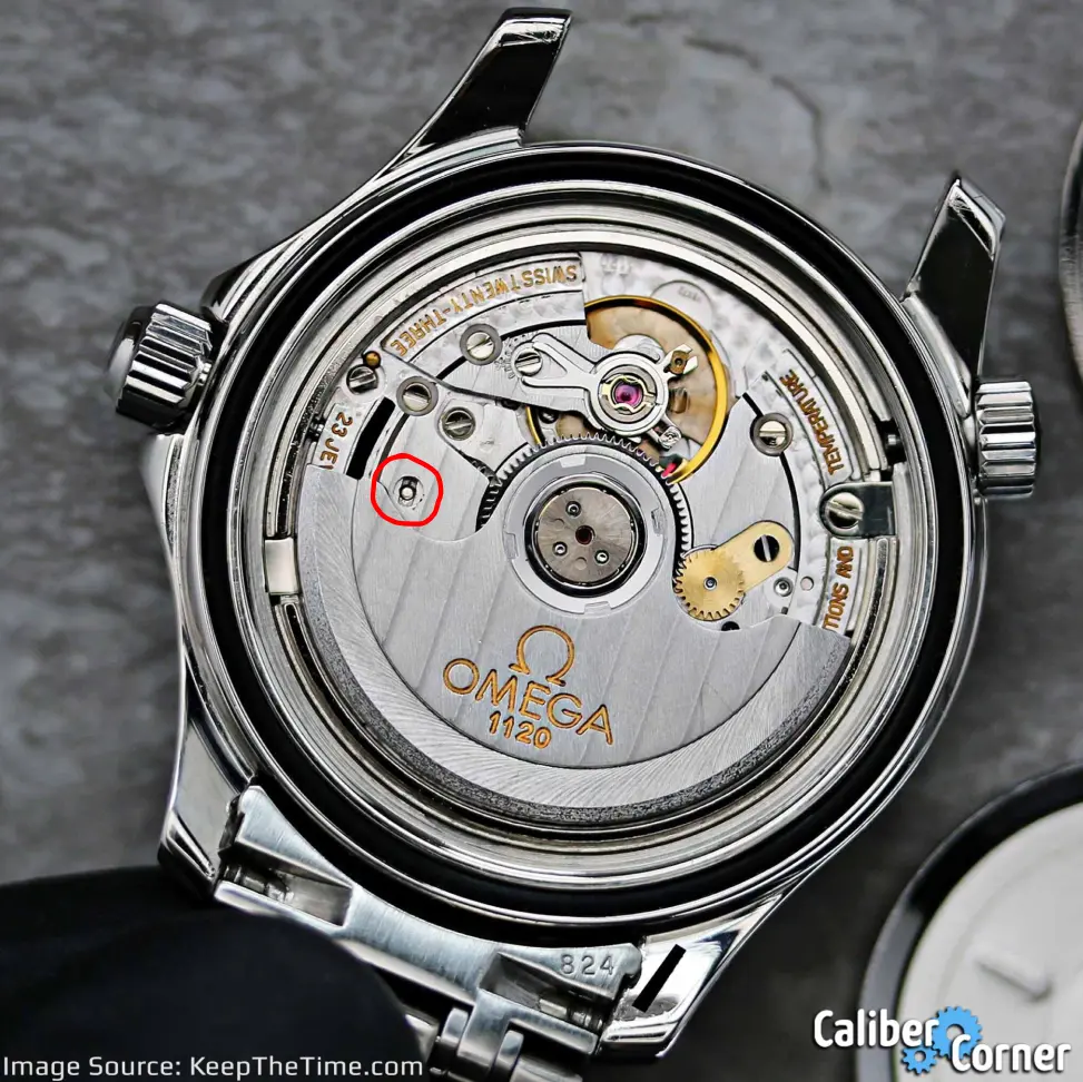

The stem can be removed and inserted by pressing on a little slot, which is spring loaded. You can push the stem all in, and while still pushing the stem lightly, press on the slot with a sharp tool. Of course, that assumes that you have the tools to open the case back and at least have a little understanding of what you're doing. Otherwise leave it a to a professional. It may be as simple as that, or the stem too short, or something more complicated.

You do not want to use anything pointed. The reason there is a slot where the stem release is, is so that you can use a screwdriver to press the button in. By using a screwdriver it limits how far in the button can be pressed, because if you press it too far, the winding/setting parts can be disturbed to the point that the stem will just pull right out...like the OP has.
If that happened, the hands, and dial will have to come off, along with the calendar parts to repair it.
Use a .8 screwdriver for this...

IF the stem is coming out too easily, that means your watch needs a trip to a watchmaker. The dial/hands have to come off (and much of the date mechanism) if the problem is watch-side (like a setting lever spring too loose or bent, or a gunked-up-setting lever, or broken setting lever tip, etc), or a replacement stem if that is 'all' that is wrong with it.
IF you have the ability to return it, I'd suggest doing that and buying a different one. Else, expect a few hundred to repair it.

I really appreciate all the input. I went to a well-known local watchmaker, and they replaced the setting lever (according to what they told me). Since this was arranged through the seller, the replacement was covered under the seller’s warranty. The crown now operates just as it should. I’m still in the honeymoon phase with this piece.
