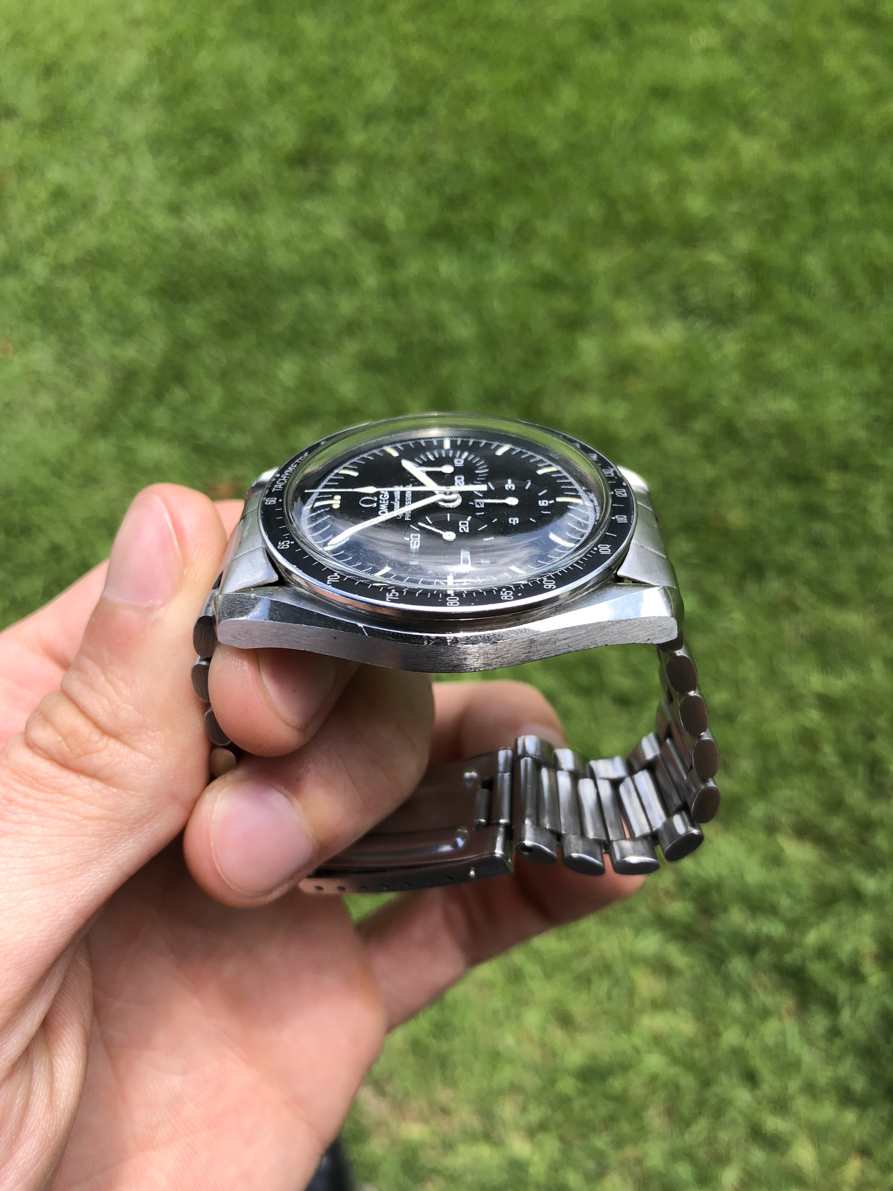

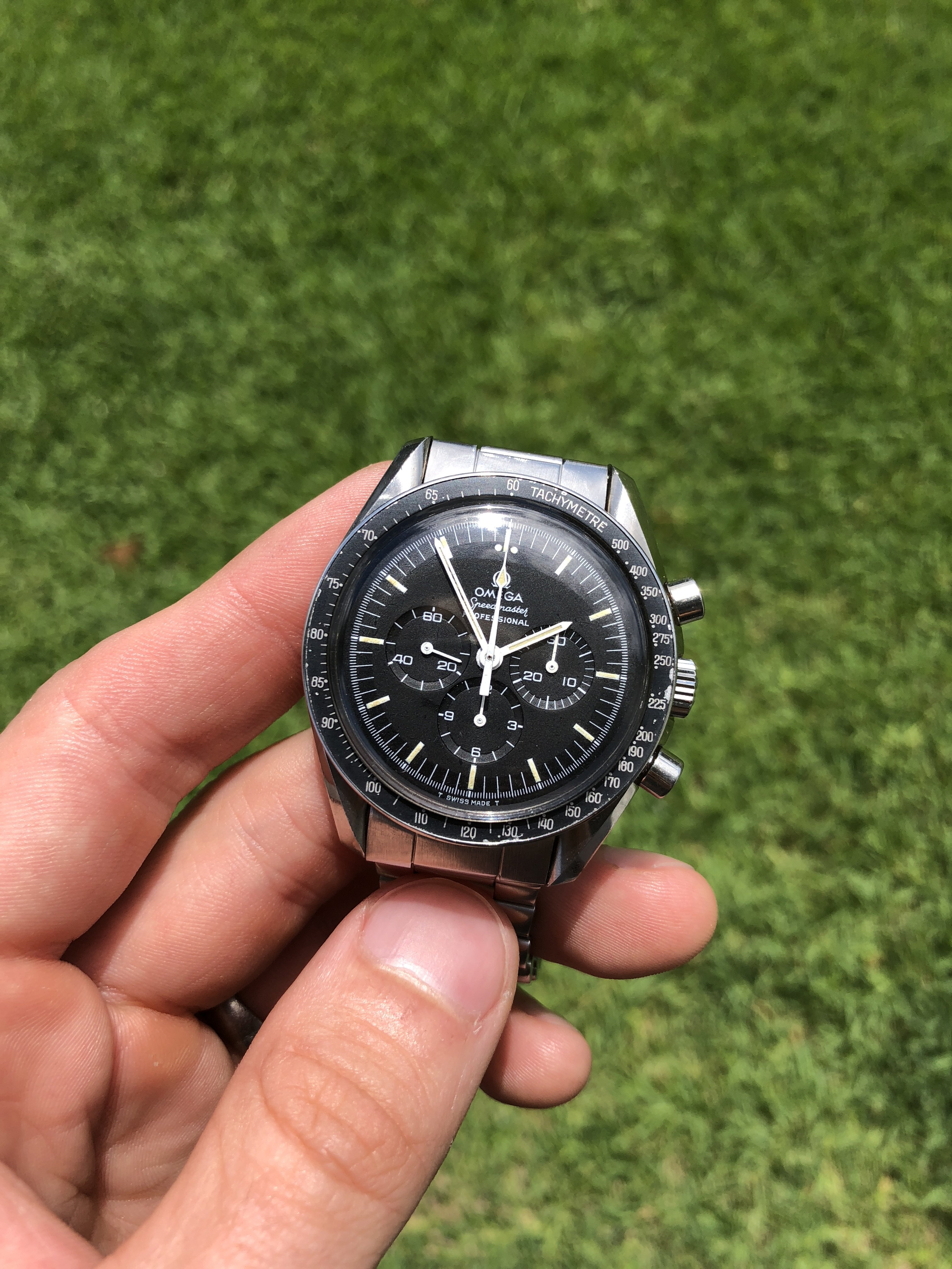

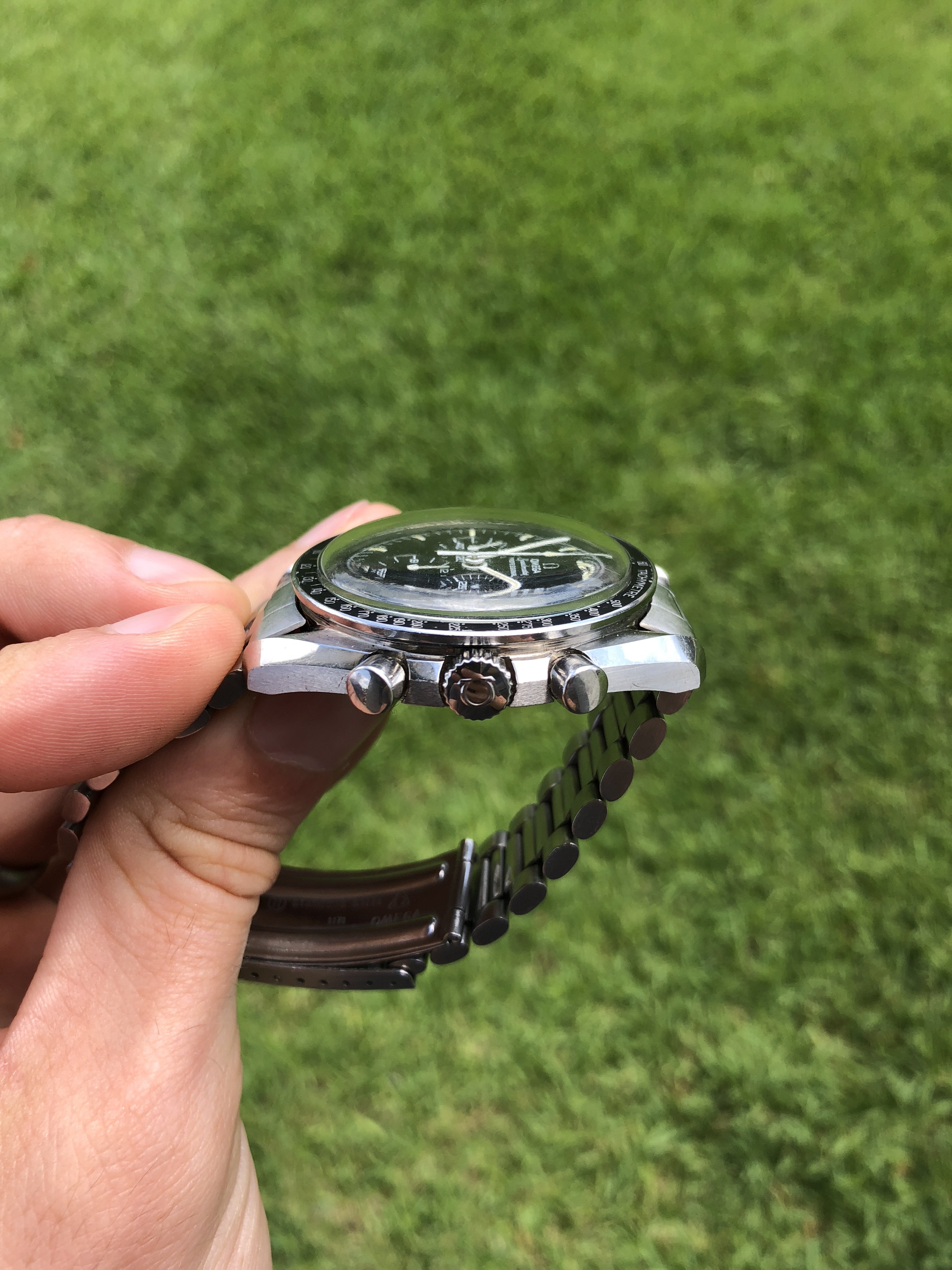

After much searching, and no finding of a watch maker that was perfectly fitting my bill in my local area, I decided to go back to Atelier and have them perform the service on my 145.022-74, despite my frustrations chronicled earlier in this thread. It took a little sucking-up of my own pride, but ultimately I am happy to say that I jut got the watch back, and they did great job. I wont say that they went above or beyond to cater to the needs of vintage owners - for instance they seemed perplexed as to why I wouldn't want the case refinished, or why I wanted to keep the original parts. But at the end of the day, all that matters is that they did what I needed, and they did so very well. I will happily return in the future.
She's healthy and looking good with a new set of period correct hands and unpolished caseband that I picked up while it was away for service!
334
784
Congratulations that the service finally worked out for you. Nice looking watch! I think the case in in a really good condition considering it is more than 40 years old. It appears to me that the bezel and the dial do not line up as good as before service. The bezel seem to be turned a little bit to much to the leftt.
Just for curiosity where did you source the hand set? 😗 I am looking for one in a good condition myself. The ones I find do always look less attractive.
Good eye. I fixed that already.
I got the handset from ebay. It was basically an entire 145.022-78 that an owner had since the mid 80's, but had donated the movement to a different watch, for reasons I don't know. I sold the dial and bezel, kept the handset and case band and recouped nearly all of the cost. I think I'm down about $200 for the handset and case band so far... not bad. I will likely sell off my old hand set, but they're in such poor condition that they have very little value and will need a repaint and relume to have any attraction. I think I plan on keeping my original case band and pushers.
That is one sharp caseband 😗
Yes... almost too sharp? It starts to feel like the bezel doesn't really match the case band...🤔. I'm keeping my old case band out of slight worry that it a little too much of a contrast. but I like my aged bezel, even if others would match better.
