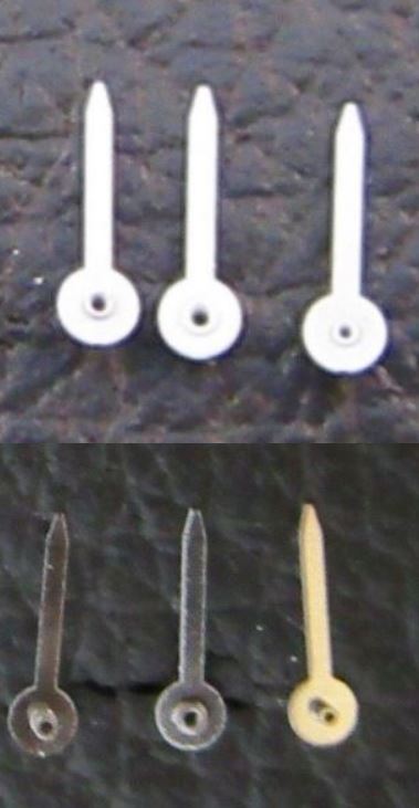

Just a question about the counters hands of the 145.022 series (Maybe it is the same for other ref?...): are they all different?
On this pic, it seems that they have all a different hole diameter, and a different "tube" size... (I don't use the right words I guess...)
Thanks by advance for your advices...
B.

Yes, on the 321, 861, and 1861 there are all different for each hand. All these hands are compatible with the other movements, so the minute counter hand for example fits all three movements.
When you get to the new 3861, things change. The hands on that one are all the same size posts...
Cheers, Al

@Archer, thanks for these details, very good to know. Compatibility between 861 and 1861 will probably help me... 馃榾
Not concerned yet by the 3861 馃榿, but one day maybe...馃榿馃榿
1,583
10,359
Oh yes, very clear. Axles diameters really different... Thanks again for your time, your quick and accurate answers, @Archer , all the time. Precious on OF!
