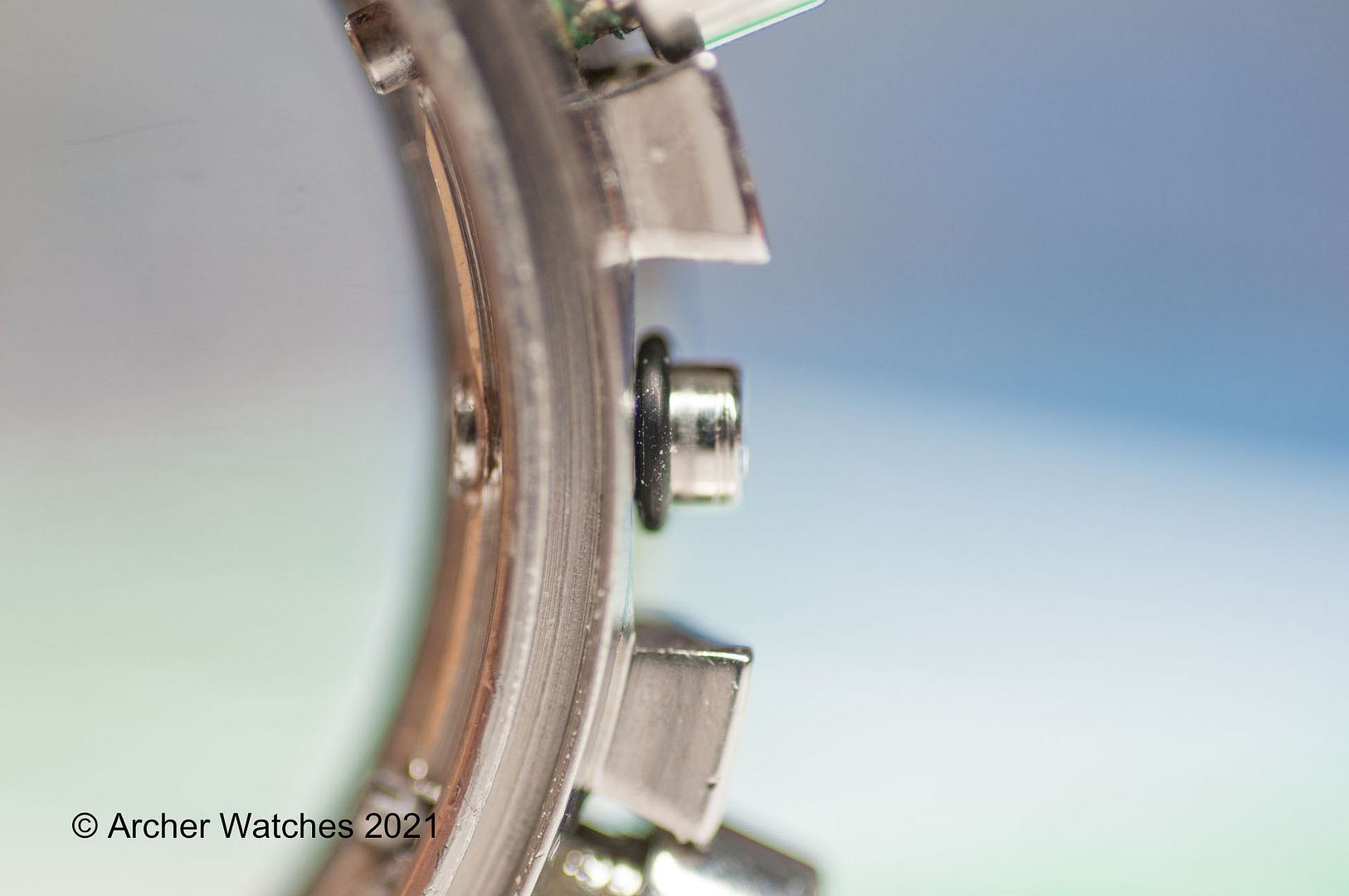

Perhaps some images will help illustrate. This is a Speedmaster case, and I have placed an O-ring, similar to the one that is inside the crown, onto the case tube. This is the approximate position that the O-ring located when the crown is pressed in to the winding position:
This photo represents the approximate position of that same O-ring, when the crown is pulled out to the time setting position (as you know, the crown does not move very far when it is pulled out):
Based on this, it should be pretty obvious that the water resistance does not change by moving the seal a couple of mm's.
Cheers, Al

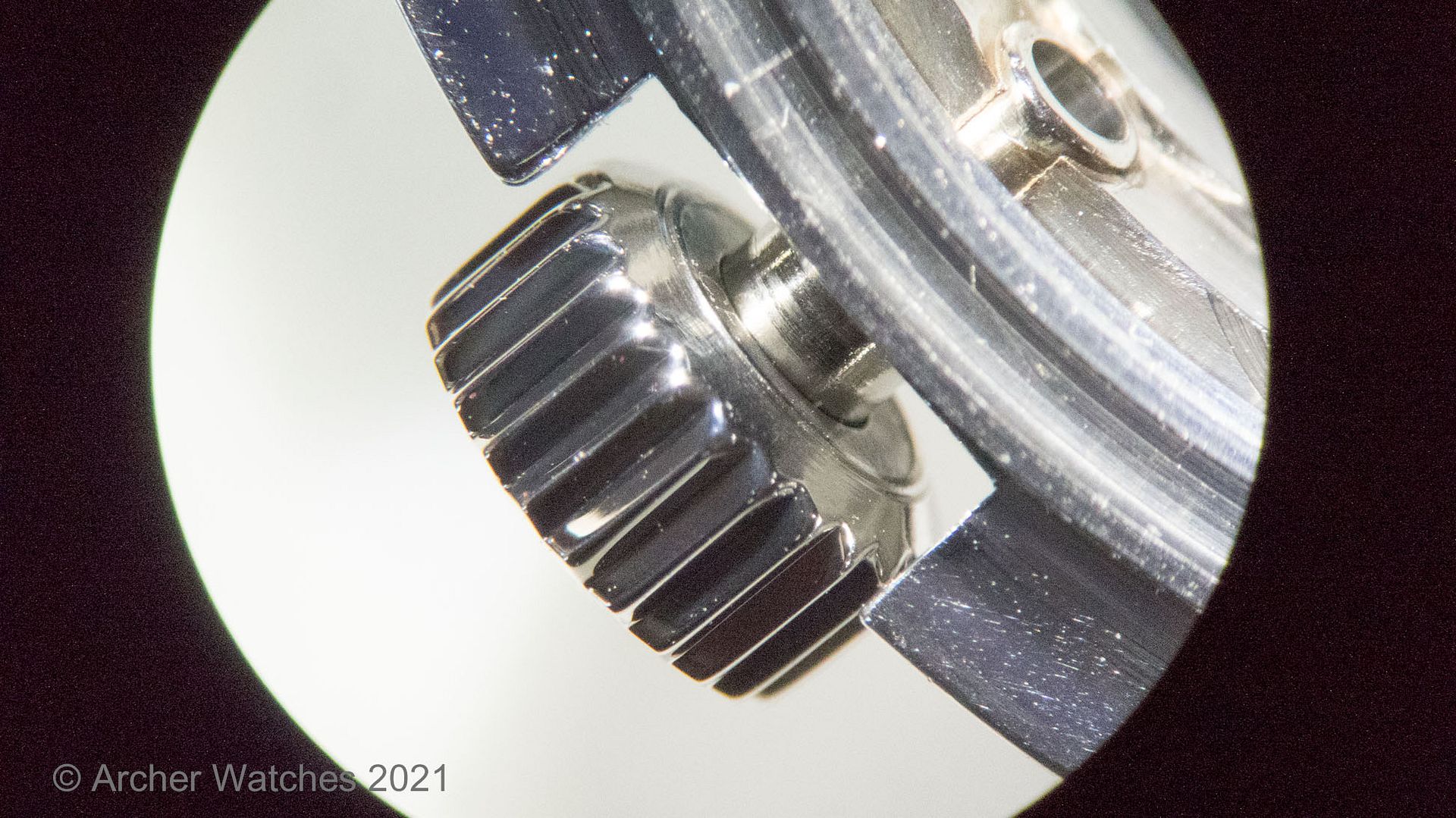

Here is a Speedmaster crown installed on a case tube...this should clear up your misconception...
Cheers, Al
