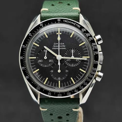

Hi Omega Forums,
Could someone help me with the originality and condition of the watch?
Some points I noticed:
stepped dial
applied Omega logo
T swiss made T
long indices
correct caseback
BASE 500 DO90 bezel
Asking price is high in my view: 11,100.00 USD, no box or papers.
Thanks,
Mateus.
2,427
4,700
It's a 105.012-65. So 11k could be fine, but some more pictures would help, e.g. from the movement and in general, in better light. If the seller won't provide that, I see a red flag not pictured 馃榾
These are only the first steps to see if a further assessment is meaningful or if you should walk on.
5,376
24,550
I would like to see inside before saying its 65 for sure.

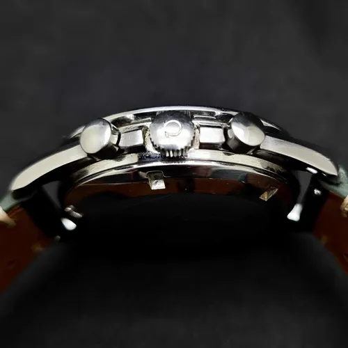

It has the correct pushers, but wrong crown.
Close spaced T marks, but the photo wont let me zoom in.

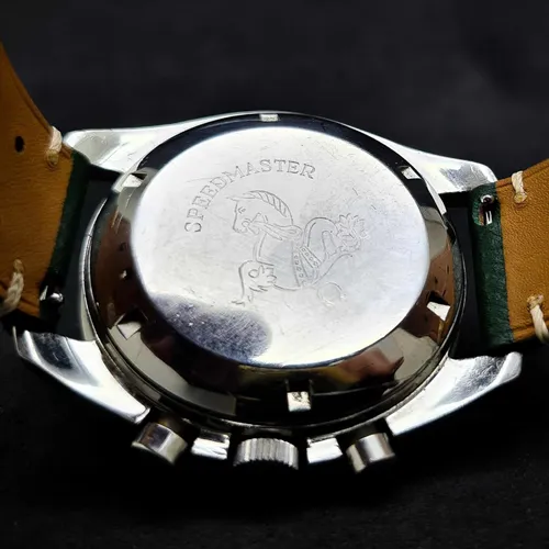

Case back is polished, not crime, but you need a better view.
If everything is good, 11k is about right.
But dont take my word on it until you show some better pictures. These are PNG's so I think thats why I cant zoom them
