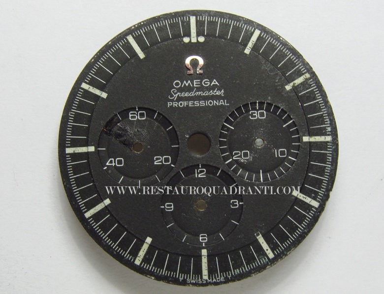

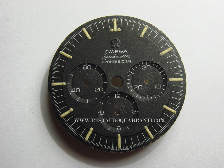

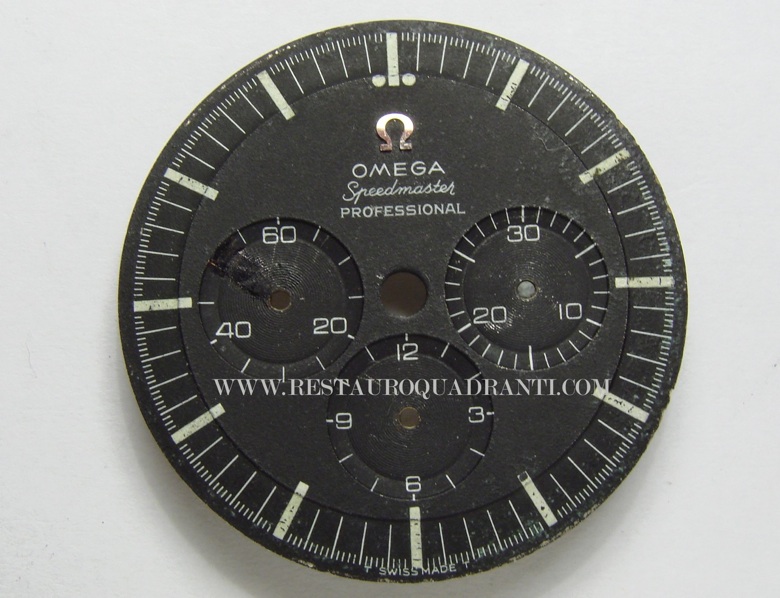

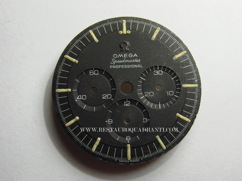

I am now of the view that there is nothing special about the dial feet for the 68 transitional models - they are just regular 861 dial feet. I also believe the dial feet for the 861/1861 models are the same size, as they have to fit into the hole in the main plate. 321 dials can be fitted by filing the feet.
I believe the dial feet should fit. Sometimes, if the dial is from a 321, the feet are filed down to fit the 861.
The dial feet are 0.95 x 2.75 long for the 861
Just my 0.0002c worth - I would keep the original dial in this watch as is - it is a beautifully battle scarred dial complete with memories. Sure, buy another dial (at todays prices) in case this evaporates on you or a family member in the distant future 😁. Personally I have changed dials to make them "more attractive" and have just wasted money.
I would most likely want to contact someone in an attempt to apply some unguent to stop the spread of any further rust cancer. If you did want to have it restored ro some of its past glory then I would contact LewiswatchCo in Australia to see what he could do.

I’d also keep the original dial. It proudly displays the history and experiences the watch has been through.
If you do decide to swap it out, you could also consider a modern service dial. It would be cheaper than a vintage -69 dial and after all, neither would be original.

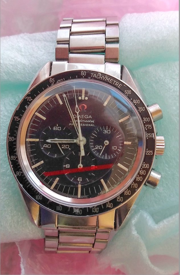

That's a good thought 😀. I wish I had a real clear picture of the watch on my wrist while sailing but this is the best I could come up with. I post just for fun.

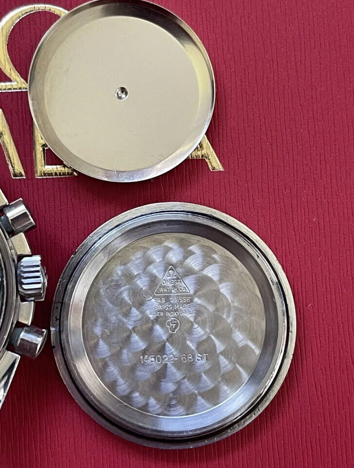

I would also leave the engraving on the caseback, as it is part of the story. Your loved ones will appreciate it long after you are gone (not that that would be anytime soon, I hope).

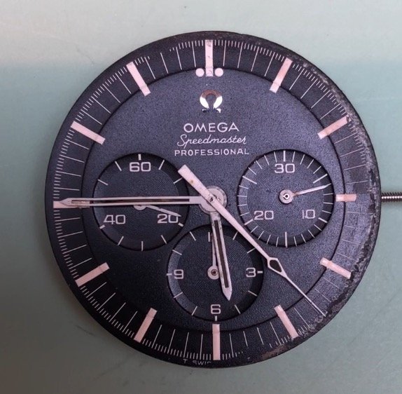

My thrill at finding my beloved watch only lasted a few days. As I began wearing it, I started noticing condensation under the crystal. Salt water had obviously gotten inside the watch!

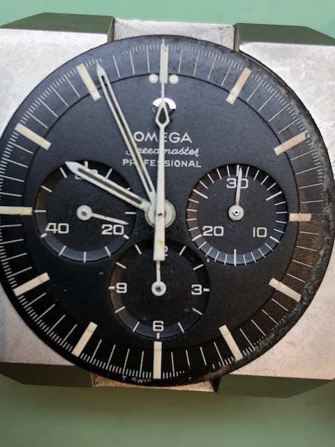

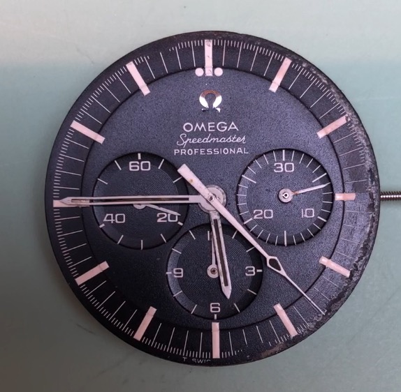

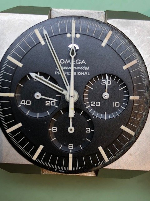

Long story short, the watch continued to run for a while but gradually the face of the watch started showing signs or corrosion, the markings and lume started showing increasing signs of damage. Then one day the winding stem came off, and I sadly retired the watch to a dresser drawer for several years until I finally started thinking about resurrecting it.

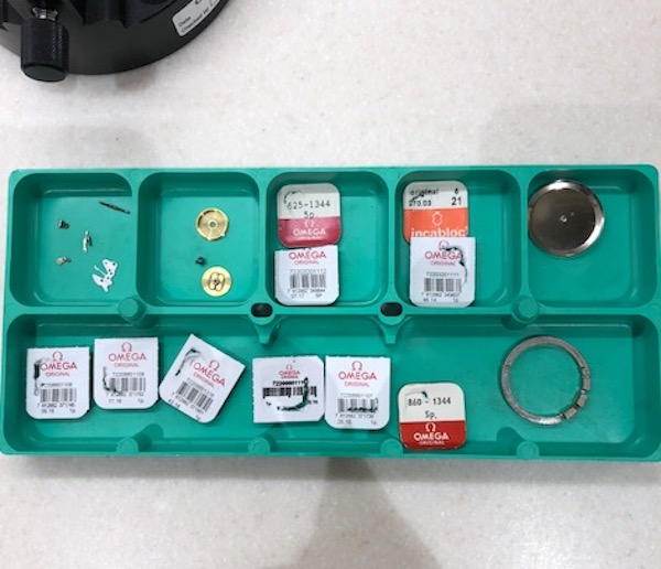

Omega wouldn't touch it, claiming it was beyond repair. Through this forum I found a master horologist with credentials for working on Omega watches. He took a look and said he could completely restore it mechanically though I'd have to live with the dial's cosmetic damage unless I wanted to spend thousands to find a replacement.
At first I thought of doing that, but then someone of this forums suggested I just leave it as is. He said I should think of it as "battle scars" and be proud of that. And you know what? He was right! Even though a collector would scoff at the look of my watch, I love it! Every time I look at it, it reminds me of being an 18 year old kid on an epic sailing adventure. Even if someone paid me, I wouldn't replace the face. So thanks to whoever suggested that to me on this forum!

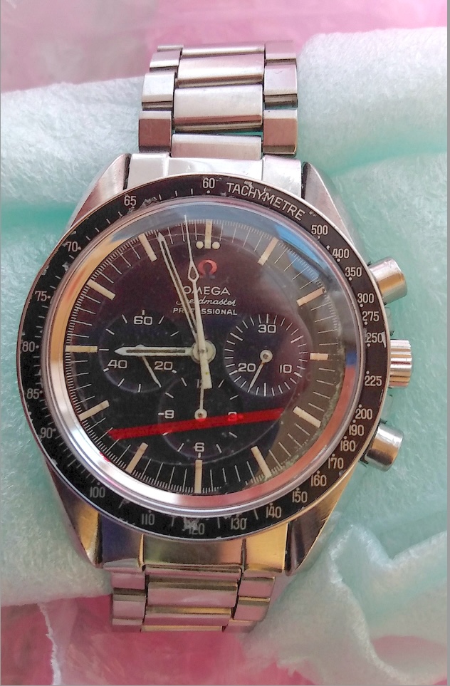

So, anyway I went ahead and spent $700 to repair it and now have a fully functioning watch with a sort of ugly dial on it LOL I prefer to think of the dial as "battle scars" of that fateful trip, rather than a flaw. I mean, I am not a watch collector. This watch was used as it was intended, and used very hard! Now, 55 years later, it is still running just fine. Imagine that...55 YEARS!!!

The permanent damage to the face:

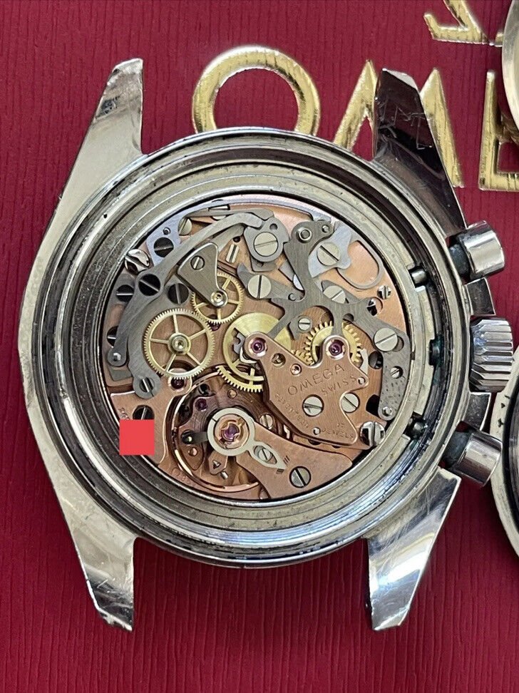

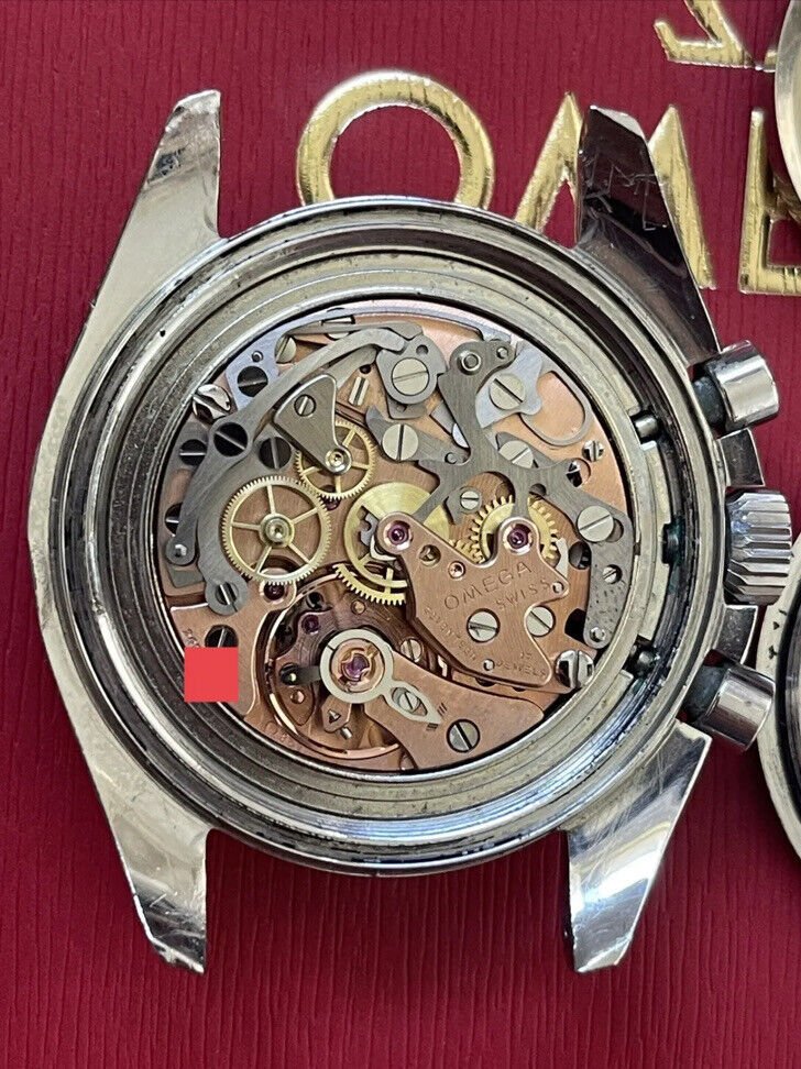

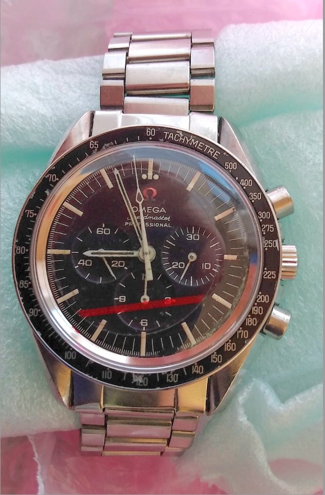

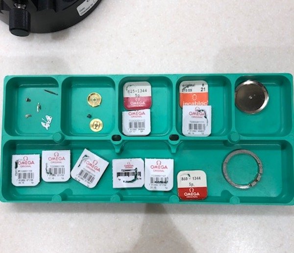

The internal watch repair using Omega parts:
The finished repair:
Internal Shot after repair:

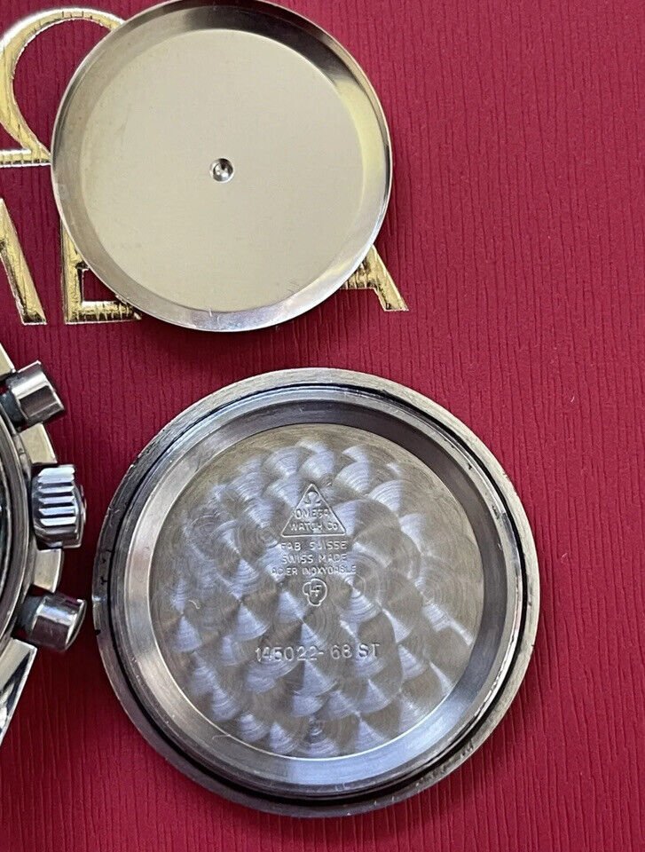

Case back (inside)
