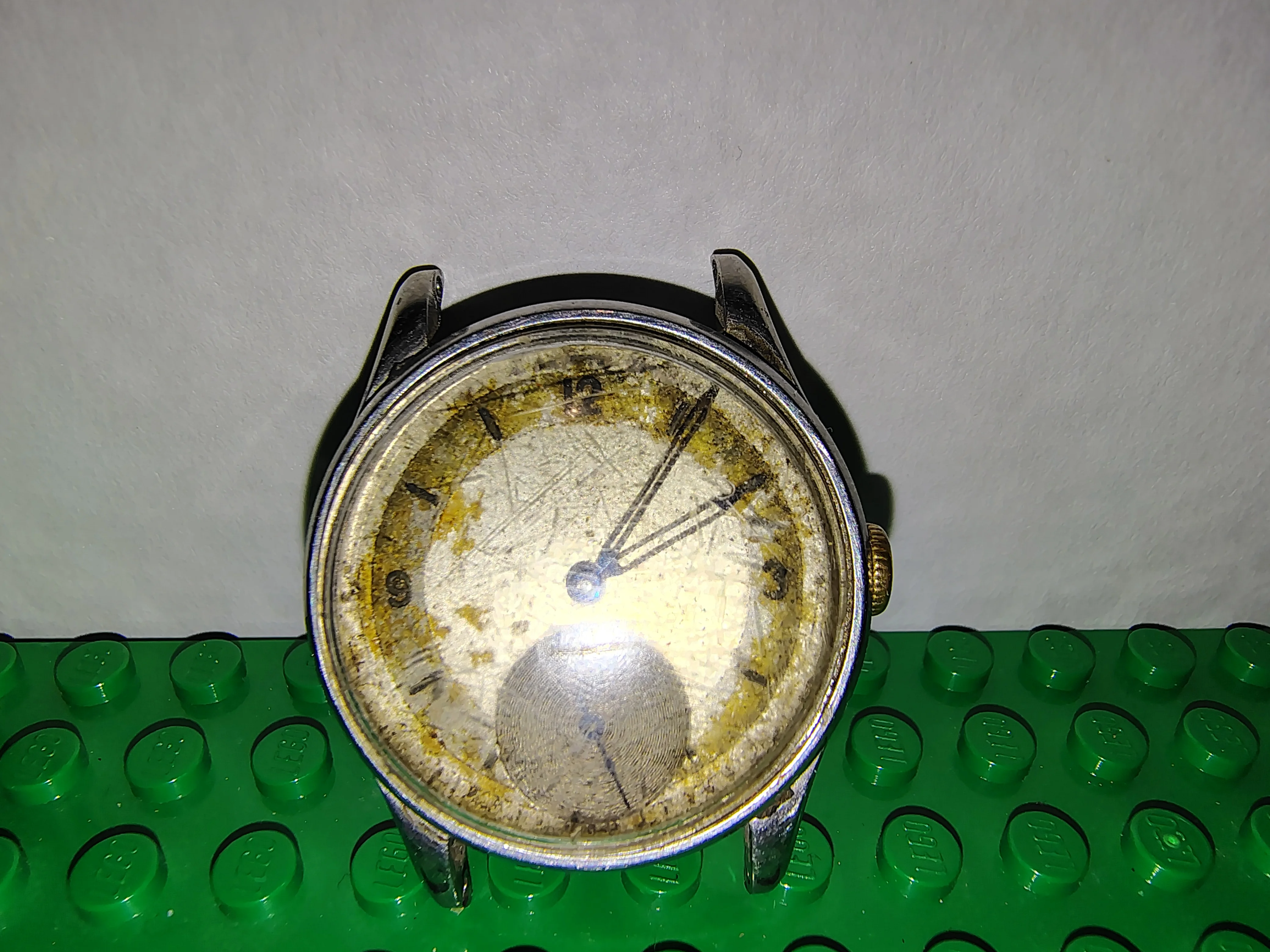

Hello again Omega Forums!
I made a post previously about what I thought was a score; vintage men's omega from a local antique shop that I assumed I could easily get a case back and mainspring for. It became very clear I was incorrect, with springs being scarce and case backs unique. Well, I was bored the other day and sifted through them again at the shop and found another!
The dial is absolutely ruined. If you set the time around 2-3 o'clock, there's a scratching sensation, and the watch works well until the minute hand reaches that same area.
The case back was slightly off when I purchased it which was how I could tell it was an Omega. No signs on the front nor markings on the back, but there was an Omega movment and stamp inside. I pushed the case back down properly so it wouldn't come off in travel but there's no grooves to get it back off! Marks suggest the previous owner had a few attempts too.
Given it works well, I'm considering sending this off to Omega. Do 1930s/40s Omegas get the same dial replacements that people are often so cautious about? It can't possibly get any worse.
Any food for thought or ideas would be appreciated. I'm also considering a light brown leather/calf skin strap.

My overriding thought is why on earth would you consider sending such a watch to Omega for service? Even in the unlikely event that they would accept it, the "service" would be extremely expensive, and you would end up with a replacement dial.
Beyond that, when you say "No signs on the front nor markings on the back", are you referring to the case back? If there are no markings, then would not be original.

Sorry, meant the "Omega" is missing from the dial. It wasn't until the case was opened, that I realised it was an Omega.
I'm hoping they would replace the dial - it looks like the minute hand is bent at the tip, but it catches on the dial around 2 and 3 o'clock. The dial is beyond saving I thought?

The condition of the dial poor, of course, and I'm not suggesting that it would be a mistake to replace it. But:
a) you could find a good independent redial artist who would charge less, and probably significantly less than Omega
b) it is not uncommon for manufacturers to insist on refurbishing everything, rather than simply replacing a dial, and that would be very expensive
Beyond that, it generally makes no economic sense to fully renovate a vintage watch that is in poor condition. Much better to wait and purchase a better one, that requires little, if any attention.
