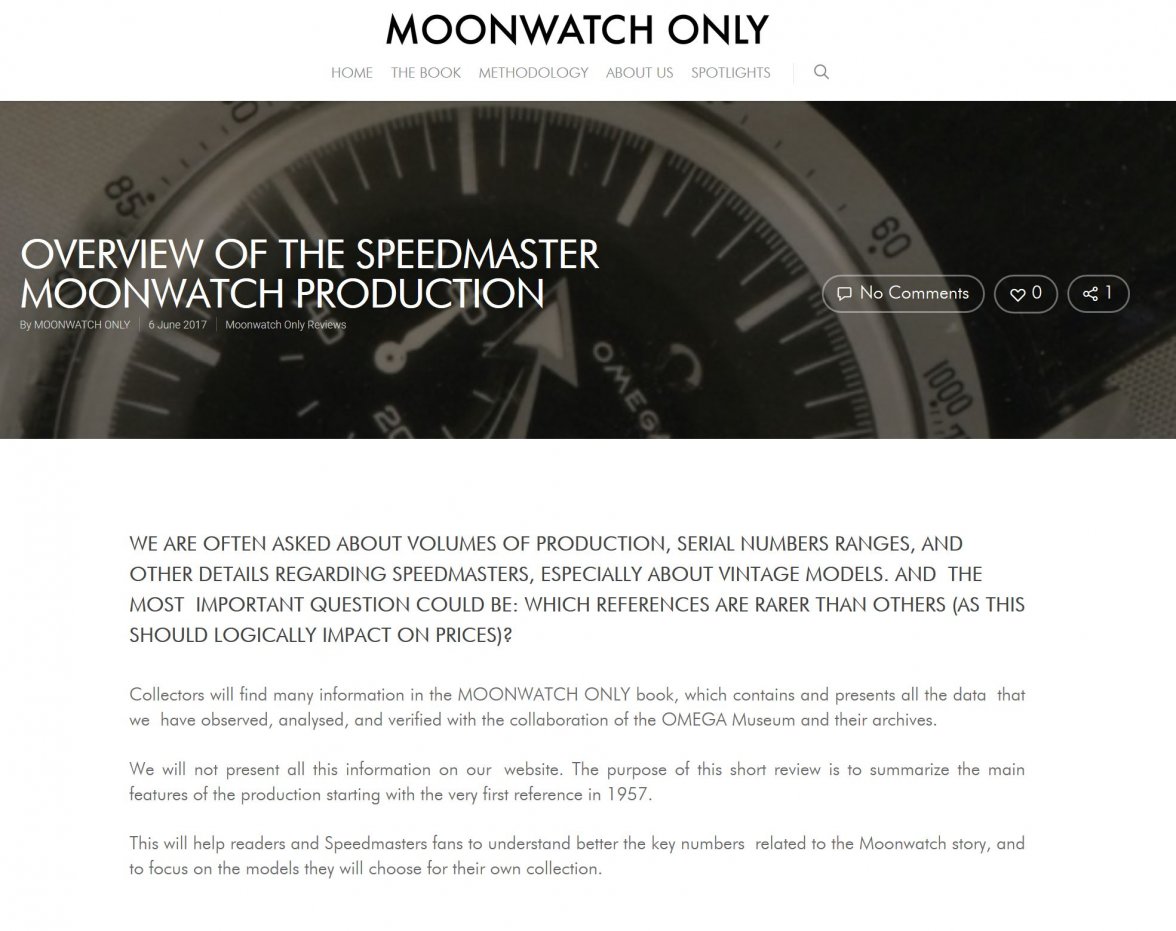

Speedmaster production and serial numbers from the MOONWATCH ONLY website

In a 2007 50th anniversary press release Omega stated 330,000 Speedmaster Professional watches had been produced.

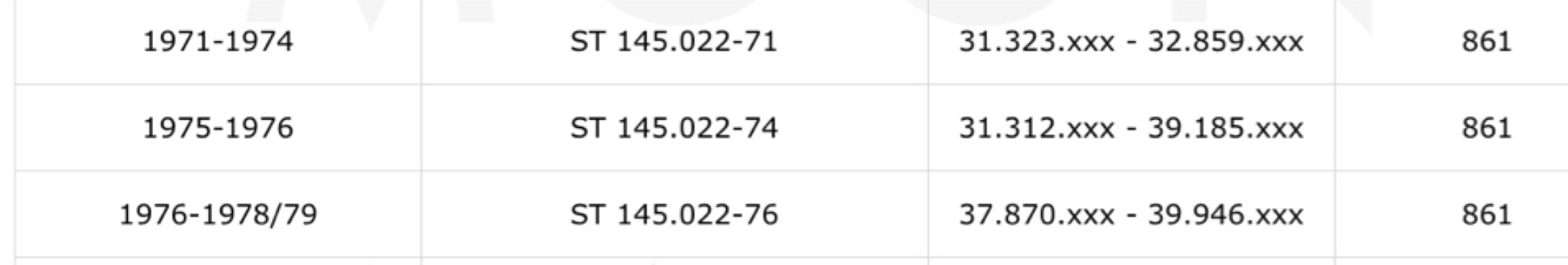

Could you explain the following:
For a simple amateur like me the numbers in the table for the 861/1861 calibre for the periods 1971-1974 and 1975-1976 (145.022-71 and 74) seem to be overlapping/mixed/inconsistent.
Did Omega mix up their production numbers or where does this stem from?
1,319
6,017
Isn't it bizarre that the serial numbers between different models overlapped so much?
eg
Now, there are clear differences between the 71, 74 and 76 models; in fact, I have a 71 that's 31617xxx and a 74 that is 31326xxx - but they presumably wouldn't have overlap between the production of the different models, so they must just have been stockpiling movements and using whatever came to hand from the warehouse...?
Yep, it seems it was a mess during that period. When we started collecting s/n, we thought at the beginning that such overlapping was the result of frankens, but now enough examples have been observed (e.g. 145.022-74 in 31 million) to validate them as genuine and coherent.
