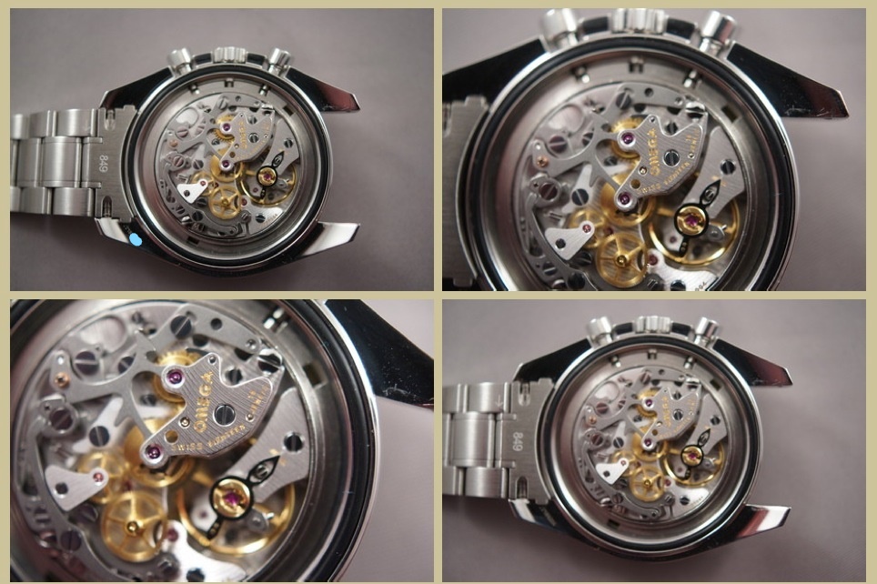

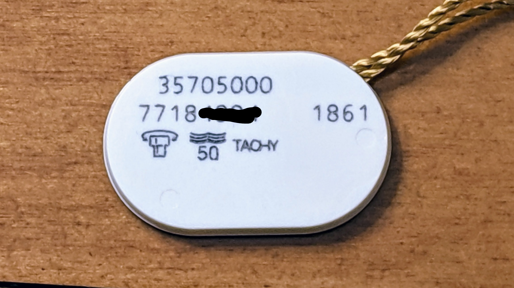

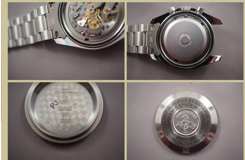

  4. dornier Nov 22, 2018
    9
    Here are some photos of the watch. Thanks!

  5. padders Oooo subtitles! Nov 22, 2018
    8,993
    13,941
    There is a hang tag on those photos, that will give you model number. Is it a 3570.50 or the sapphire crystal one? I can’t tell from those. Either way it looks fine for an early 2000s model. What is your concern?

  6. Foo2rama Keeps his worms in a ball instead of a can. Nov 22, 2018
    17,106
    25,350
    Watch luminova dial dates post 1997 so the “double” case back matches as 145.0022 is the part number for the case. (In the old system) generally these are referred to as 145.0022 or PIC code 3570.50 or rarely 3870.50.
    These started in 1996 with Tritium and got luminova in 1997.
    345.022 matches the “new” reference for the watch with steel Bracelet which also has the pic code 3570.50 which then became 311.30.42.30.01.005 in 2014.
    Another way to look at it was omega made the 145.0022 on leather and the 345.0022 on bracelet as was the numbering system at that time. The watch hits right at a transition in how Omega did reference numbers.
    Made from 1997 on aka the current reference.
    1861 movement dates it to post 1997 also. The real rare one is this watch with Tritium and the 1861. Very short overlap.
