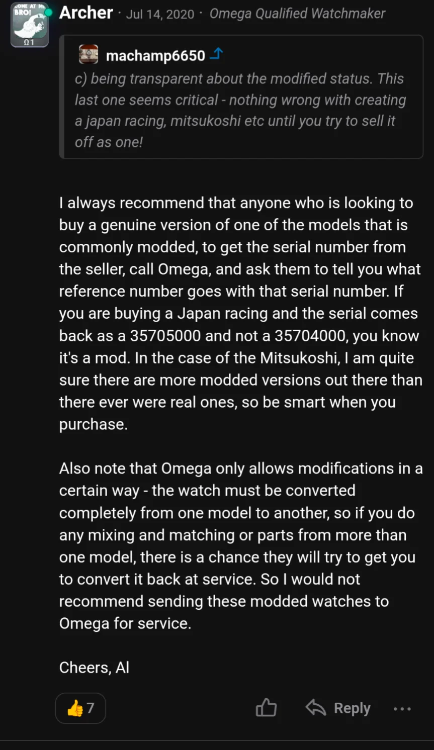

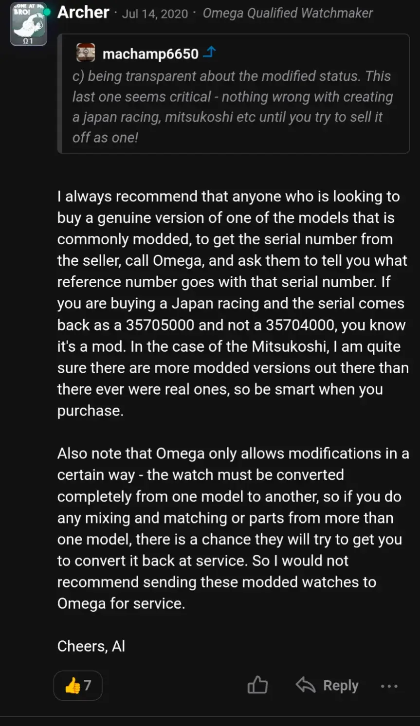

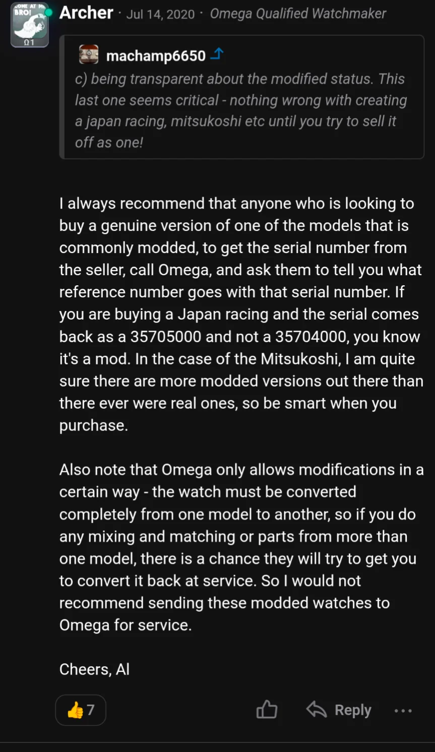

So to ask the question a different way, what happens if an older reference is sent in for service? Are there opportunities for the service center to flag discrepancies in conformity and/or originality, or no because their primary focus is getting the watch back into good working order?
Check this post regarding modifications:
