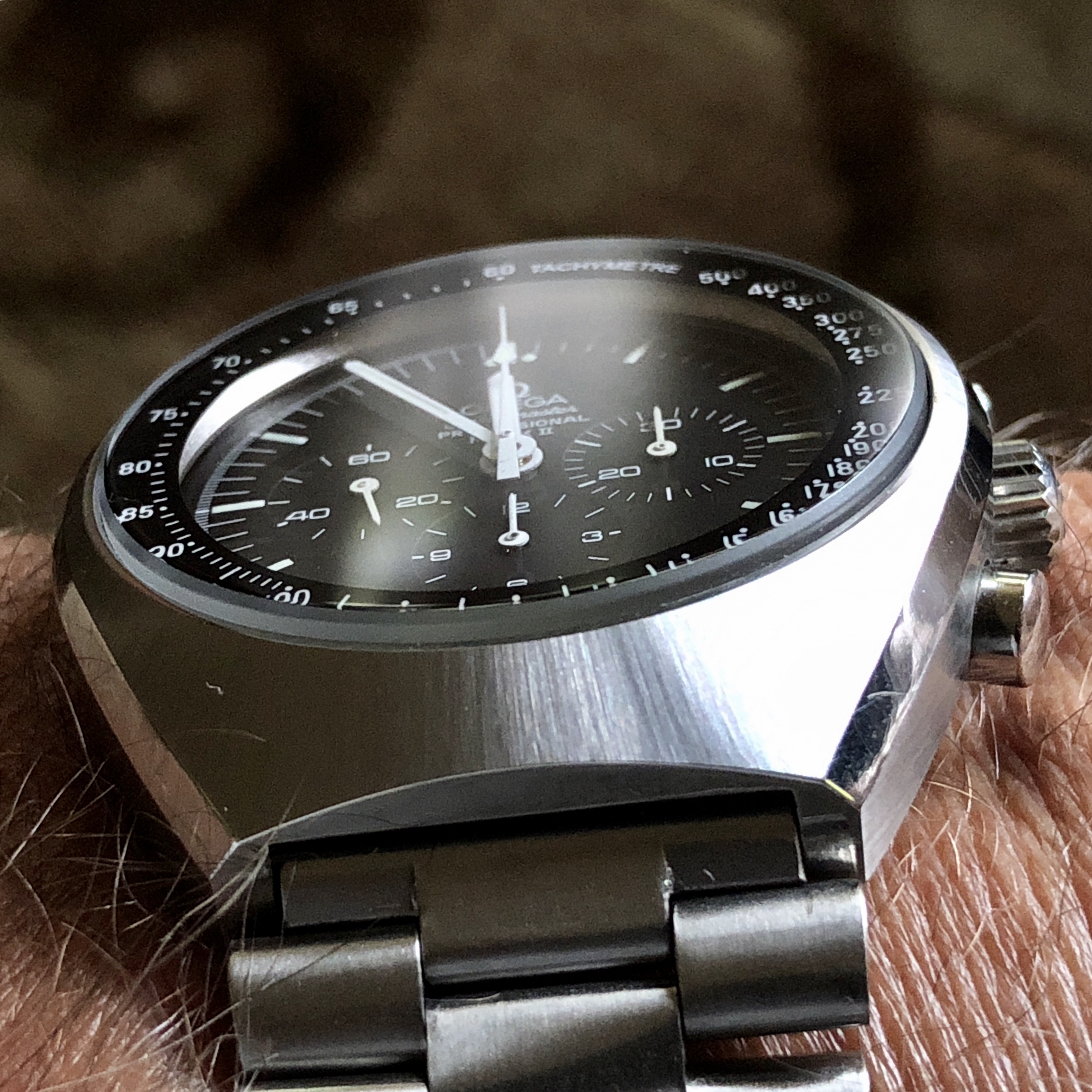

Hoping some of the vast knowledge base here might be able to give me some advice.
I'm relatively new to the watch world, but recently inherited this vintage Speedmaster Professional Mark II from my Stepdads estate. I'm wondering what the pro's (you guys!) think about it being restored.
It has sentimental value obviously, but I'm wondering if its even viable to pursue restoring to make it a daily wearer. I'm willing to spend up to $1000USD for the restoration if it would bring it back to a presentable (used - not pristine) piece. Stepdad was a highschool shop teacher for 30 yrs... and I'm guessing this saw the majority of those classes. It shows.... Rarely worn in the last 15yrs though (after retirement) but all functions seem to work. Sadly I have no documented service history or anything like that.
I'm guessing at a minimum it needs: full inspection, new crystal, new sealing kit, possibly new case (maybe salvaged with new lapping?), oiling and setup?
From my VERY uneducated inspection. it appears:
- Time function is ok - Very basic 24hr test against phone stopwatch was within 10 seconds.
- Chronograph function/stop/reset is ok, but haven't timed it for accuracy in any way.
- Crystal O-Ring appears to have degraded, leaving a weird distortion on the Tach ring. I read the Tach detail is printed onto to the crystal in these 70's models?... does that mean I'm screwed? (please correct me if I'm wrong - very new to this!)
- No sign of water damage/ingress... but can only imagine all the seals need replacing
In the right light its potential is more obvious...
Again, apologies for my newbieness in this post.. but any advice would very much appreciated!
Thanks!

hi and cool watch. anything can be fixed so best is get some estimates from watch makers that have an omega account so the crystal with inner printing and other parts can be gotten, along with an estimate for the mvt service and work. Don't go too crazy cosmetically restoring the watch as the more you replace the less it's the same watch 馃榿

Hello and welcome!
If I get you right, it's important for you to bring your Stepdad's watch back to life. So it's a sentimental task. Your given budget sounds realistic to me and if you don't compare the costs to the market value, everything will work out fine.
I think the watch has the potential to bring it back into very nice condition. It appears the case hasn't been refinished, but only heavily worn, which is very important. I believe the case can be redone up to very good condition. The caseback looks good, which is fine as well. By the pictures, I can't tell anything bad about the dial.
So maybe you should have a service of the movement and gaskets, an expert refinishing of the case and bracelet, add a new crystal and a new set of hands. In my opinion, this would turn out to cost about what you suggested.

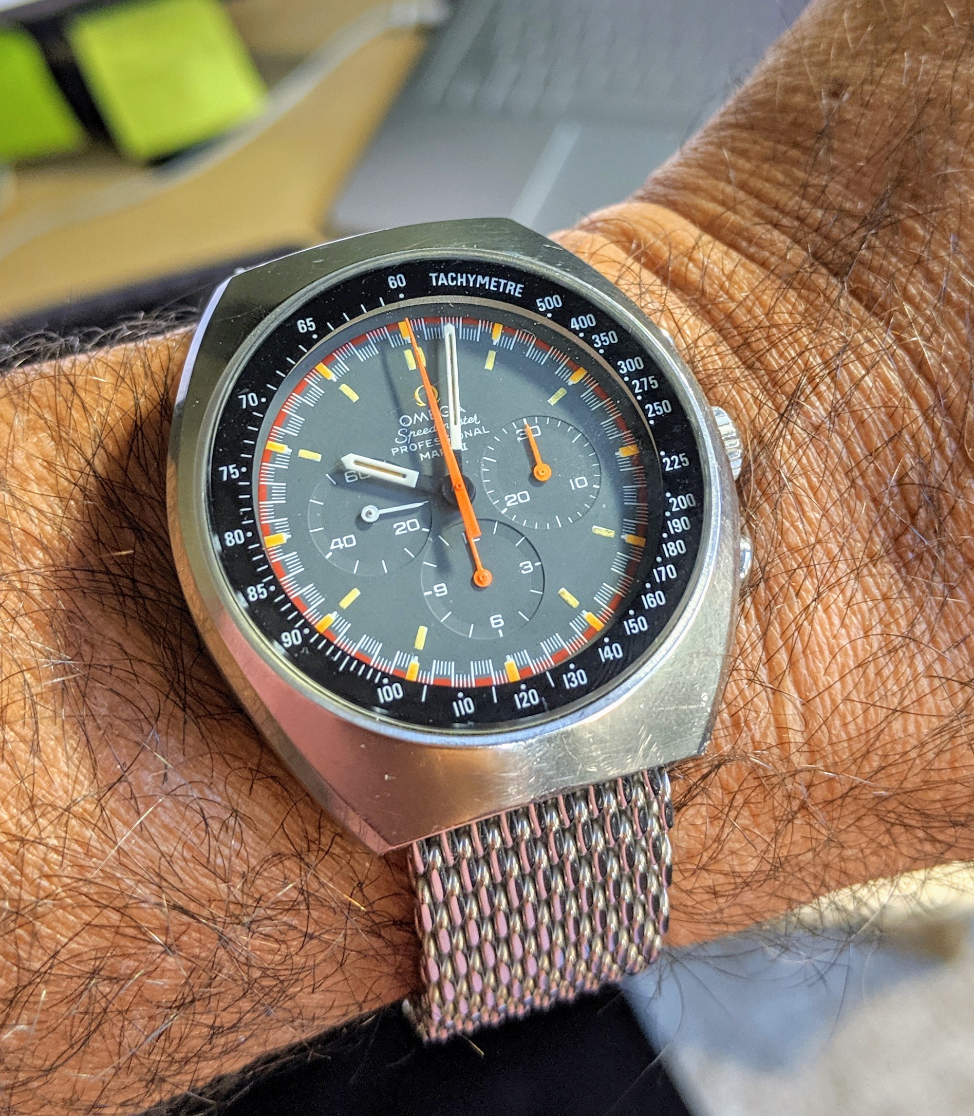

You can follow my adventure here,
https://omegaforums.net/threads/racing-dial-mark-ii-back-from-omega-restoration-service.19381/
I still love the watch, but it's far from vintage at this point.
I would caution you to think twice. You may find that bringing this one back will cost more than the watch, and for a bit more, you could get one in far better condition.. I've put more money into this watch than its worth, but I'm ok with that. It was a valuable lesson for me early on.

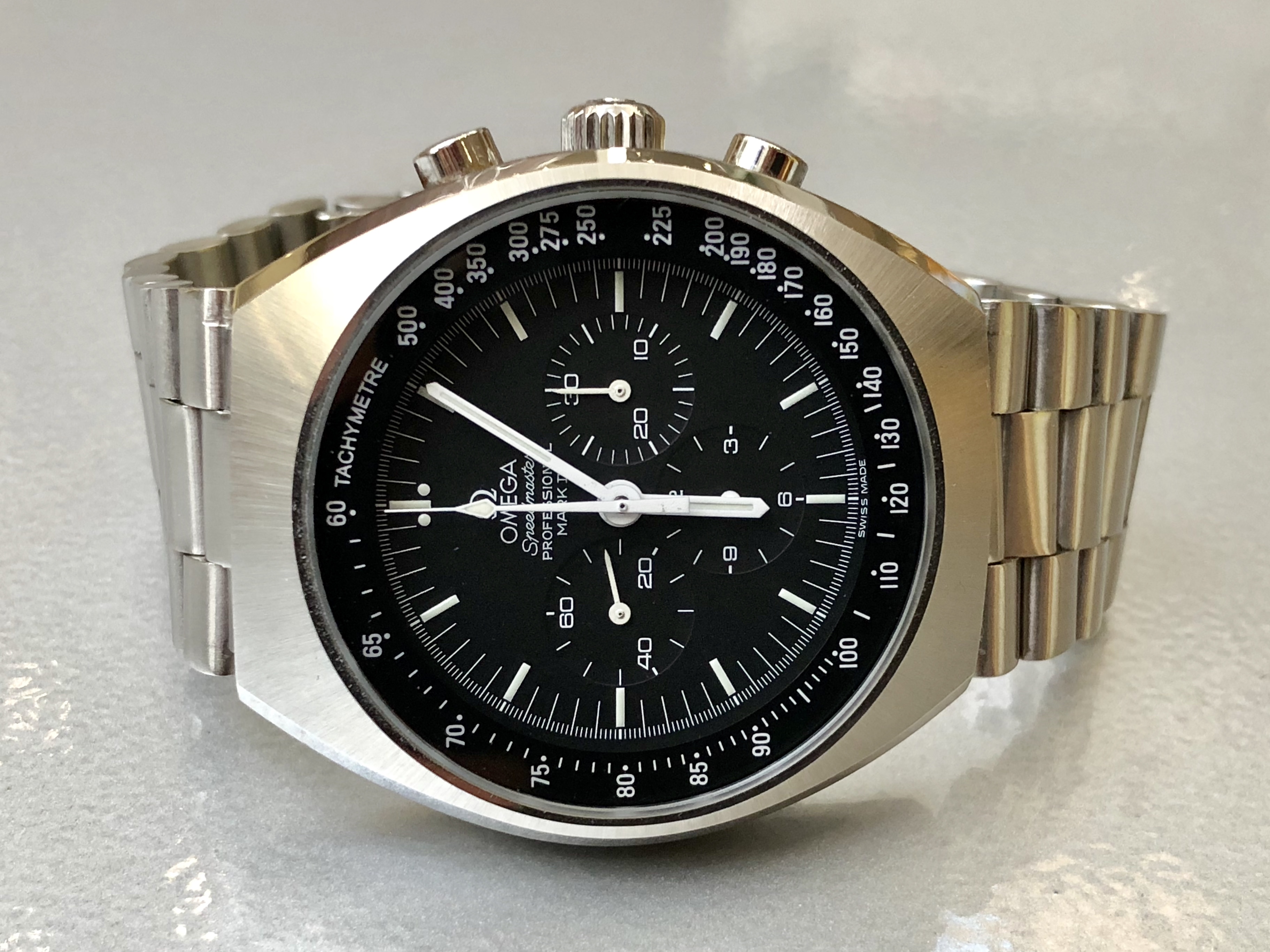

you would be surprised how much nicer that watch will present with just replacing the crystal and a good solid cleaning of the case and bracelet. with a clear and unblemished crystal that watch would look presentable on the wrist. Close-up pics like those in this thread don't really translate to how a watch appears when on the wrist. Going too far in a cosmetic resto will wipe out all the watch's history. i always go for "Sympathetic" restos and try to keep our stuff as-found as much as possible.

Damn it.. your restoration looks great!!! Thinking you are right though... a full restoration probably isnt right for this guy.
