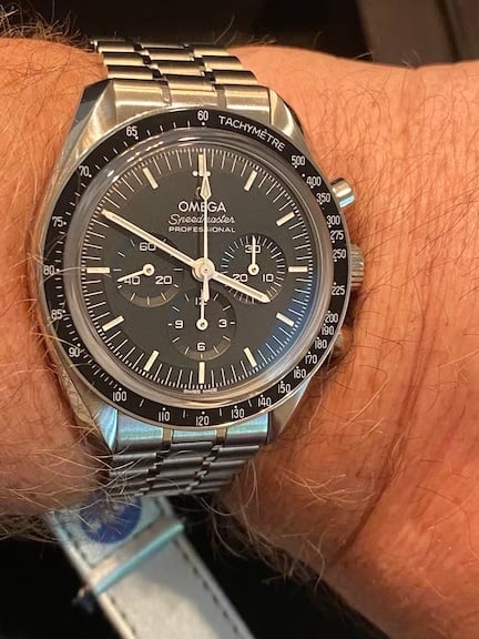

I purchased my new moon watch with the 3861 movement on Sunday 8/22 from an AD.
On Monday at around 7:30AM I gave it what I thought was a full wind (in hindsight it very likely wasn't), then at around 10:30AM I decided to start the chronograph and let it run. The movement stopped at around 10:30AM Tuesday morning running approximately 3 seconds fast. Chronograph ran fine with no issues for the entire 24 hours. One interesting note is that I happened to notice within a couple of minutes of when it stopped and then as I was taking it off of my wrist I noticed it started again and ran for about another 10 minutes before stopping.
I waited until noon on Tuesday to give it another full wind and see how long it would run. This time I listened to the "clicks" as I was winding and just kept going until I didn't hear clicks. I also confirmed that my fingers were slipping on the crown by the orientation of the logo on the crown not changing after I was at a full wind mechanical stop. It ran 64 hours and 10 minutes, having stopped at 4:10AM on Friday morning. I noticed what time it had stopped after I woke up, and when I picked it up it started again and ran for about 10 minutes and then stopped. I had checked it at the 24 hour and the 48 hour intervals for accuracy: 3 seconds fast at 24 hours and 5 seconds fast at 48 hours.
On Friday at 8:00AM I gave it a full wind and again confirmed by the absence of "clicks", and the location of the logo on the crown, that I was at a mechanical stop. I also started the chronograph at 8:00AM. As of this moment (8:15AM Sunday) both the chronograph and regular movement are still running. This time though it's running faster than on the previous winds: 2 seconds fast at 12 hours, 4 seconds fast at 24 hours, 6 seconds fast at 36 hours, and 8 seconds fast now at 48 hours.
I will post again this evening or tomorrow with the statistics for this full run with the chronograph moving the entire duration.

Update on running with the chronograph going: ran for 57 hours and 4 minutes with the chrono "on" the entire time after a full wind; once I noticed that it stopped I hit the chrono "start/stop" button to disengage, and it started up again and ran for another 7 hours and 8 minutes before stopping. So total run time was 64 hours and 12 minutes. (I picked it up and hit the reset button to zero-out the chrono and it started up again and ran another 9 minutes)
I learned a long time ago to not draw conclusions from data sets where n=1, but I'm trying to wrap my head around the fact that when I did not run the chronograph the total run time was 64:10, and when I did engage the chrono and it was consuming energy stored in the spring for 57 hours it still ran for a total of 64:12 (statistically the same as 64:10). Has Omega been unwittingly manufacturing the foundation for the ever-elusive perpetual motion device all these years?
The accuracy on this recent run with the chronograph engaged resulted in consistently running 4 seconds fast per 24 hours.
99
186
Summary:
For anyone who's maybe still a little concerned about "over-winding", I'm confident that winding with a "finger-tight" grip on the crown until it hits a mechanical stop and just won't turn any more (you will stop hearing the clicks too) has not caused any damage to my Speedo. This is my first expensive watch (unless you count a $350 Citizen Eco-Drive quartz as "expensive"), and I have no prior experience with a winding or automatic watch, so I'm a total novice at winding and I still didn't screw it up.
Running a "full wind" all the way down without engaging the chronograph resulted in a life or 64:10 and running fast by an average of 2.5 seconds fast per 24 hours.
Running a "full wind" all the way down with the chronograph engaged resulted in a life of 57:04, and then when I hit the chrono start/stop button again it ran for another 7:08 (64:12 total), and running fast an average of 4 seconds per 24 hours.
I'm inside another "full wind" and it's running about 1 second fast after almost 11 hours.
Again, I know better than to draw conclusions from a data set of n=1, but can anyone tell me if it makes sense that the watch would run faster (4 sec / 24 hrs fast) with the chronograph running than without the chrono running (2.5 sec / 24 hrs)?
