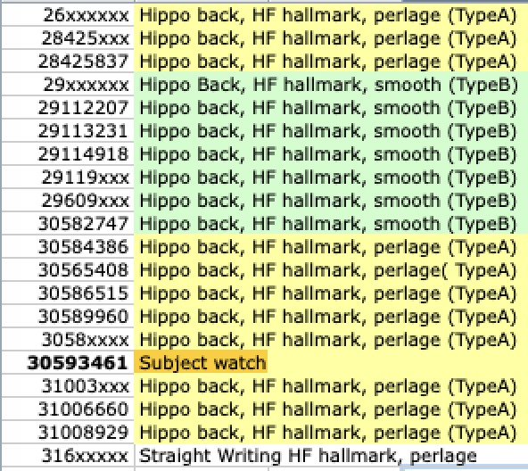

I understand the seeming "late-game" nature of a hippo back here with a 32.8M serial but the smooth interior (no perlage) is another aspect that caught my eye.
Don't know if helpful but here is a small sampling I did to determine what to hunt for with my own -69 ("Subject Watch"; still no luck). The last of the hippo backs before SW seemed to have perlage and SW took over earlier than 32.8M. Crude data with lots of gaping holes, and I'm sure there was some variation, but perhaps more consistent as a type B caseback from ~29M-30.58M range or other replacement?
