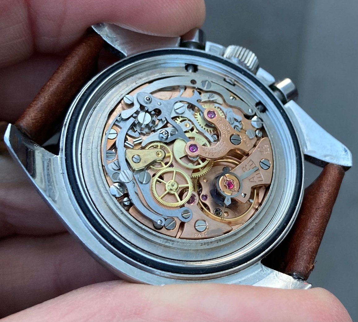

Hi guys and speedies’addicted !
i’ve been caught by the speedie mania for few months now and after my hunt, I found what could be my first speedie, in a possible interesting vintage spécimen. The watch is presented as a 145.012-67, with a « not so bad » but original DON bezel, an AML step dial with close T and patina matching hands (drop second hand). UV shows an harmonious low lume, so not relumed dial IMO.
The caseback is unfortunetaly a service one 145.0012.
Caliber is a 321 24.591.xxx.
After I’ve readen several opinion from several tables, i am a bit confused.
Serial matches w/145.013 as well as 105.012.
Dial is definitely a 105.012 one and ni réa son to have been replaced.
Before asking OMEGA an EOA to valid the watch UD, whatsapp is your general opinion about this deal before a quite expensive decision ?
Thanks at all !

24.591.XXX serial should be a mid/late 1967 105.012-66
