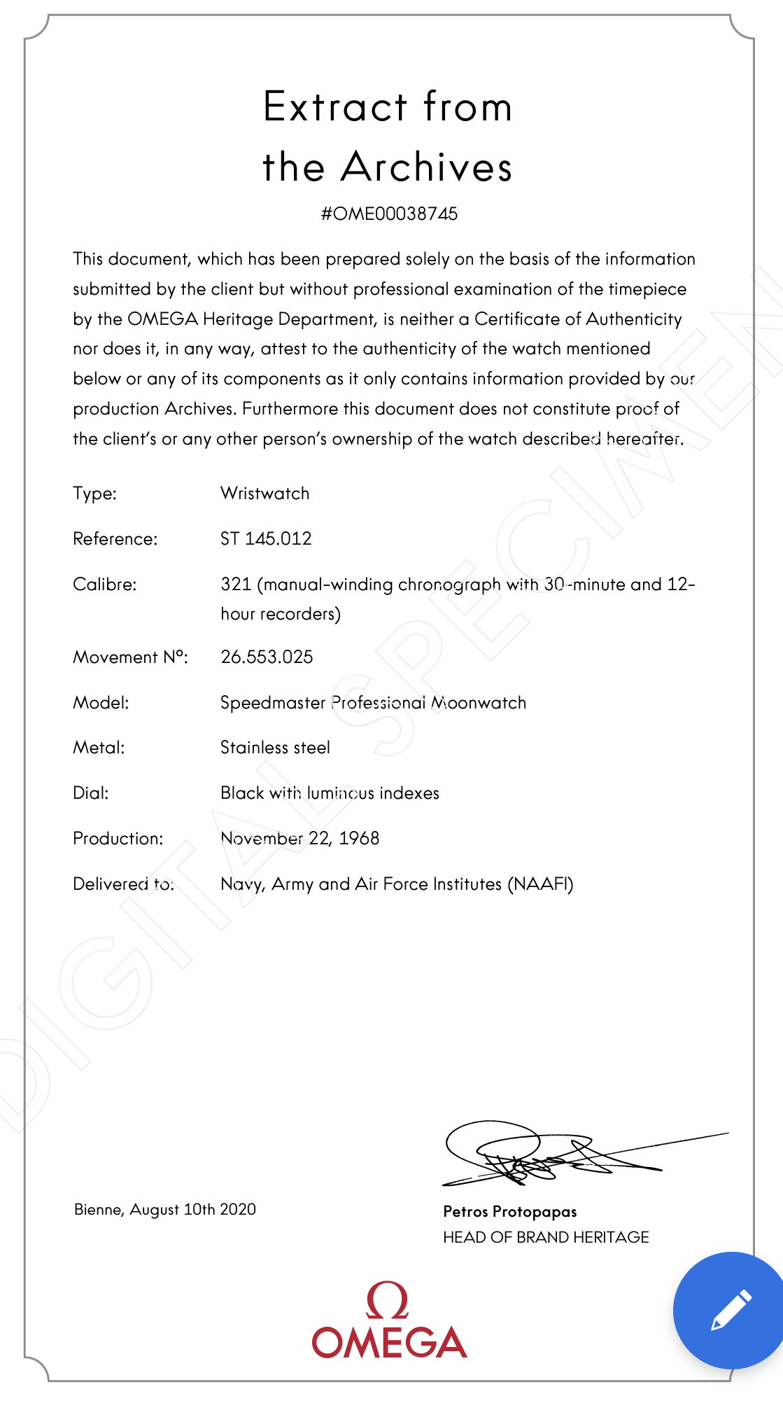

On another subject, is there any value in getting an archive extract from Omega?

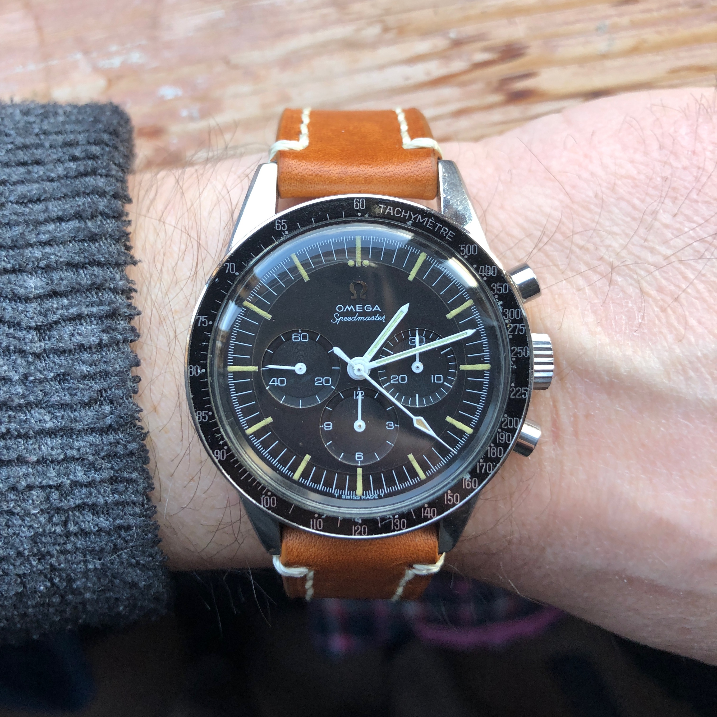

Probably not a lot, you already know most of the history the extract provides and they aren't cheap. It will likely say that it is a 145.012 produced (based on the serial) around Sept-October 1968 and delivered to the NAAFI. It won't mention the year iteration (ie the -67 in the caseback) they never do, or anything else all that exciting unless it originally came with a Racing dial that is (which is very unlikely). It is out of range for an Ultraman so it most likely won't say that either.
The EW I show above was also NAAFI delivered and shows that on the extract. It doesn't say anything further about delivery location.

Nice watch. After Simon cleans it up please post a picture of it ... I'd really like to see this after shot.
Enjoy the watch in good health and I commend your dads exquisite taste !
Thanks. I might still get one as a memento for my father, as I鈥檒l be keeping the watch! The watch in your picture is stunning. I hope mine ends up looking half as good!
