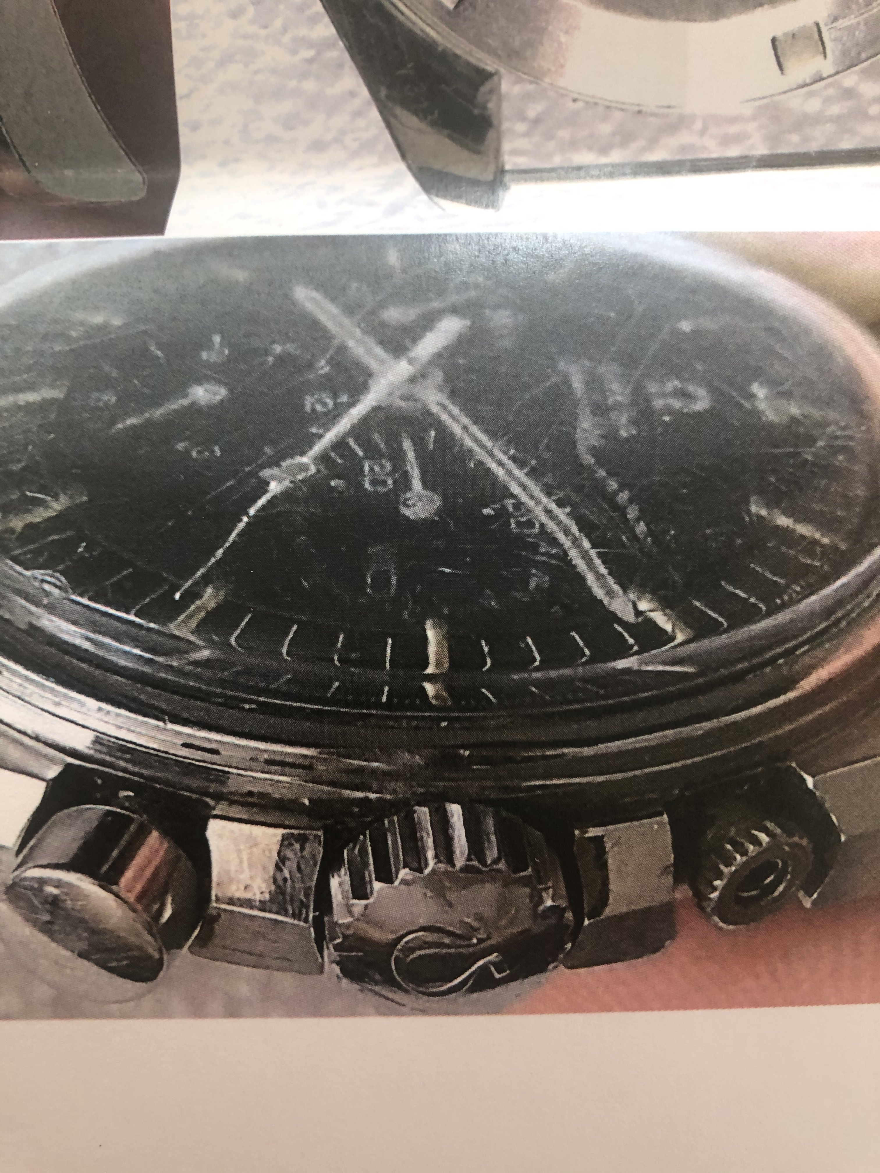

No real sentimentality involved but if it’s likely to affect the value then I’ll get it back.
18,326
27,695

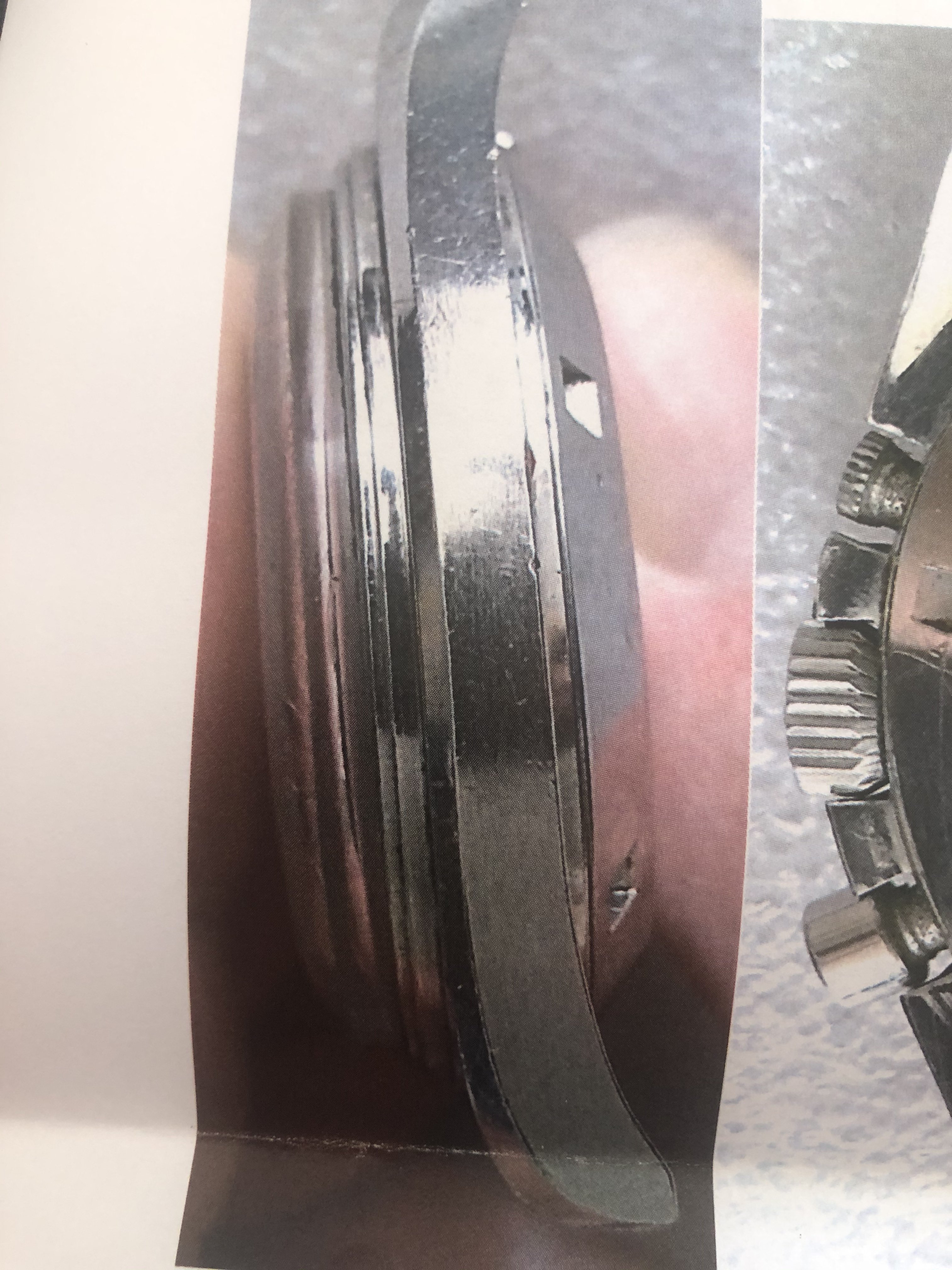

Most definitely will. Unless there are very very specific notes in writing not to touch the dial or hands or case during service. Like all Swiss watchmakers they will attempt to bring it to new functional spec. Which means new dial and hands which will ruin the value of this watch. They correct bezel is about 3,000 or more. They will put on a new bezel that you can buy for 100 bucks.
10,804
16,814
I am getting deja vu here. This the second watch this week where someone has asked about a family piece, got it opened by a watchmaker but not got a photo of the all important inner caseback markings and then sent the watch off to Omega leaving us all none the wiser and running the risk of being charged an arm and a leg to change bits that will negatively effectively the value. In this case, a new bezel is better than no bezel but if Omega feel the lume needs stabilising then the original dial and or hands may return in a plastic bag along with a hefty bill and new shiny ones fitted.

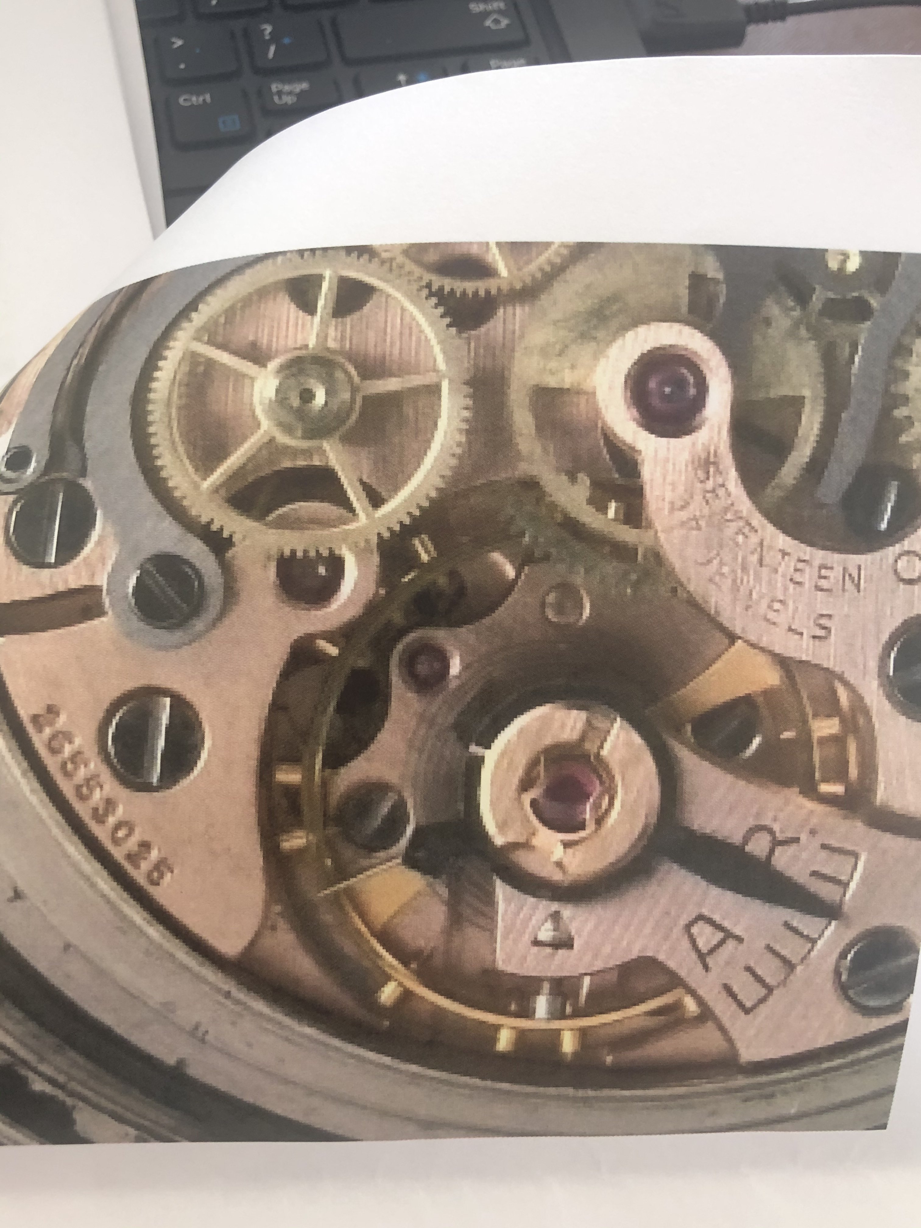

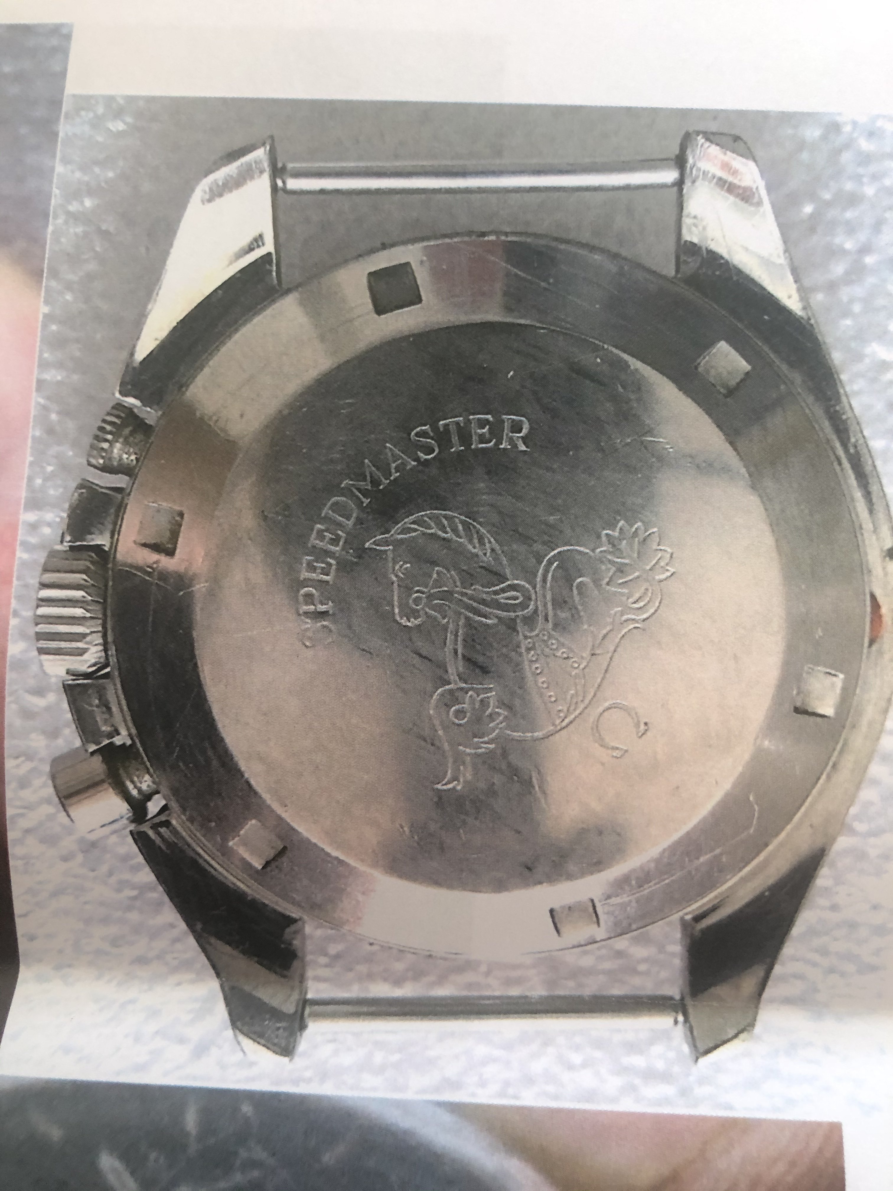

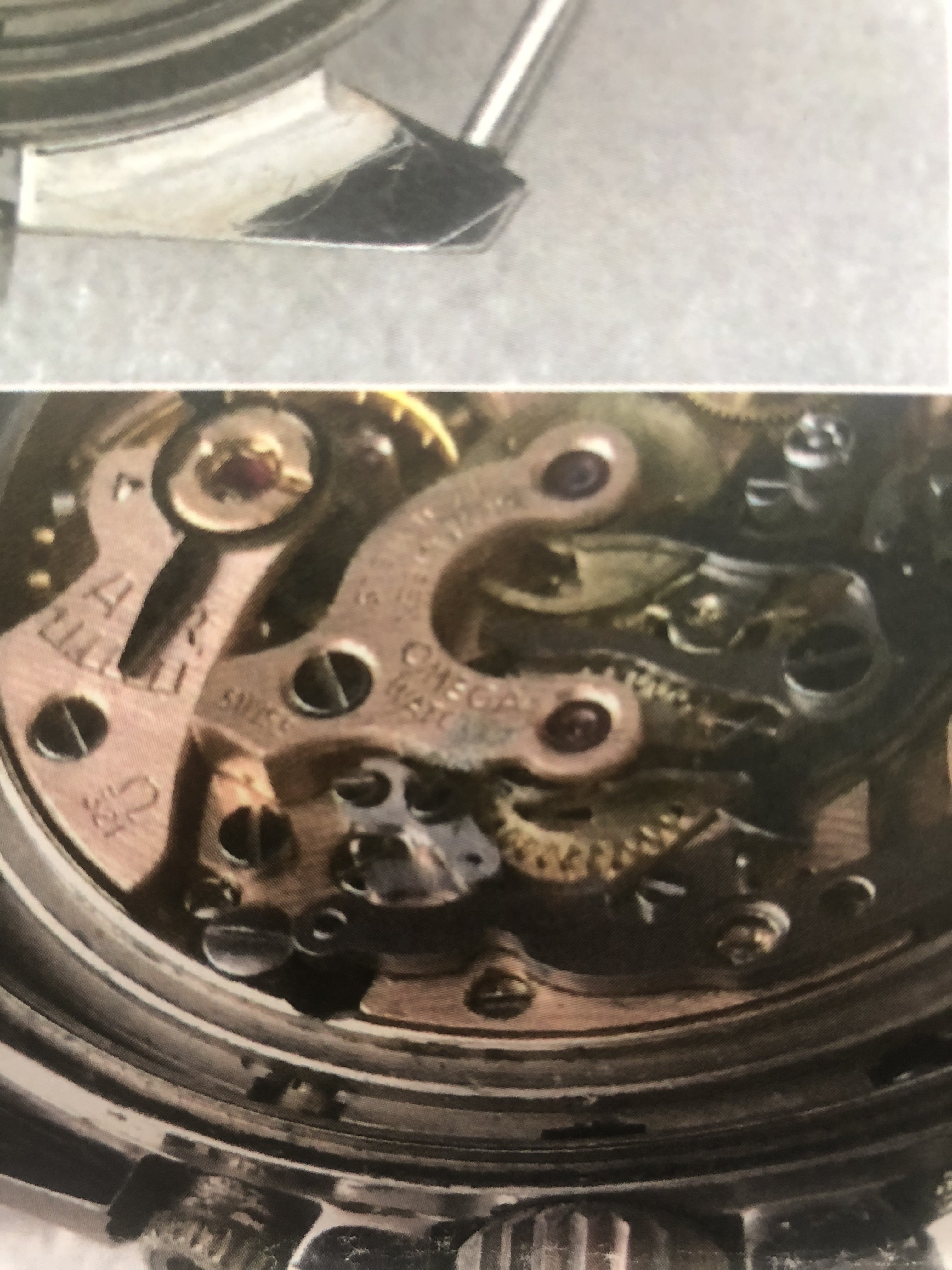

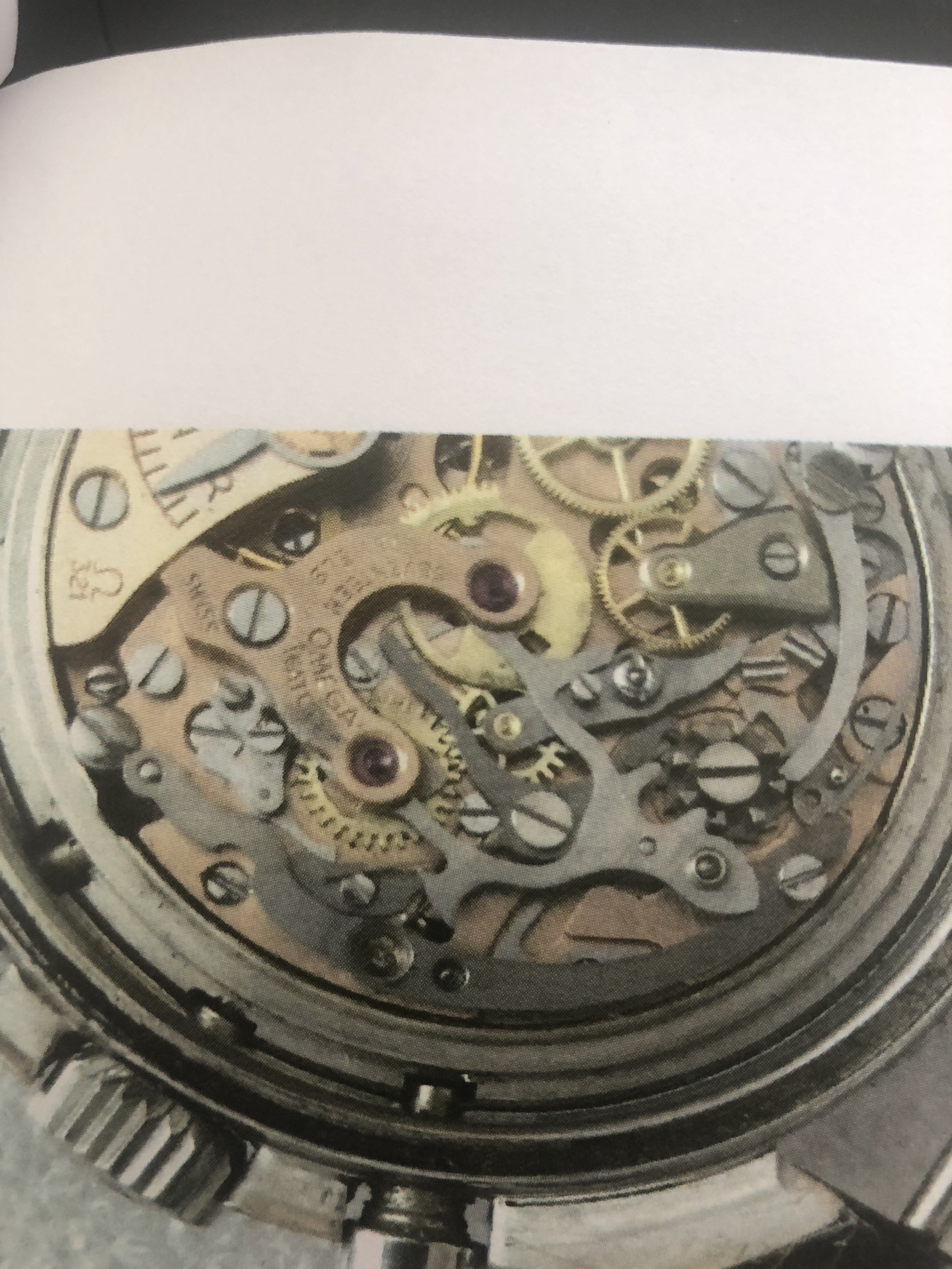

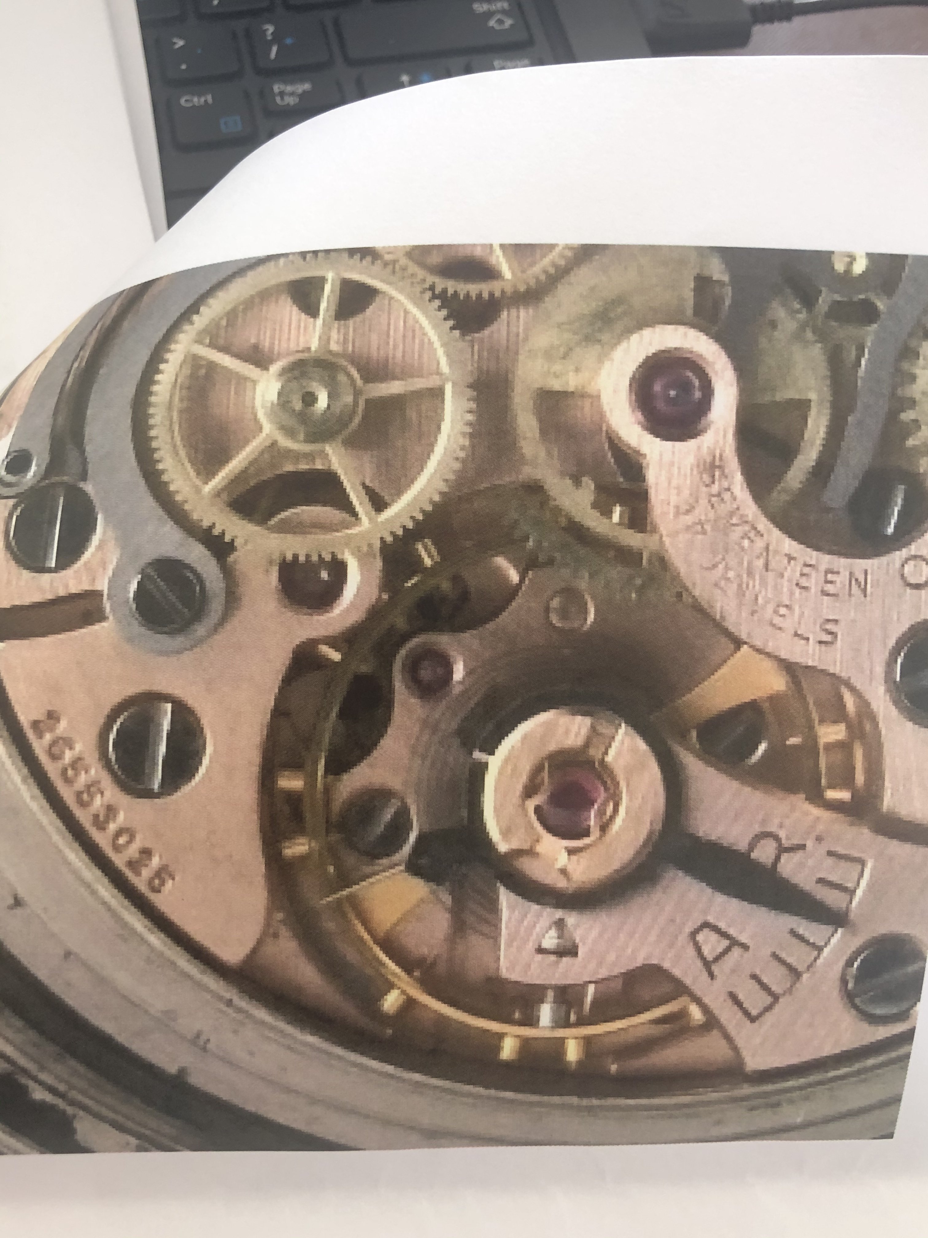

I’ve stopped the jeweller from sending the watch. He didn’t take a photo of the inner case back but I will ask for that now. He was able to give me the code off the movement which is 26552025. I believe this dates it to 1967?? Does it do anymore than that? What sort of marks should be on the case back?? Thanks for everyone’s help so far, appreciated!

No just the one starting 265. I’ve asked him to photograph the in side of the case back so will hopefully have that tomorrow.
10,804
16,814

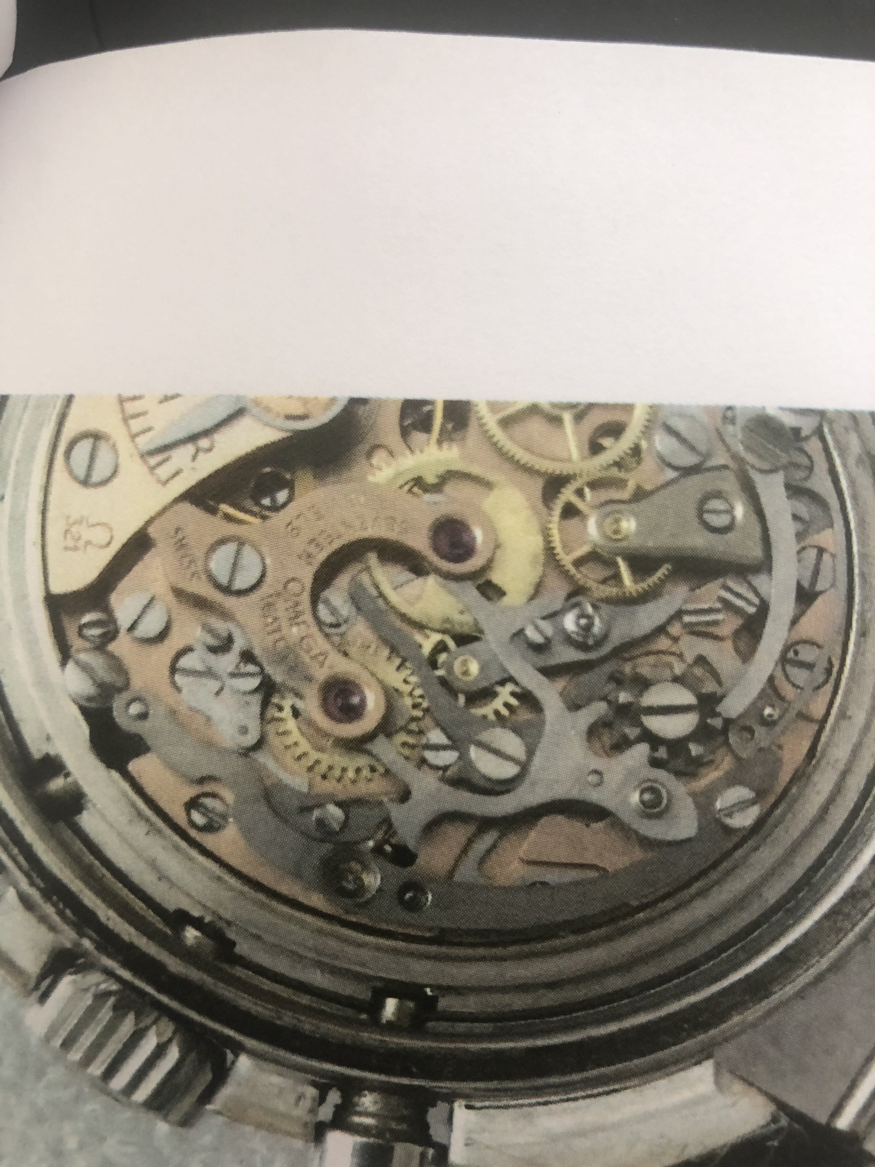

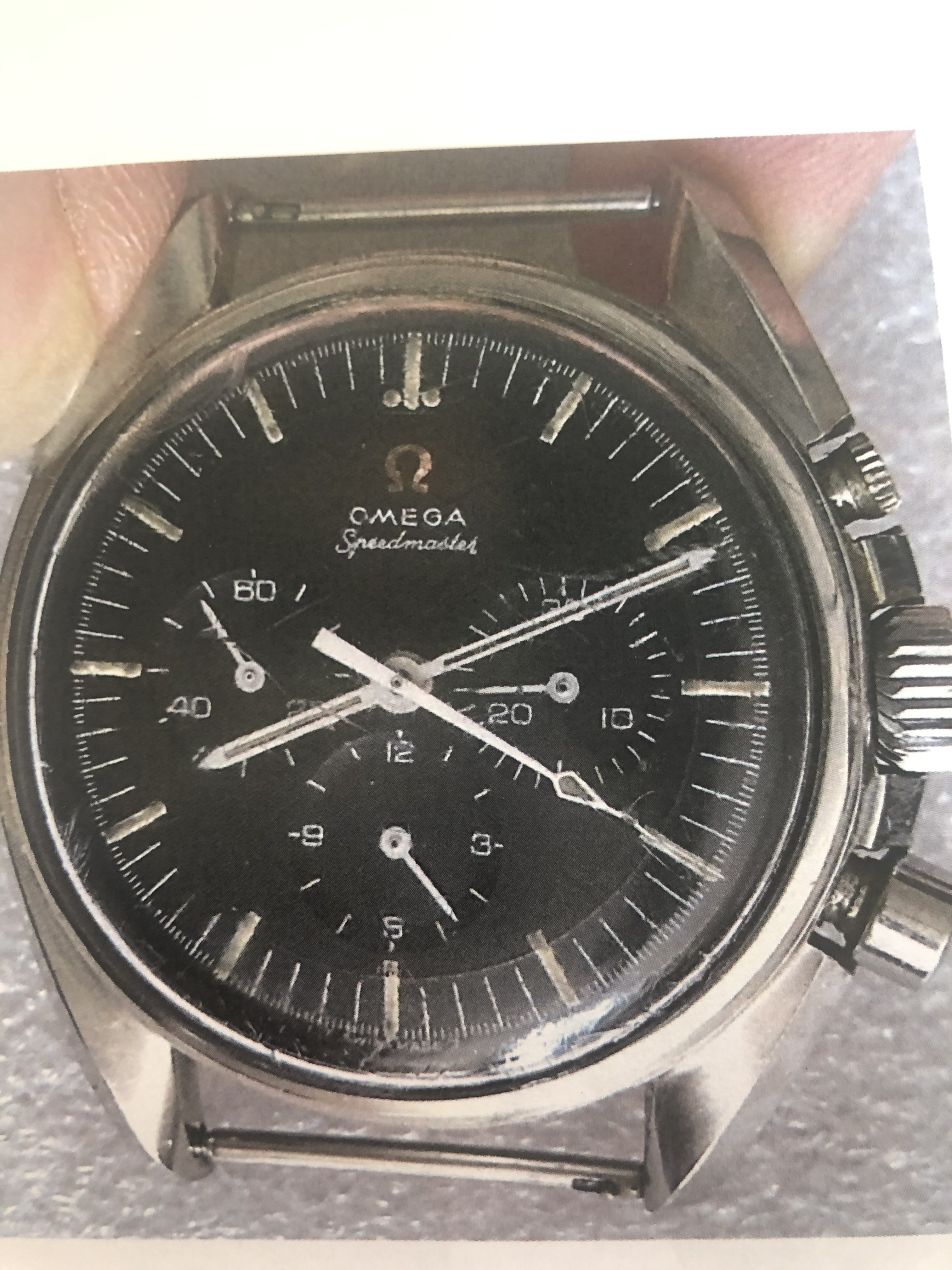

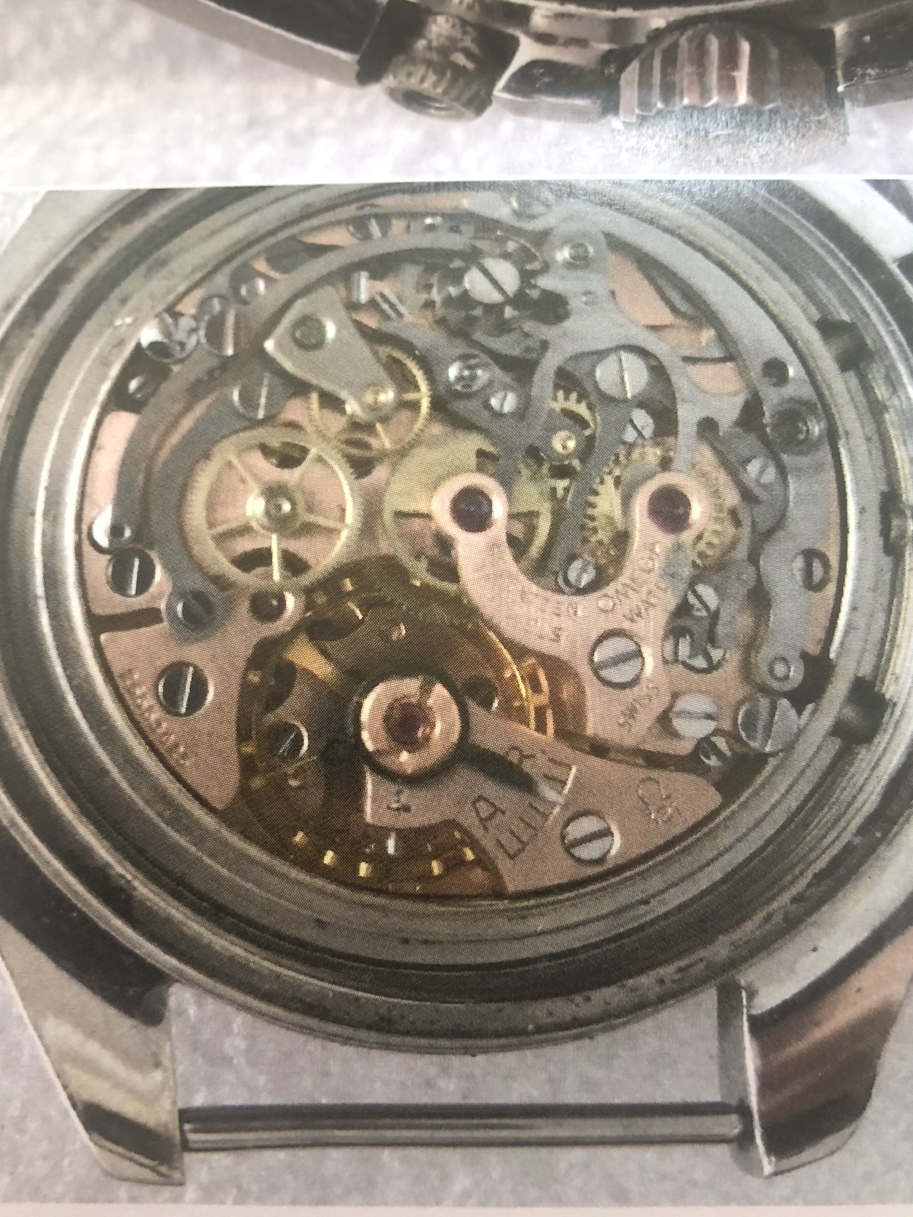

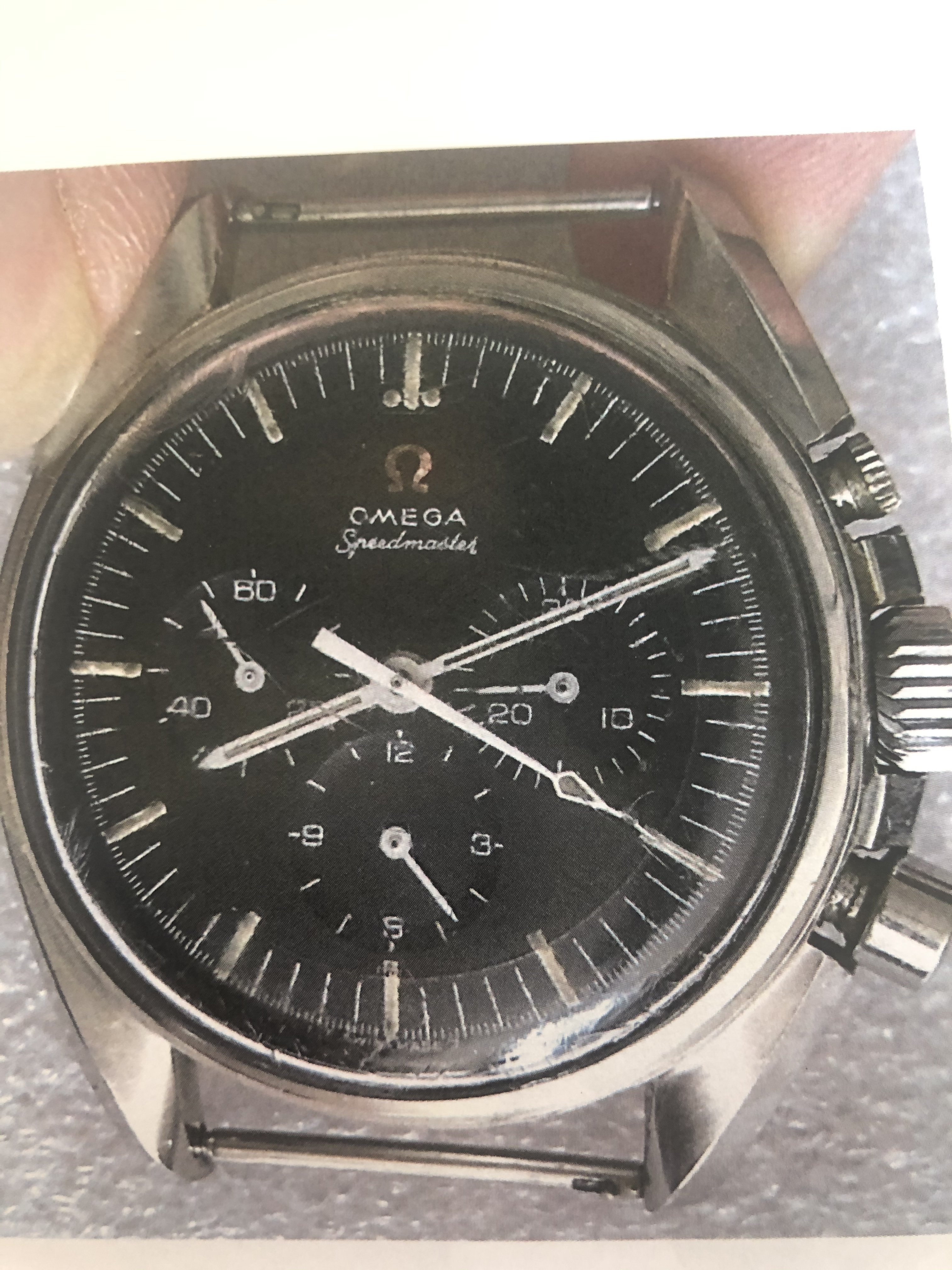

It'll likely be a 145.012-68, those are all 26,55X and have the flat bottom chrono hand. As already noted, the dial has been swapped for a 105.003 dial at some point in its past, hence the lack of Pro text. It will have been produced around Nov-Dec 1967.

It'll likely be a 145.012-68, those are all 26,55X and have the flat bottom hand. The dial has been swapped for a 145.003-65 dial at some point in its past.
That’s the confusing bit as my Dad bought it new and hasn’t had any work done on it. He broke it in about 1970 and it hasn’t been used since. The watch still keeps time but the stop watch is buggered. I can’t work out why it has an earlier face!

Its strange alright. Maybe it came that way and had already had work (would the NAAFI have sold a second hand watch?) or maybe he has forgotten that it had a service sometime in the '70s. Back then these weren't valuable or even fashionable and often watchmakers worked on several at a time. Parts from similar watches have been known to be put back into the wrong cases back in the day. Or maybe the original dial got damaged and the watchmaker found a suitable replacement.
The dial on it is valuable, maybe £2-3K or more. The problem is, the correct dial is only a little less valuable at £1-2K. I think the suggestion of finding a bezel and living with it as is may be best.

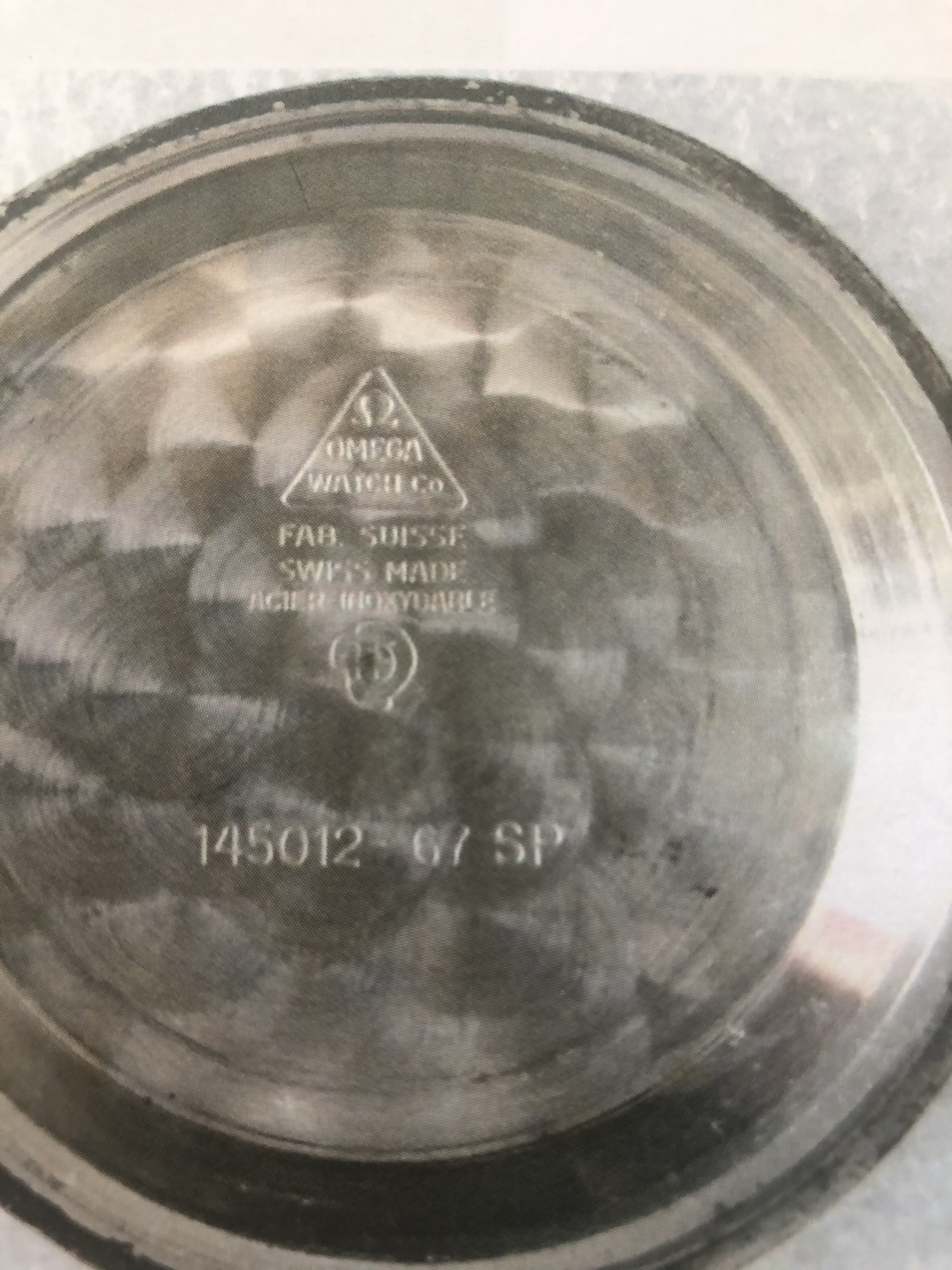

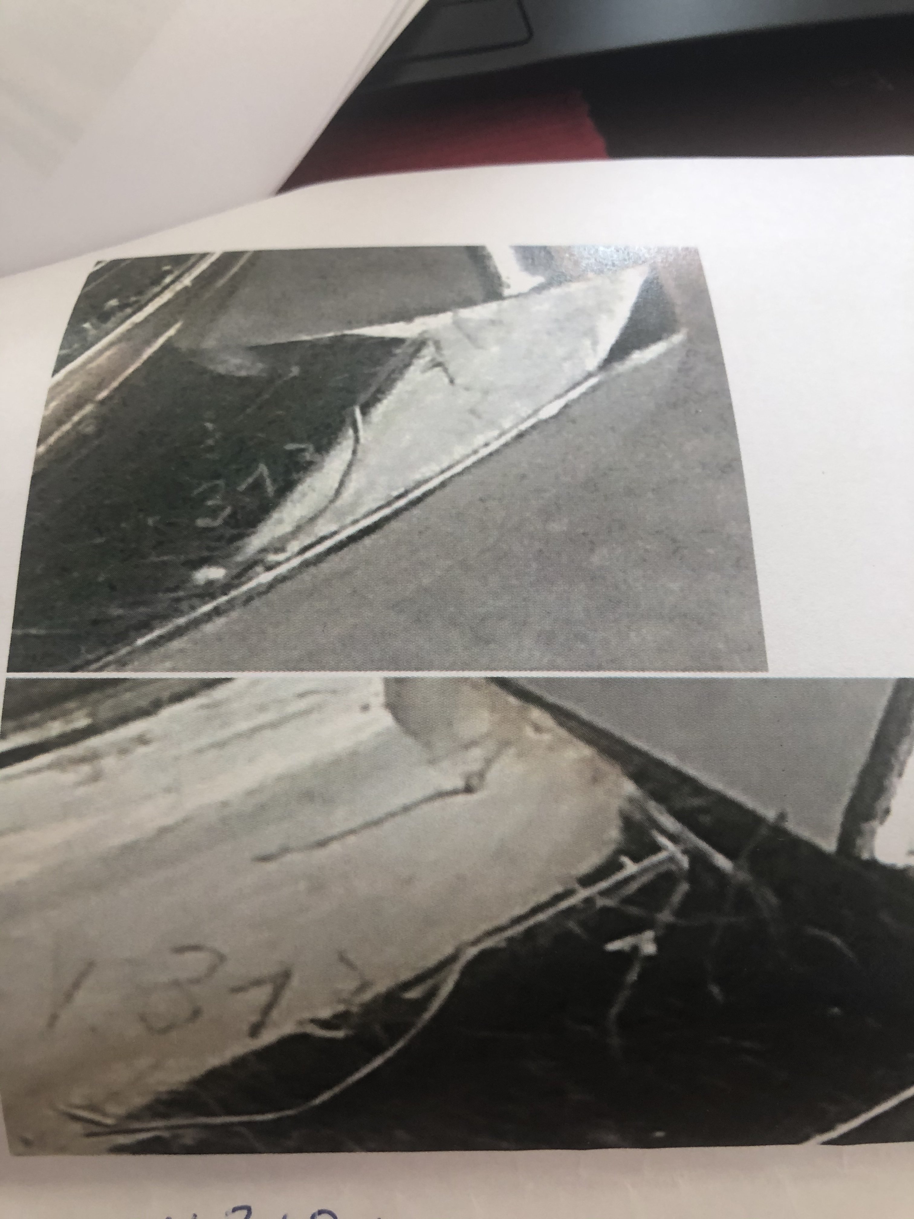

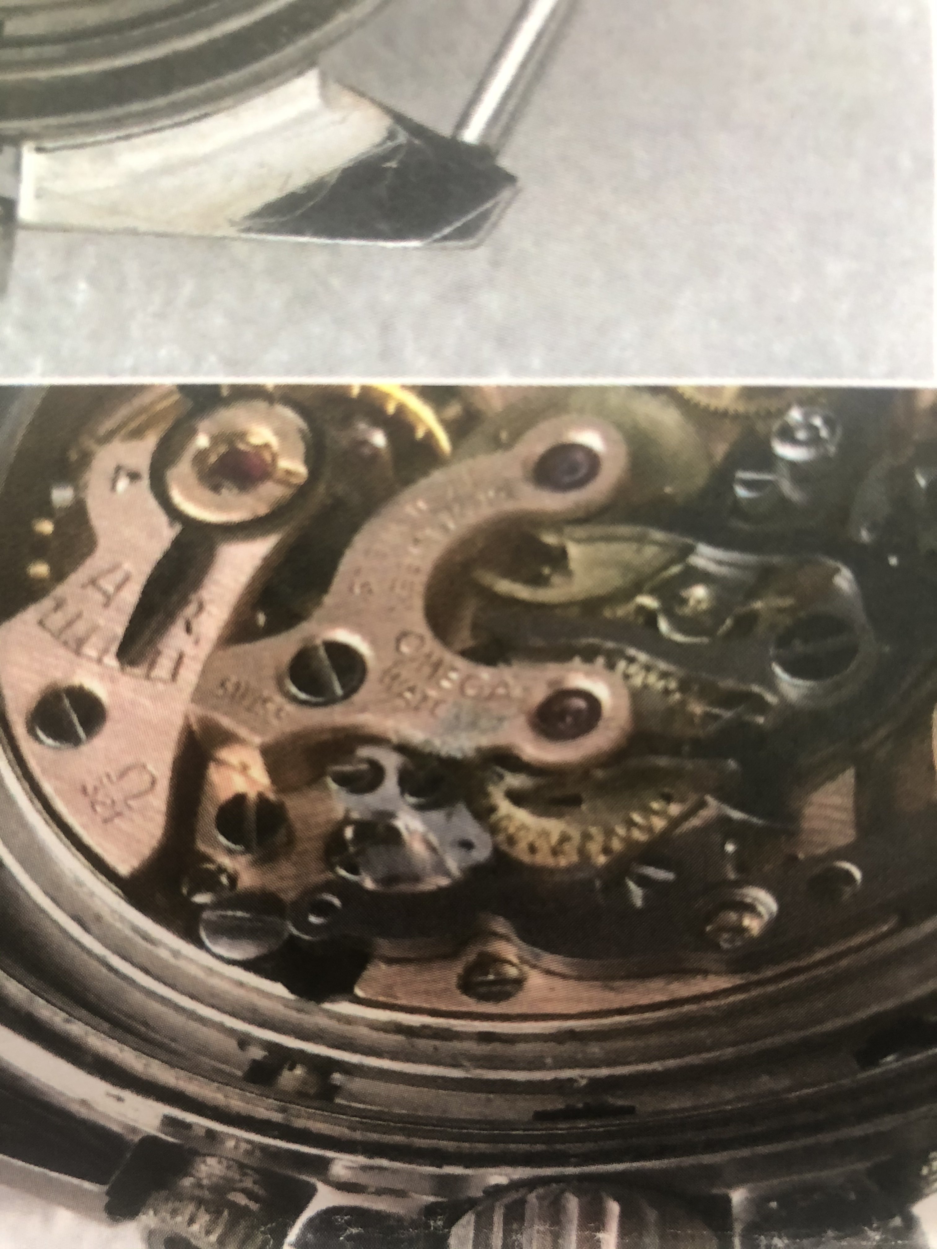

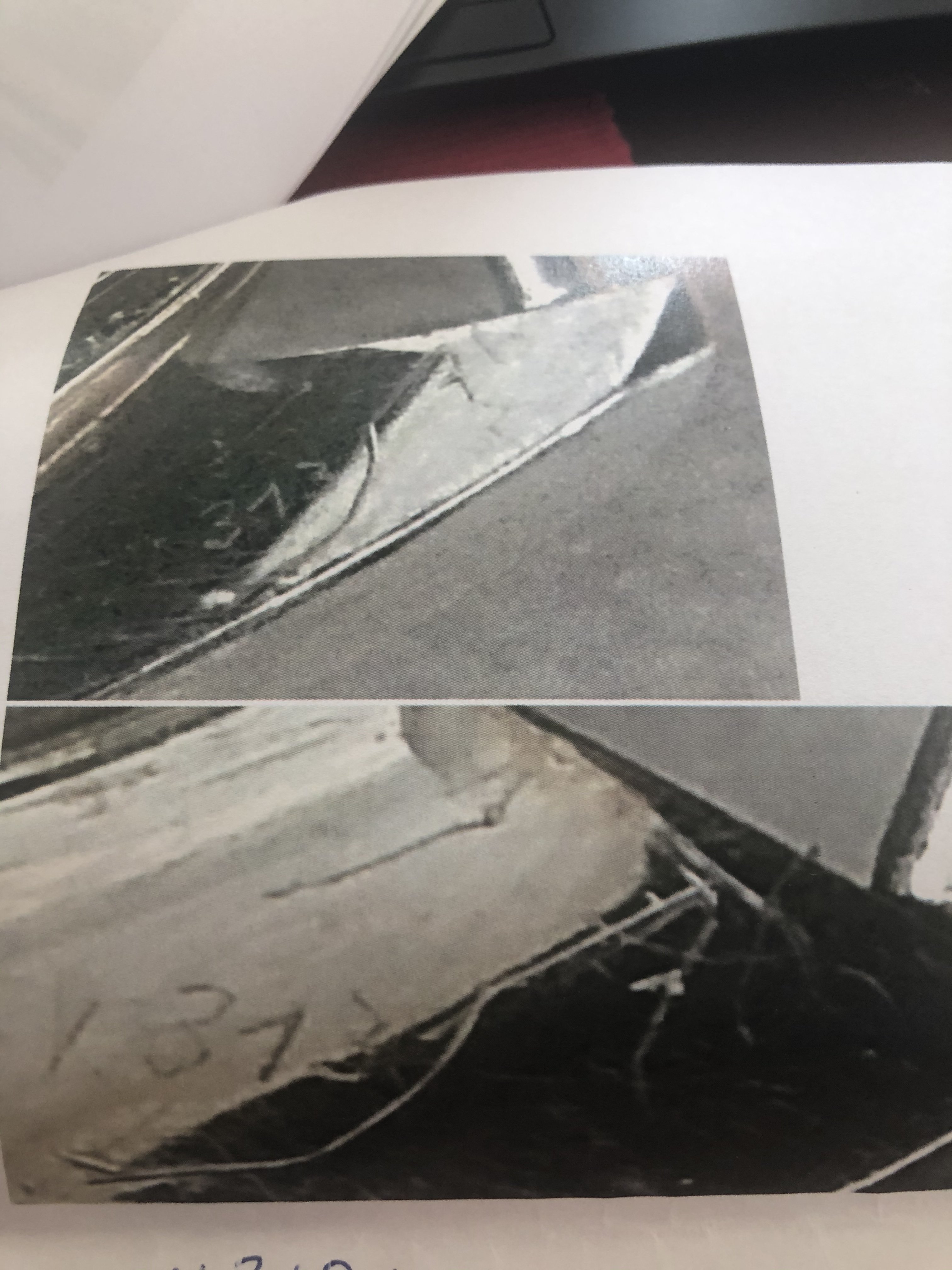

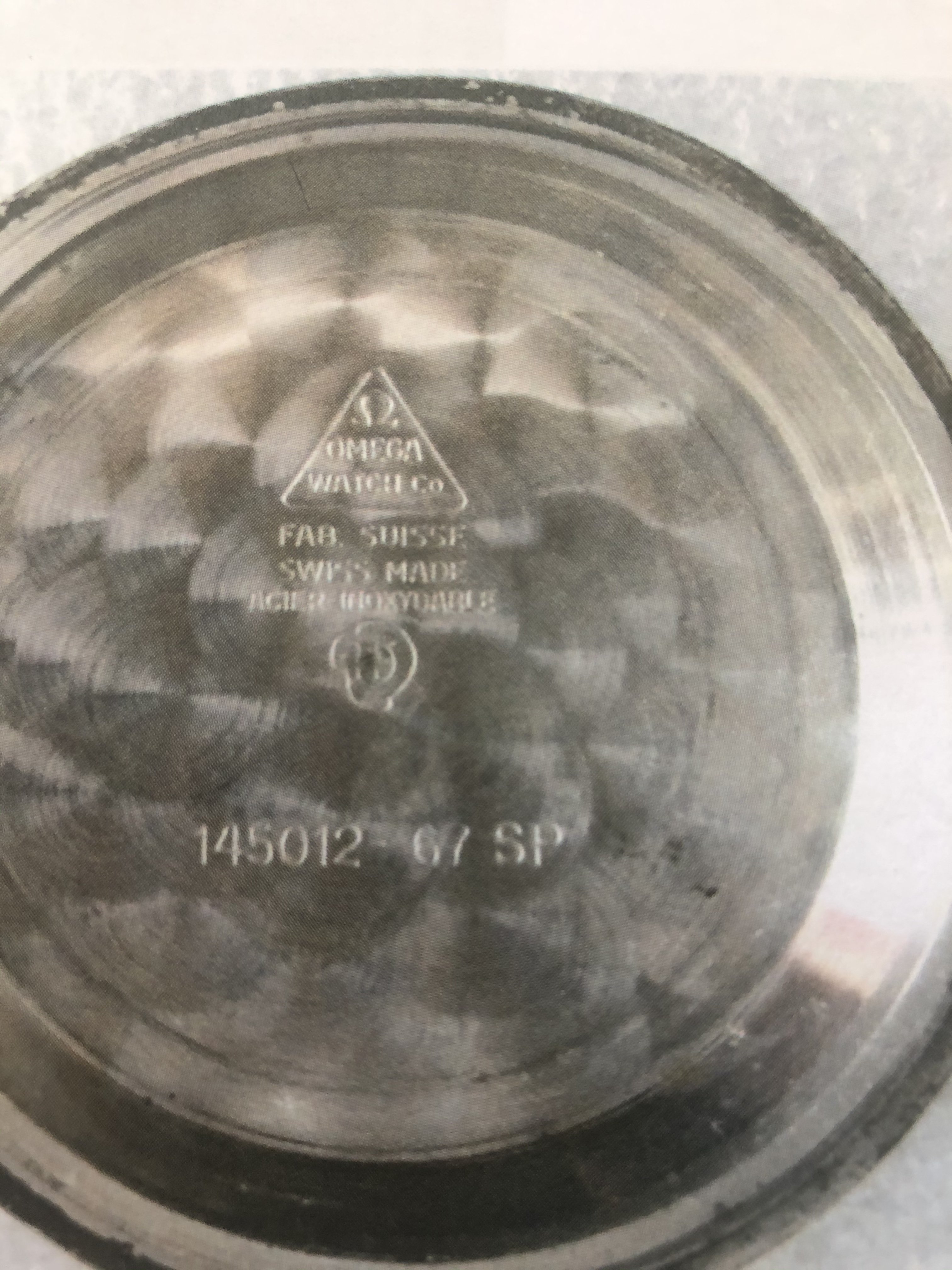

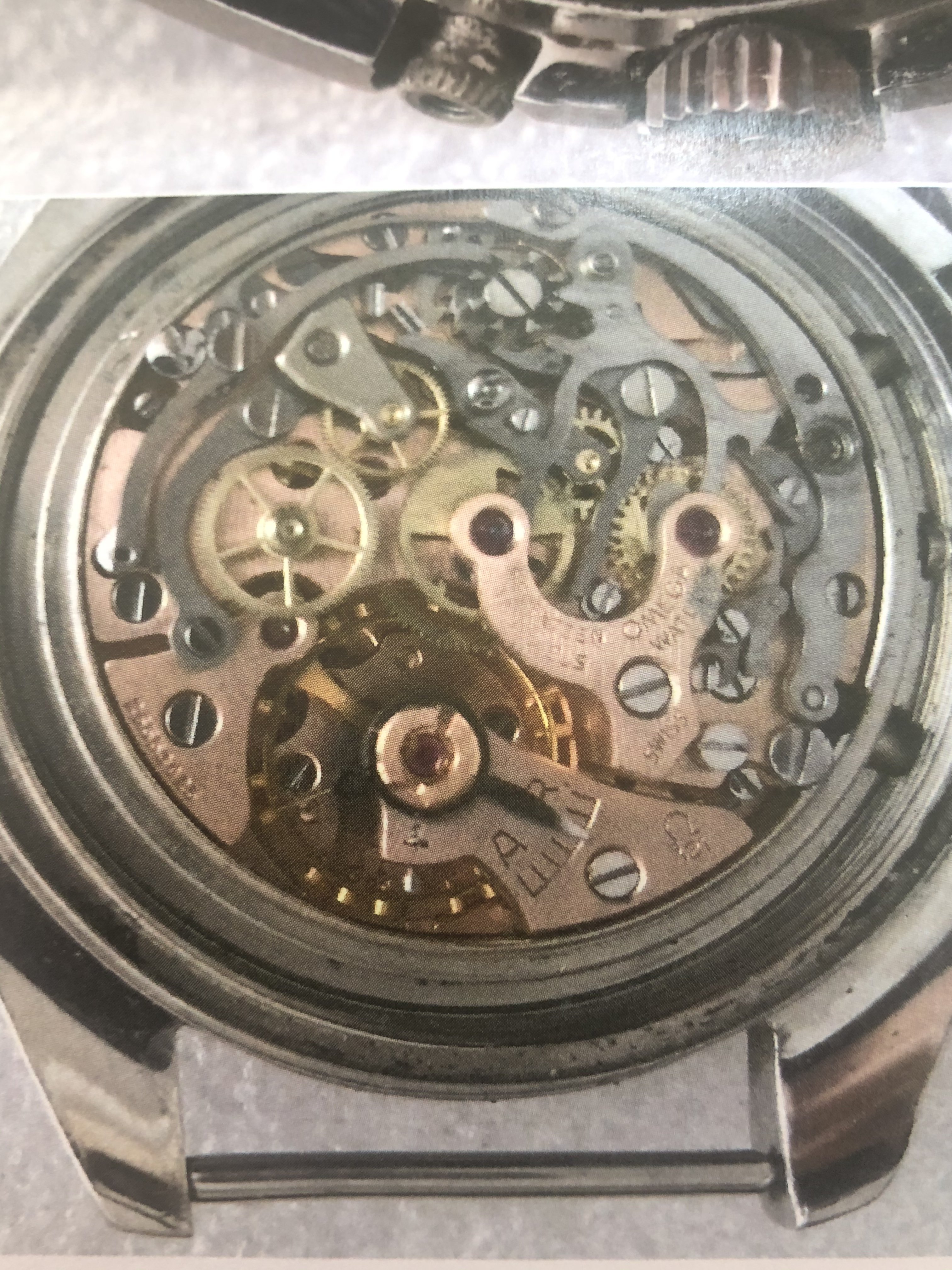

Finally managed to get a picture of the inside of the case back. Also found V3131 inscribed on the rear of the case. Any thoughts on these?
913
1,596
Am I crazy, or does the lug in the above "V3131" shot not even look like the same asymmetric case as the previous photos? Where is the large flat triangle at the end of the lug in the previous photos? Those lugs look straight.
Are the V3131 photos older photos of the watch?

That's a great watch you've inherited from your father, the 145.012 reference is the same reference as was worn on the moon.
