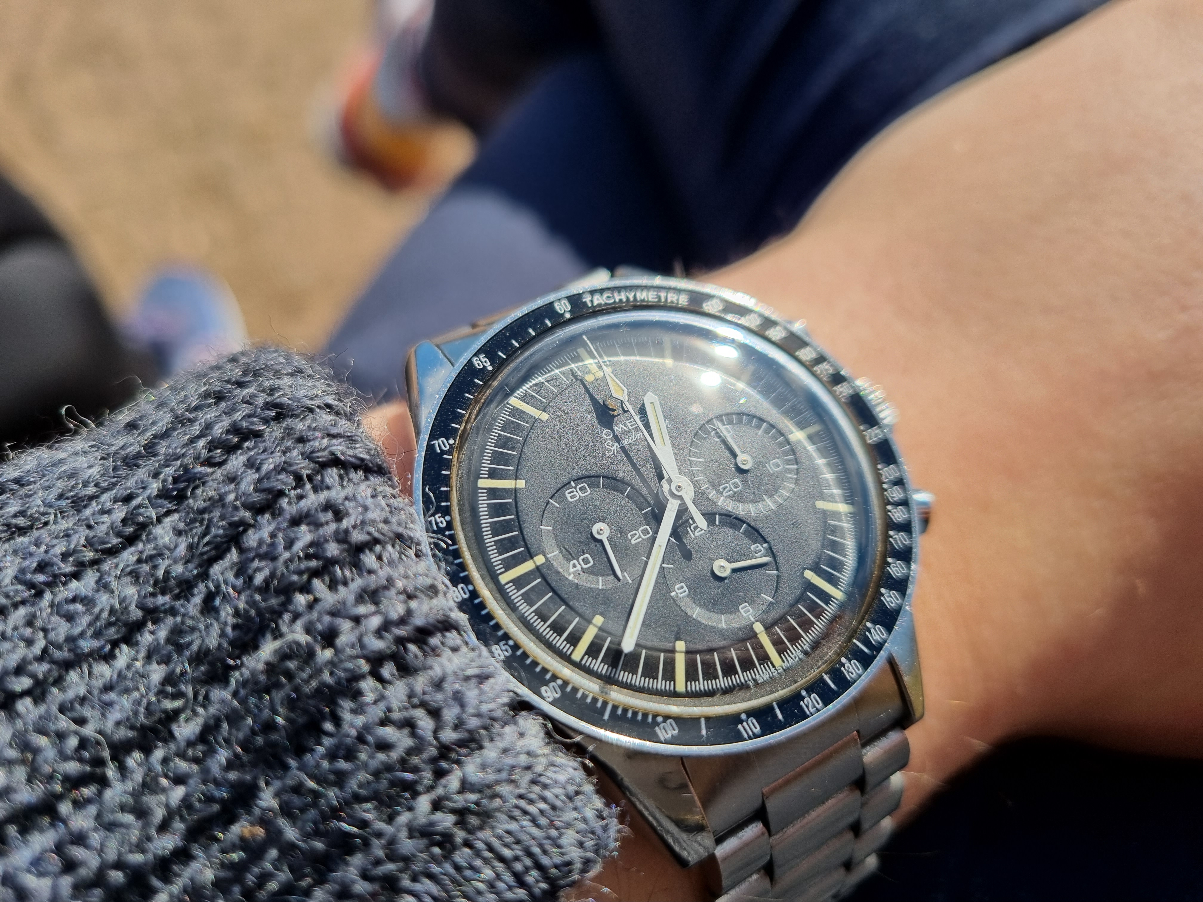

I have a Speedmaster from 1964 whitch has chronocreep, the hour counter og the crono slowly moves as the watch is running and the chronograph is disabled.
I have stopped using the watch a few months ago for that reason. Before i send it for service i want to find some parts that need changing.
So for now its just in the box, and i was wondering if i was to use the watch with chronocreep, wuld that further damage the watch?
Thank you

Just an break lever adjustment under the dial. Use it. Nothing will happen that makes it worse.
