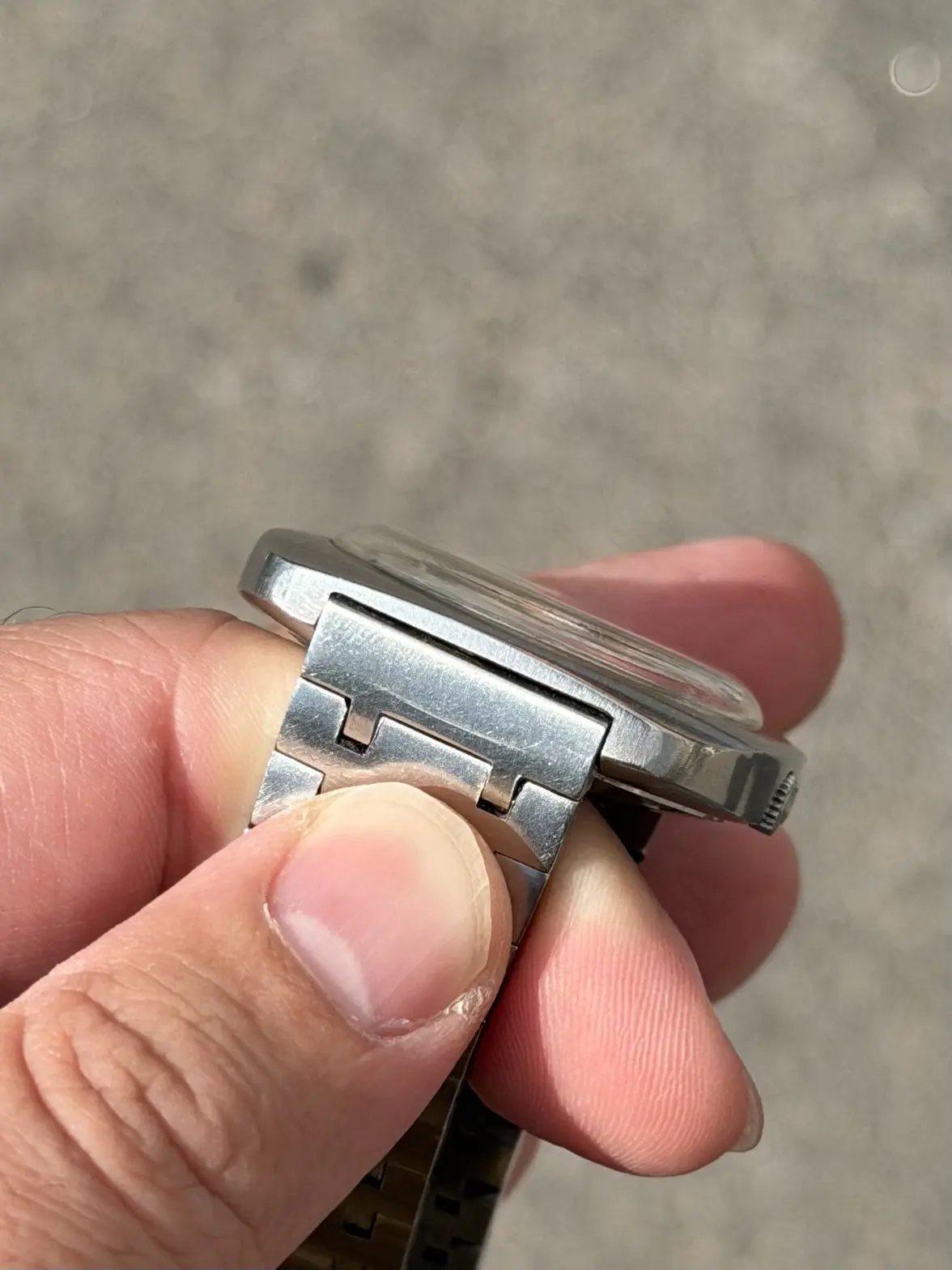

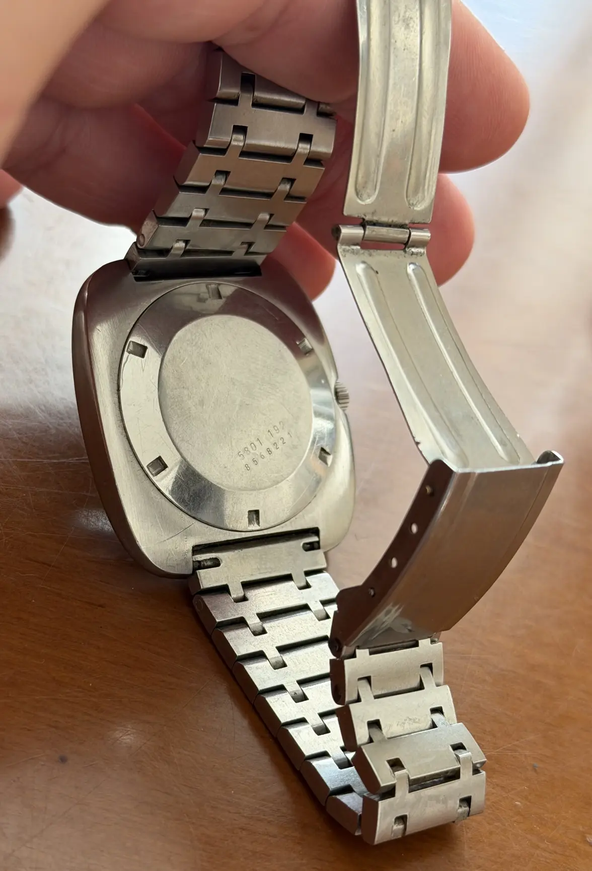

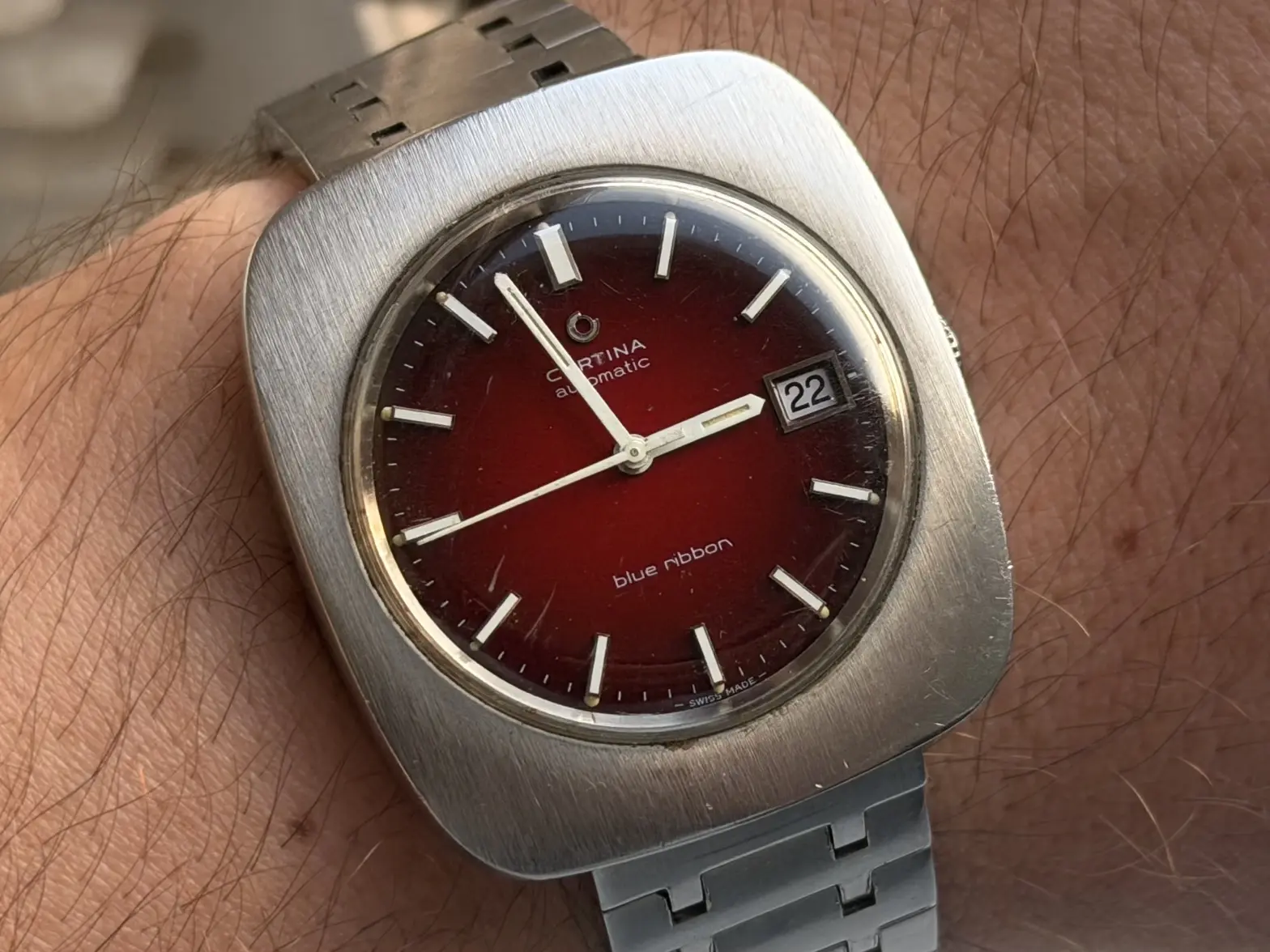

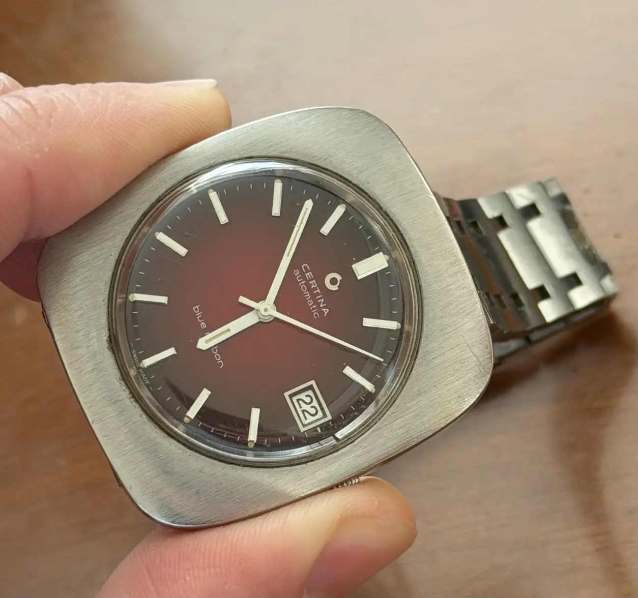

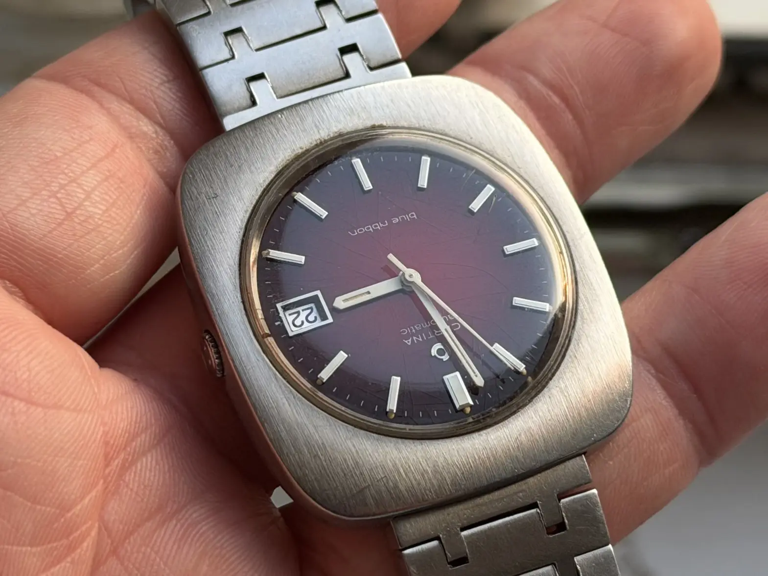

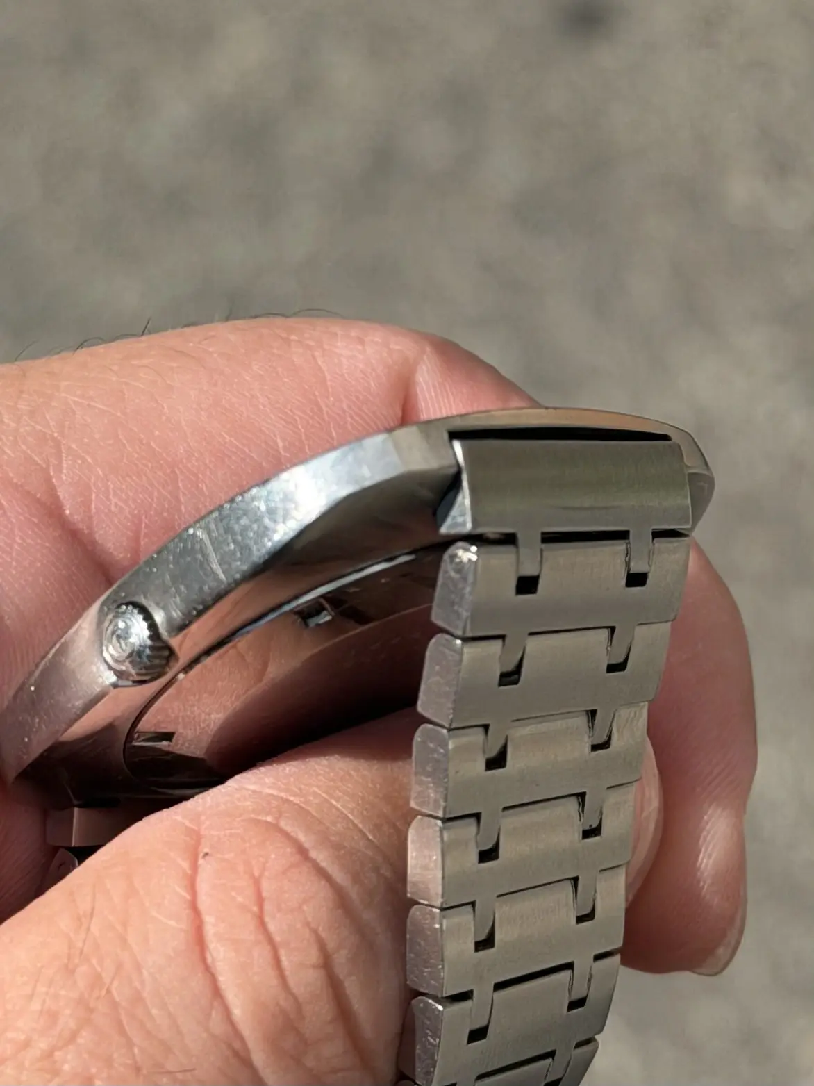

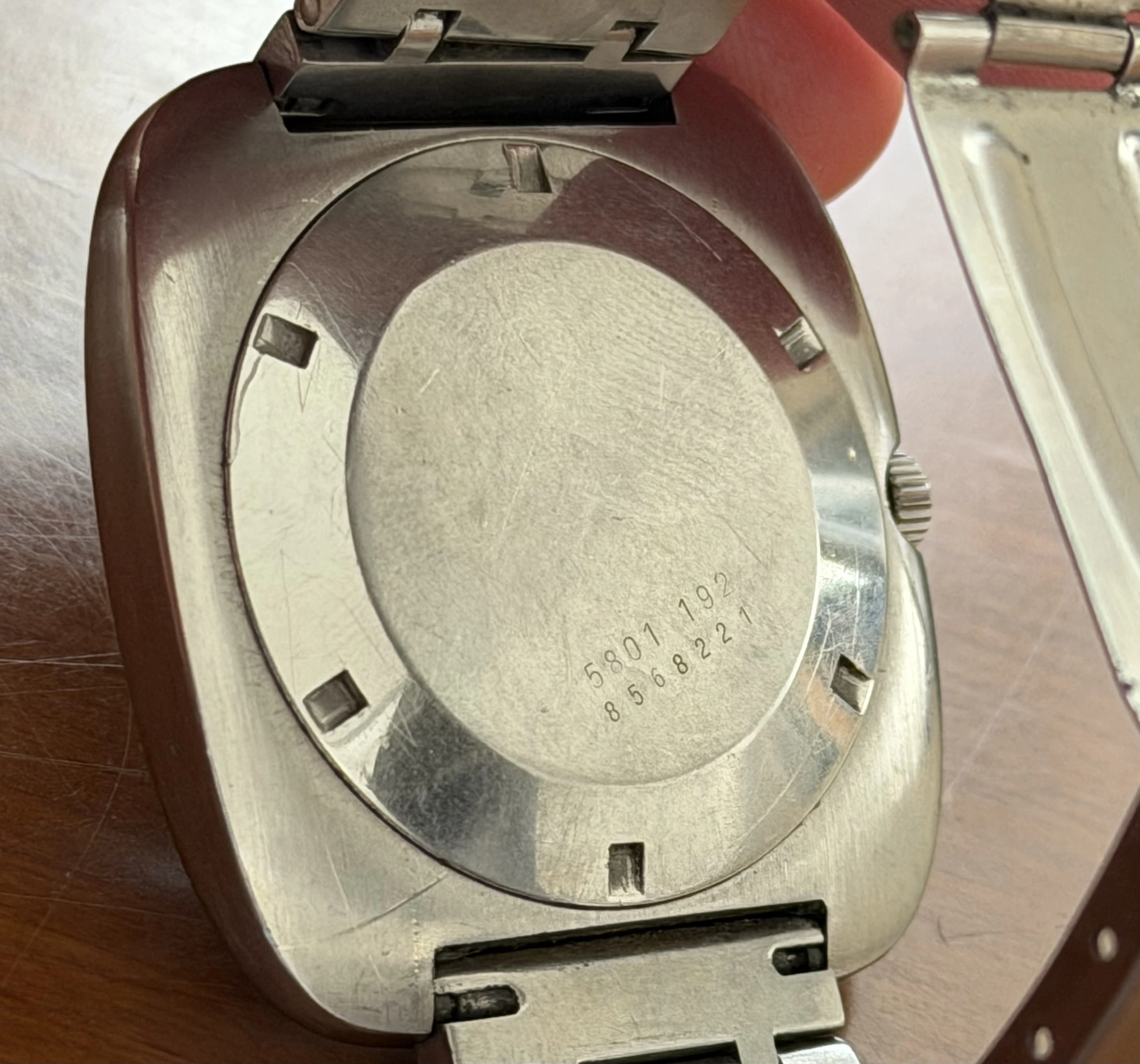

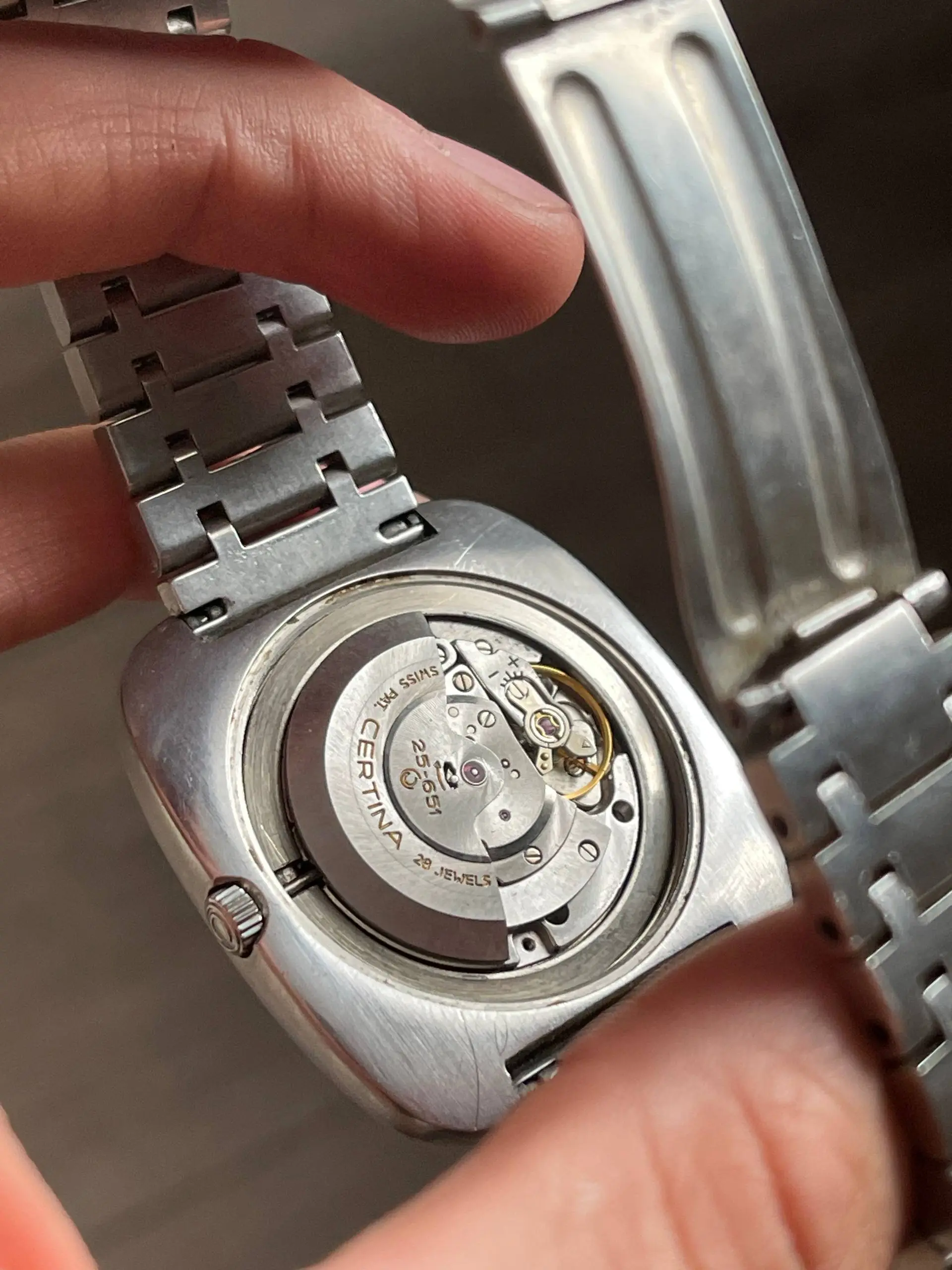

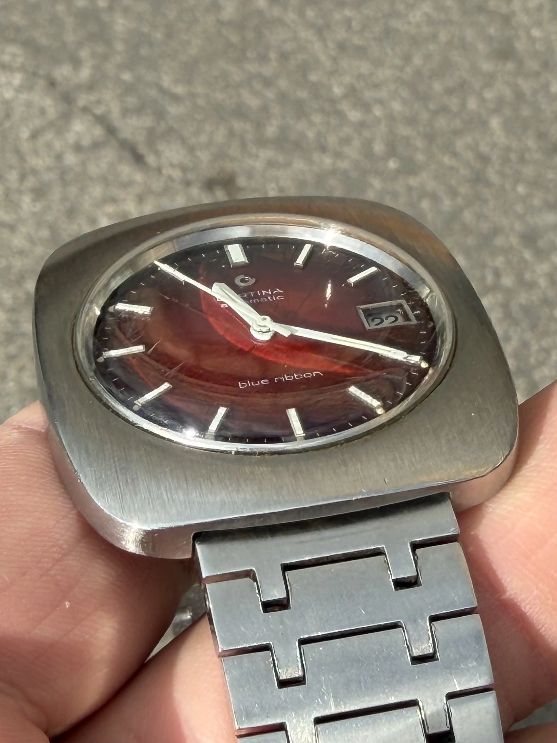

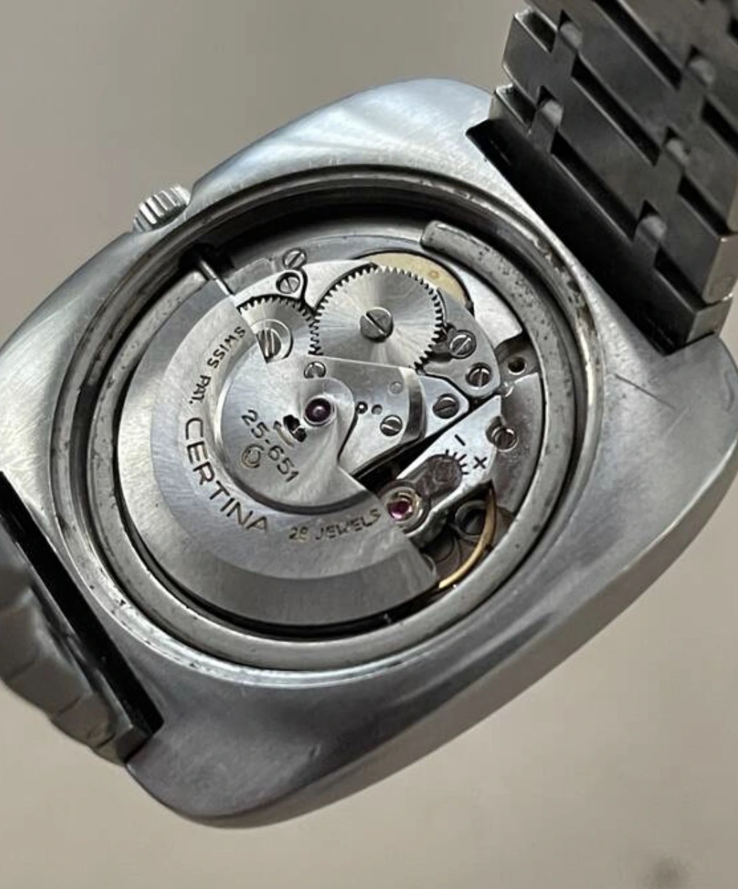

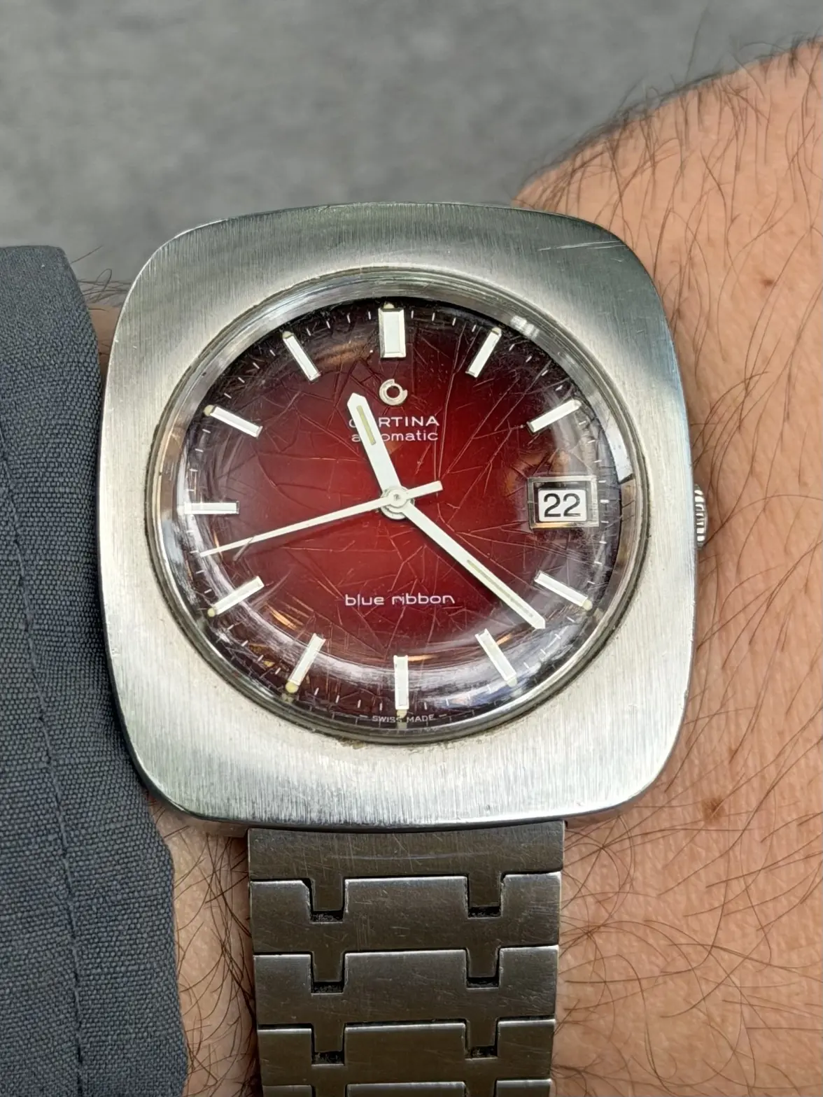

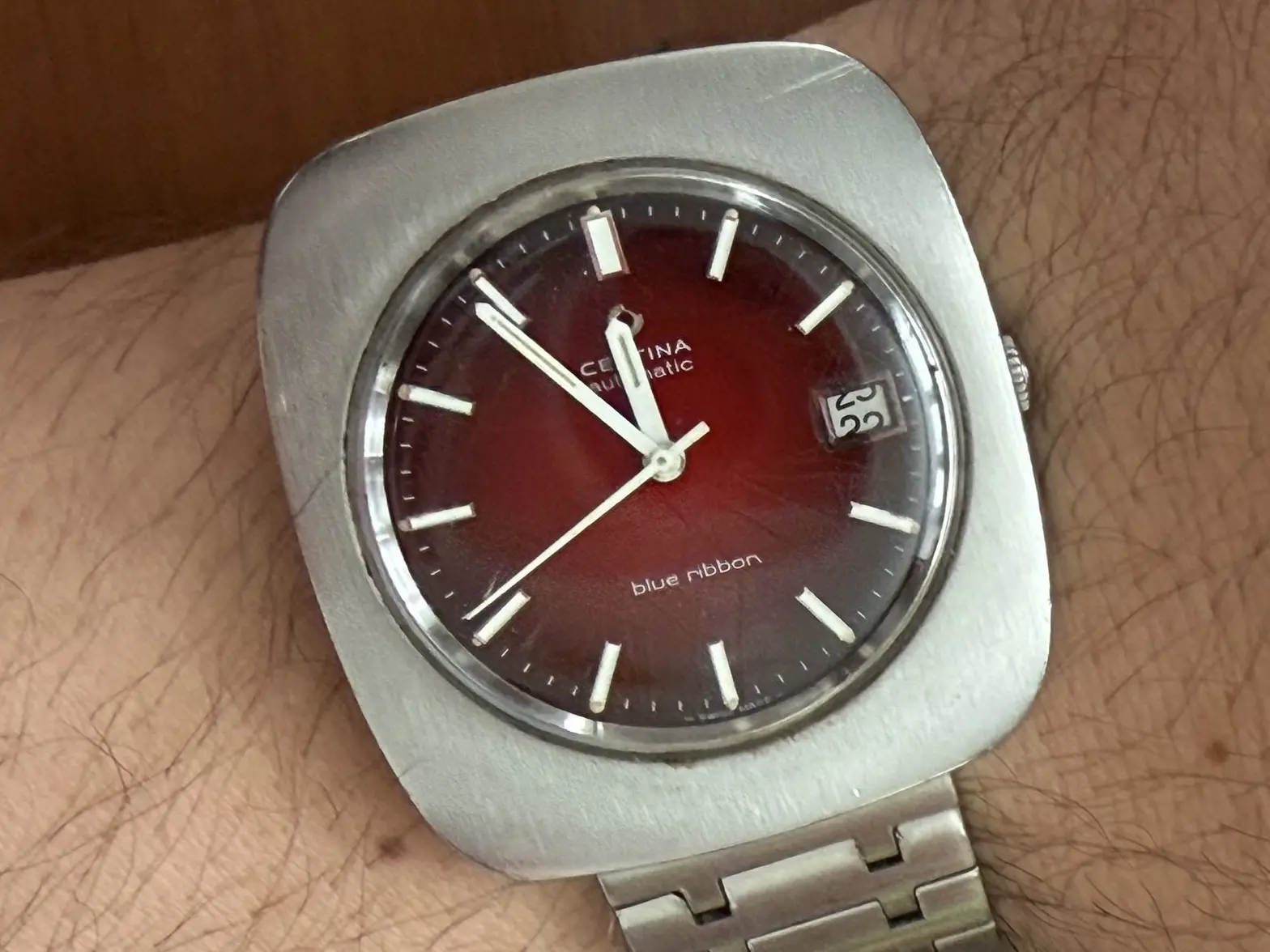

Hello everyone,

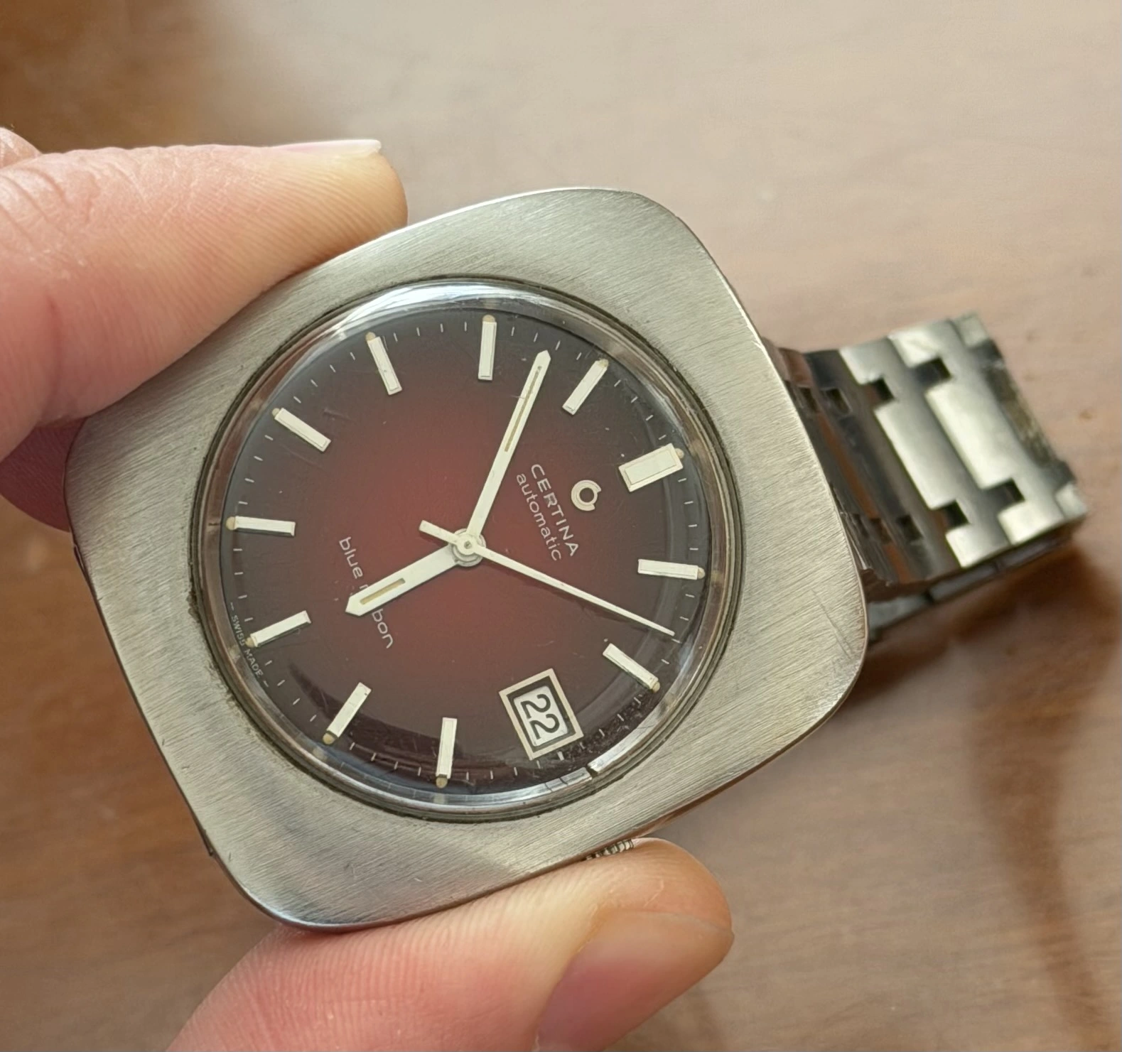

I recently acquired this Certina Blue Ribbon Automatic and I’m hoping someone can help identify it.
I’ve spent quite a bit of time searching online but haven’t been able to find another example with the same case, dial color, and bracelet.

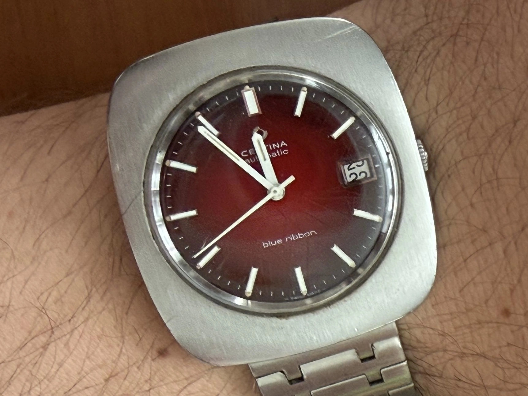

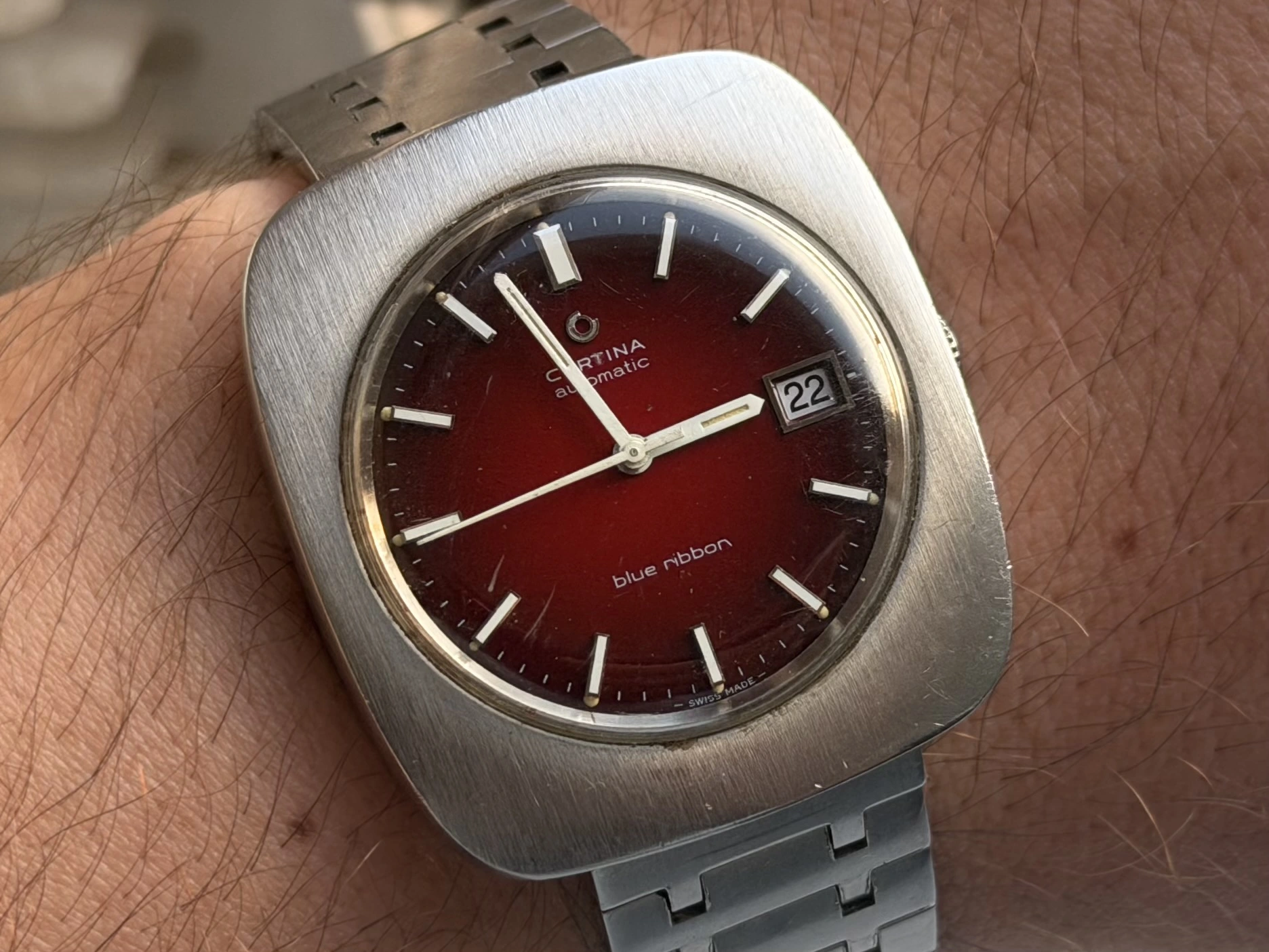

The dial appears to be burgundy (unless there is a more accurate name for this color).
The watch is running well. It has been keeping time for over 10 hours, and the automatic winding works as it should.
However, there is one issue with the date mechanism. Around midnight, the date begins to change but does not complete the transition. Instead, it stops between two dates for a while and then eventually returns to the previous date. I first tried advancing the hands manually (without using the quickset), but the result was always the same. Later I let the watch run naturally past midnight. The date indicator remained between two dates for about 20 minutes. After I wore the watch and moved it around, the date returned to the previous day instead of advancing.

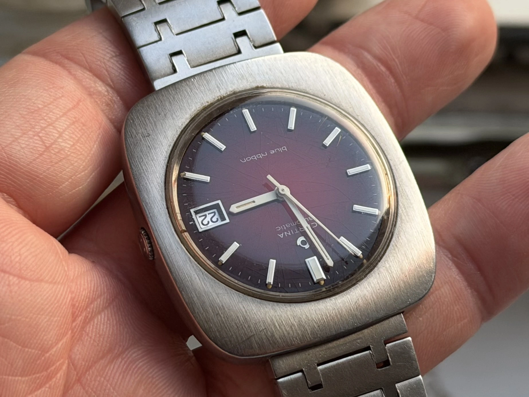

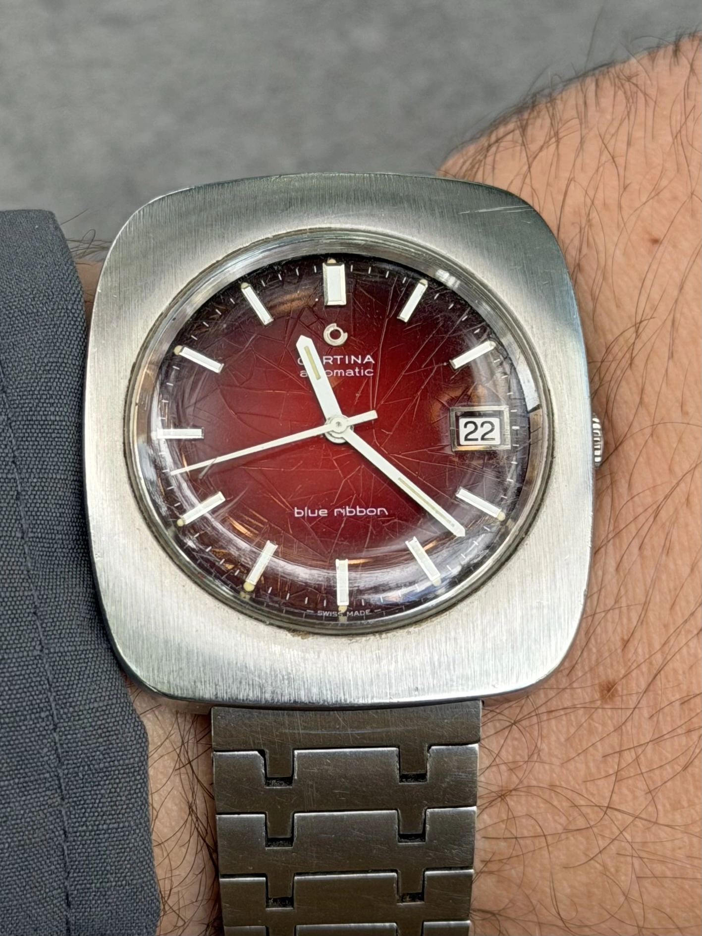

The dial also has a very unusual crackled pattern. At first glance it looks like cracked lacquer, but the pattern continues underneath the printed text and the applied hour markers. I’m not sure whether this is an original factory finish, a lacquer defect, or age-related deterioration.

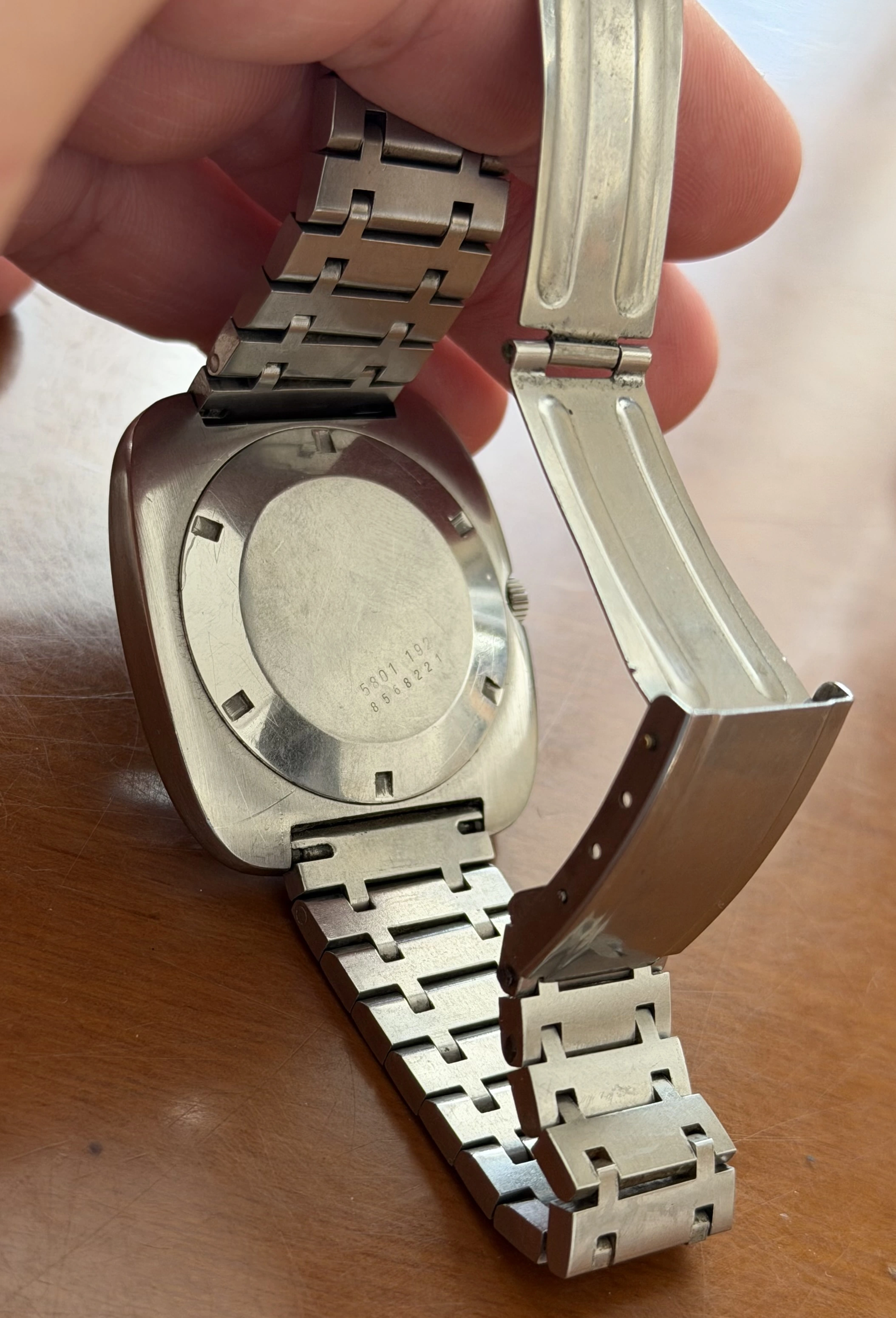

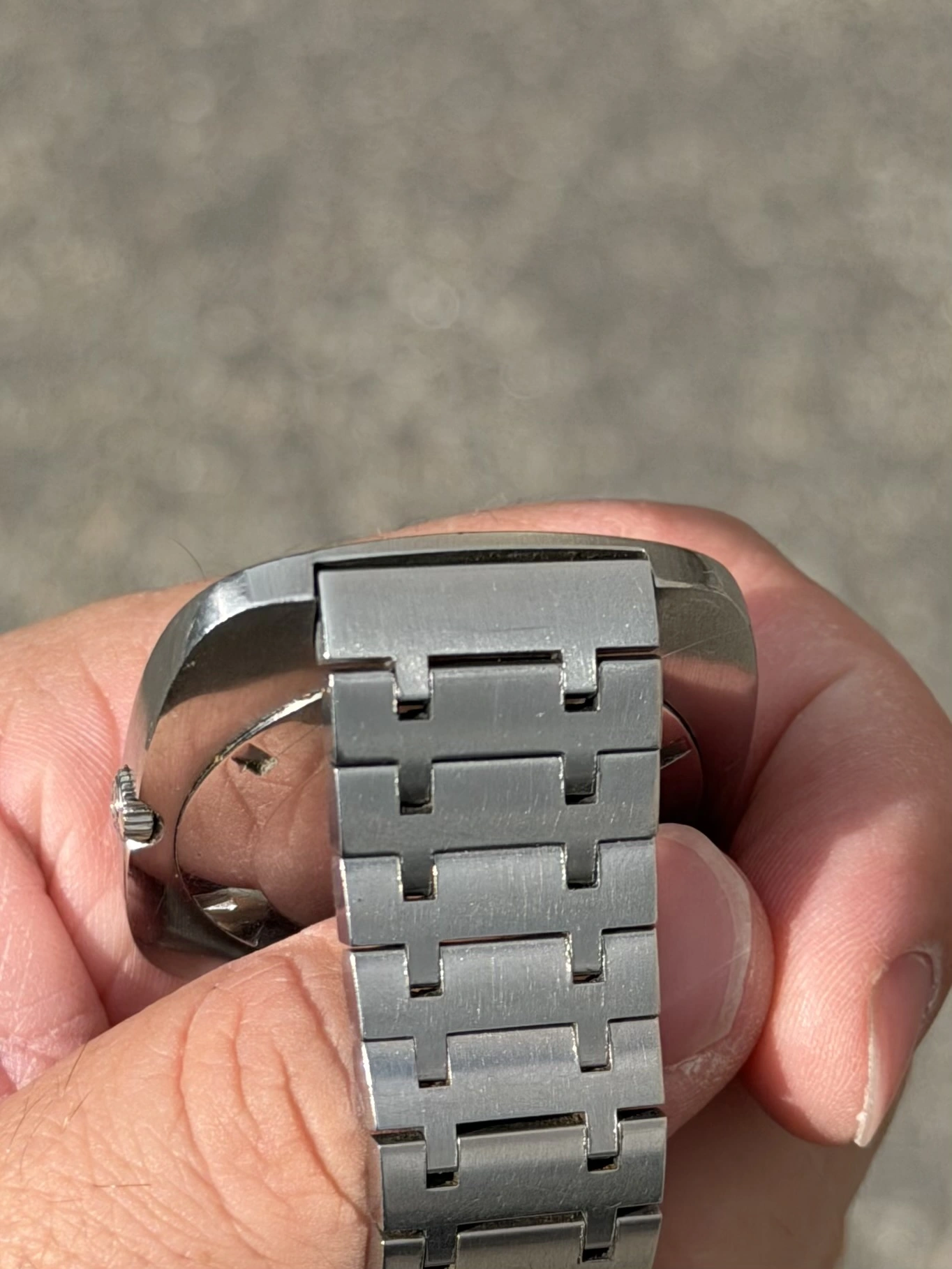

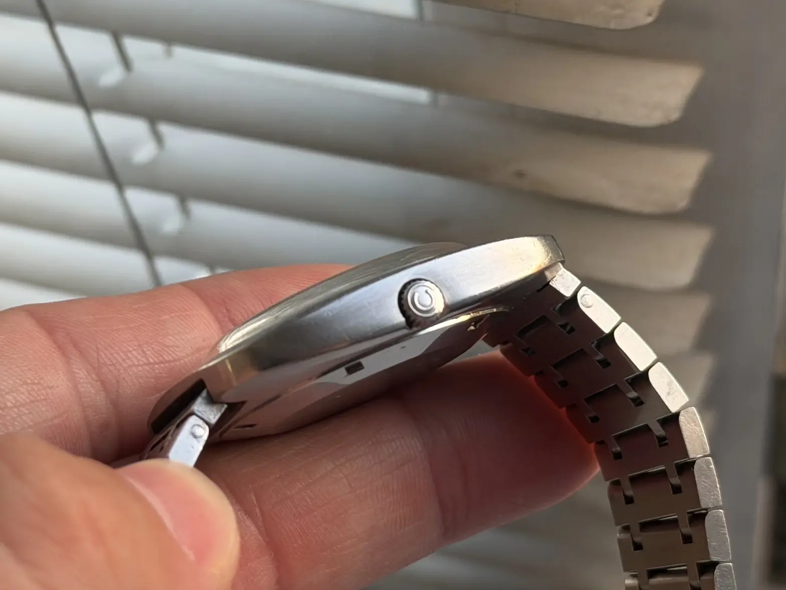

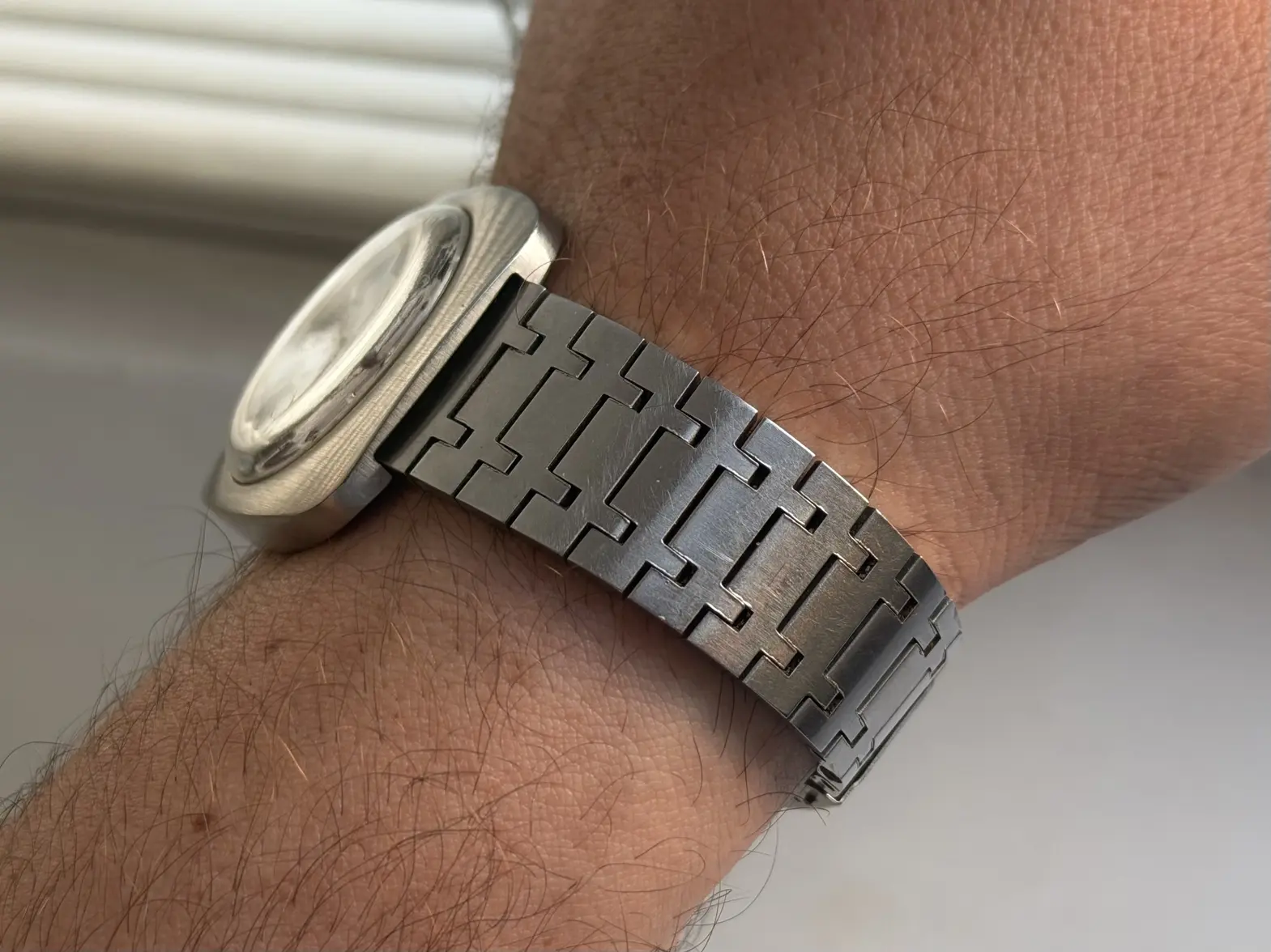

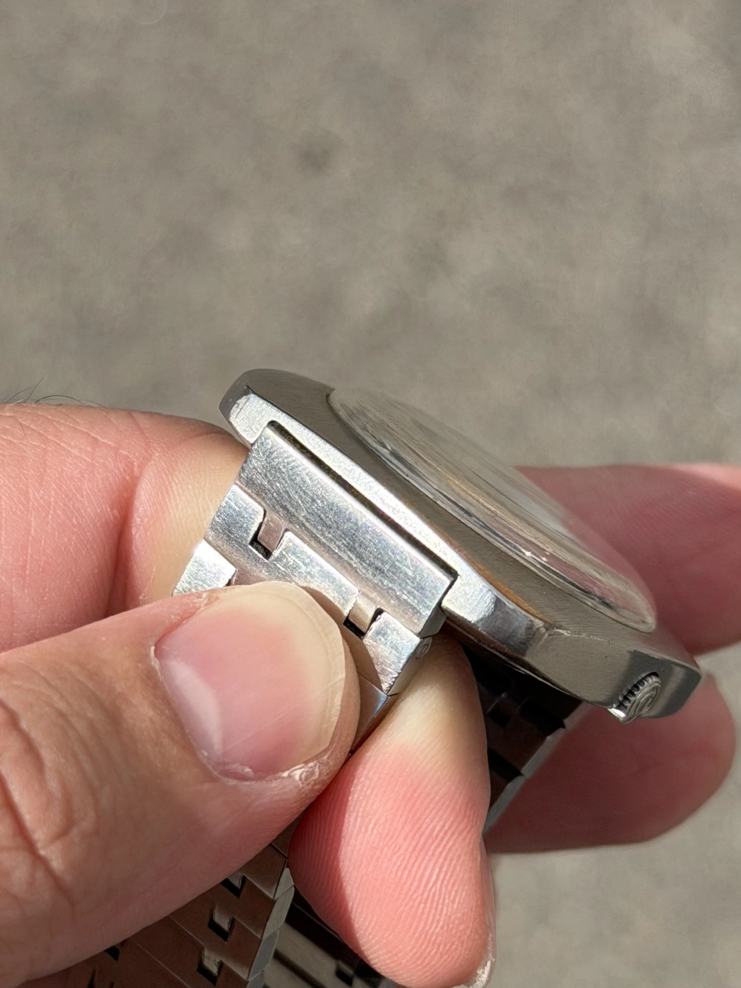

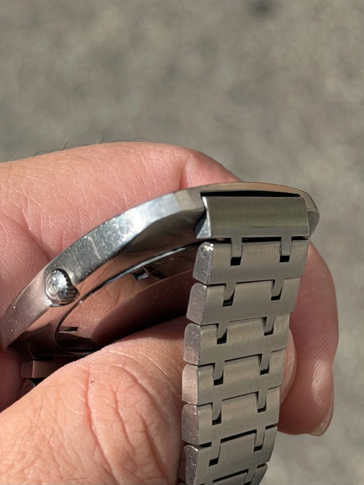

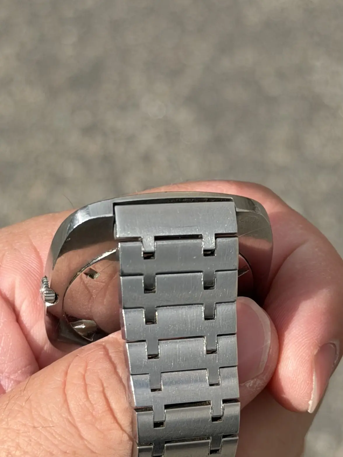

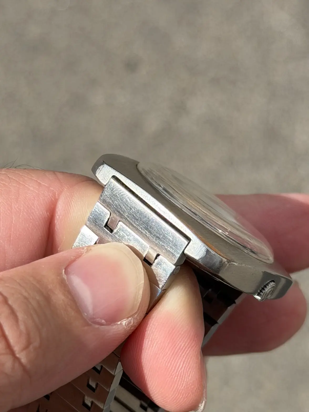

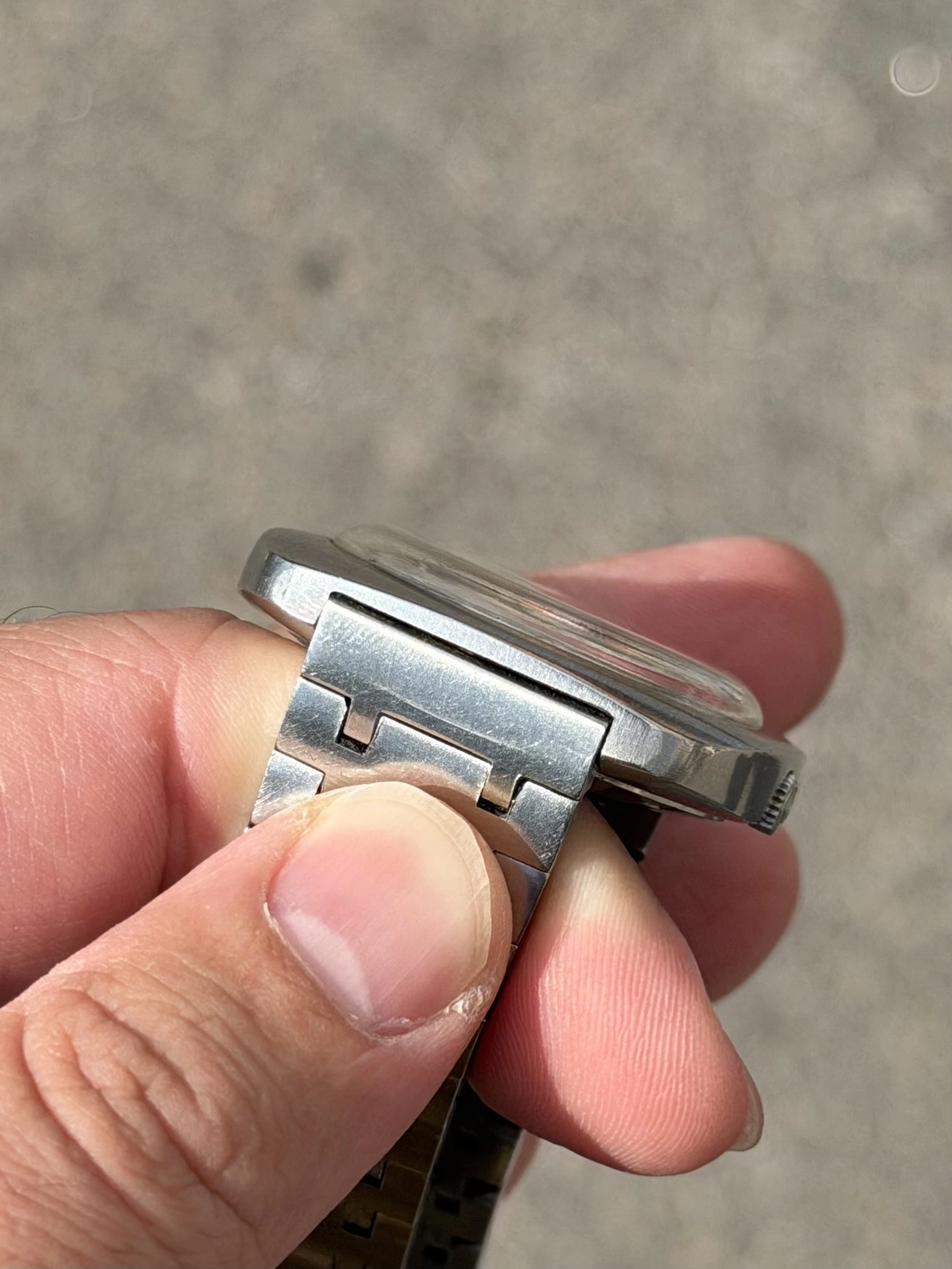

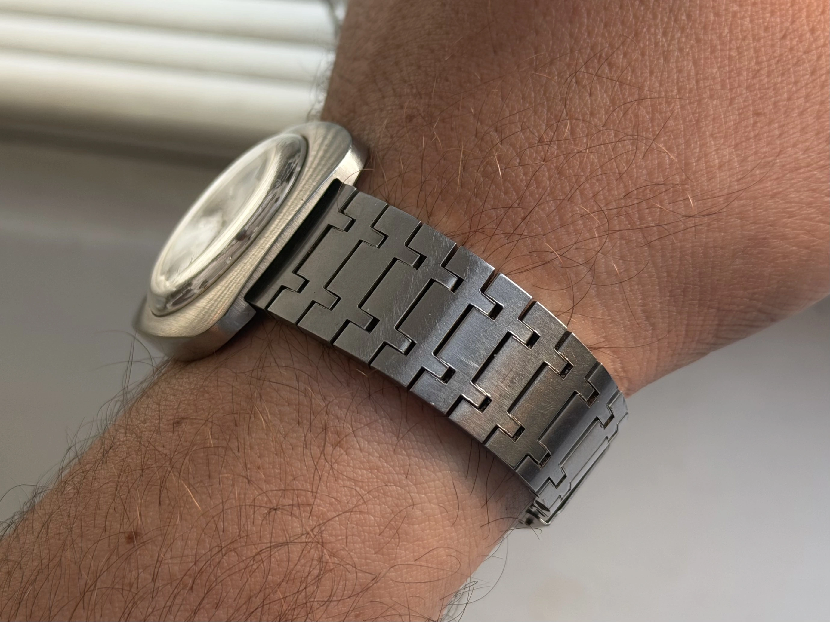

The bracelet has no visible markings or logos that I could find. However, the end links fit the case extremely well—almost as if they were made specifically for this watch. Either the bracelet is original, or it has been exceptionally well matched to the case.

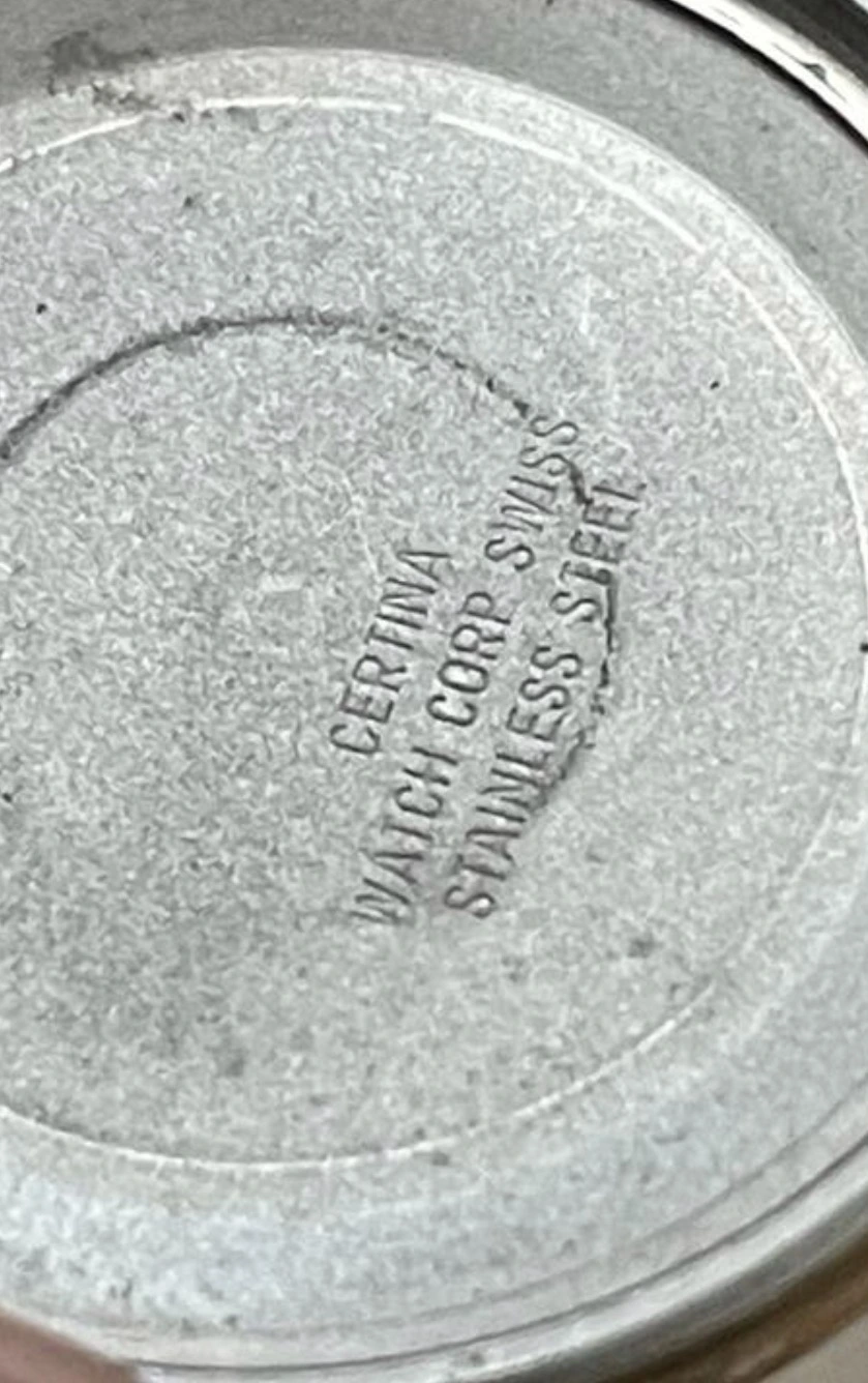

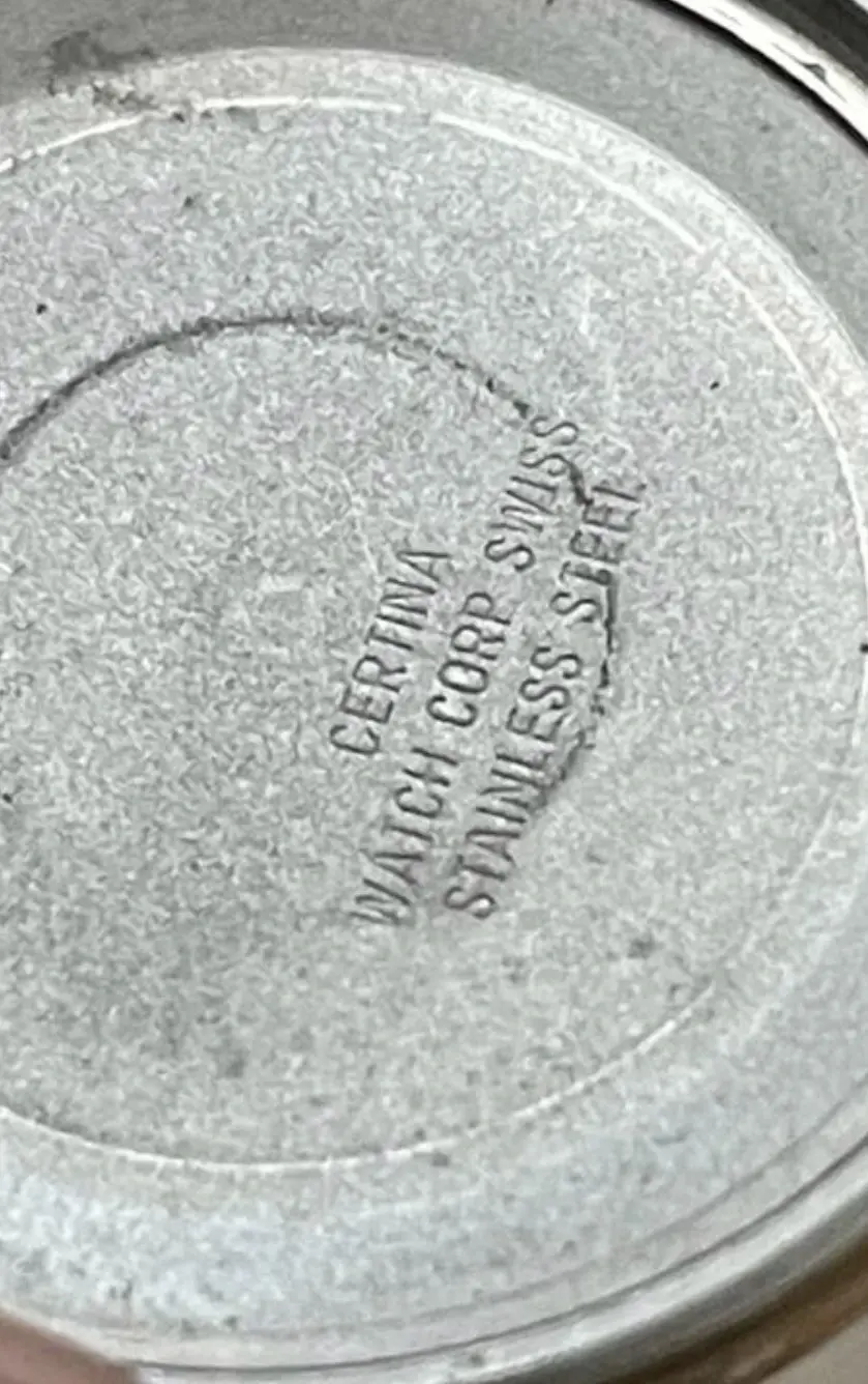

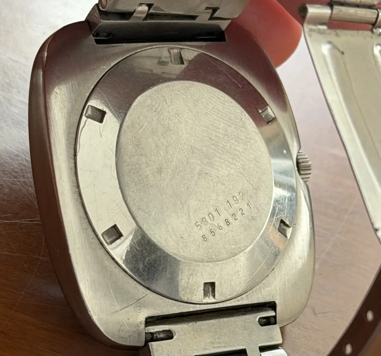

The inside of the case back is marked “Certina Watch Co. Swiss Stainless Steel”. From the information I’ve found, this type of case back marking may indicate a watch intended for the U.S. market, likely from the early 1970s. If anyone has more accurate information, I’d really appreciate it.
The case itself still has a strong satin-brushed finish and does not appear to have been heavily polished during its lifetime.

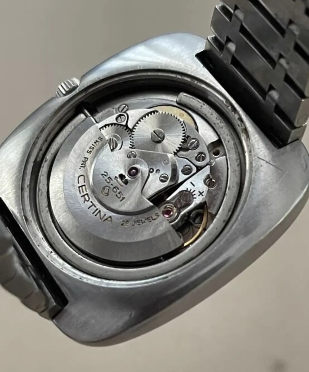

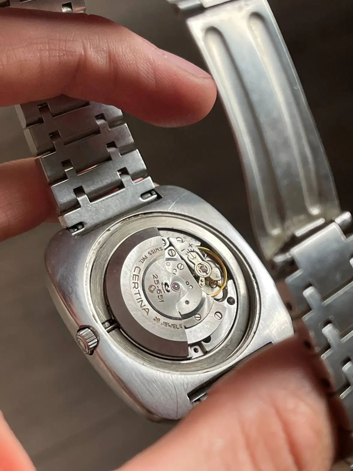

The movement is Certina Cal. 25-651 (29 jewels).
I’d be very grateful if anyone could help with:
  • Identifying the exact reference/model.
  • Confirming whether the dial is original and whether this crackled appearance is factory-original or damage.
  • Determining whether the bracelet is likely original.
  • Explaining the probable cause of the date problem.
  • Estimating its current market value in this condition.
Thank you very much in advance for any information or opinions.
Photos attached.

Le cadran semble être bordeaux (à moins qu'il n'existe un nom plus précis pour cette couleur).

Le cadran présente également un motif craquelé très inhabituel. Au premier abord, on dirait du vernis craquelé, mais le motif se prolonge sous les inscriptions et les index appliqués. Je ne sais pas s'il s'agit d'une finition d'usine d'origine, d'un défaut du vernis ou d'une usure liée à l'âge.
Le bracelet ne présente aucune marque ni logo visible. Cependant, les maillons de bout s'ajustent parfaitement au boîtier, comme s'ils avaient été conçus sur mesure pour cette montre. Soit le bracelet est d'origine, soit il a été exceptionnellement bien adapté au boîtier.
L'intérieur du fond de boîtier porte l'inscription « Certina Watch Co. Swiss Stainless Steel ». D'après mes recherches, ce type de marquage pourrait indiquer une montre destinée au marché américain, probablement du début des années 1970. Si quelqu'un possède des informations plus précises, je lui en serais très reconnaissant.

Le mouvement est Certina Cal. 25-651 (29 rubis).

  • Déterminer si le bracelet est vraisemblablement d'origine.

Bonjour je possède la même montre sans bracelet et de la même couleur ,j'ai aussi l'effet craquelé sur le cadran ,calibre 25-651 mais moi 27 rubis.
