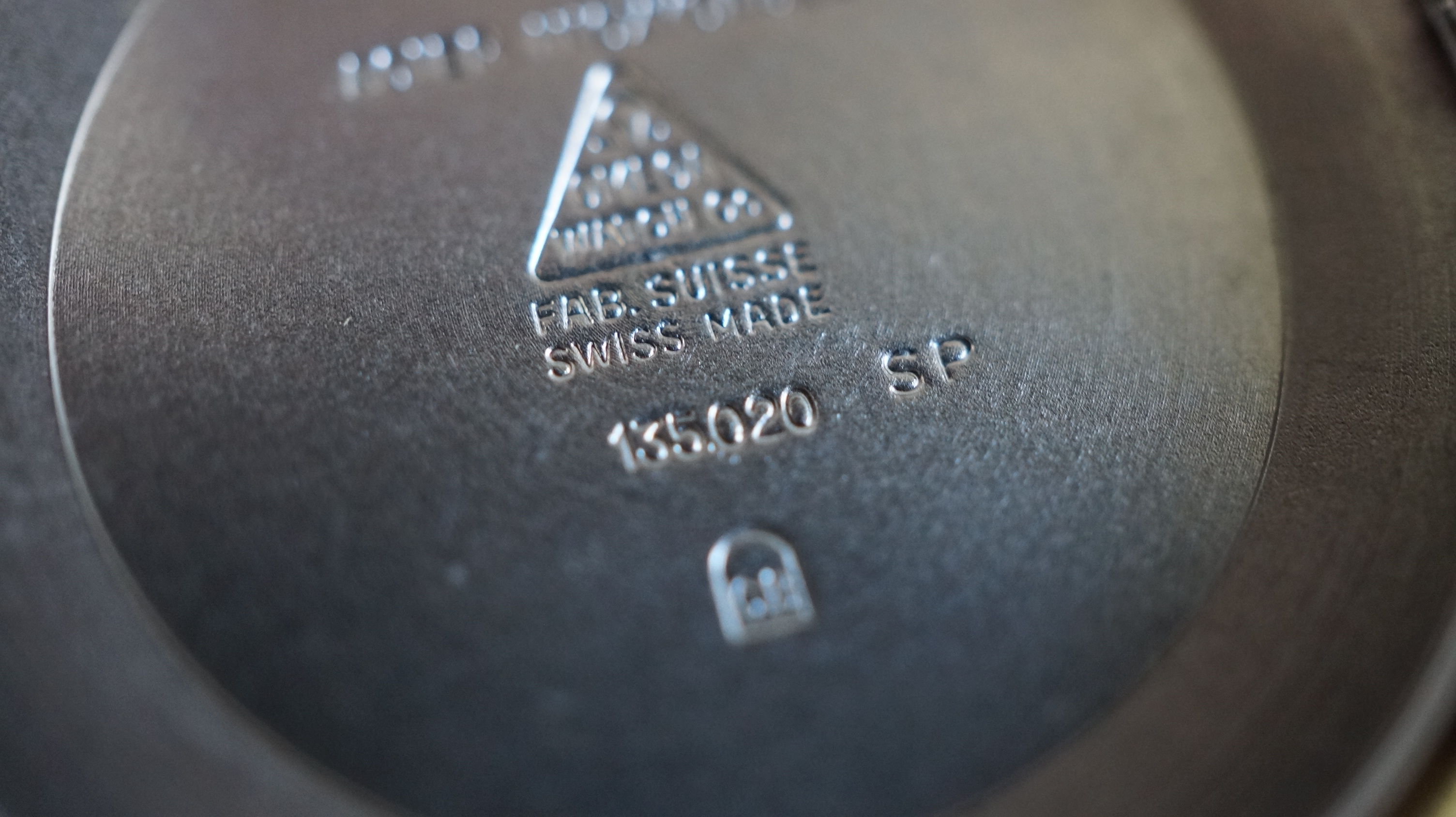

What about my 135.020 SP . Omega De Ville . That hasn't got any pushers ? I thought it mean stainless plated ? . But that doesn't work on the 145.012 SP

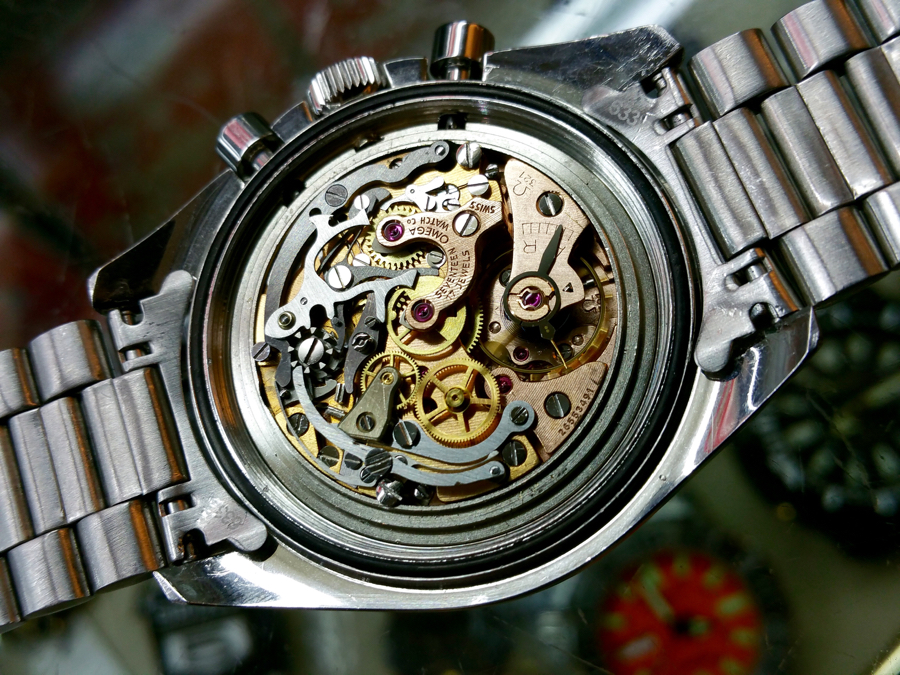

The 145.012-68 SP I recently acquired most definitely has a cal.321 movement.

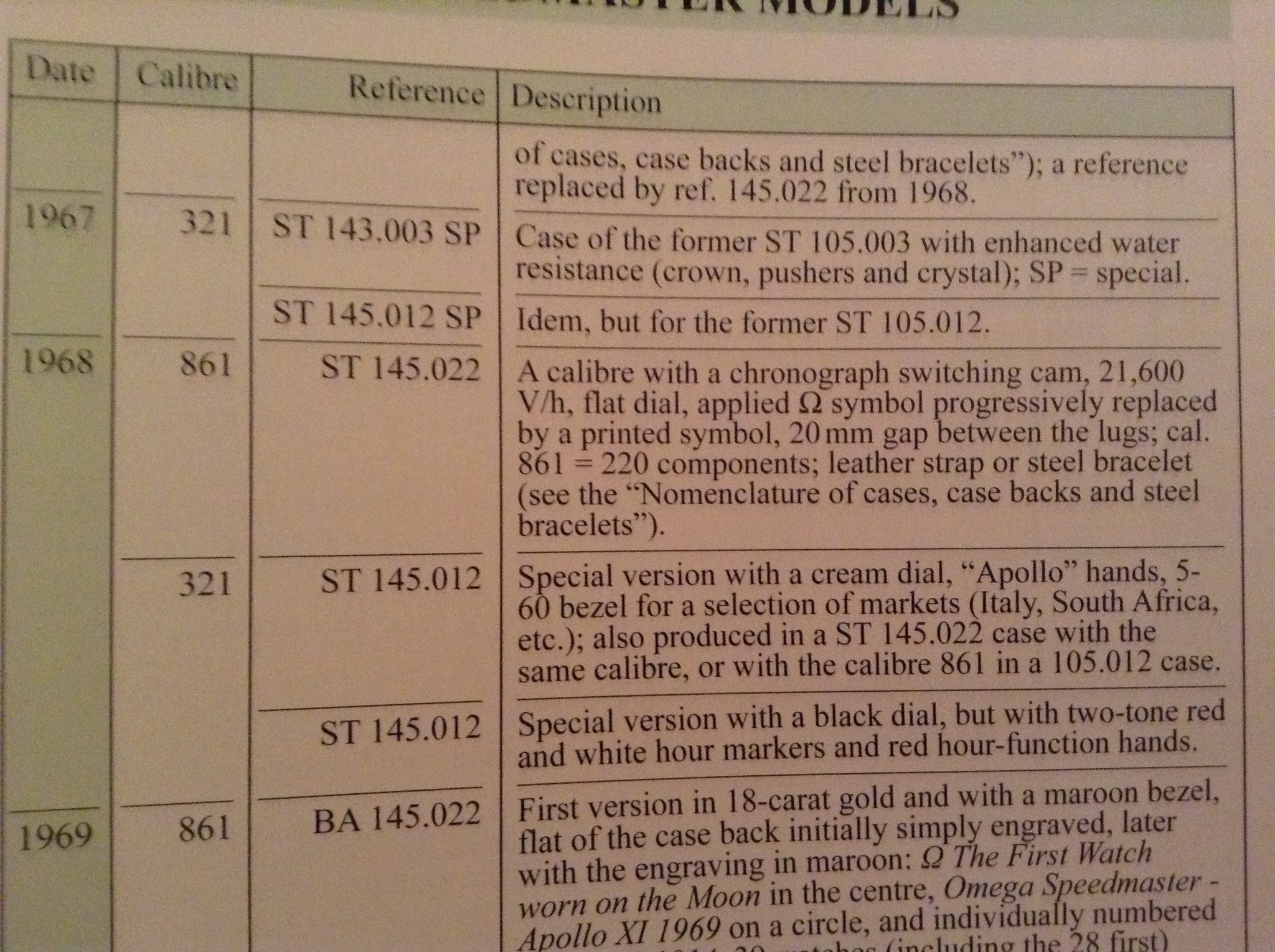

Yes this was the photo that got me worried....
145.012-68 SP is not mentioned here!
From AJTT Appendix
As has already been stated in this thread, the letter code that indicates case material is before the numbers, not after.
If yours is yellow gold capped, it would be a 055CD135020 - CD is the case material code. There is an "SP" version of all the case materials for this case, so there is an 055CD135020SP as well. The other case materials also come in the SP and non-SP versions, so for the pink gold capped (code CE), the stainless version (code ST), the 3N coloured 18k yellow gold version (code BB), and the 2N coloured yellow gold case (code BA).
The chart that has been posted and now reposted says what SP stands for - Special. It's not necessarily related to pushers IMO since many watches without pushers also have this code as you point out.

This is my 135.020 SP case . I was only asking if there where anything like that with the speedmaster cases .
