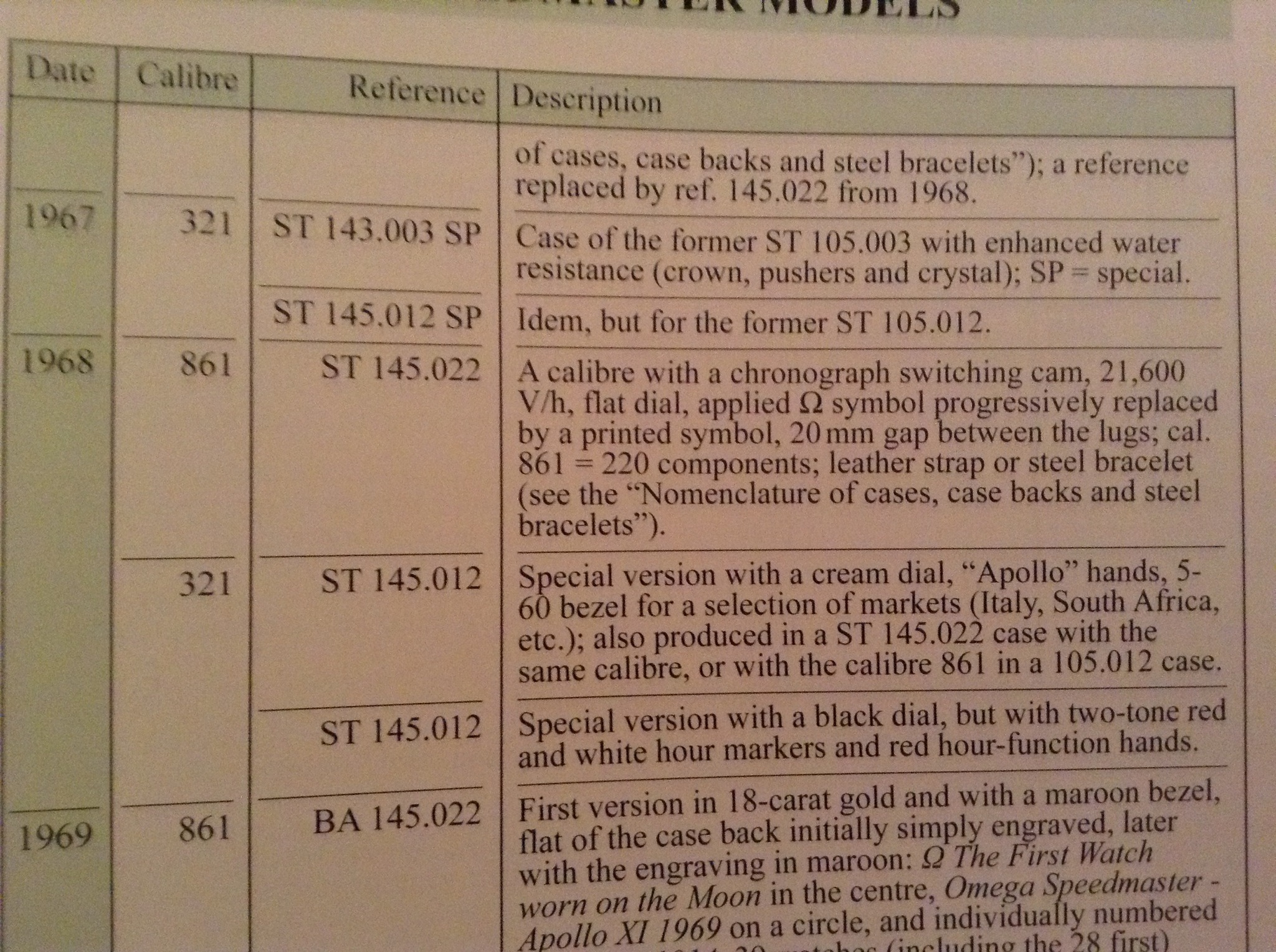

At last, I think we have the answer to this question. The SP stands for Special.
It was a designation used for a short time around 1967 to indicate a 145.012 watch that was a 105.012 case which had been enhanced for water protection. So it looks like this was another transitional watch of limited numbers. [Edit - actually the table makes it look like the 145.012 SP was the standard watch & those with just ref 145.012 are the uncommon ones]
If your wondering where I got this from, it's the tables in the back of A Journey Through Time:
34,272
38,892
Genius find! There' a whole lot of information new to me on that small section of page. I must get that book.
Anyone ever seen a 143.003? I'm certain I haven't.
Brilliant and I must get that (expensive) book someday!
My old 105.012-64 had an "S" prefix...
I wonder if that also signified the same beefed up WR or something else in this case? Thoughts or other examples?
Thanks again for the great research & best,
Tom
3,184
3,856
The list in the good book doesn't mention an "S" reference. Looks like we have a new mystery to solve 😉

Actually, there is an earlier version of this AJTT table on Chuck Maddox's website. It is described as a draft that Marco Richon was working on during 2005 as part of a new book project for Omega.
http://chronomaddox.com/omega/tables/mr/speedy_history_cm.html
But that version doesn't include the 1967 information appearing in A Journey Through Time, which was obviously added during later drafts, and which Richon possibly may not have sent to Chuck.
AJTT by Marco Richon was first published in 2007, a year before Chuck died.

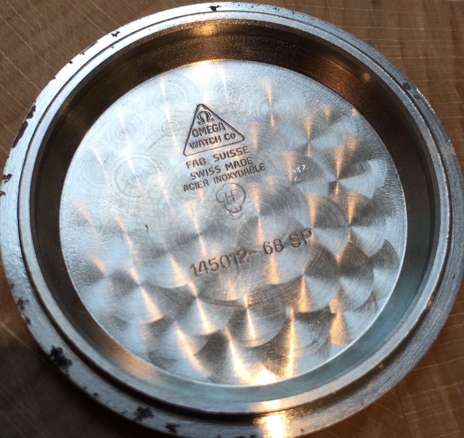

Reviving an old thread....
So we know about 145.012-67 SP, but what about 145.012-68 SP?
Is this caseback kosher?
ben
Singapore
5,317
24,330
SP = speciale poussoirs
"Special pushers"
Upgraded for better water resistance
