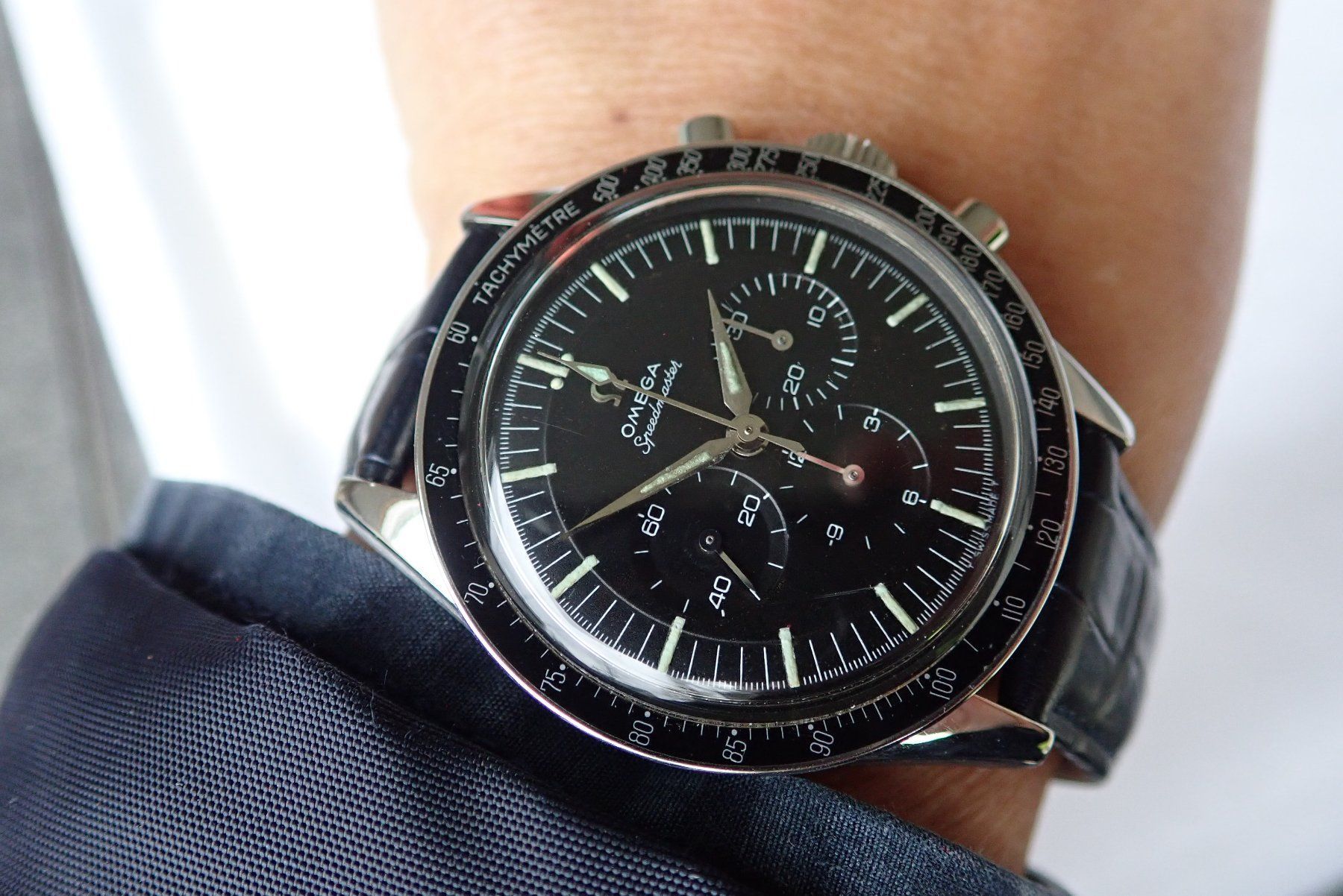

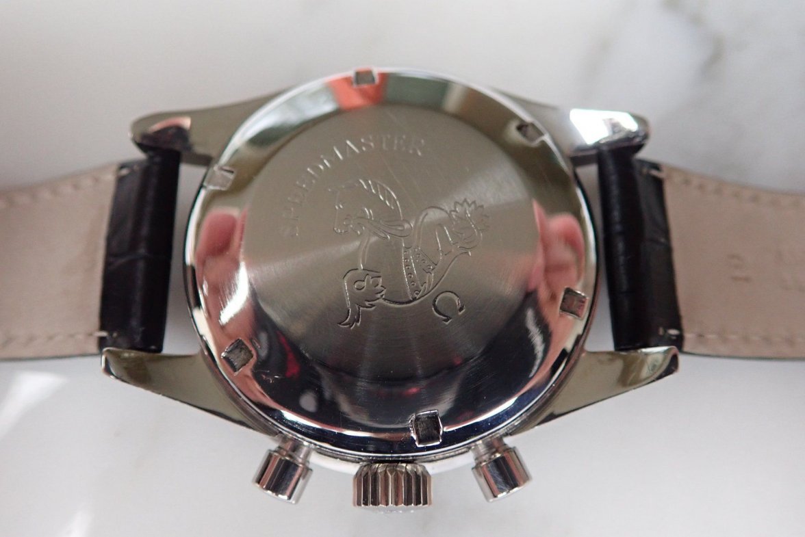

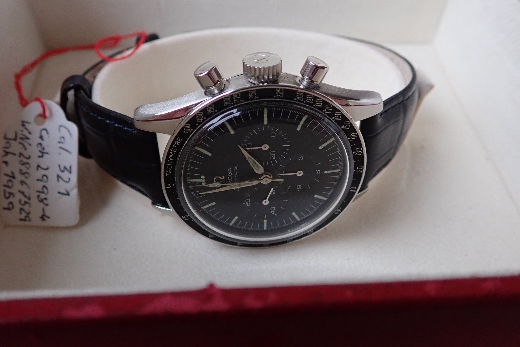

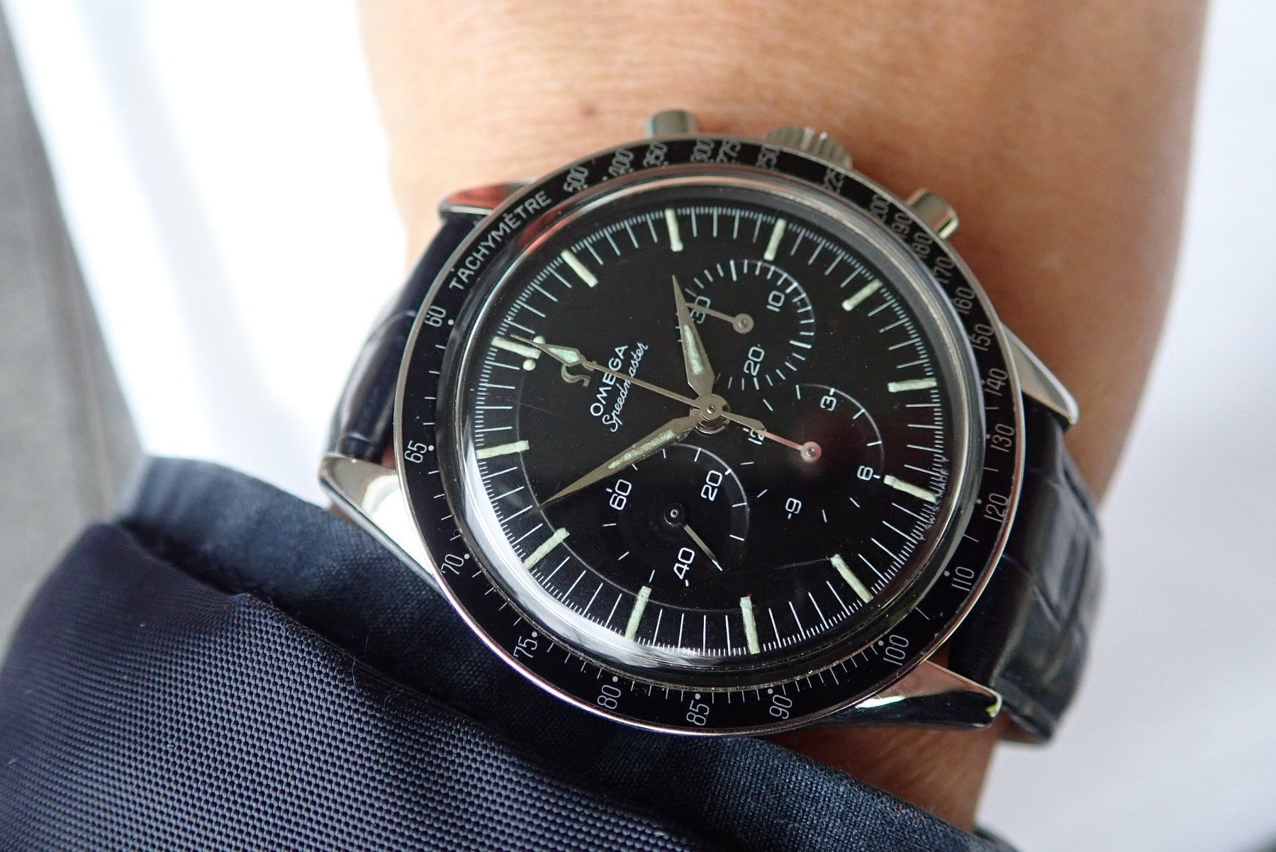

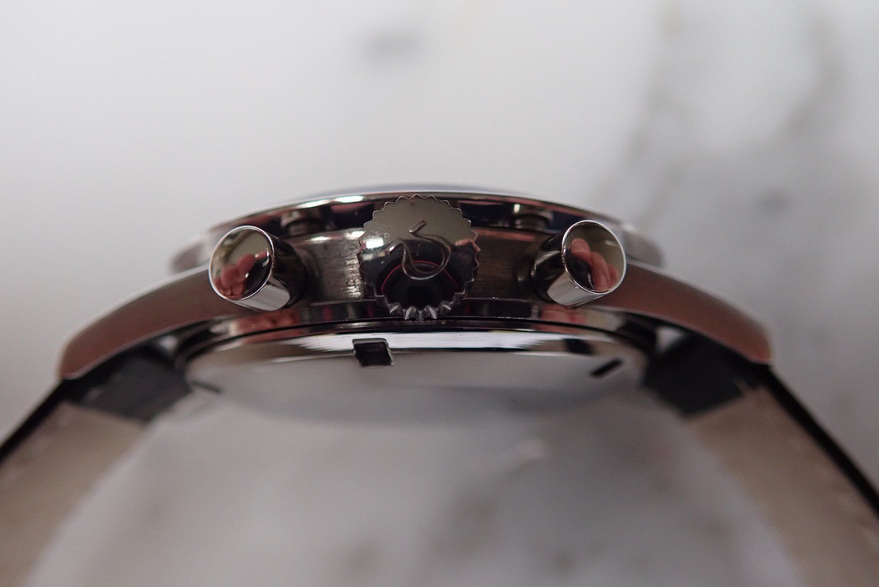

found the following watch online.
Was wondering if anyone can spot something wrong with this watch. always thought about buying a vomtage 2998, but one in its original condition.

Hello,
This watch has many issues.

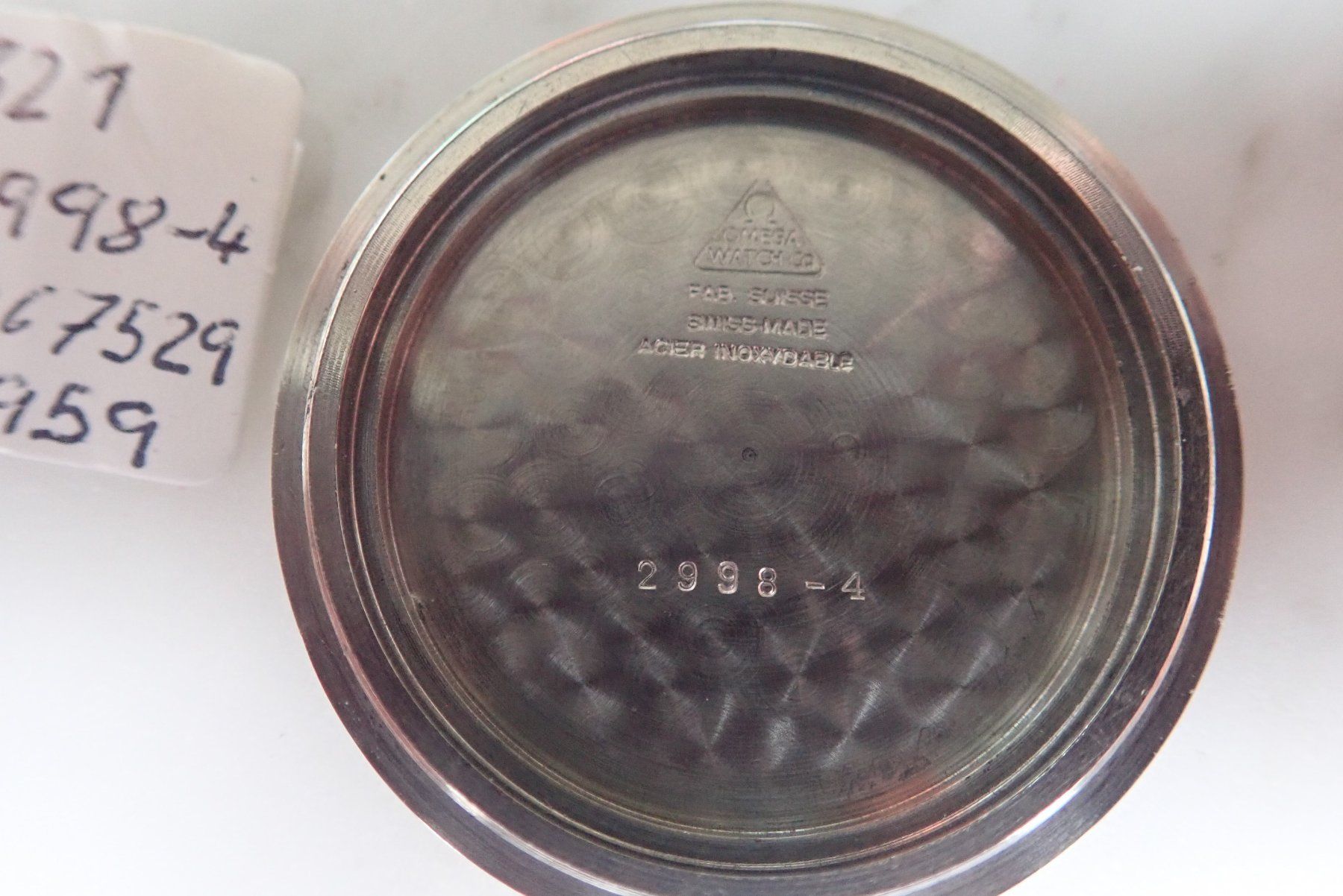

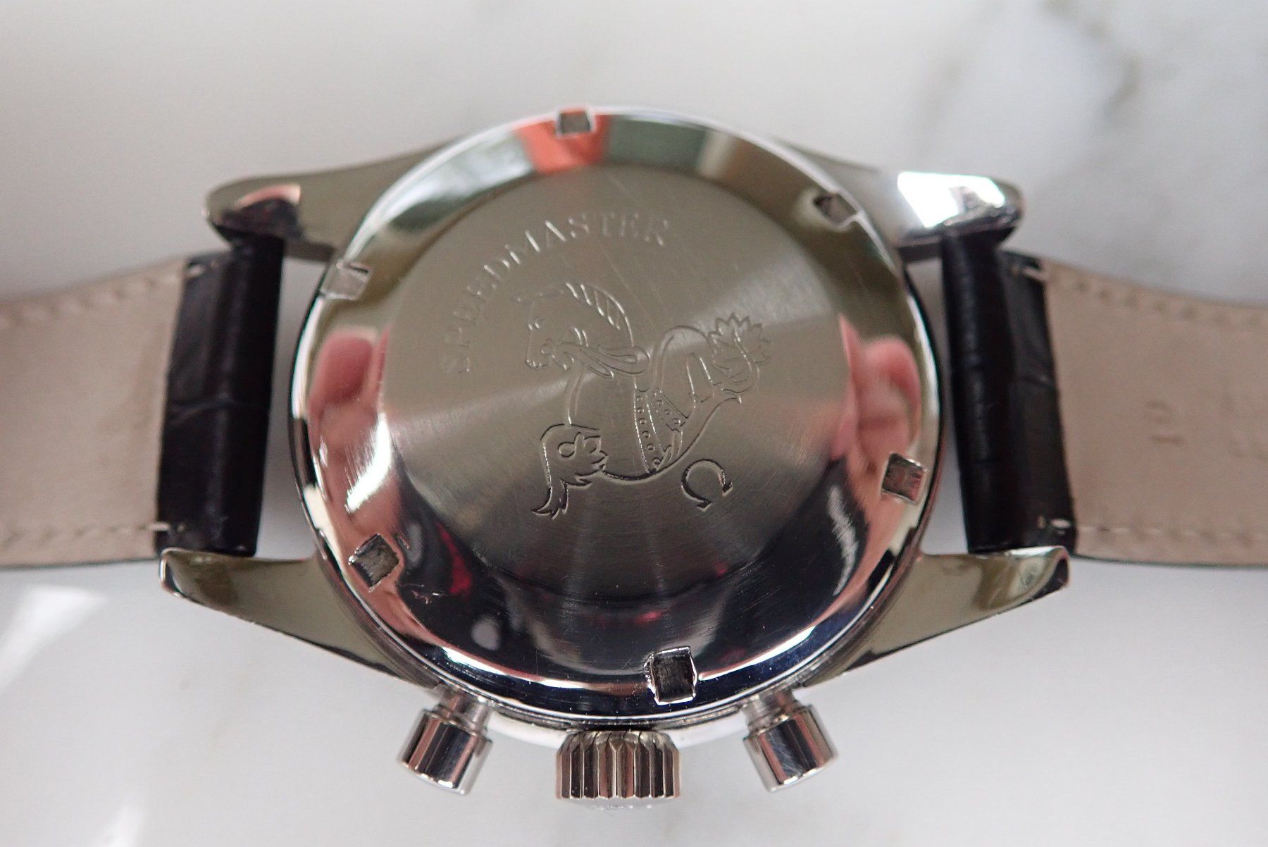

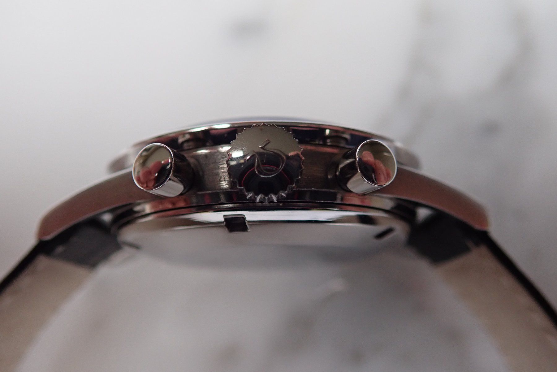

First, the case is polished to death (look at that caseback 🤦).

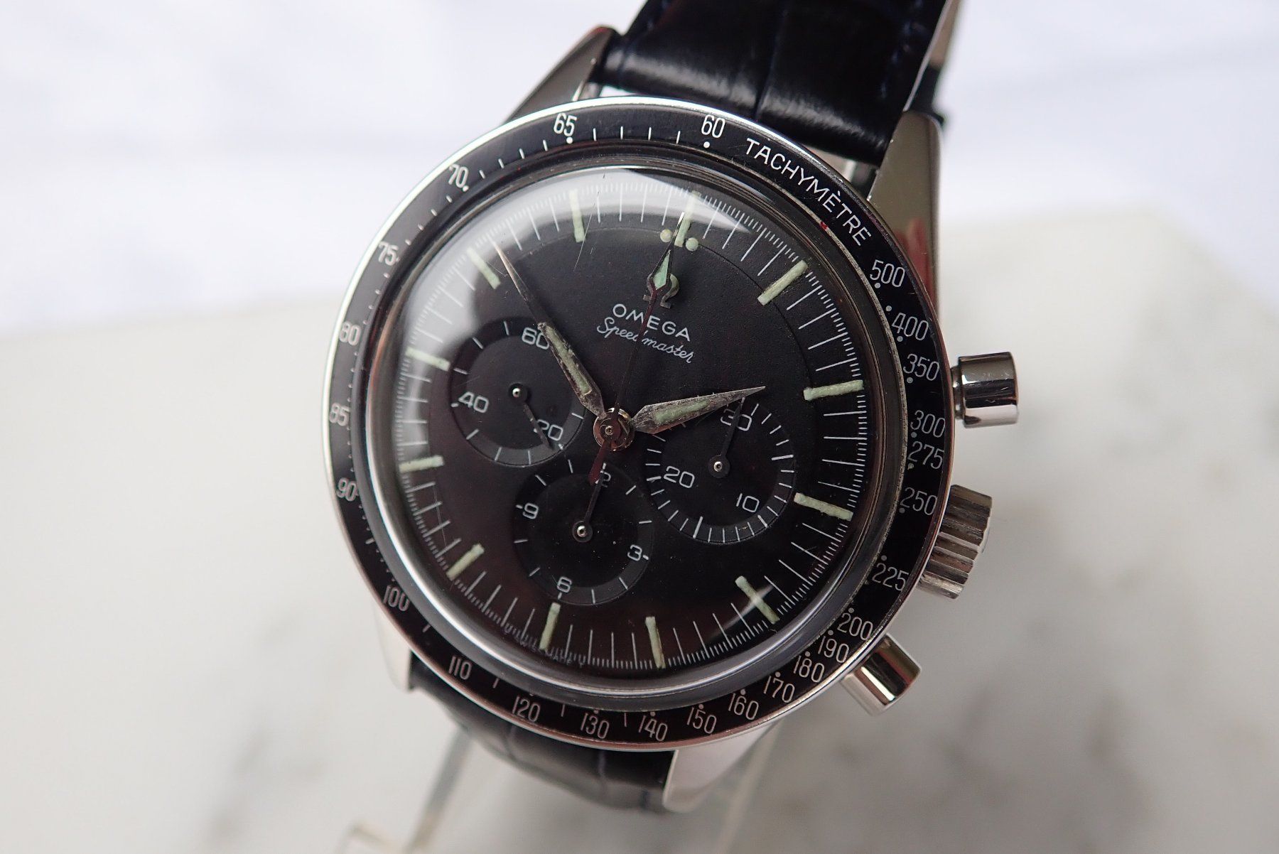

Second, the dial is from another reference (105.003) so incorrect for this 2998.
Third, the hands are not correct and relumed, as well as the dial.

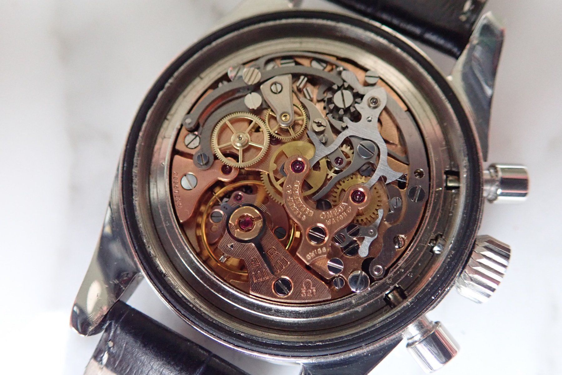

Fourth, the movement is also not correct for this reference (serial is way out of the exepected one and some parts say it's a later one).
To me, it's a total no go (unless it's 100€/$/£).

If you want one in original condition this isn’t for you.
Start by checking the dial and movement
567
1,112
Does that movement number start 23? I think that's around 1966. This should be around 17's/18's
