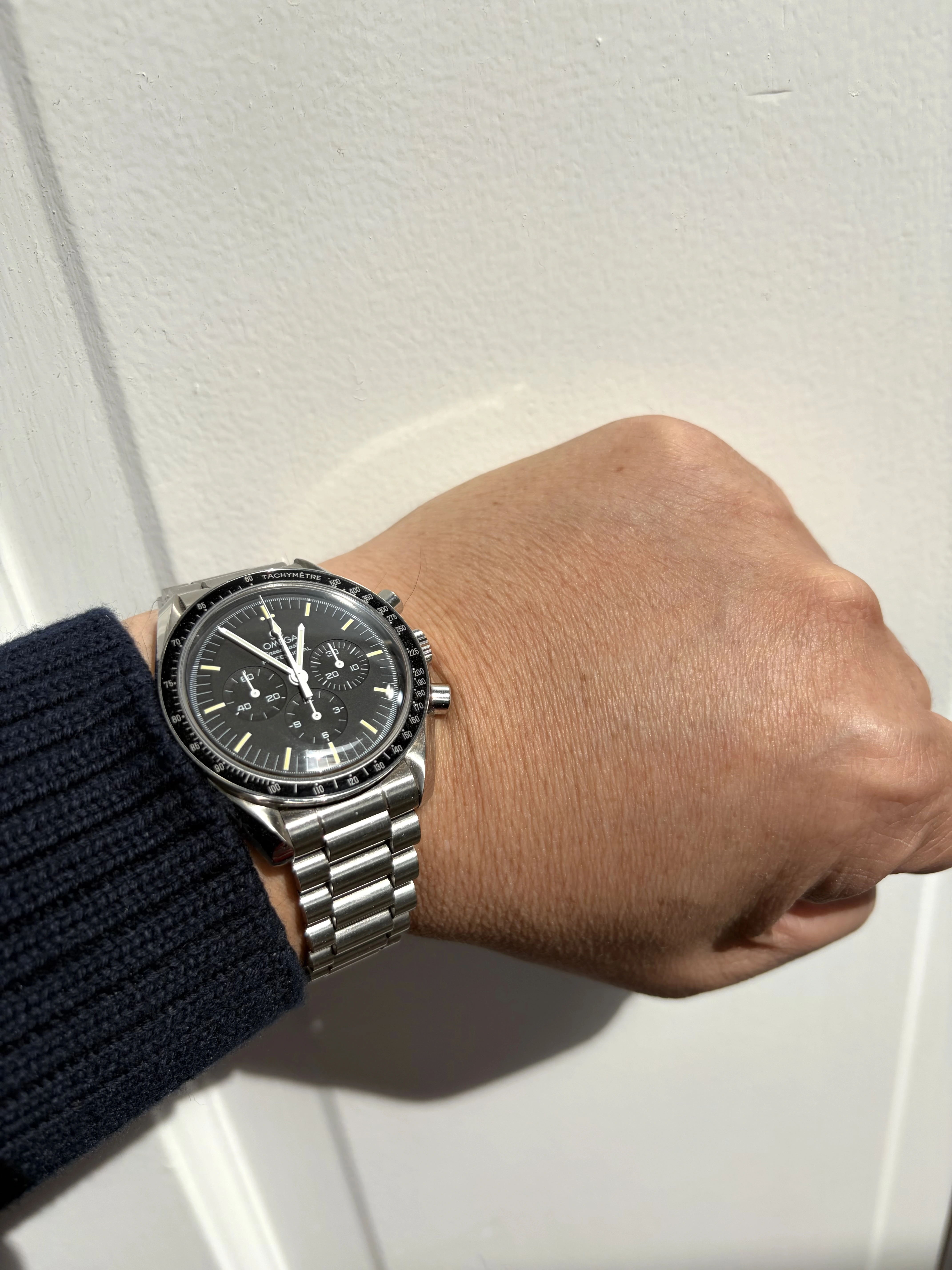

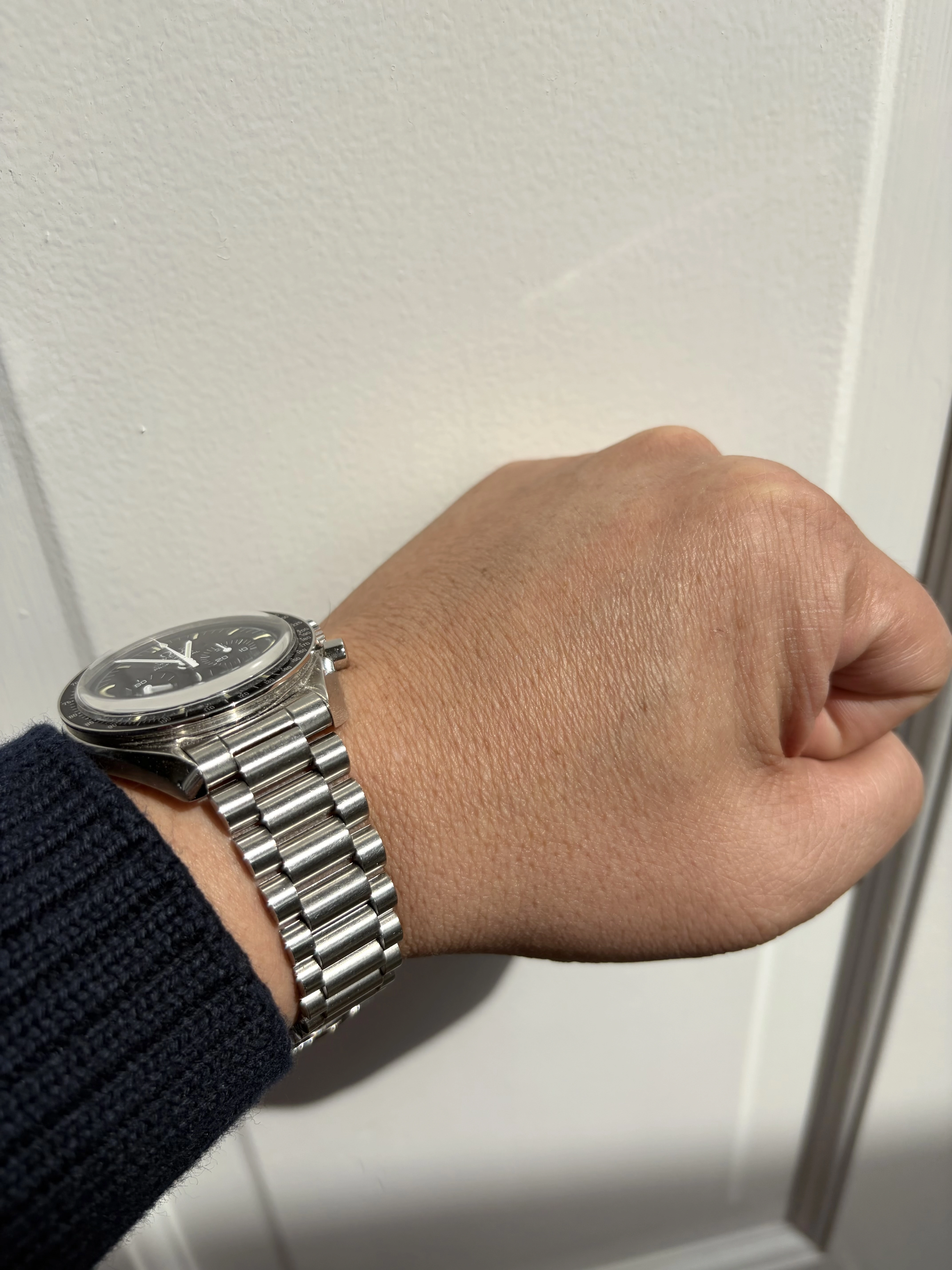

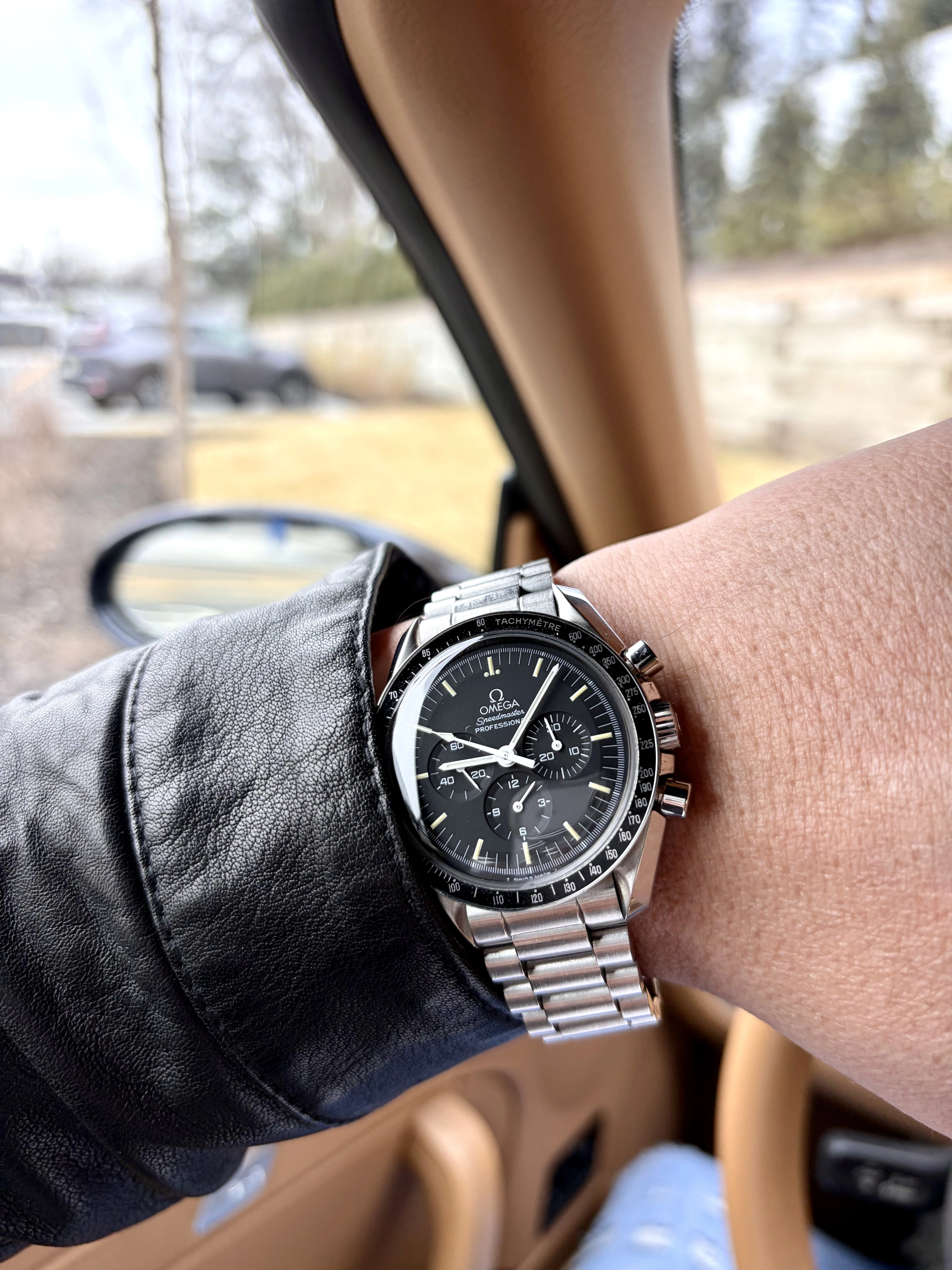

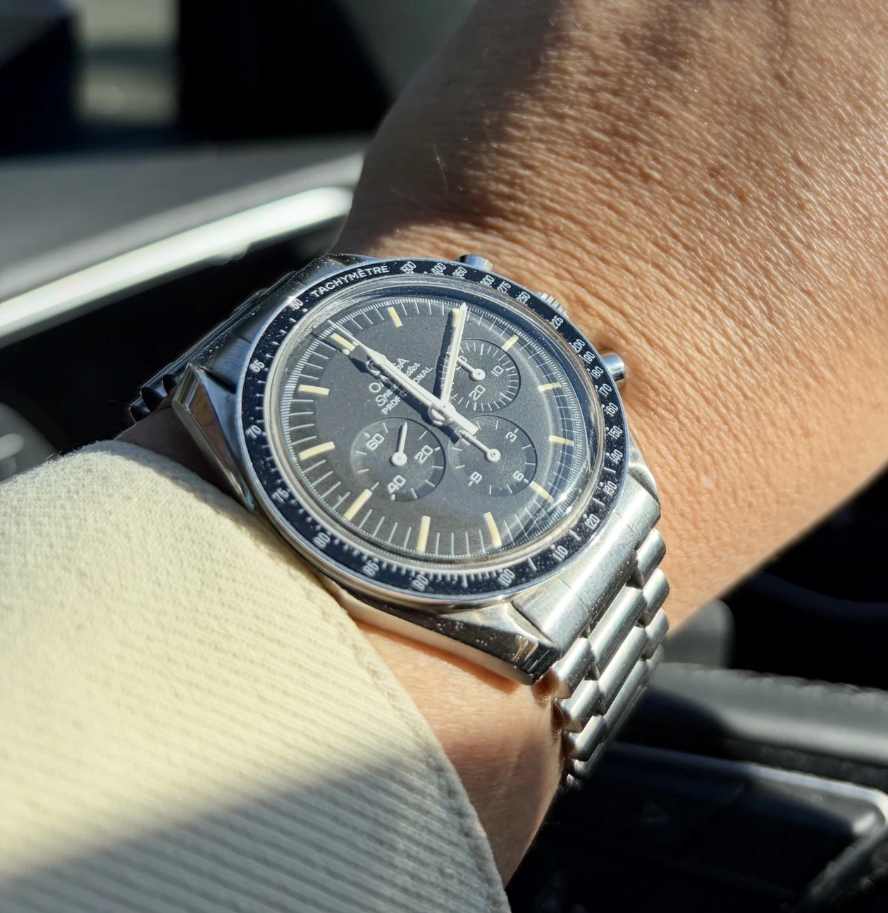

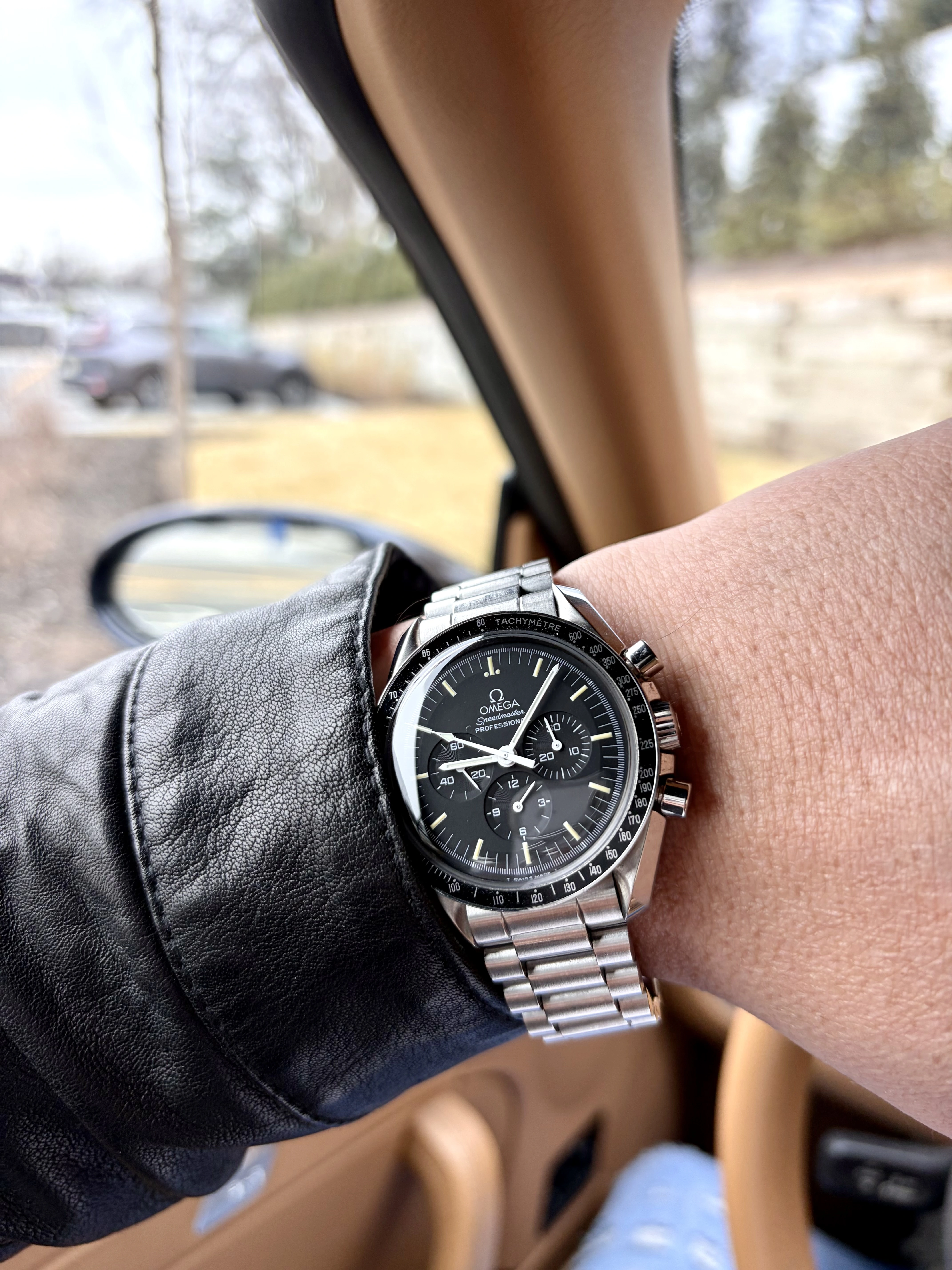

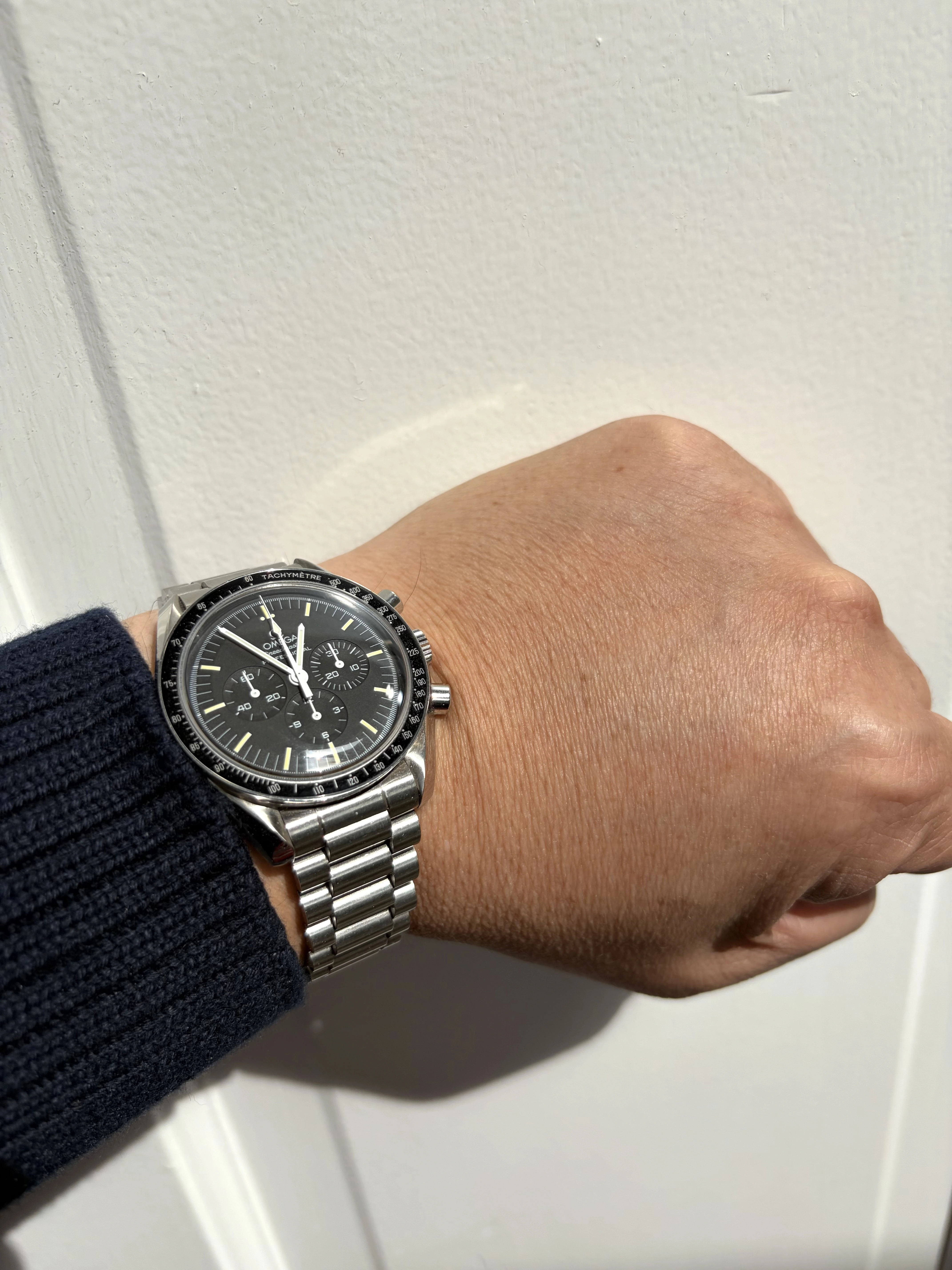

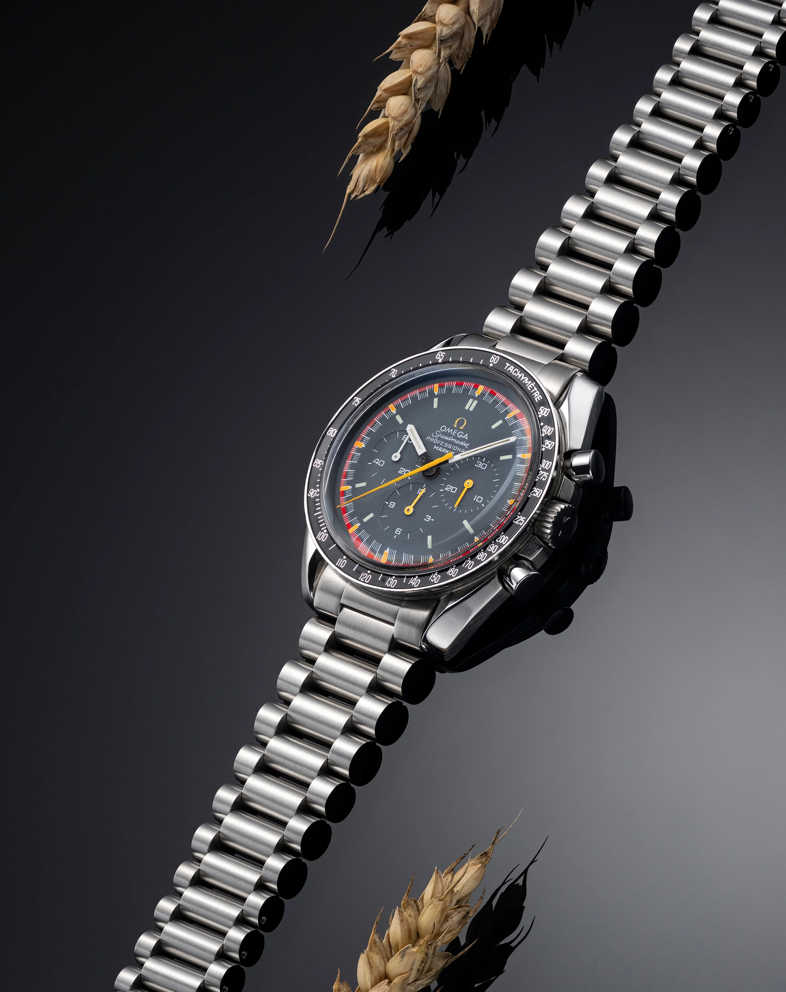

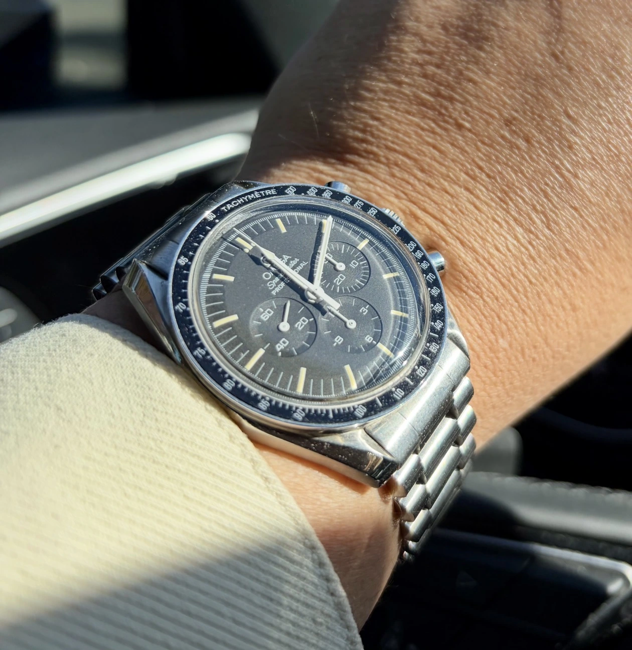

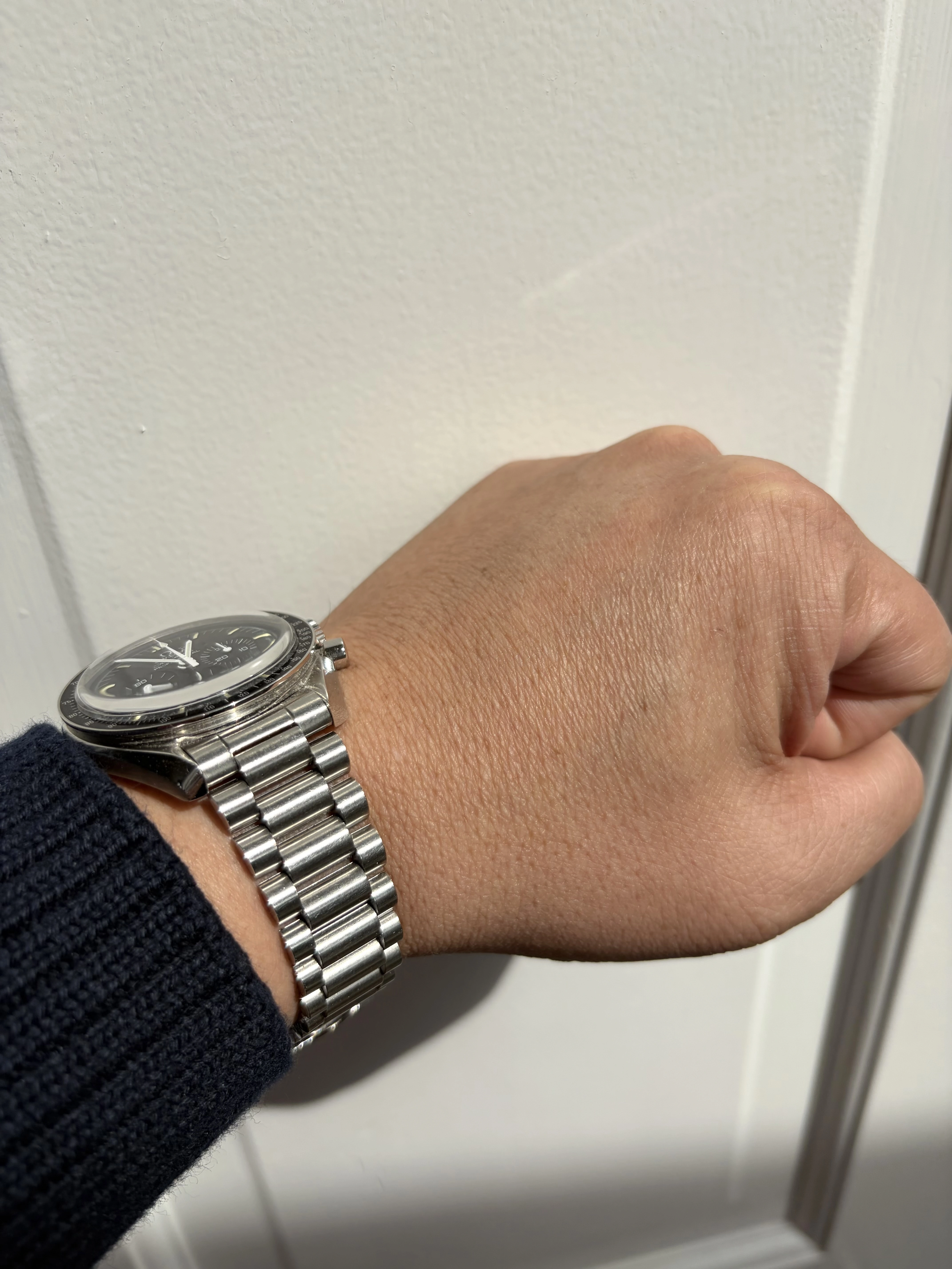

I first had the Uncle Seiko 1450 copy on my 861 Speedy and it is a great value for the money and looks good. The only two things I didn’t like about it was the clasp (I replaced with a genuine Omega clasp which made it much better), the sharpness of the sides of the bracelet, and the thing I found most annoying (the endlinks are not like the more genuine rounded 808s). The 808 endlinks look a lot better on the watch head. The price difference is huge though, so value wise, the Uncle Seiko or Forster is way to go. For me, I just had to have the genuine 1450 with 808 links and don’t regret it.
1st pic below of my Speedy on the flat angled end link of the Uncle Seiko 1450 copy and then all the following pics of the watch on the 1450/808.
31
277
Amazing photos Risto! I need to up my picture taking game. Lol.
