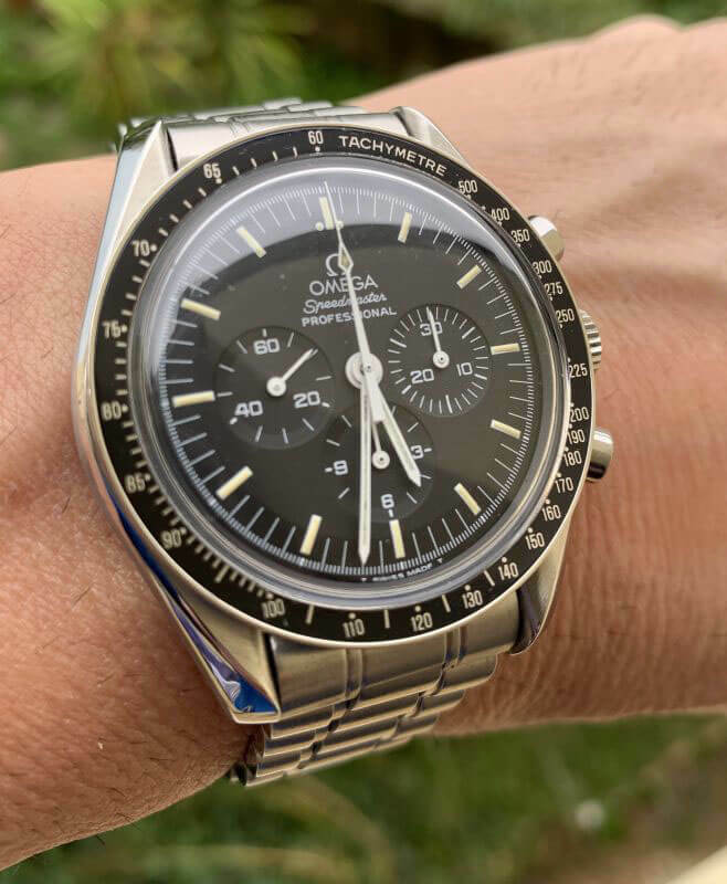

Good evening,
what do Speedmaster experts think about this one?
I'd say it's a 145.022-71 but with a replaced bezel, is it?
Thanks, Roger

It’s hard to tell if the dial has a step. At least on my phone. Can you clearly see it?

Fonts wrong for a step dial. That’s an 80’s dial. No serif DNN also 80’s.
so it’s just a 145.022 from the 80’s as it is presented.

Early '90s - either one of the last 145.022s or one of the earlier 3590.50s

Nice yellow lume for a 90s piece. Too bad the case isn't sharper.

The only thing visible to suggest -71 or before is the pointy subdial hands. -74 and later would have more blunt tips.

If the bracelet is period correct, puts it at 89-96

I concur this is not a 145.022-71.
And regardless of the watch ref. it looks totally overpolished.

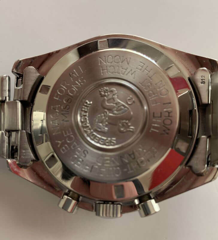

I think from early 90s. Dial is from 90s, and I think caseback is from early 90s. Same with bezel. If you have serial, try IloveMySpeedmaster.com and see what it tells you. Serial is on the lug.

You can just make out a serial number on the lug by the "812"

If you can please provide us the movement first number we could try to understand the batch production 😉

Thank you all. The watch is offered at ebay.de as a 145.022, but the seller doesn't show a picture of the movement. In any case, I won't go for it and wait for a better option.

It still a 145.022 technically.... What do you think is wrong with it?
it’s just a late tritium piece.
you must be about 30 years younger than me, I can't make it out. I can't hear very well either. 😀

The 812 on the right side seems a lot more distinct than on the left side.
It's a pity there aren't better photos, as it looks like the side of the watch without the pushers has a nice curve to it, but the side with the pushers seems straight, as if it were over polished...

yup 812 end links and you can faintly see a serial on the upper right lug if you look hard.
