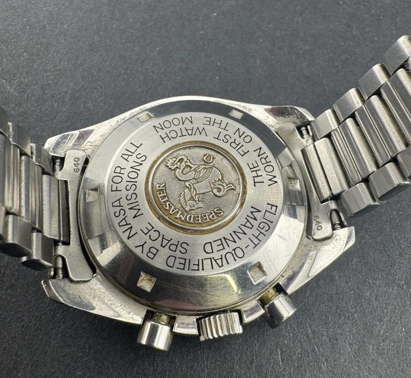

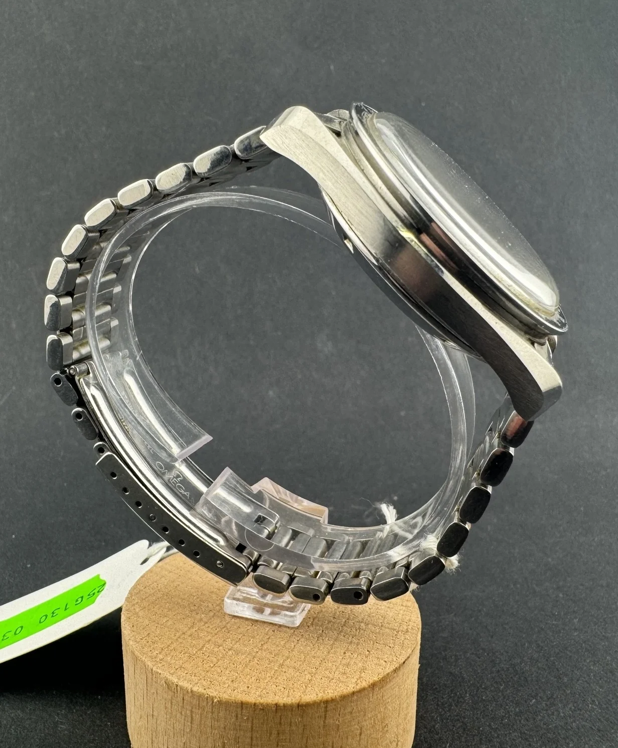

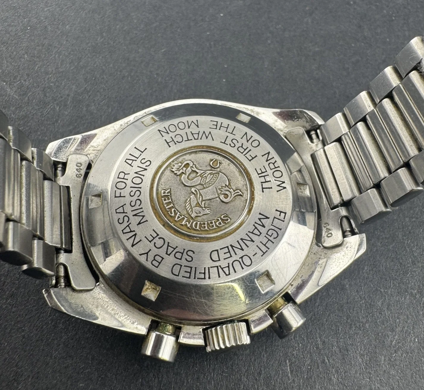

No reference nr, no movement picture, no picture of the inside of the caseback.
But the serial nr on the paper placed the watch as a 145.022-71.

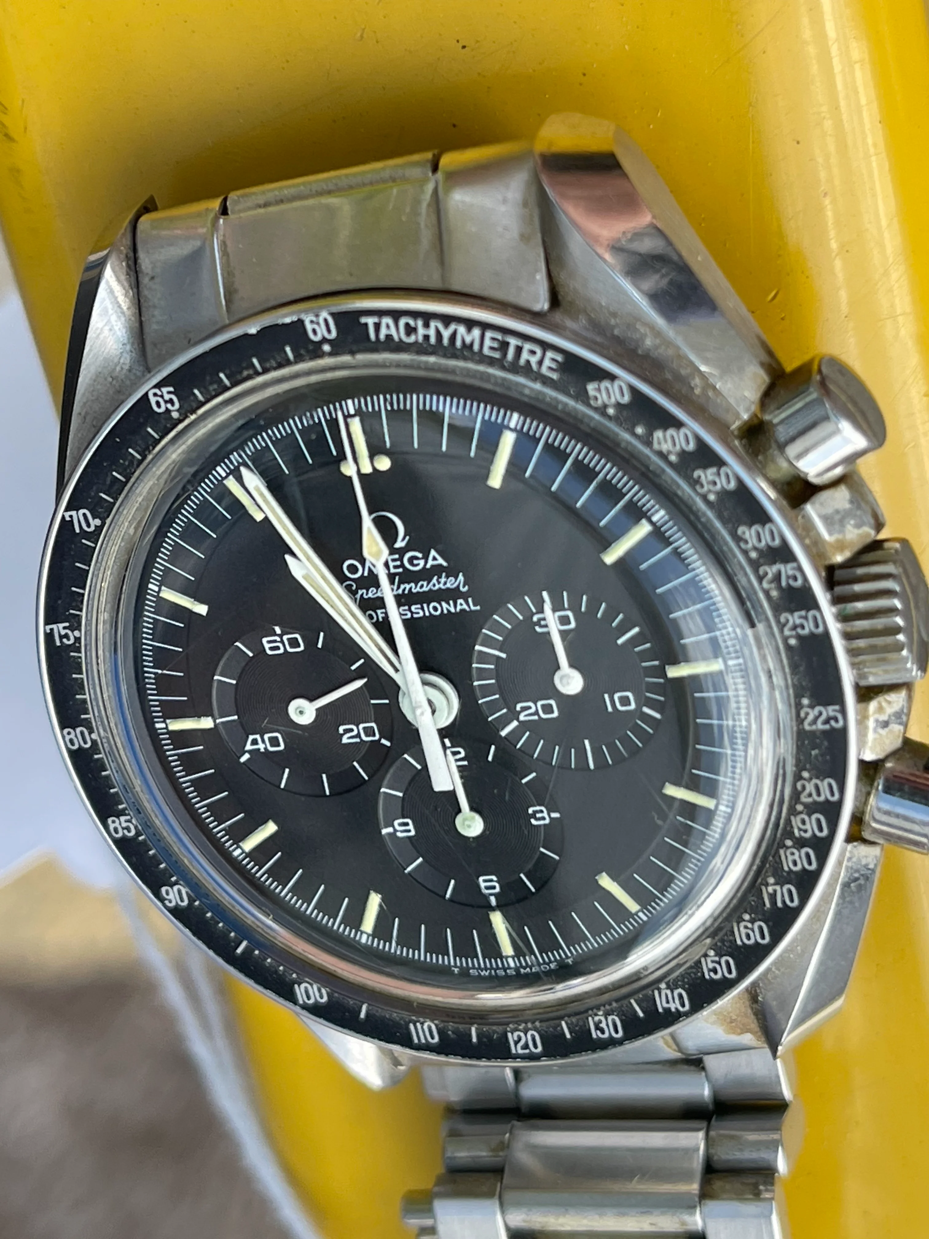

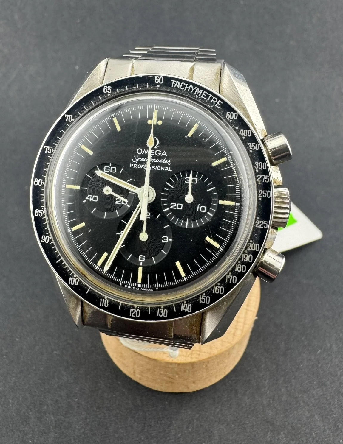

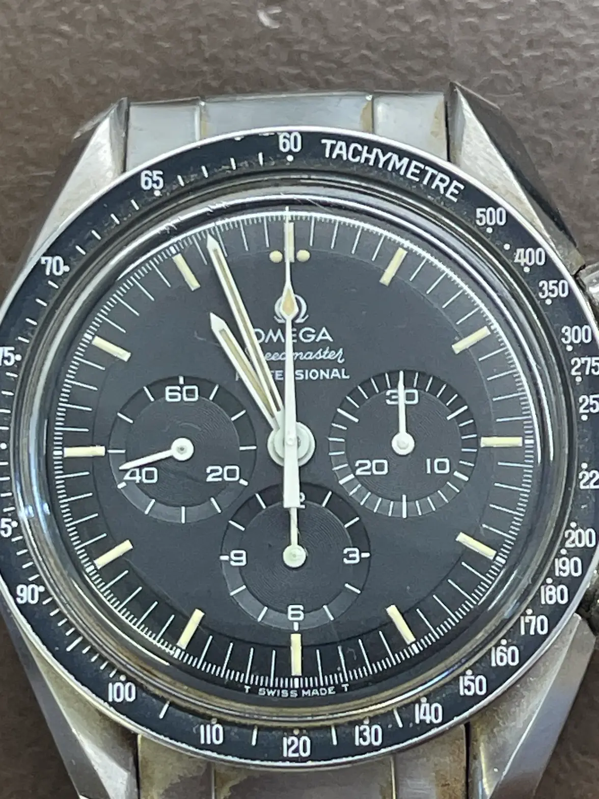

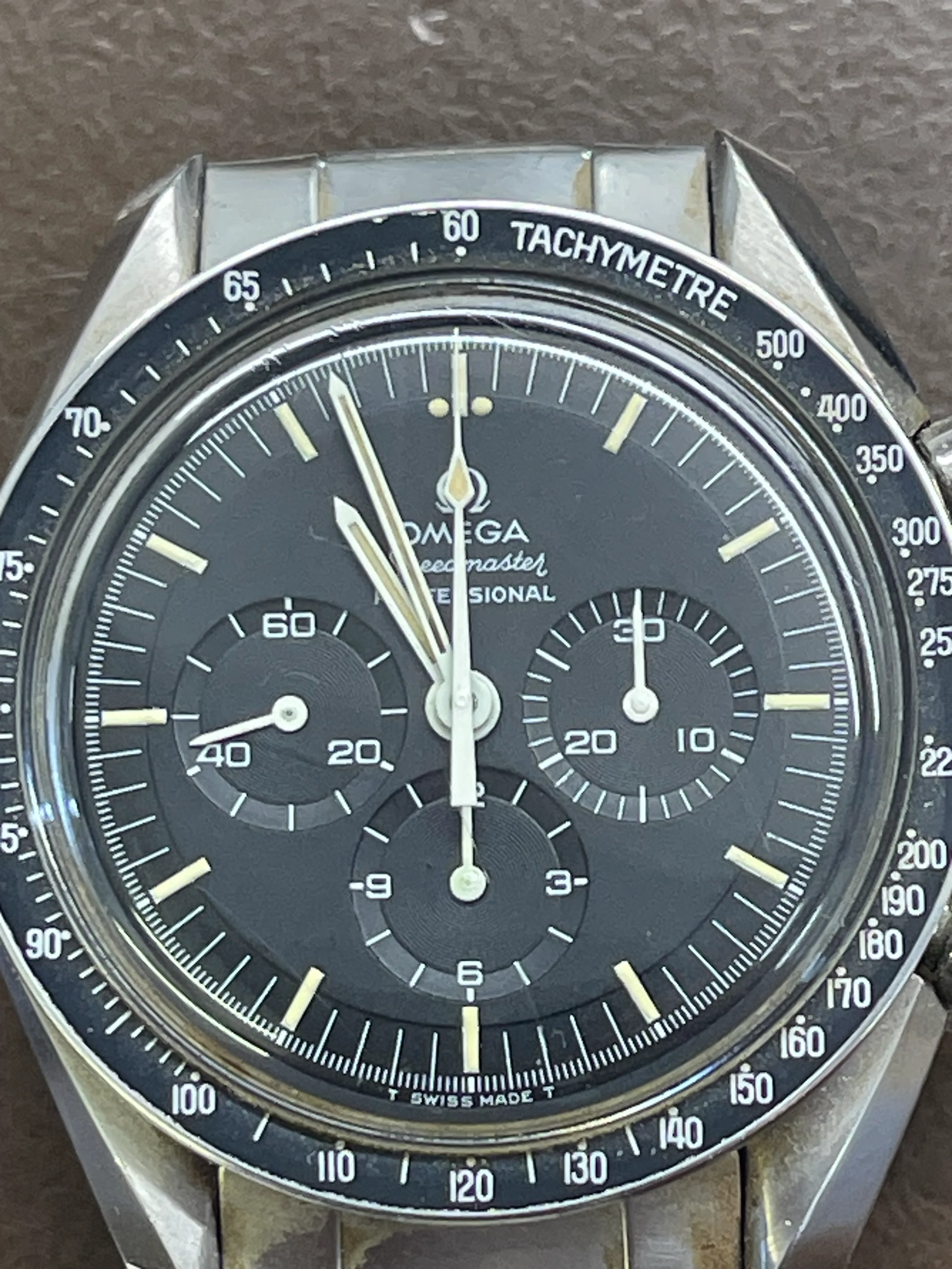

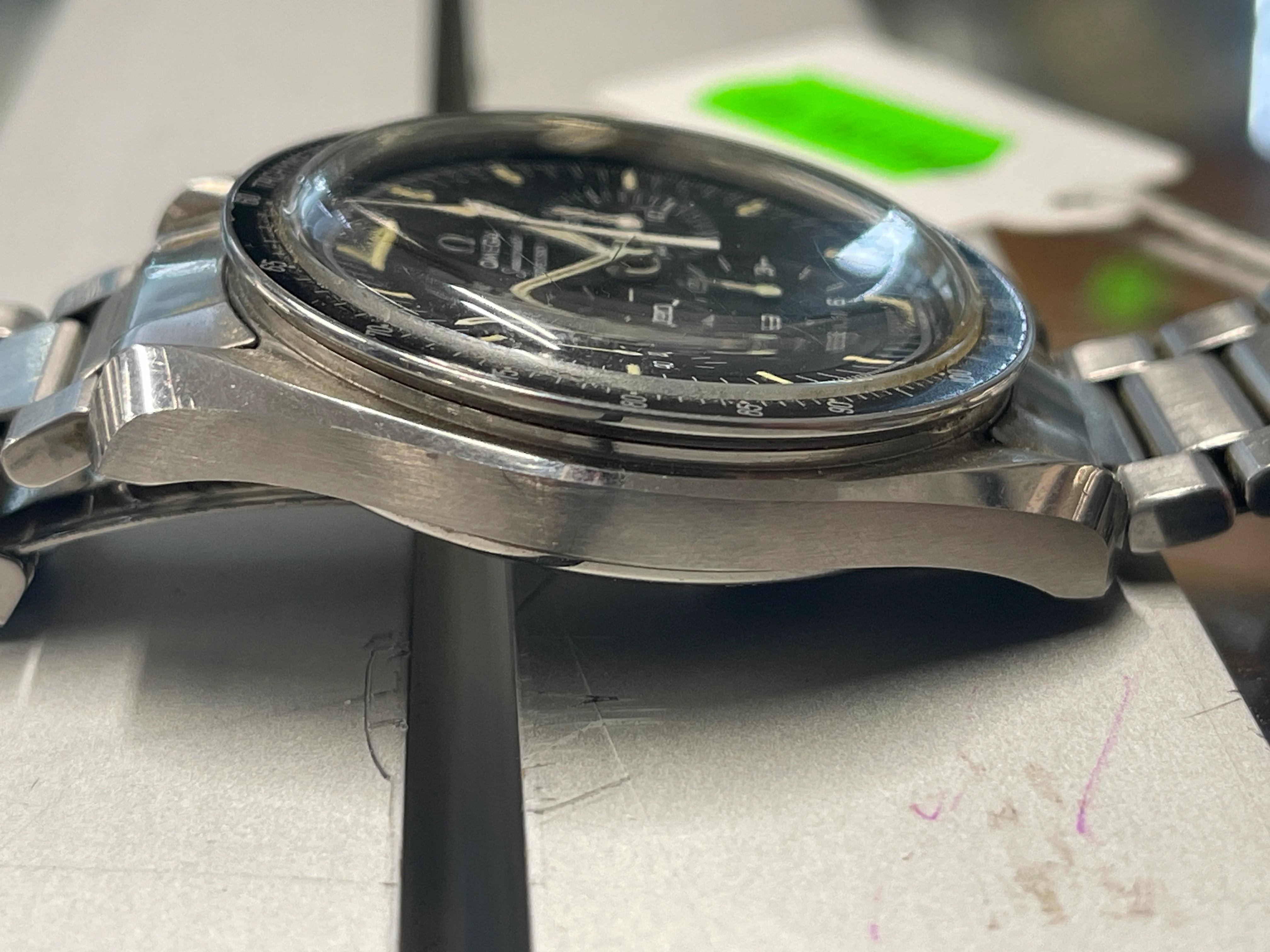

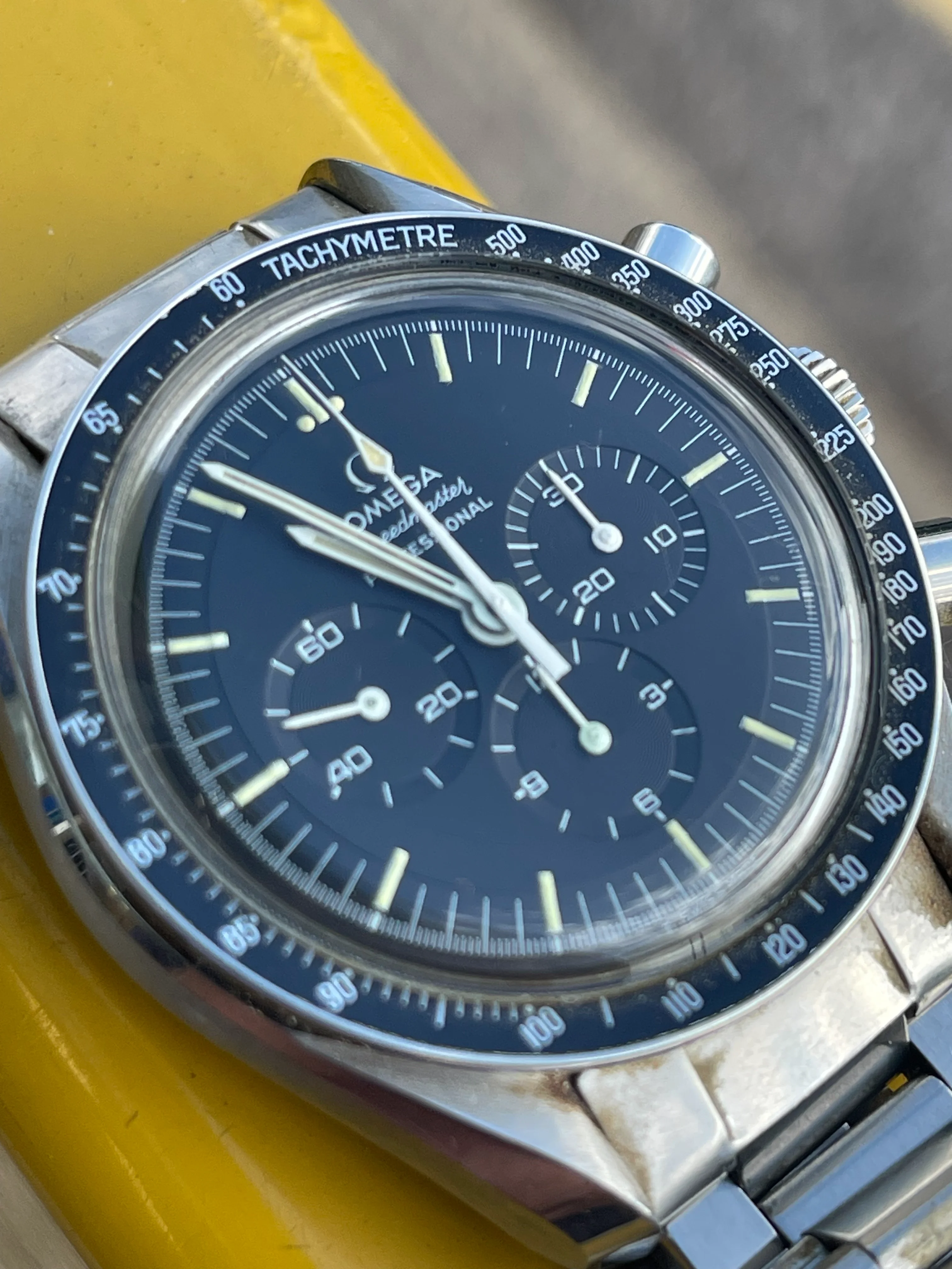

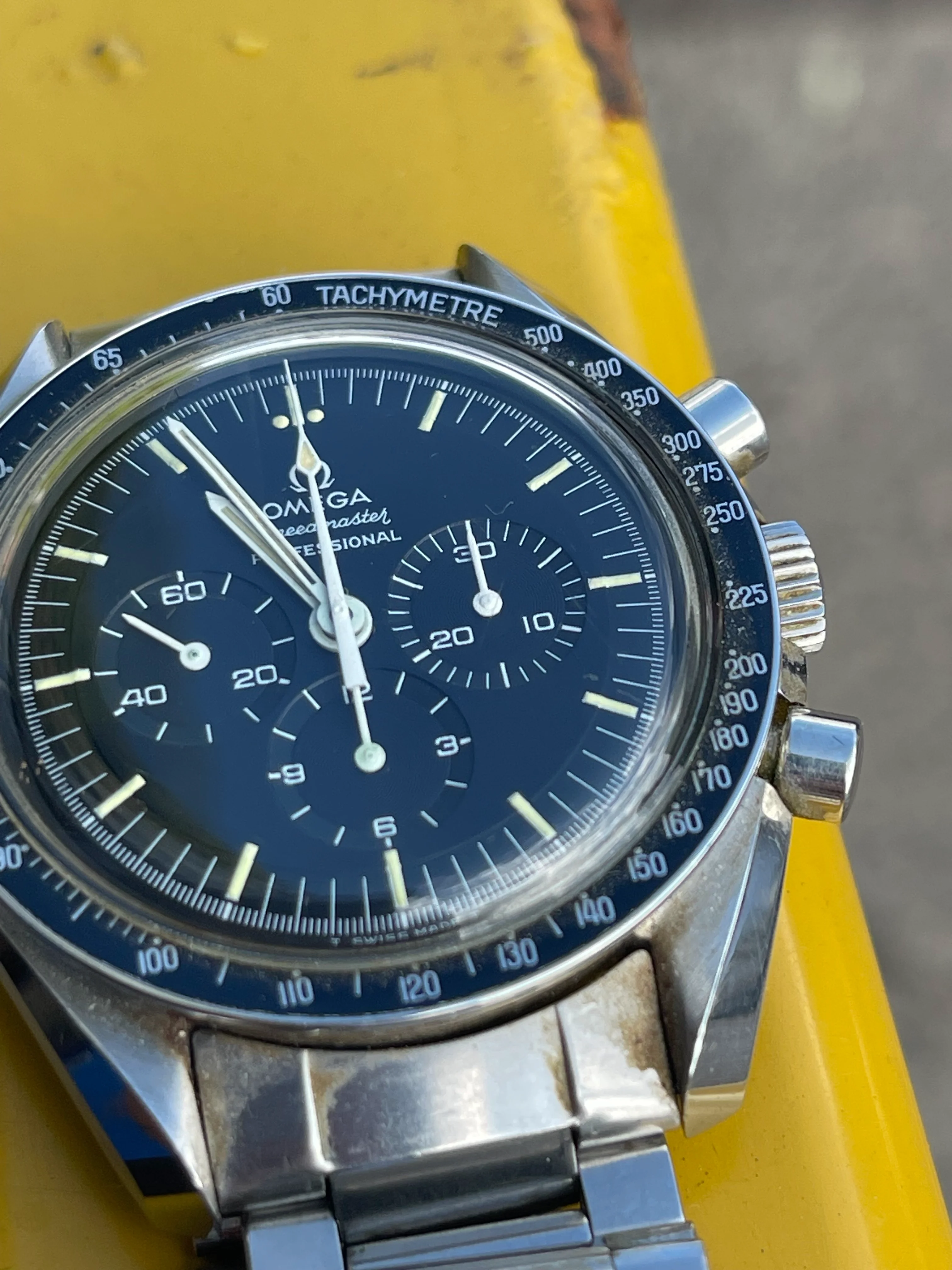

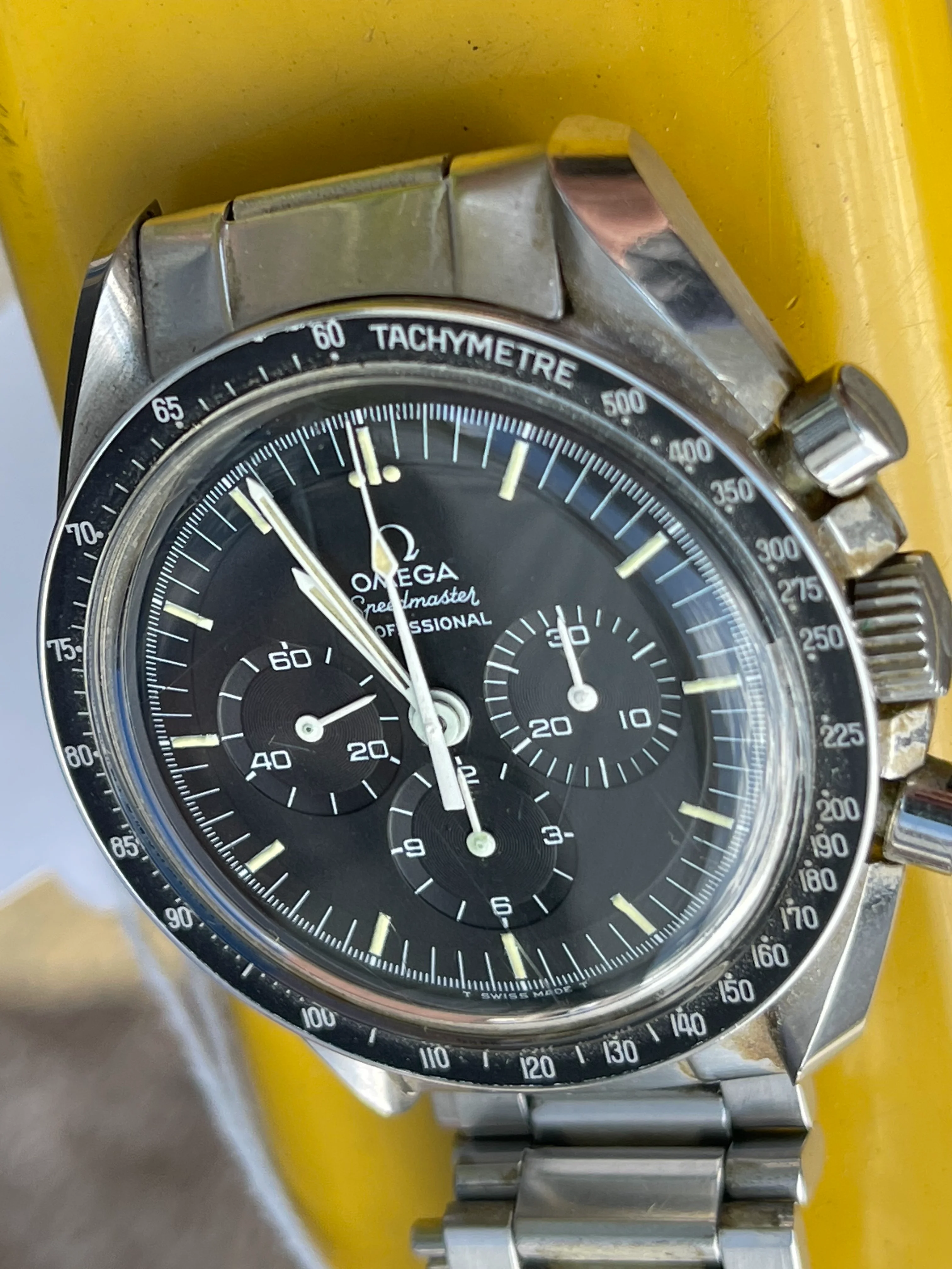

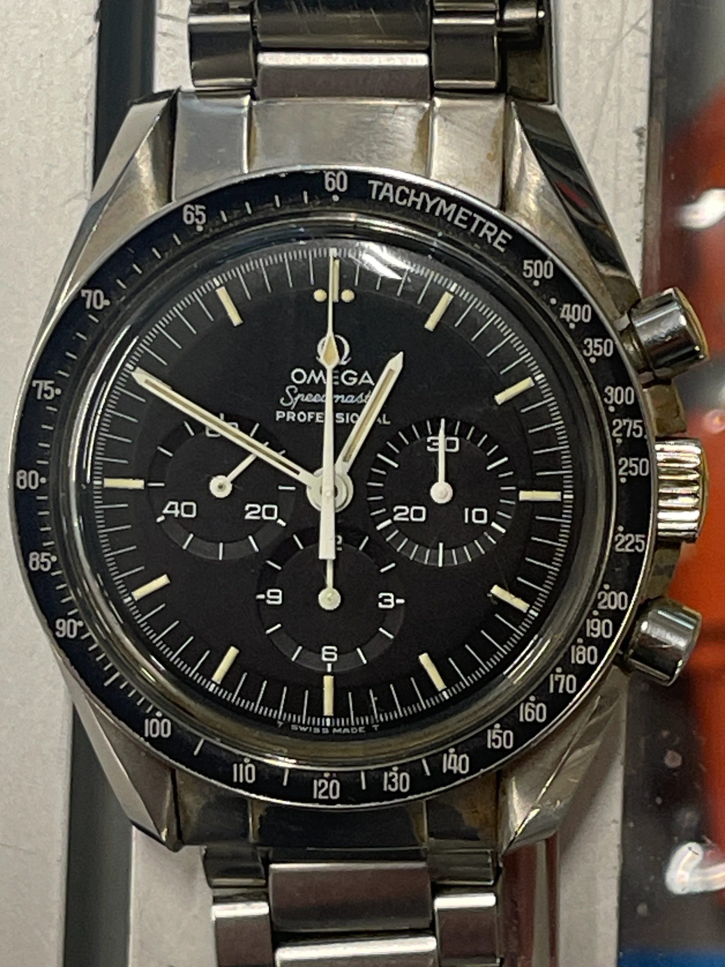

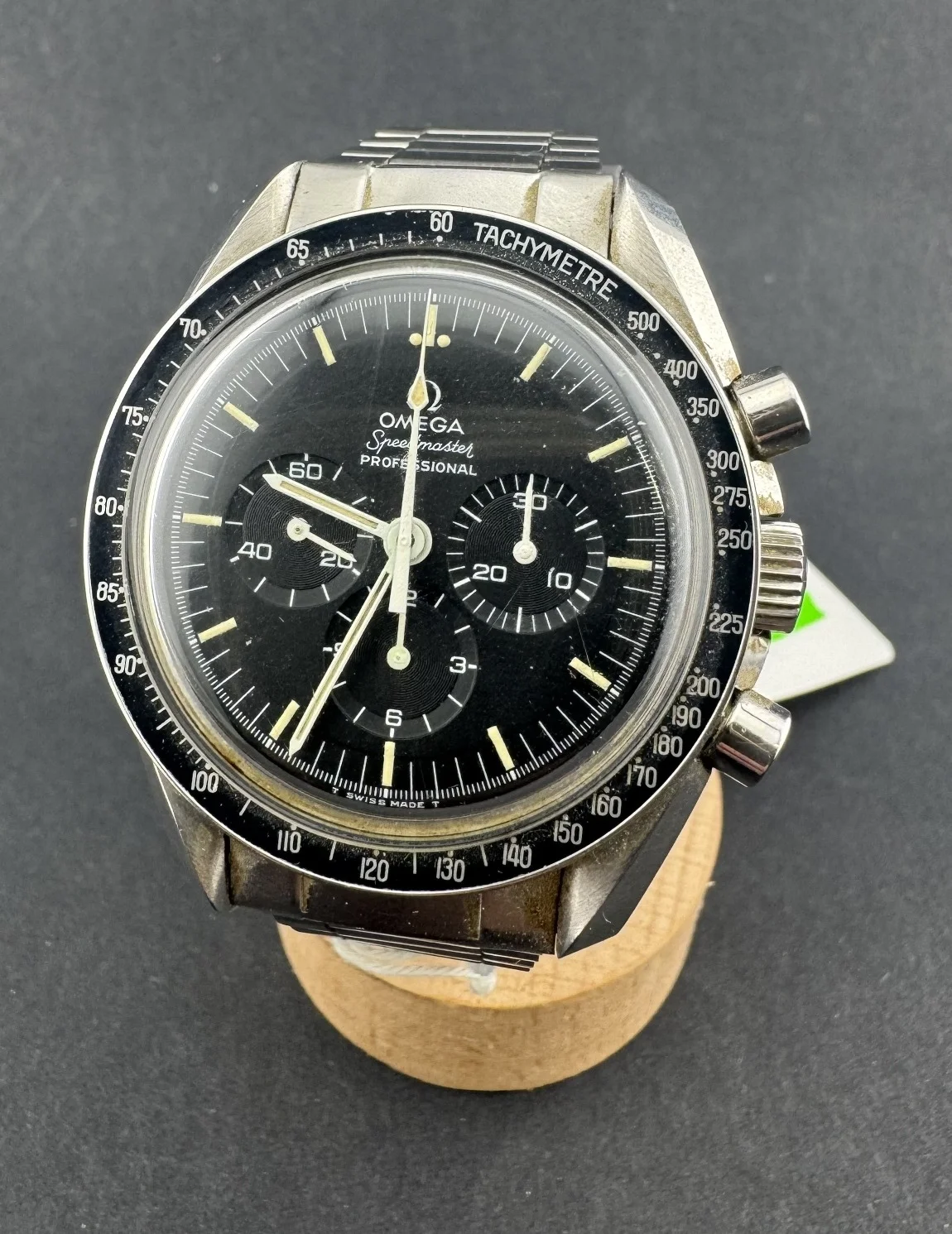

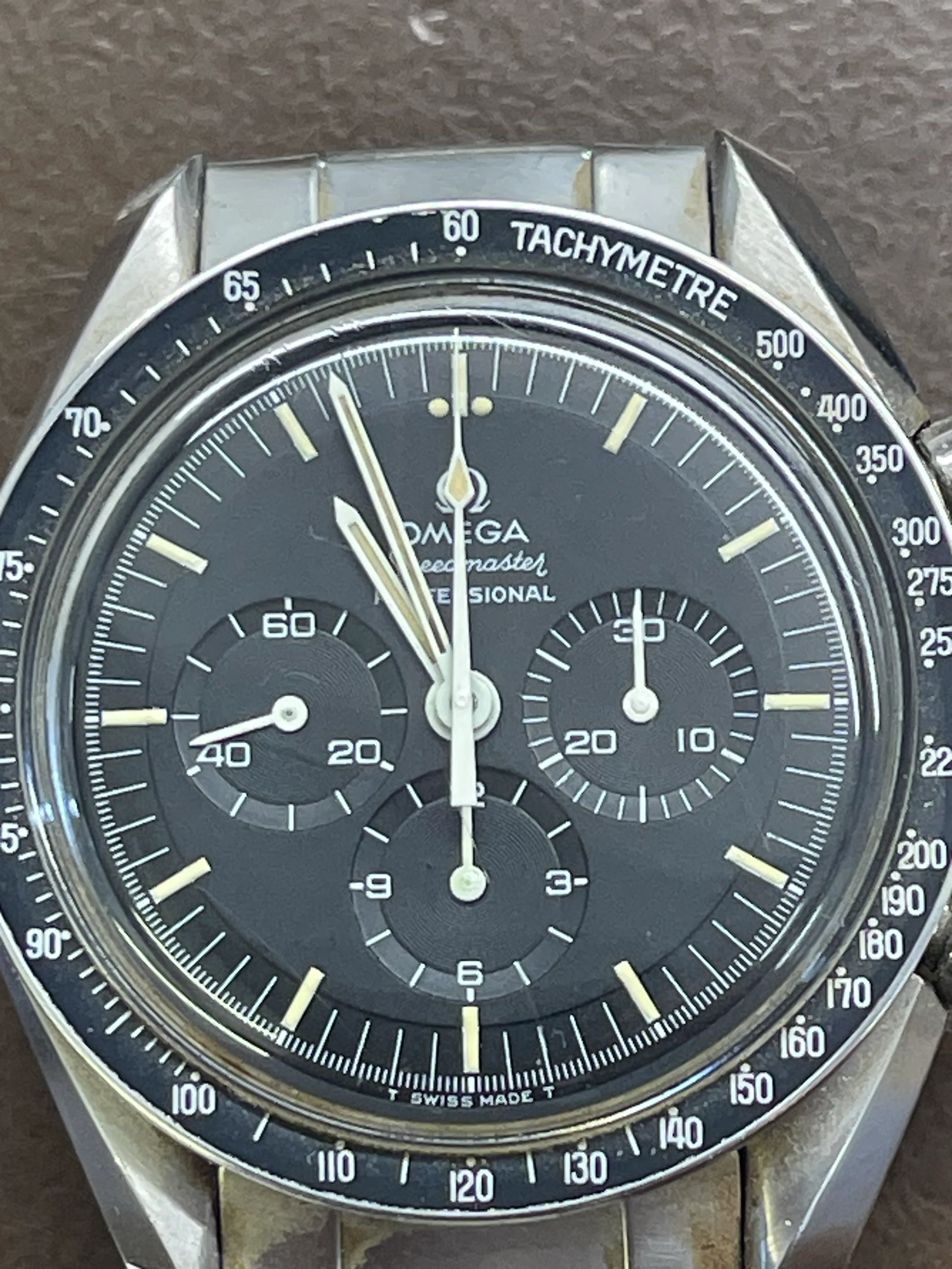

The first thing that hit me was that the hands had been adjusted, really sad about that….

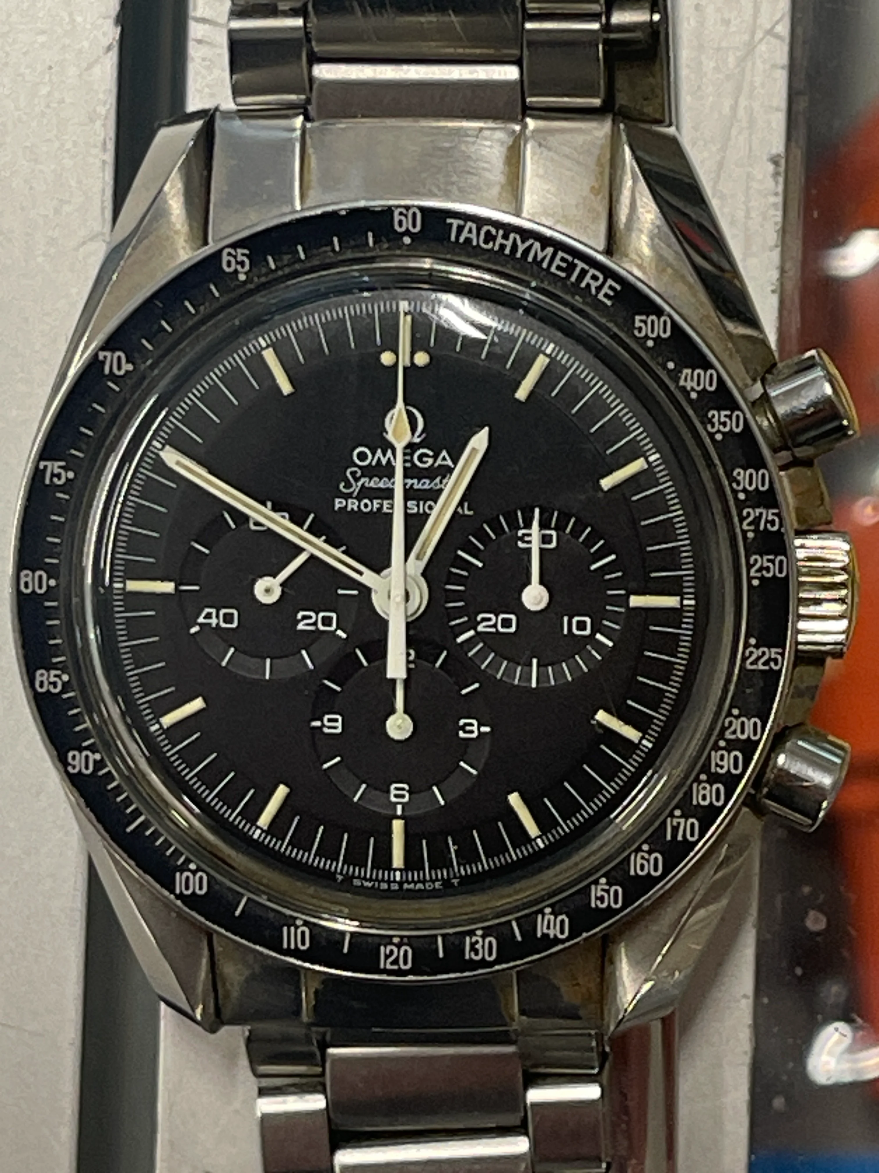

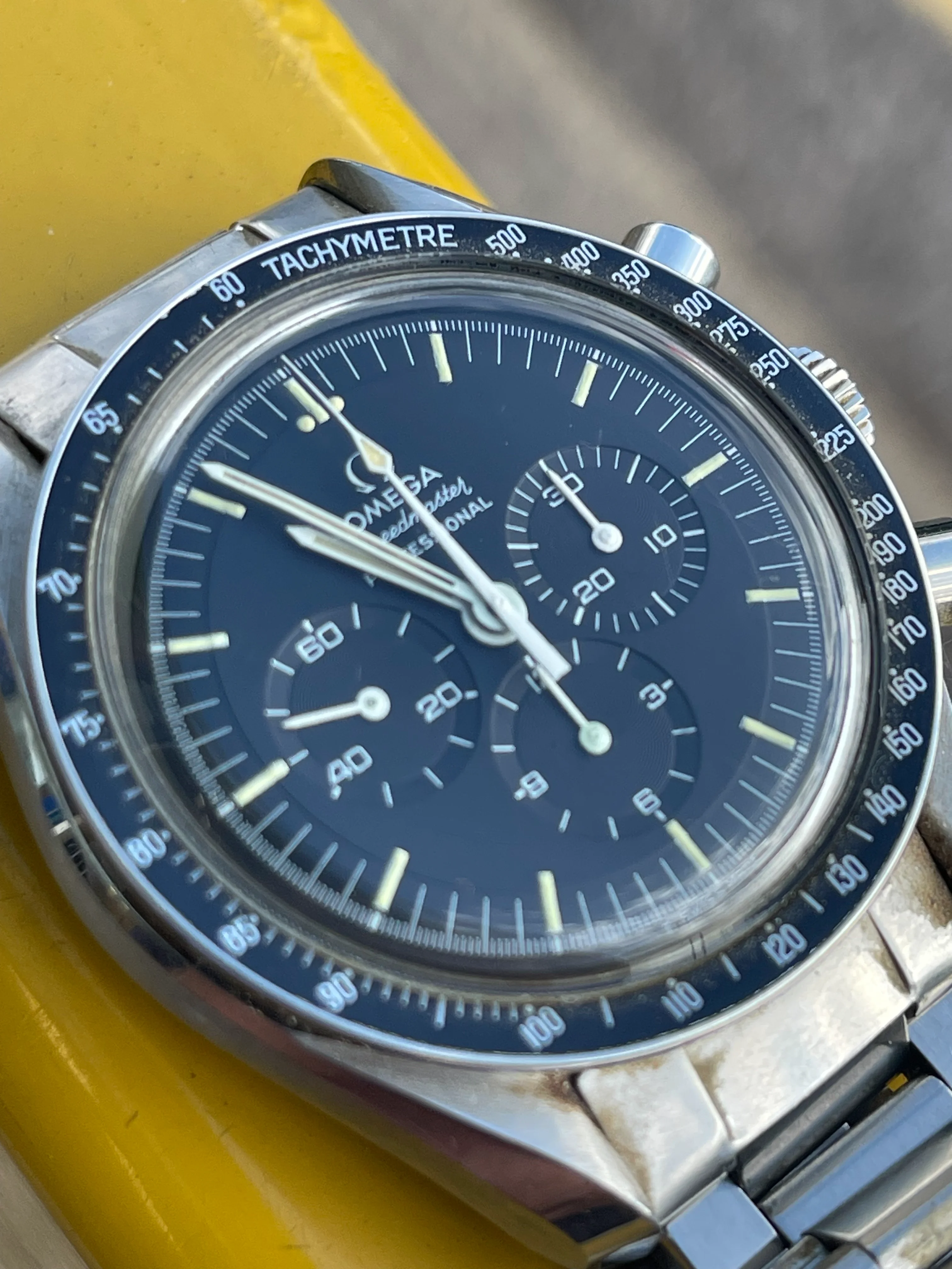

The dial, very promising, but to grade this one above Good, I had to have better (more detailed pictures), and I did not receive better ones.
The lumeplots are very attractive, without any loss or dirt/mold.
The bezel has only a few small marks, but quite dirty, I had to assume that it would clean up nicely.
The carrier ring is very nice and clean.

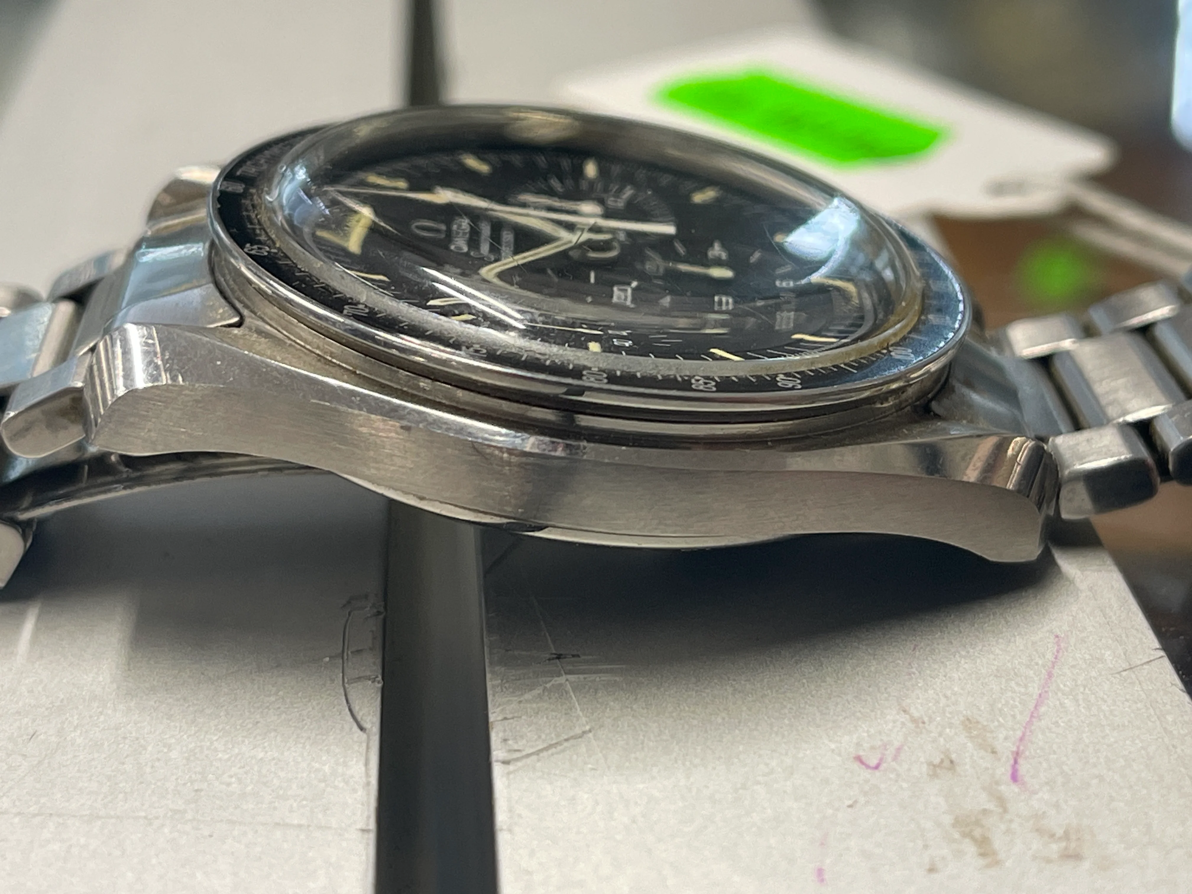

The case and case back are very very nice - the Star of the Show!!

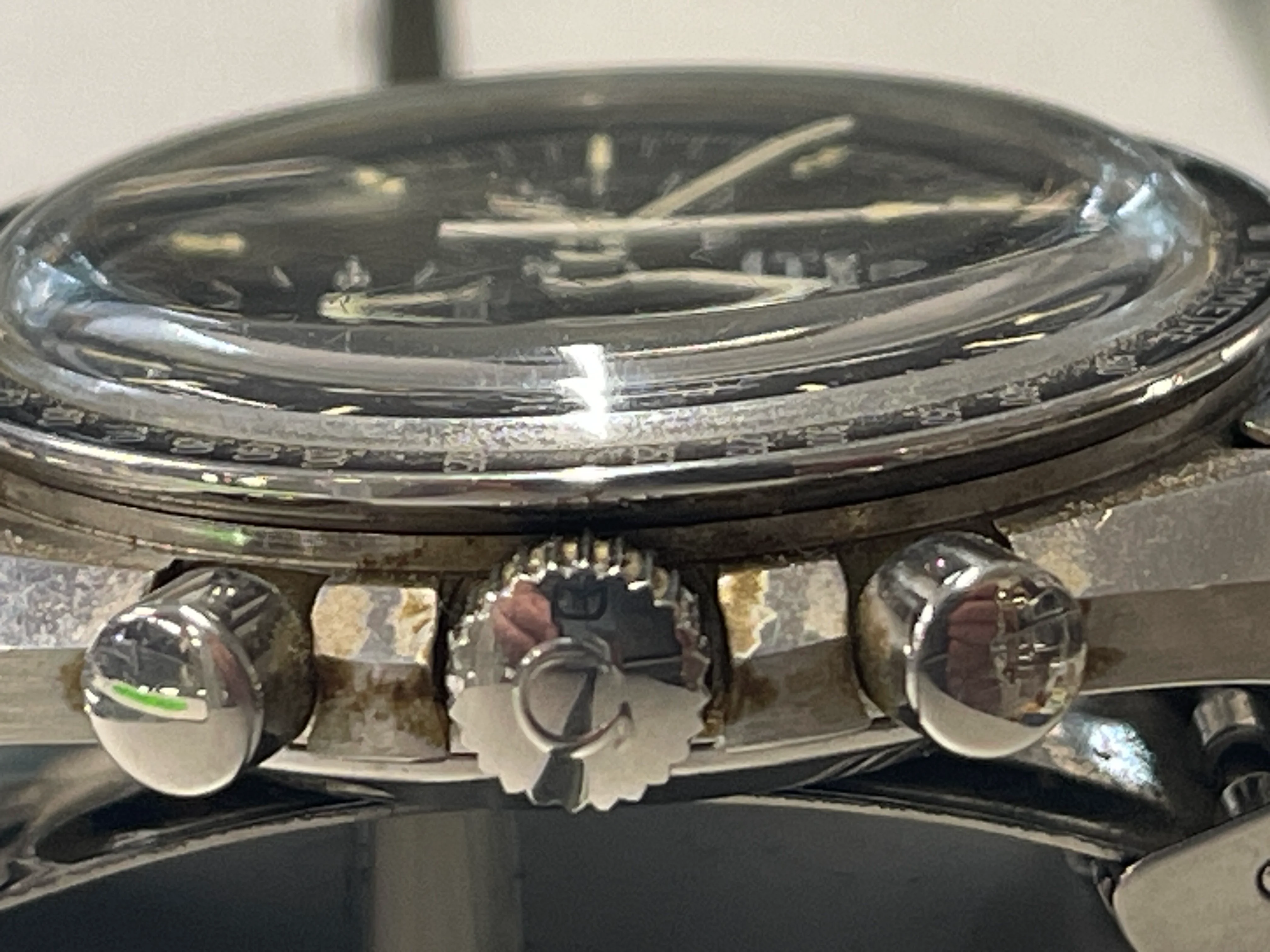

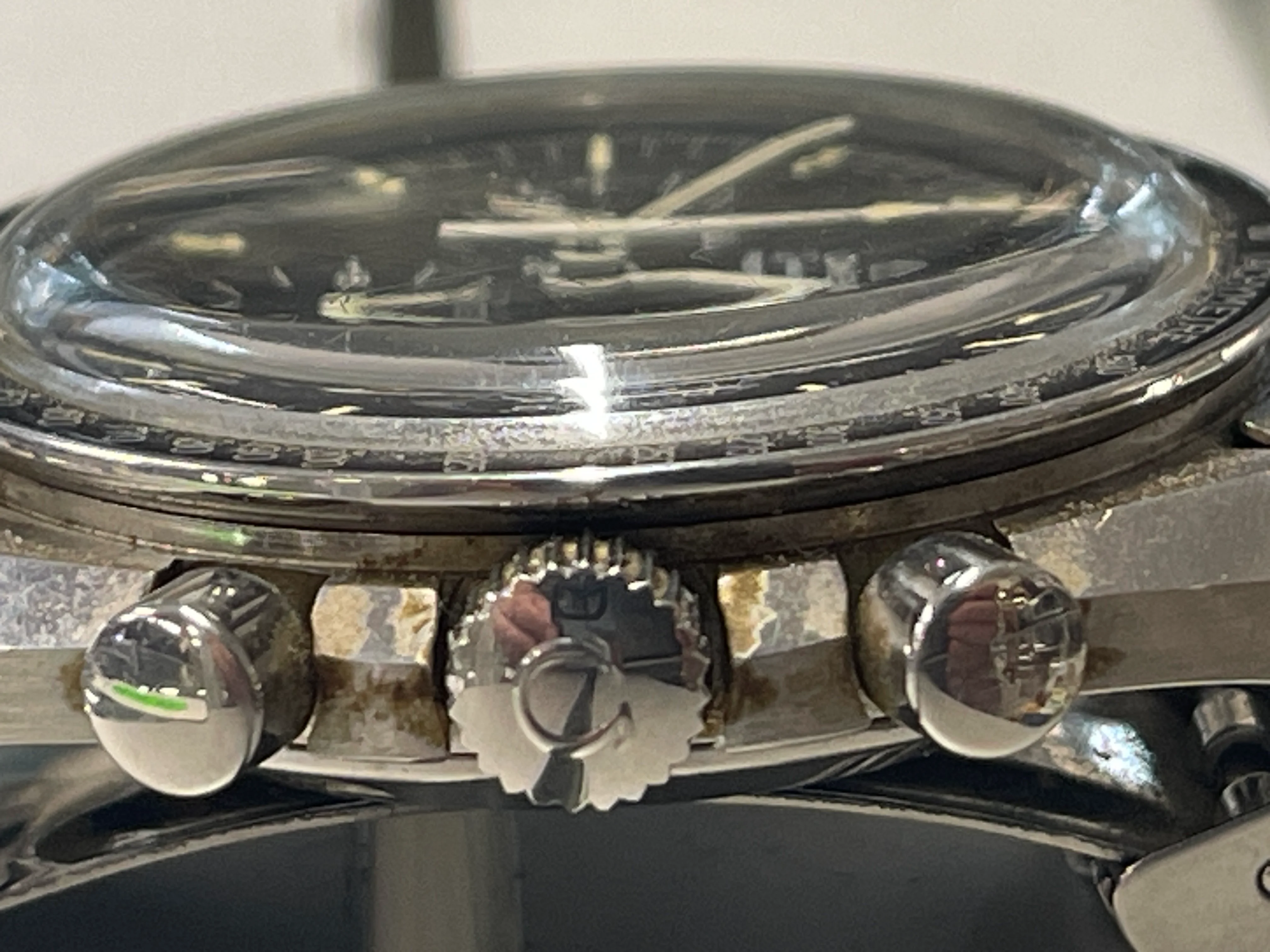

The pushers and crown have the right amount of dirt, so they could be original?
No movement pictures, but based on the condition of the watch, it should be ok, and after the service it should be fine!

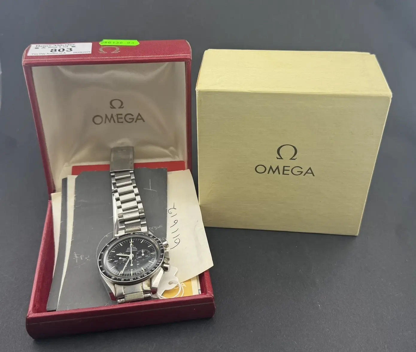

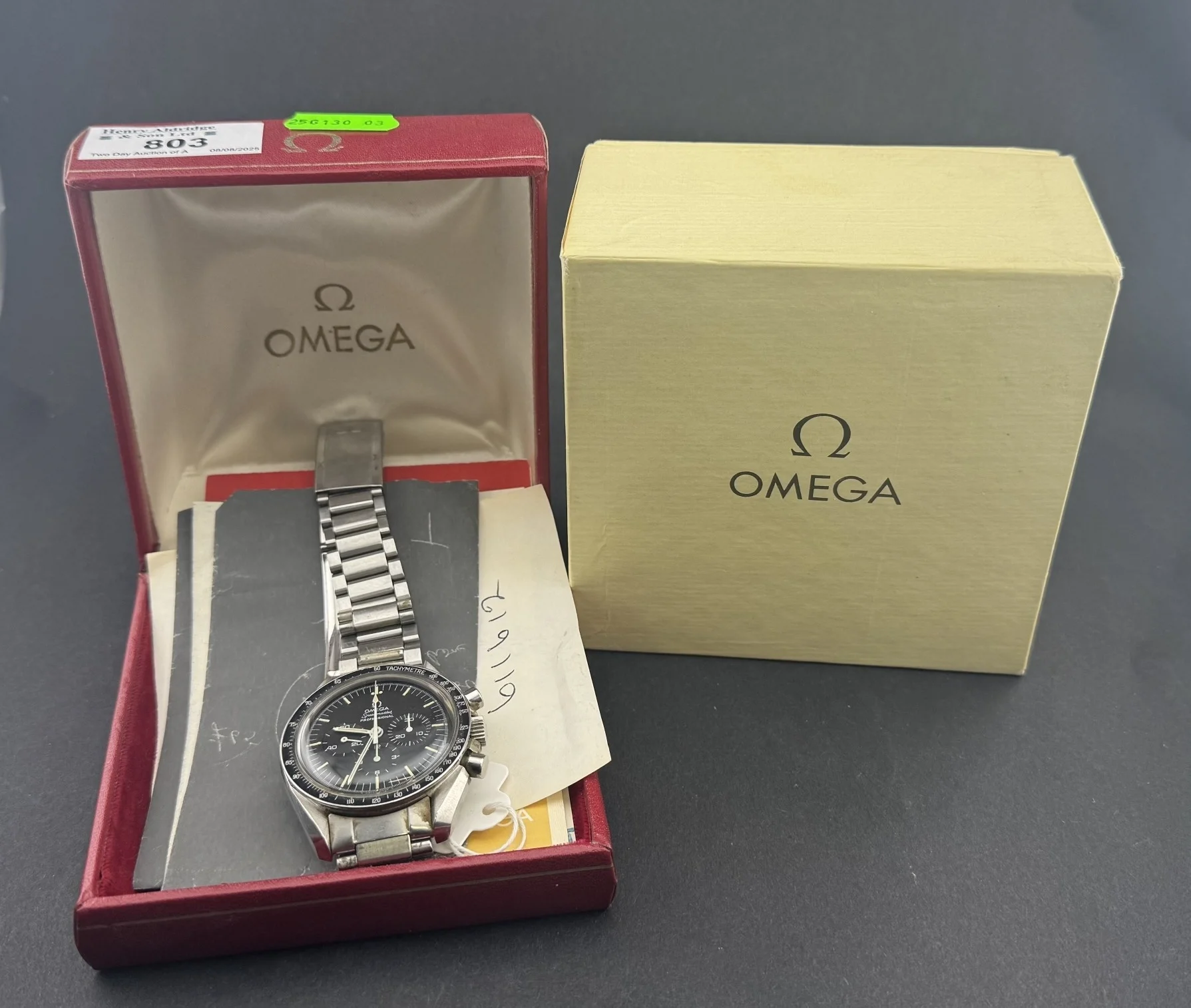

It had a 1175 bracelet and 640 endlinks.
The watch also had box and papers, and spare links, so a nice set.
And this could point to a one owner watch?

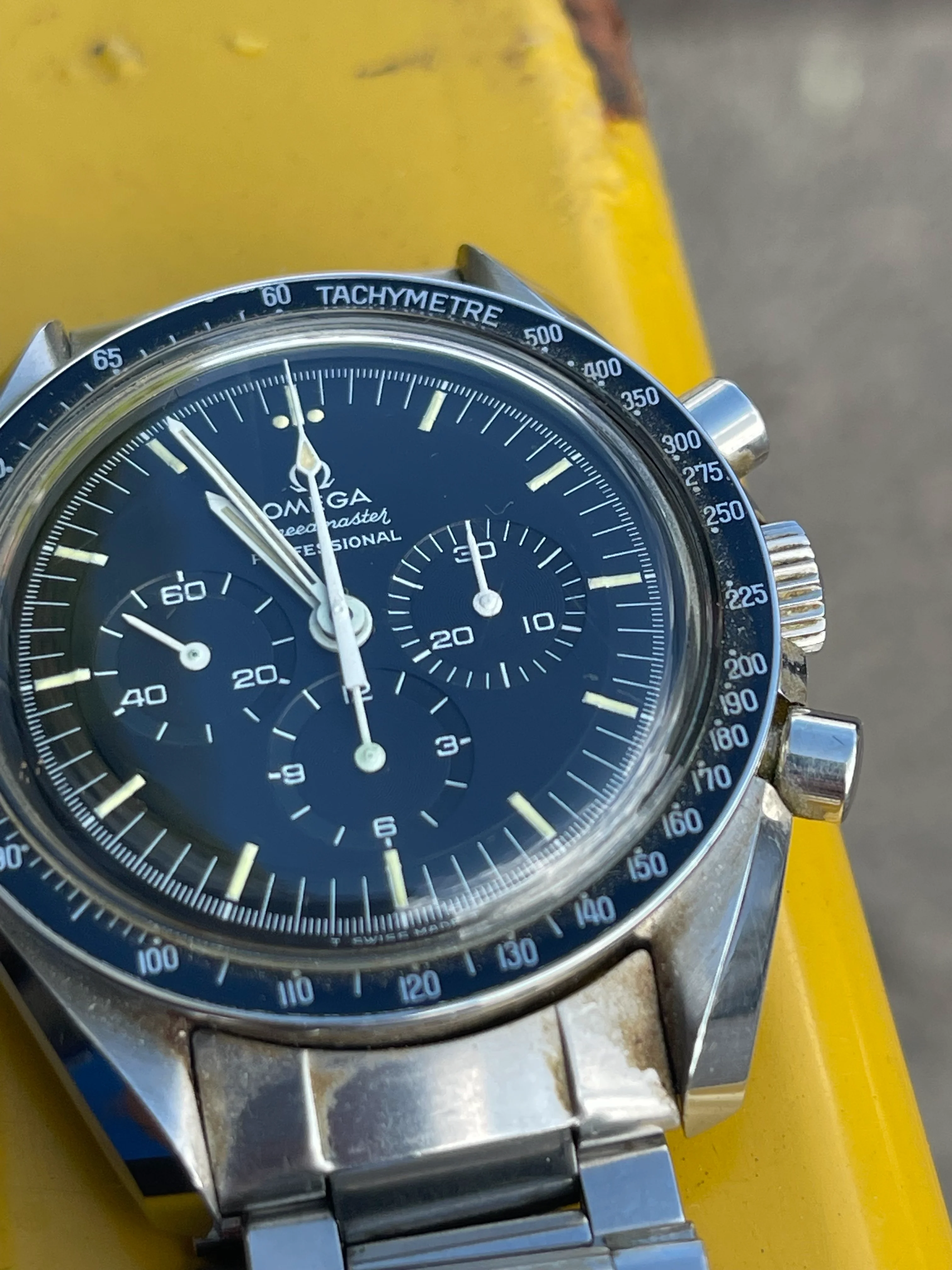

But the paintwork on the hand are a bummer….

Guilty. I was actually thinking of bidding too, in spite of having two of this reference... However, at this level, I passed. Also because the repainted hands are clear evidence of work done to the watch, and knowing this, what else has been adjusted? Hard to tell on the back of pictures alone.
384
2,906
Well I feel like an idiot lol didn’t pay attention… and now I’m glad I lost. Minute and hour counter hands have their dimples covered! Good catch and thanks for the education! I need to edit my speedy checklist
1,558
6,790
Credit where credit's due: @hansaboy spotted it too as he mentioned 'adjusted hands' above. It's kind of unusual to see it like this, though. More often than not, repainted hands come with other adjustments as well. This watch doesn't bear any clear indications of other work done to it.

Everything looked really really nice, but the paintwork on the hands made me wonder...

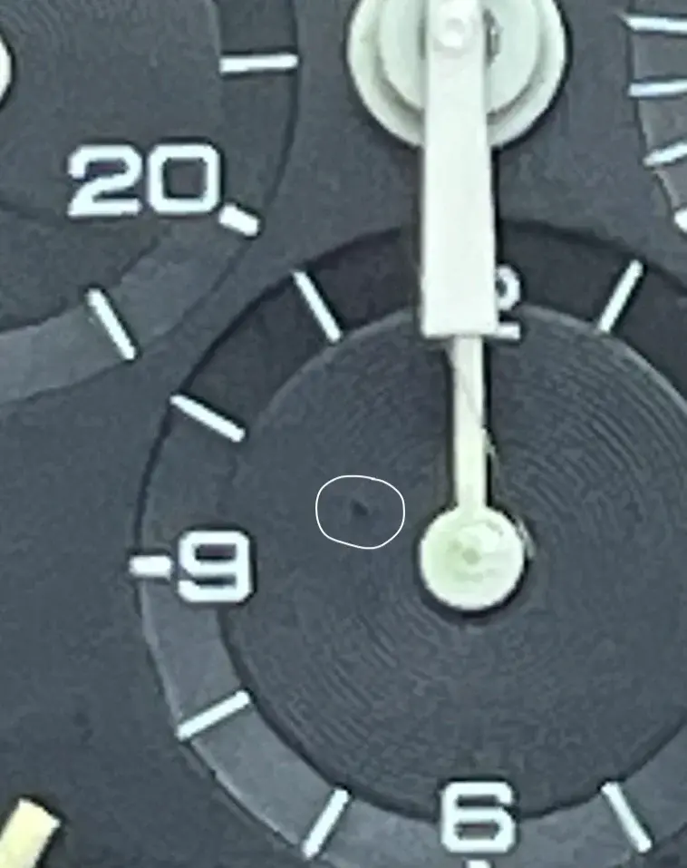

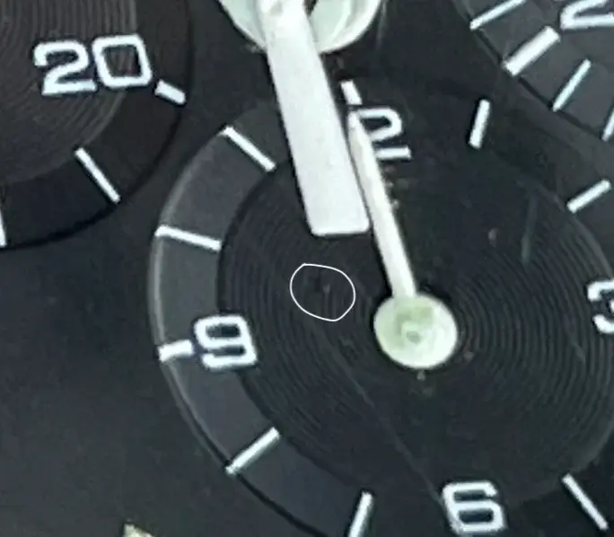

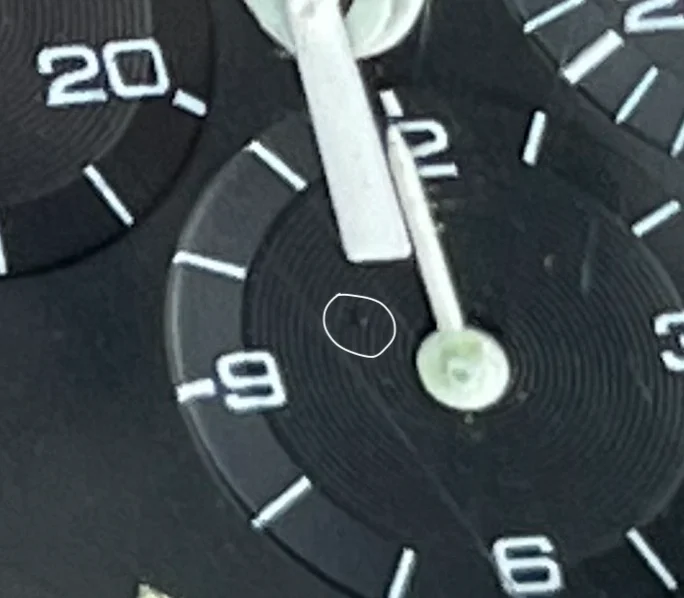

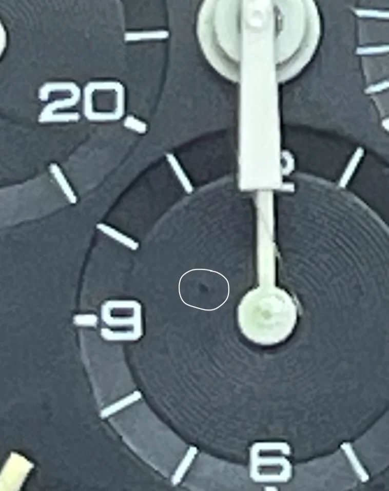

And I think I also found a "wart" on the subdial...
