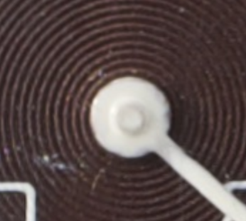

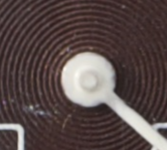

It is clear from the picture you provided all the sub dial hands, and the red hand have been painted over whilst attached to the watch - they have painted over the pivots. This is a classic sign of an enthusiastic model paint amateur bodge job and not factory work.
The luminous material on the red hand being painted over is even more of a red flag (see what I did there).
You are welcome to dream of course, but it isn't really some great mystery, just a repaint 😵‍💫

The mind sees things that it wants to see sometimes ... but from what I've seen in most macros, the hands and pivots look like this (picture from the 145.022-69 story from Fratello):
But regardless, the quality of the rest of the piece is uncontested and the story is amazing. The full story would be even better!
Looks like some white paint made it onto the dial as well ::facepalm1::
