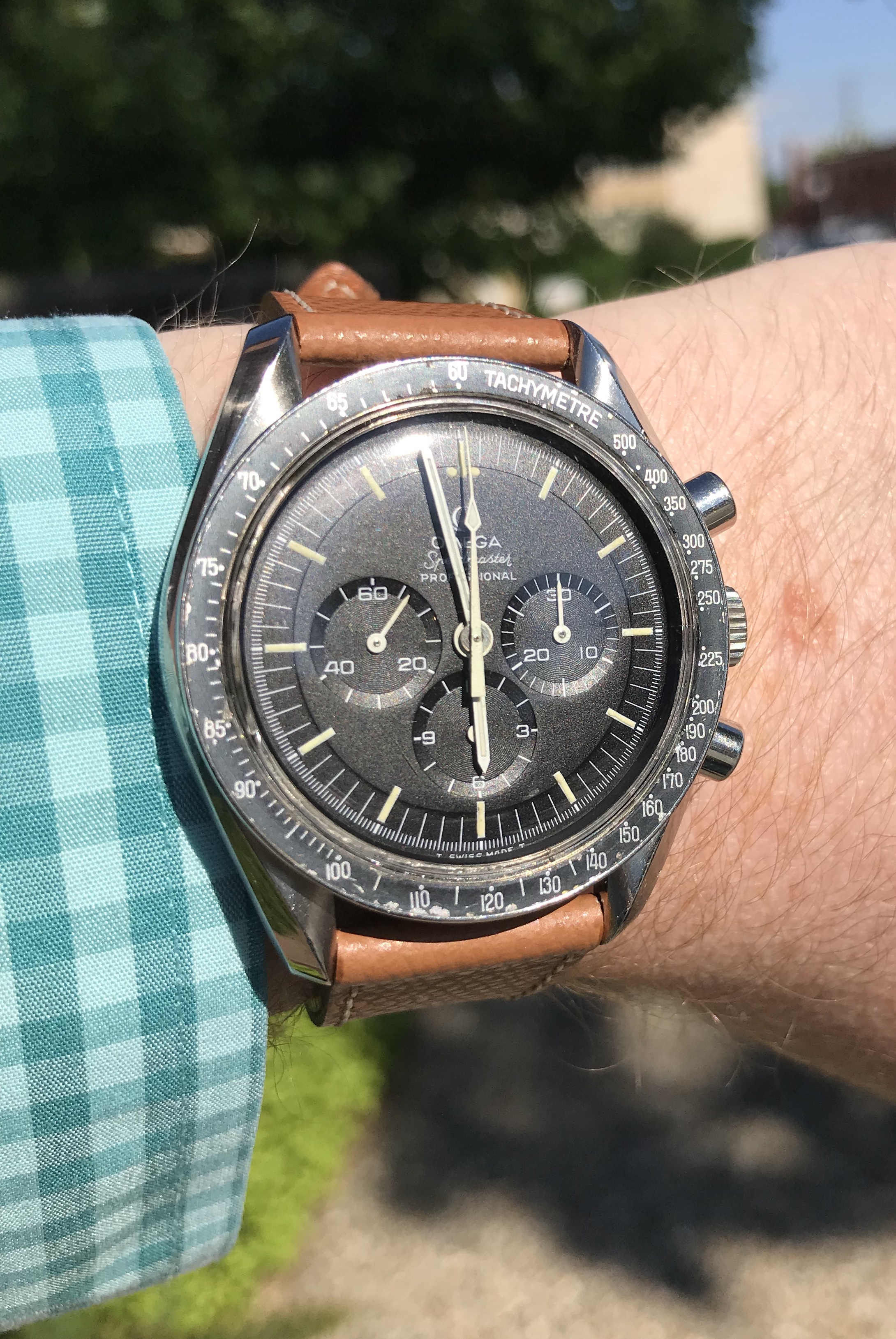

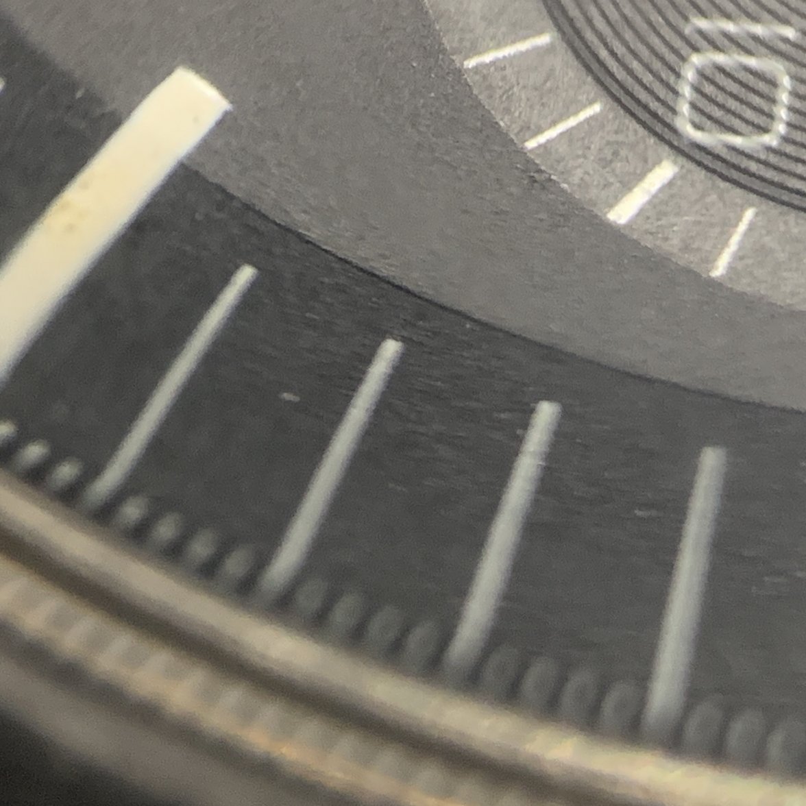

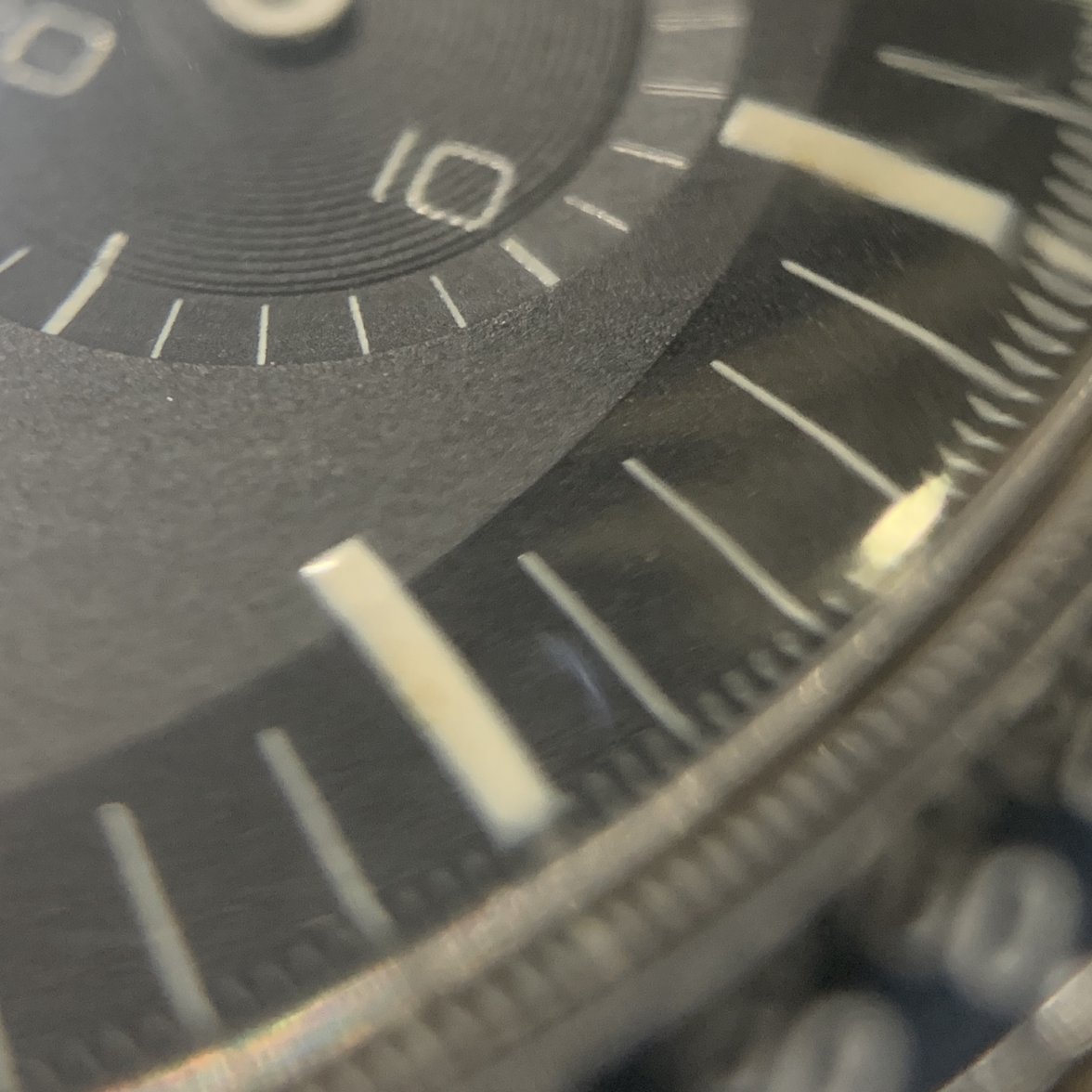

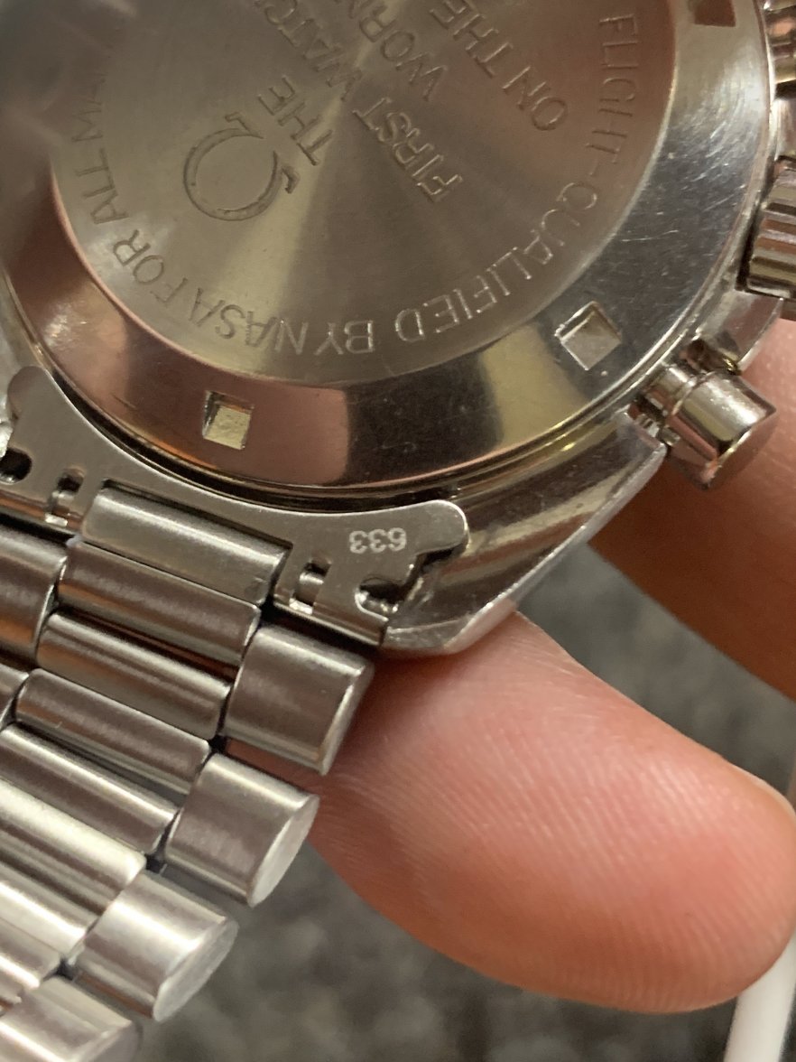

Lovely wife gifted me a Speedmaster for my birthday and I had to research what I could.
Inside the caseback is marked 145022-69
Has DN90 bezel, 1171 bracelet, straight text on the case back and not clear if there is a stepped dial or not. Seems to slope at the markers but maybe the domed crystal is messing with my perception.
The main issue I have is the SN starts with 32xxxxxx. From here (http://chronomaddox.com/romans.html) the serial number seems to be from '73-'74.
Is it likely that the case back has been swapped?

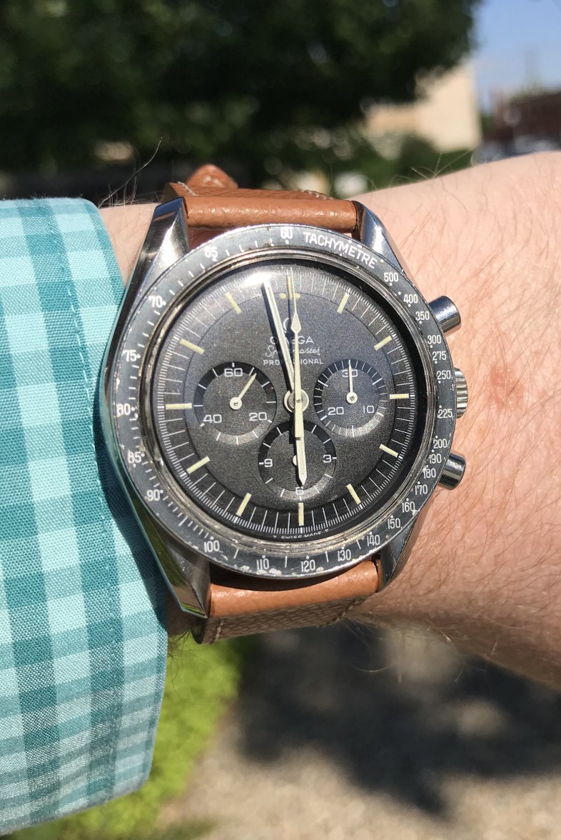

Difficult to tell whether this watch started life as a -69 or -74 but I can tell you something is afoot. A 32x serial would be in range for a straight writing or -74, so difficult to tell just from two digits. From the first picture, the dial appears to be of the dome variety, which is incorrect for a -69. Since the ‘S’ in Speedmaster is not of the drop variety (going to the bottom of the P), it is most likely from a -74. Depending on what you paid, if the watch is confirmed as a -74 based on serial/extract, this might not be the worst thing in the world as the correct caseback would not be hard to find. However, if this is actually a -69 SW with an incorrect dial, that would be a more expensive fix to find a nice condition step dial. If you are able/willing to post the full serial, that would help. Again, much of this depends on what was paid.
272
224
Just noticed the movement has a metal brake, which I believe should have been plastic on a -74, so now my inclination is this is a SW with a service dial, unfortunately.

It’s not a 74 era movement. Look at the brake.... @Taybharr
If the dial is stepped it’s correct, if domed it has a service dial from before 1978. Little hard from the pictures to tell for sure.
Chuck Maddox tables are no longer considered valid for dating there is a lot of out dated info on dates.

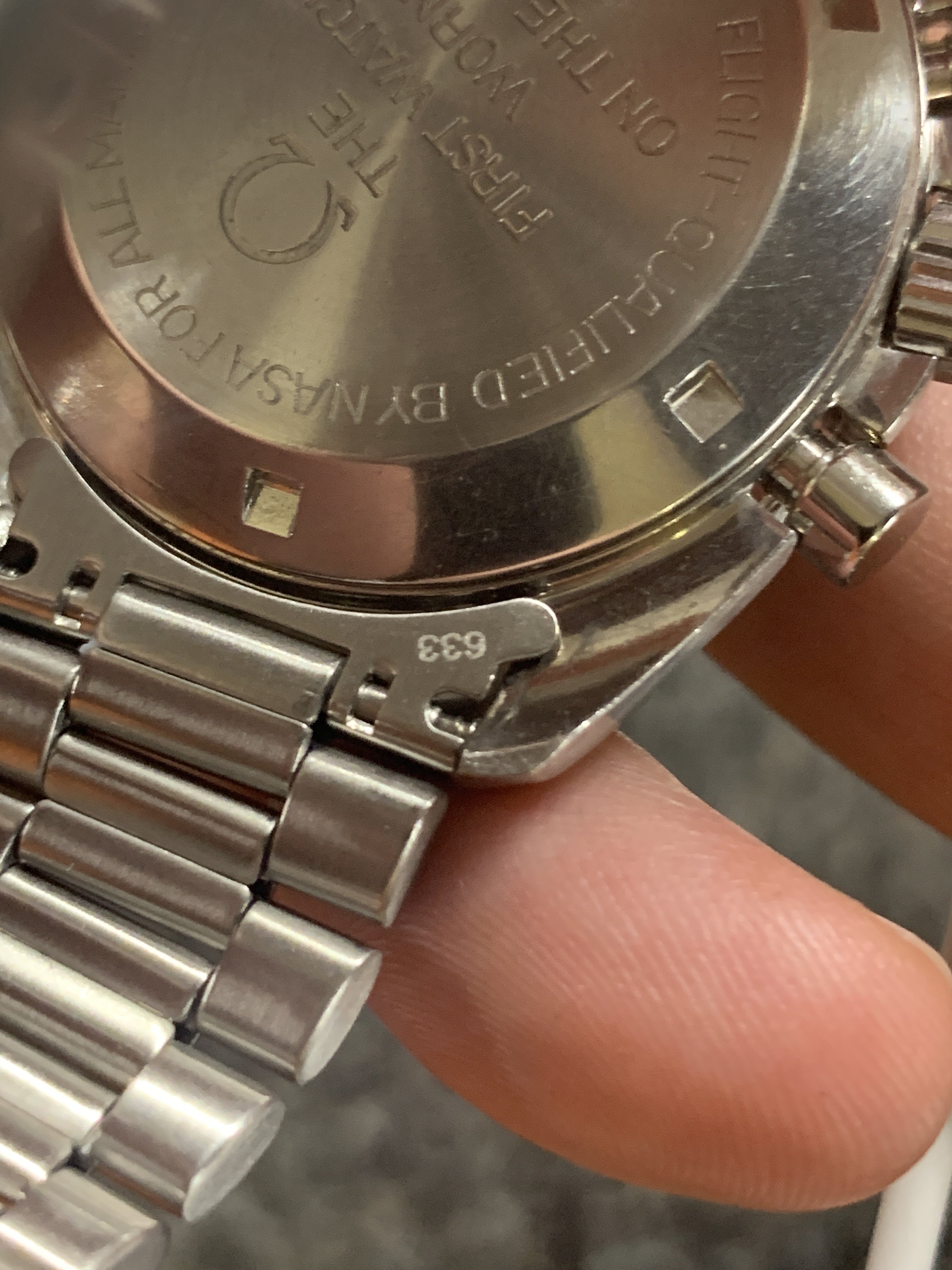

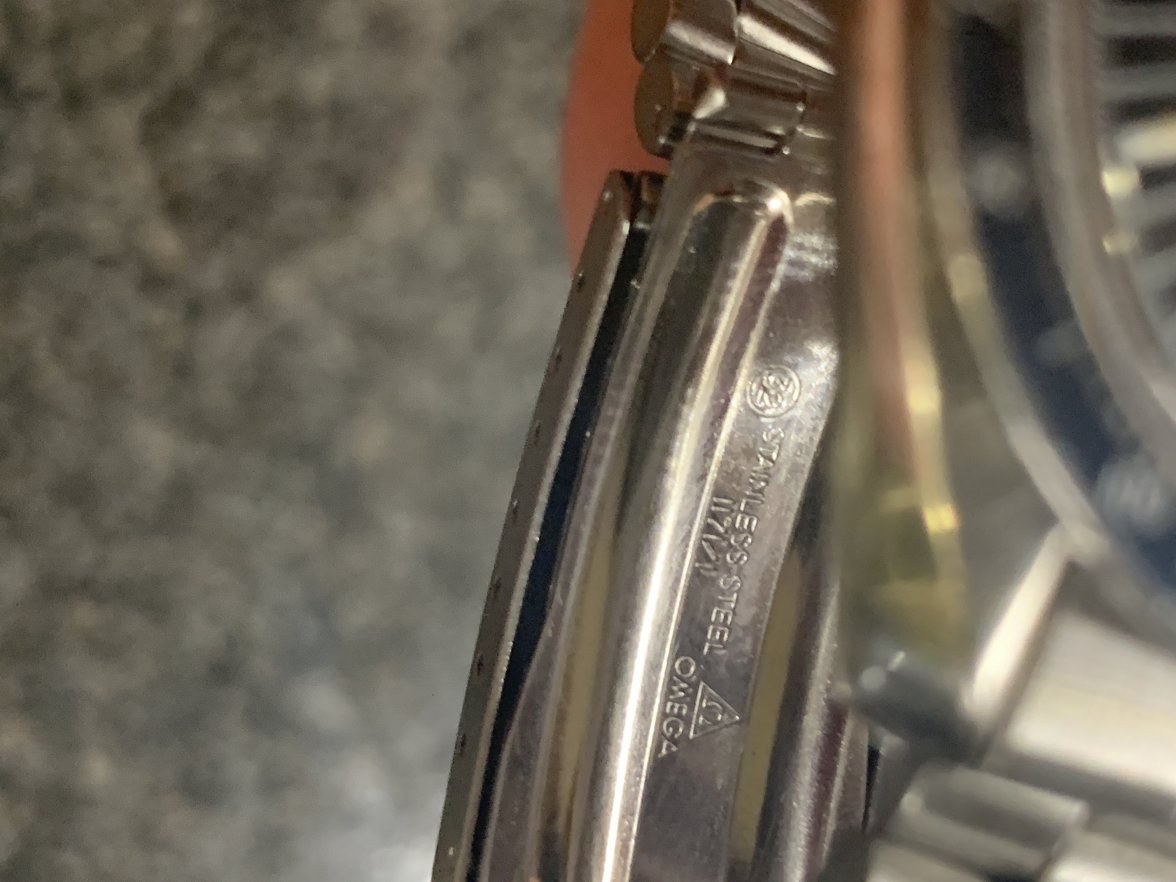

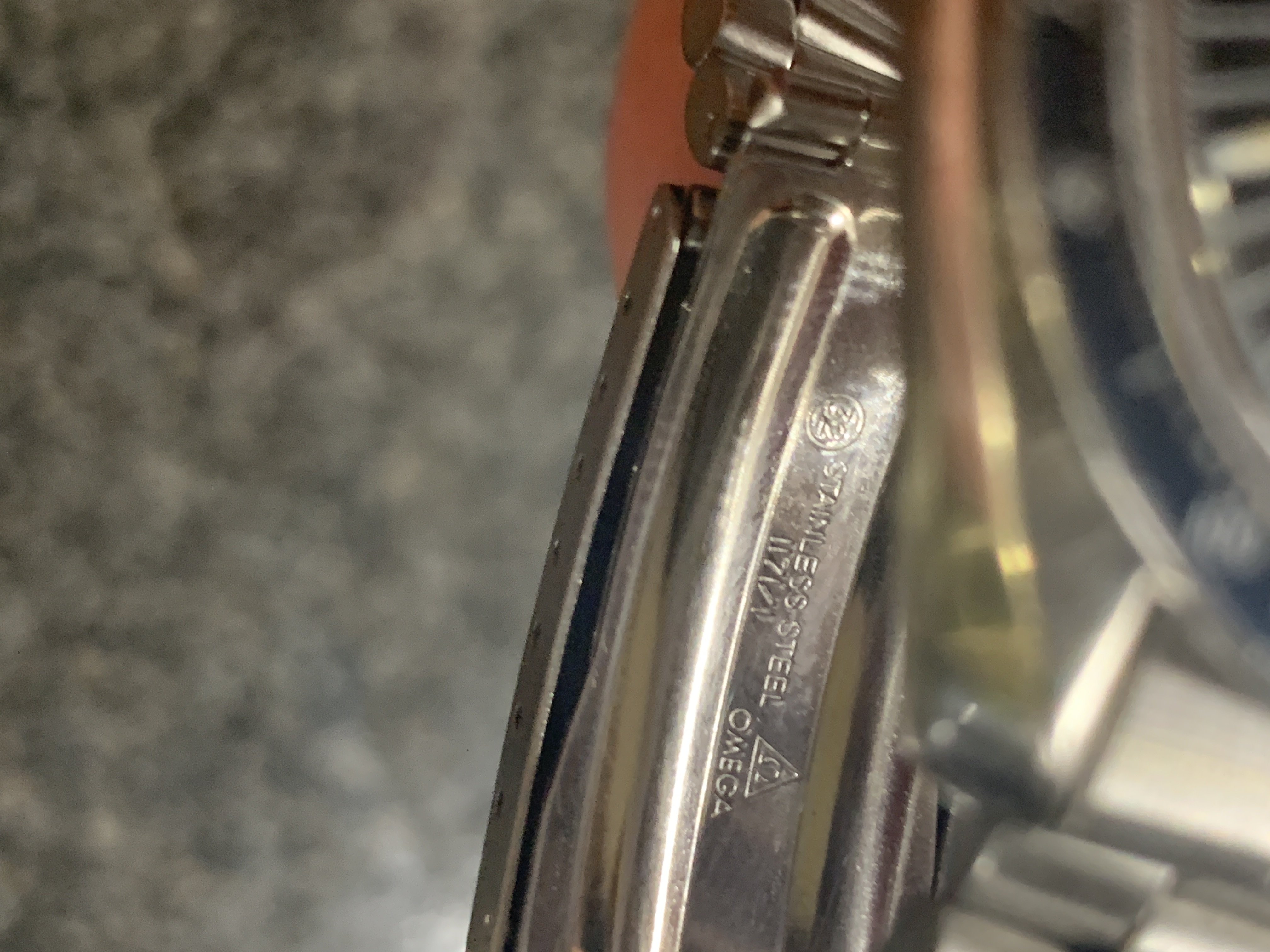

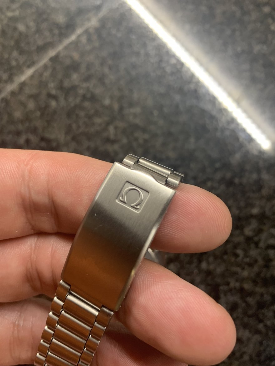

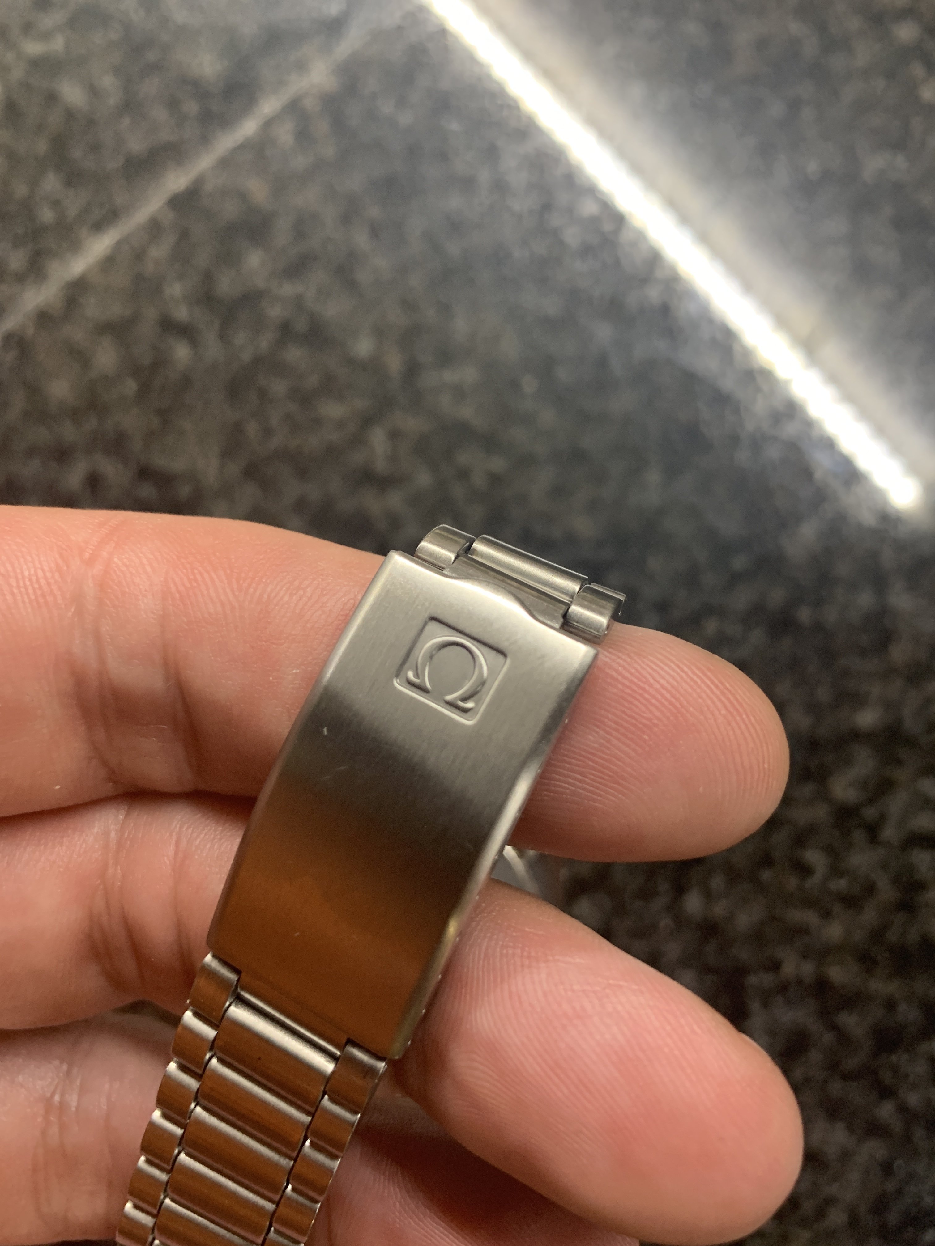

The endlinks look to be modern ones from a 1171-1/633. Do you have bracelet pics also, clasp and both sides?

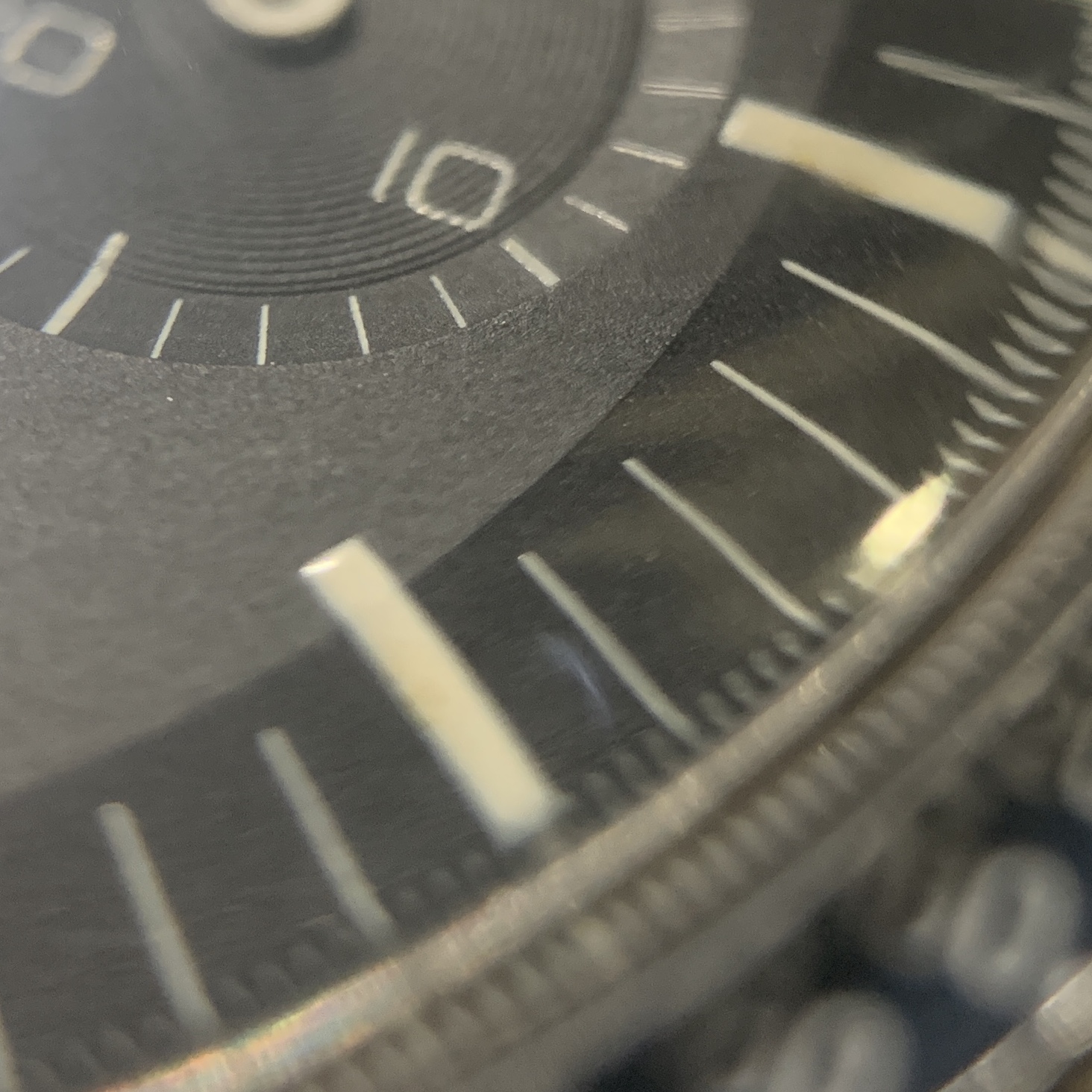

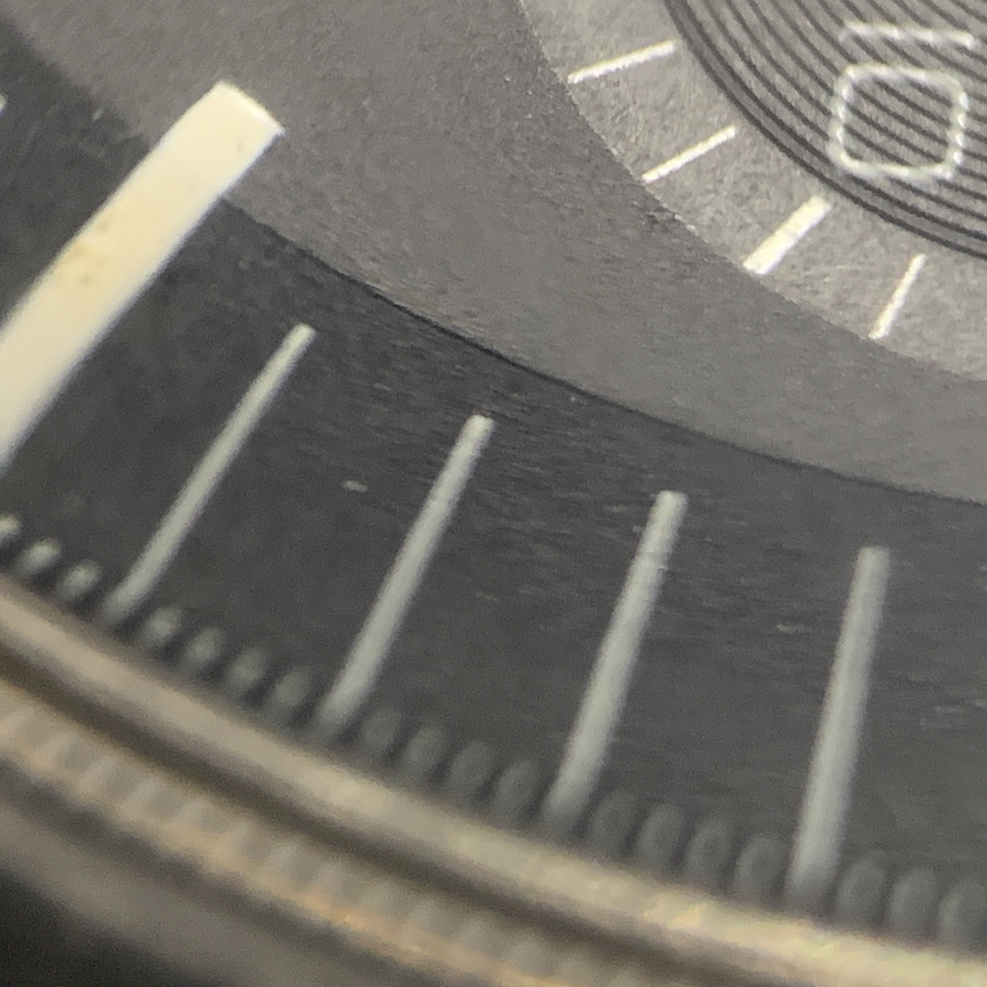

The step dial is the hardest to see but looking at the picture with 6 dials at following page. I am fairly confident there is a stepped dial.

Well, it looks like an original 1171/1 but it is not era conform wirh the watch.

Looks domed to me, there is no step at the minute track.
And yes that’s a modern 1171/1 bracelet.
That S was used on all 145.022 through late 1977 production on 145.022-76 models. So 1969 through 1978.

Hi Mike,
While this is a very nicely aged dial, I am afraid it’s most probably not a stepped one. Looks like a lovely Speedy nonetheless!

Here is an example of a -69 with a stepped dial for reference. The dome dial on your example does not have as much of a “drop”.
