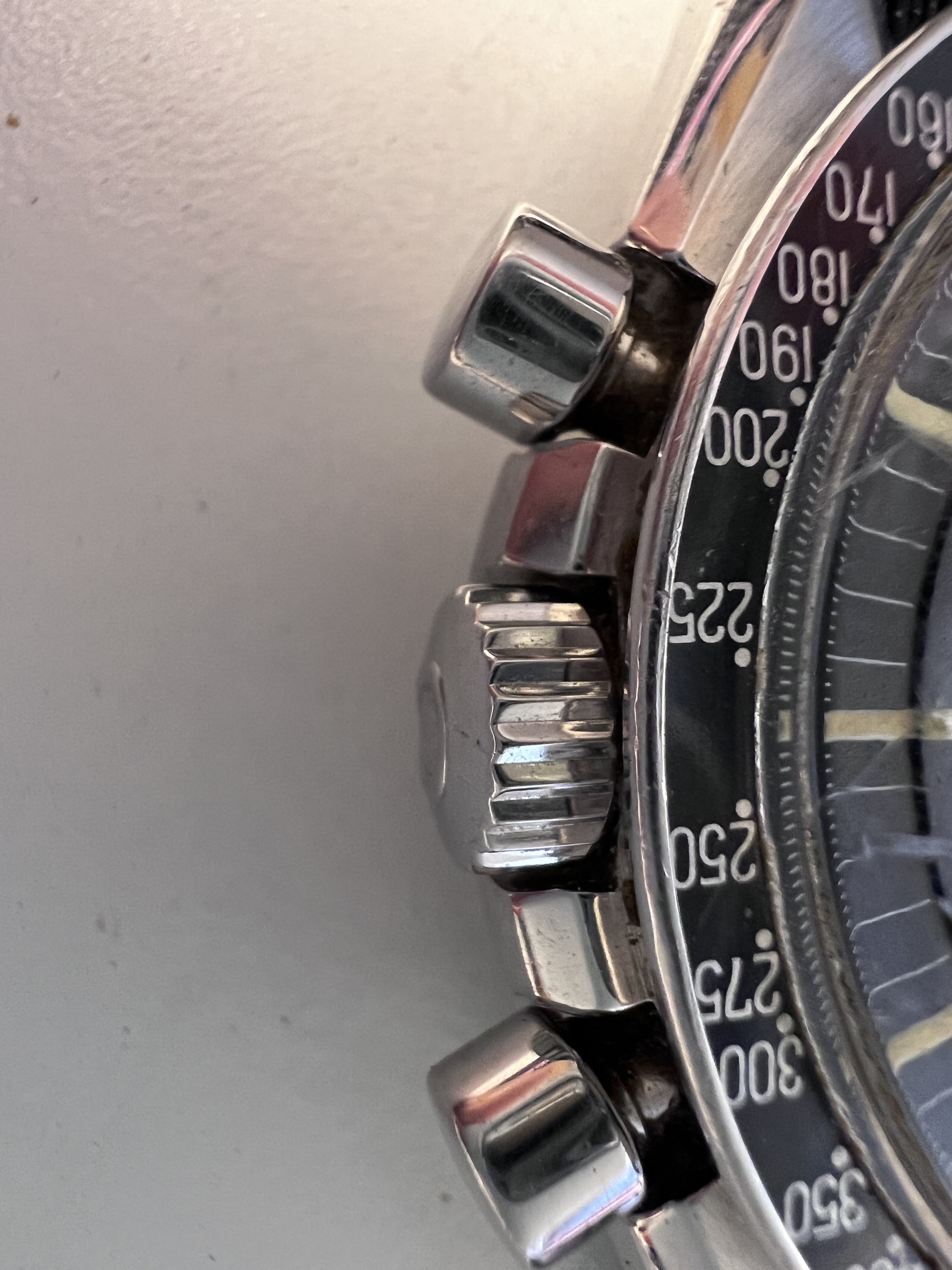

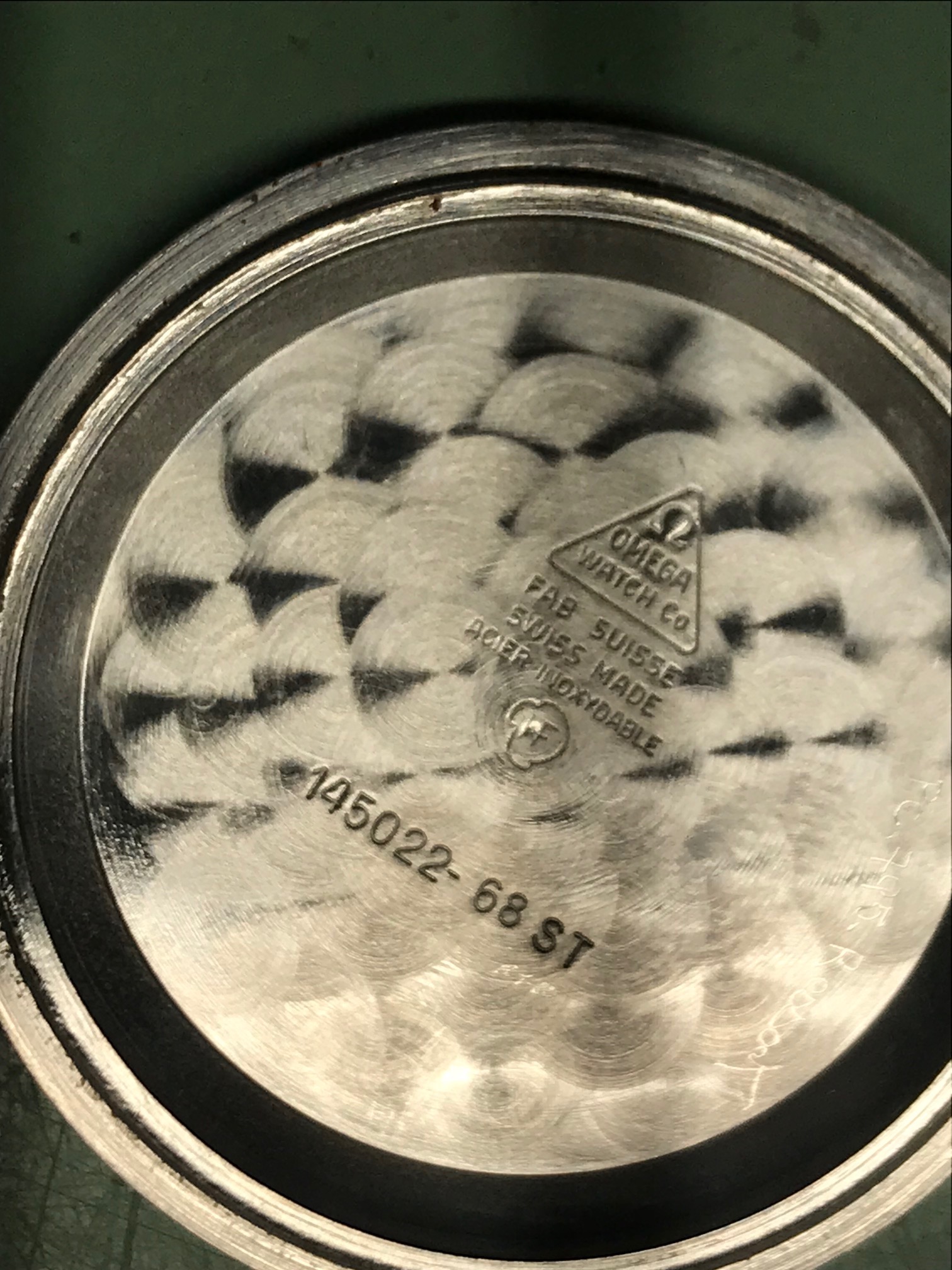

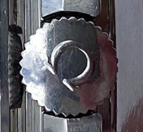

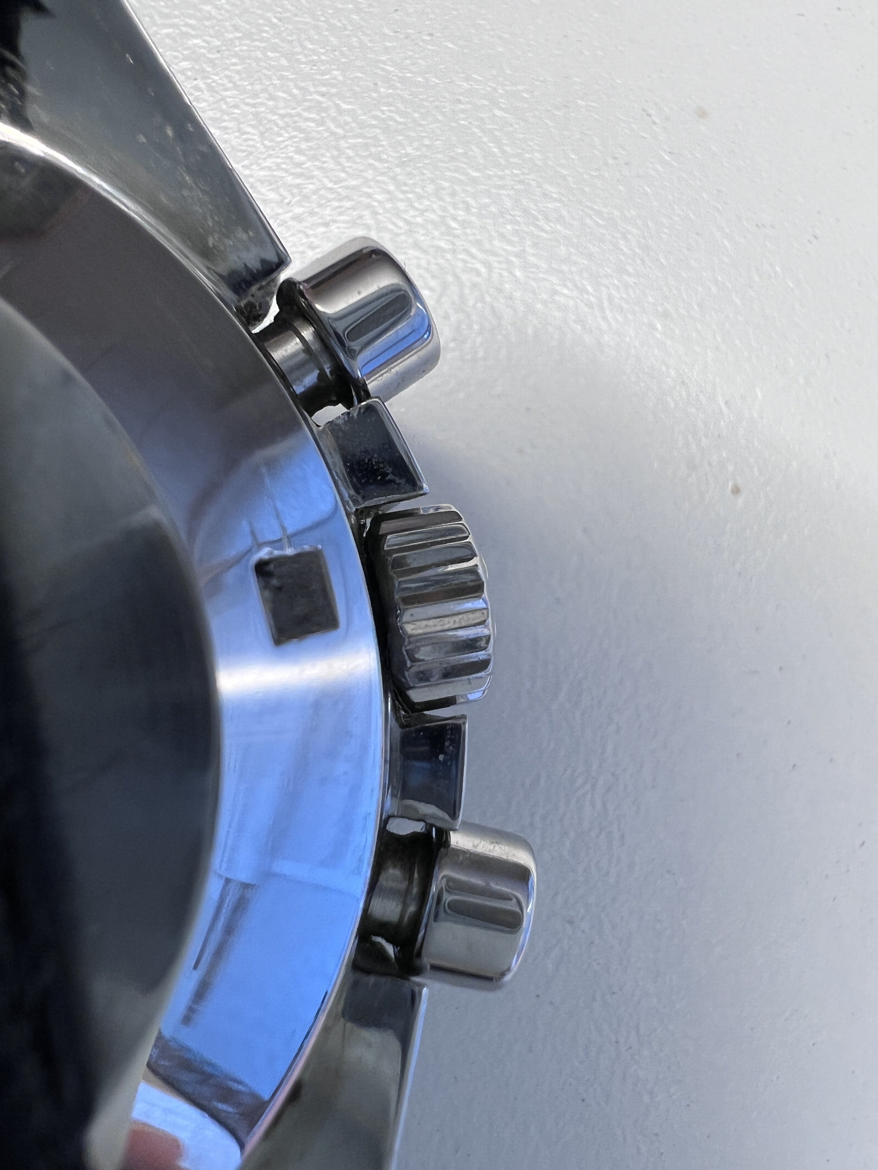

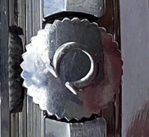

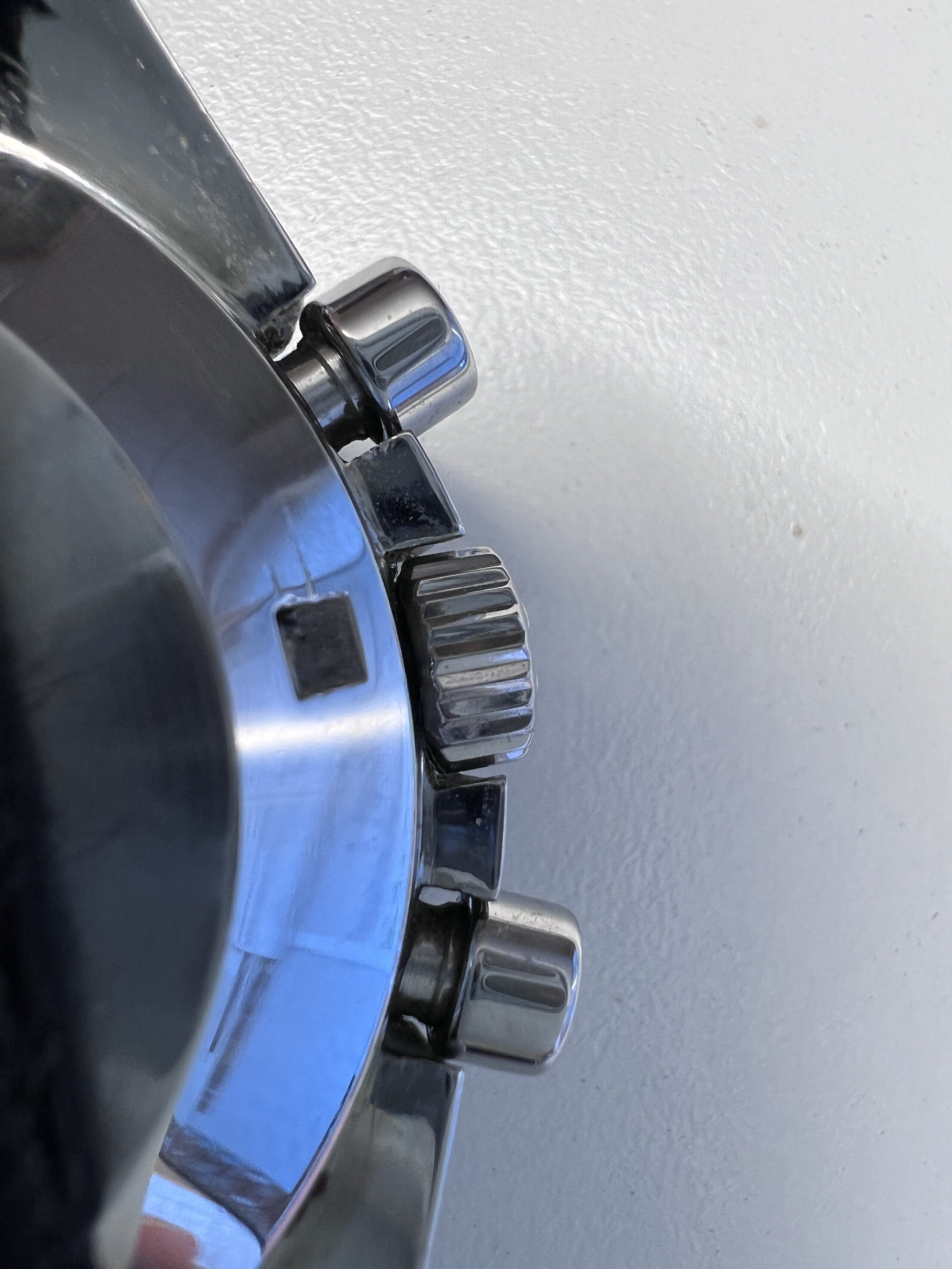

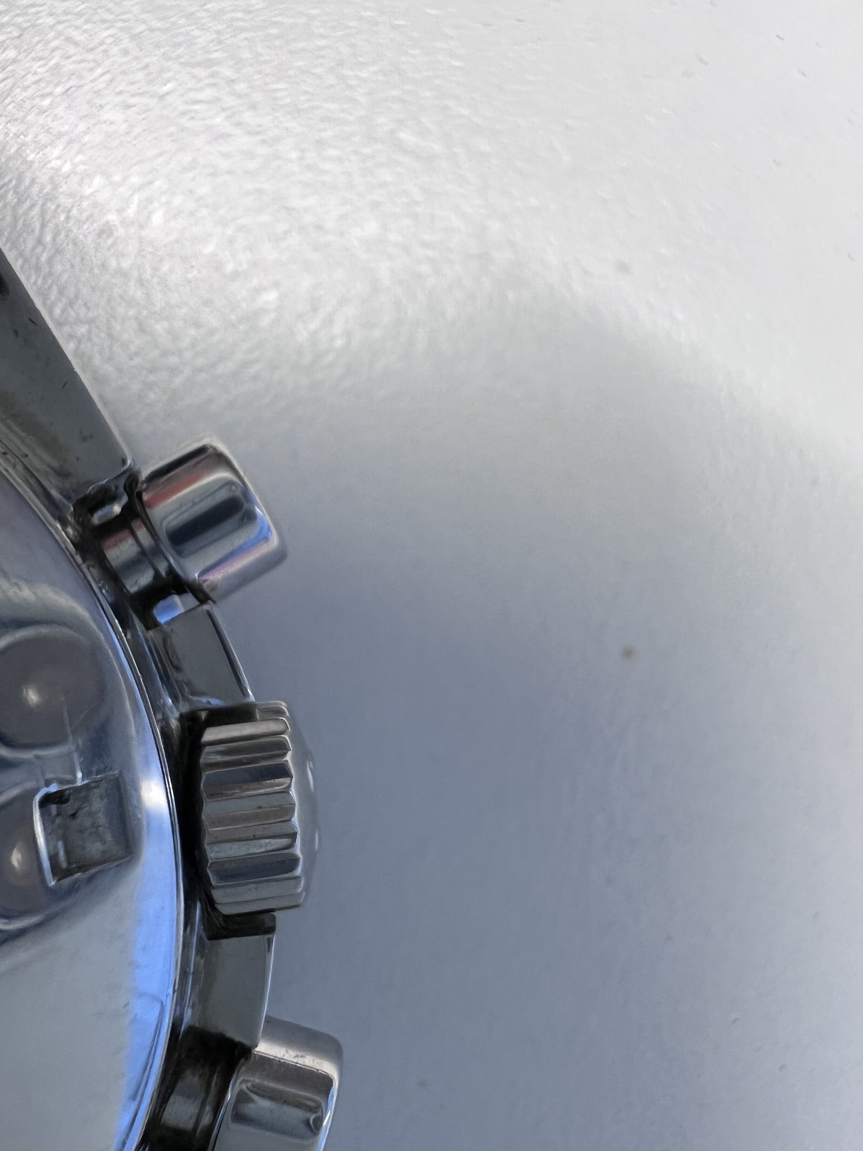

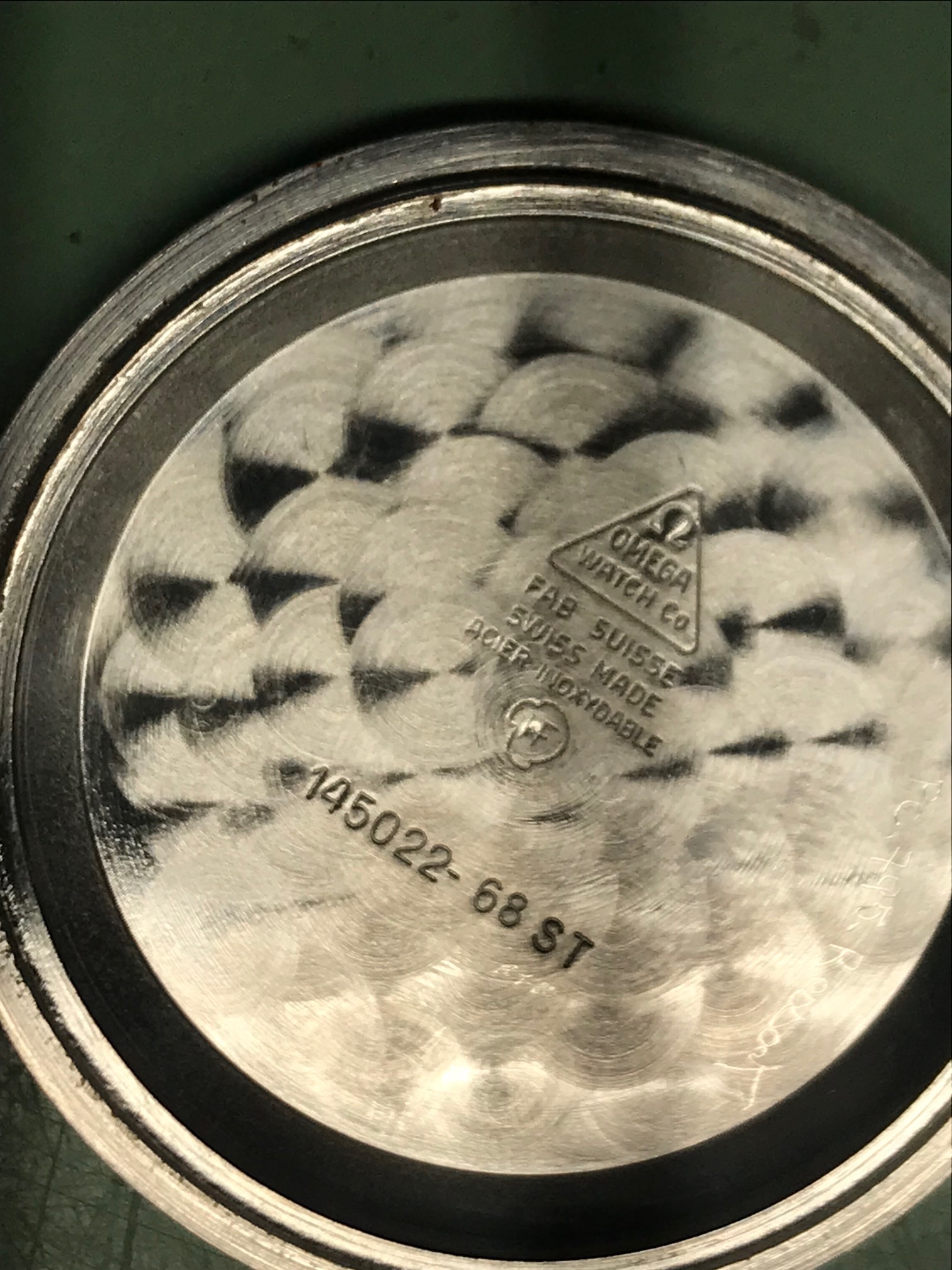

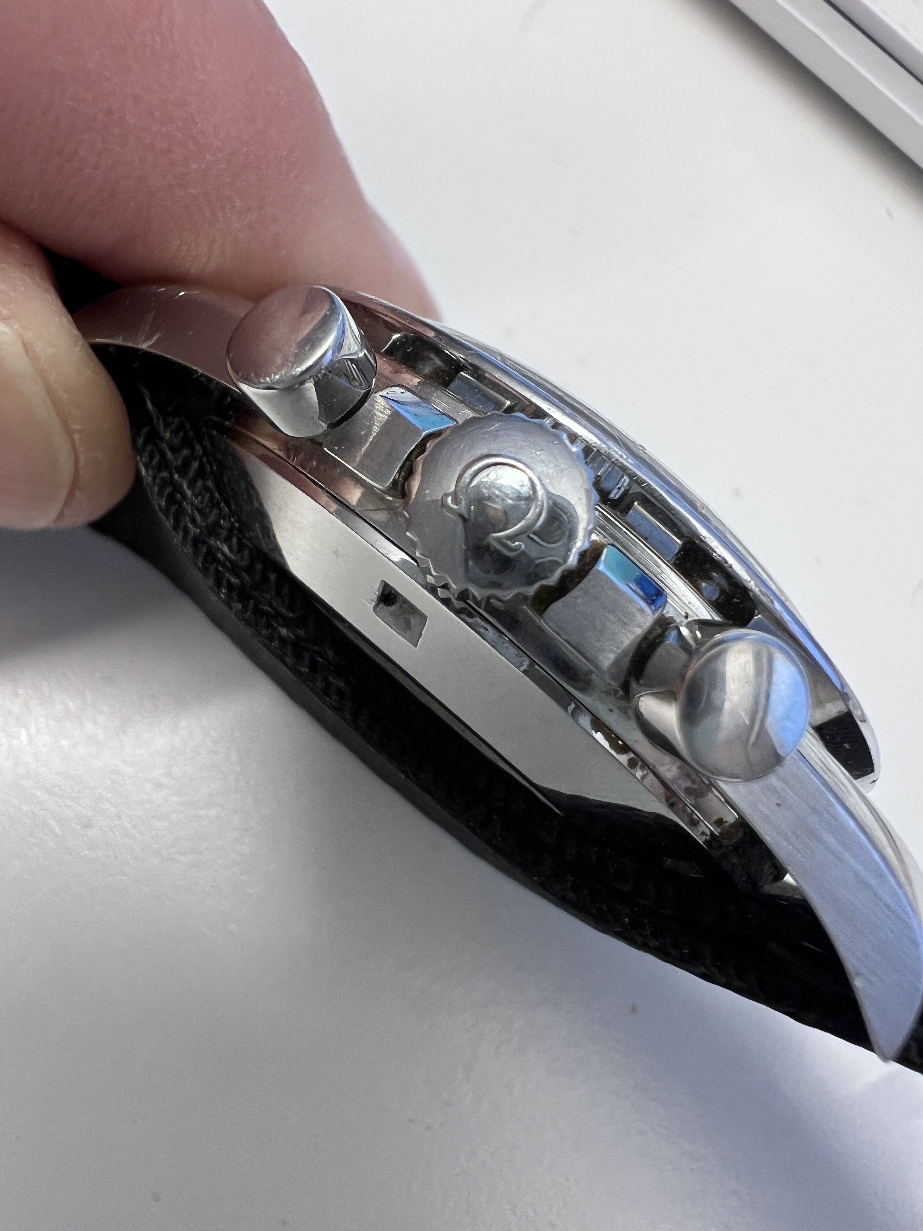

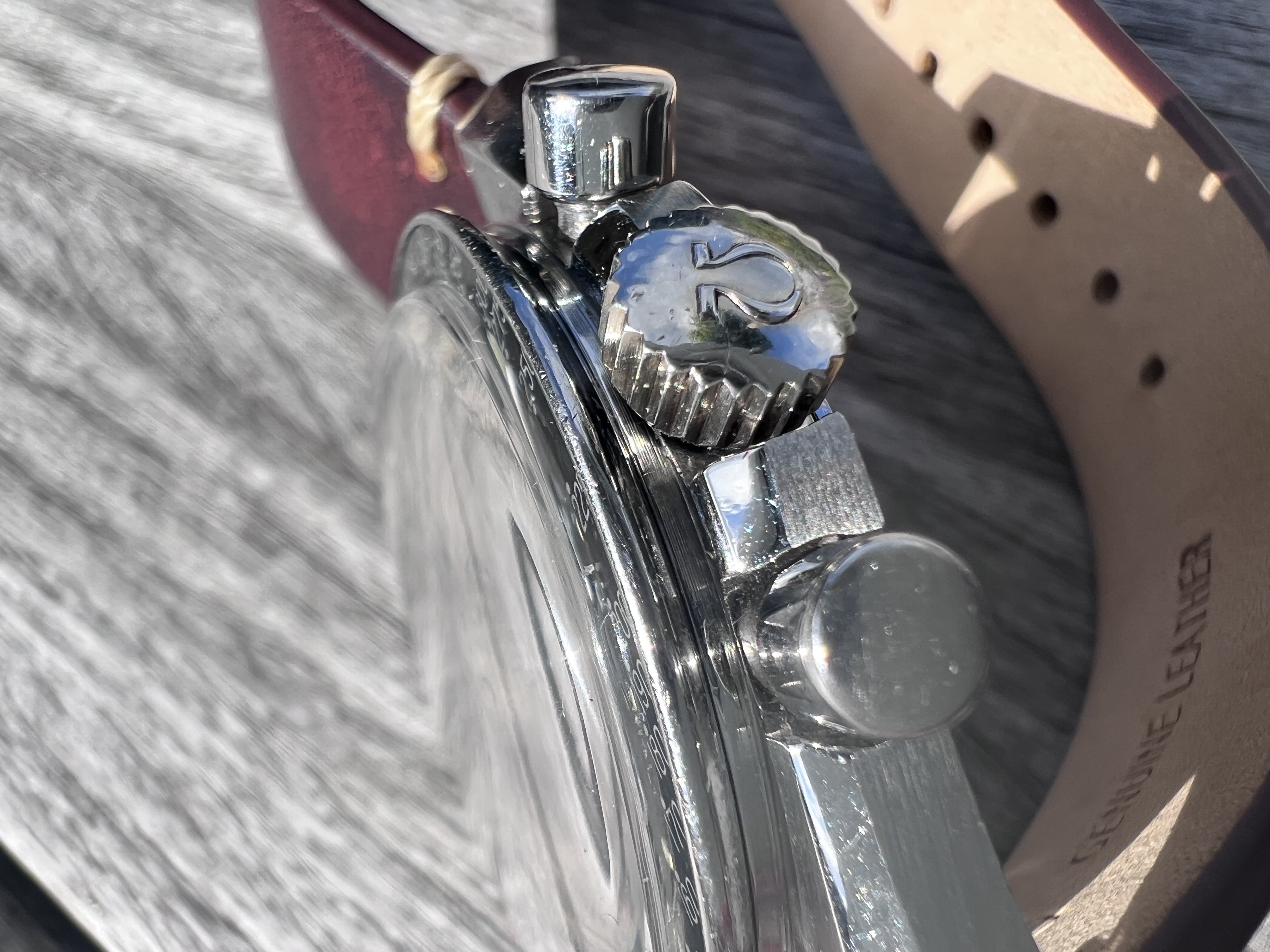

Hi Folks!
Trying to understand how you Guys can see if the crown is original or a service...
I have tried to compare with my watch and the lovely MWO book...
So the one showing here on the pictures - Might it be an original??🤔
Or do service crowns also look the same (more or less)?
I have counted the teeth (more than one time...) and there are 24.
I always enjoy your help - so thanks in advance!

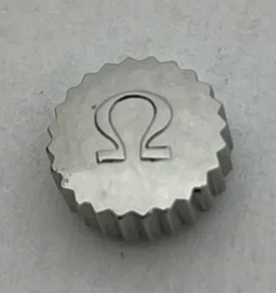

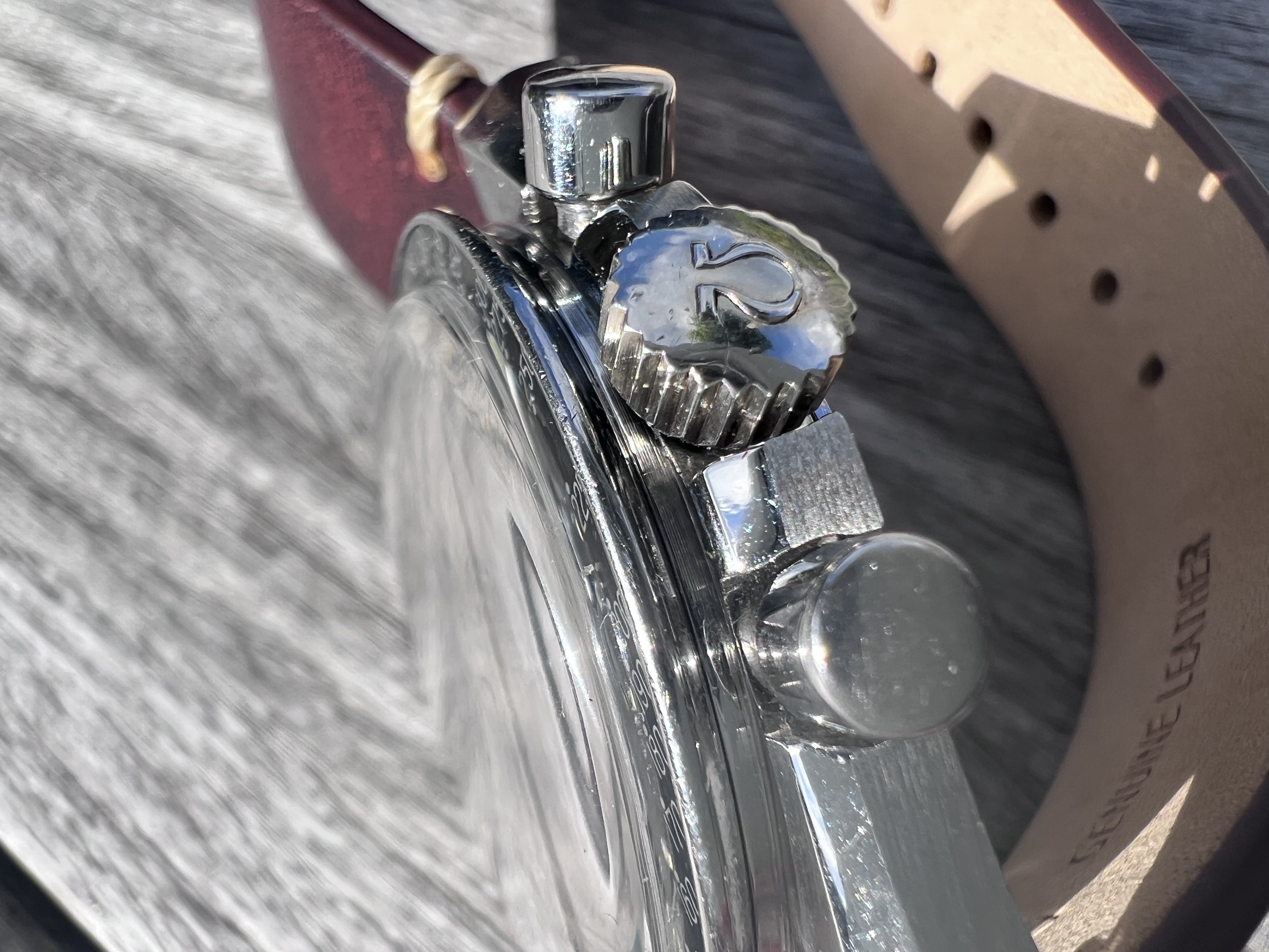

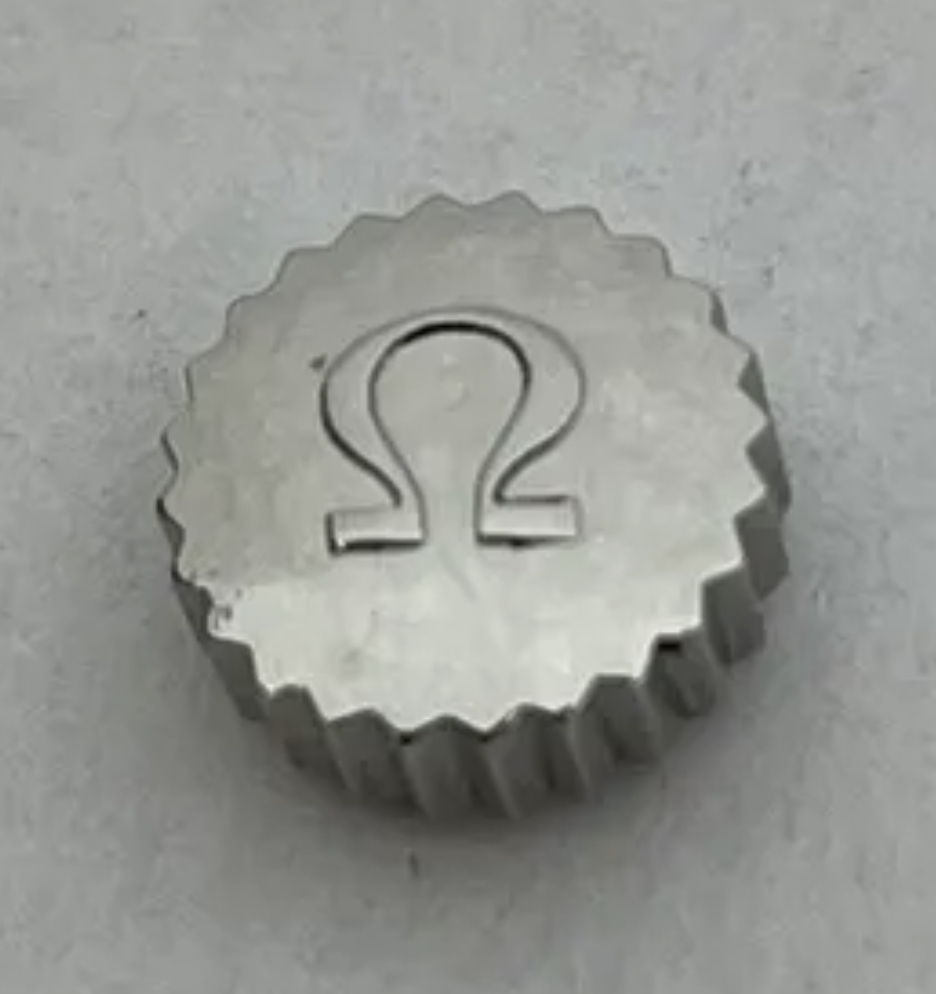

It’a service crown because the logo is the « new » version.
This is the good one
it is a part that was often changed to maintain the seal. in the past, we weren't as attentive to the details

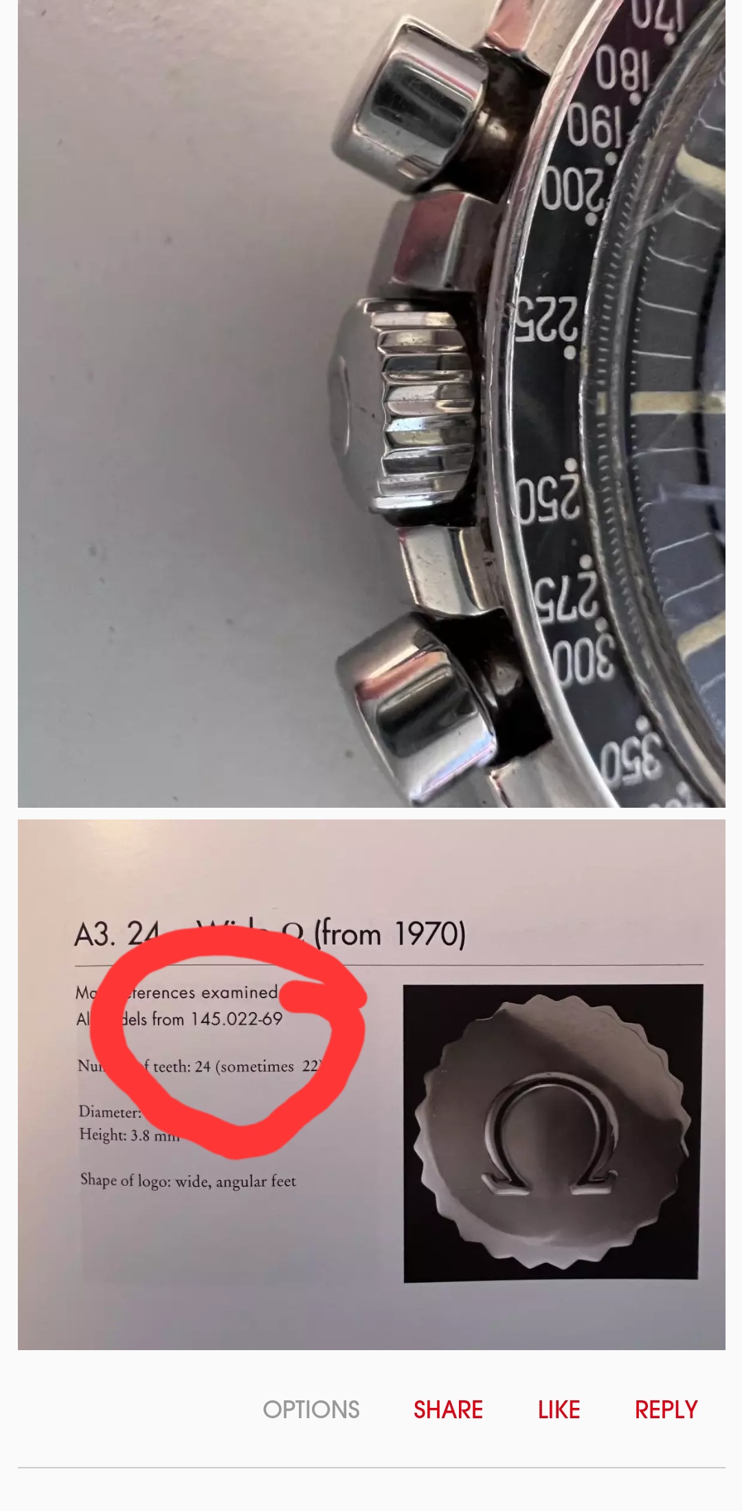

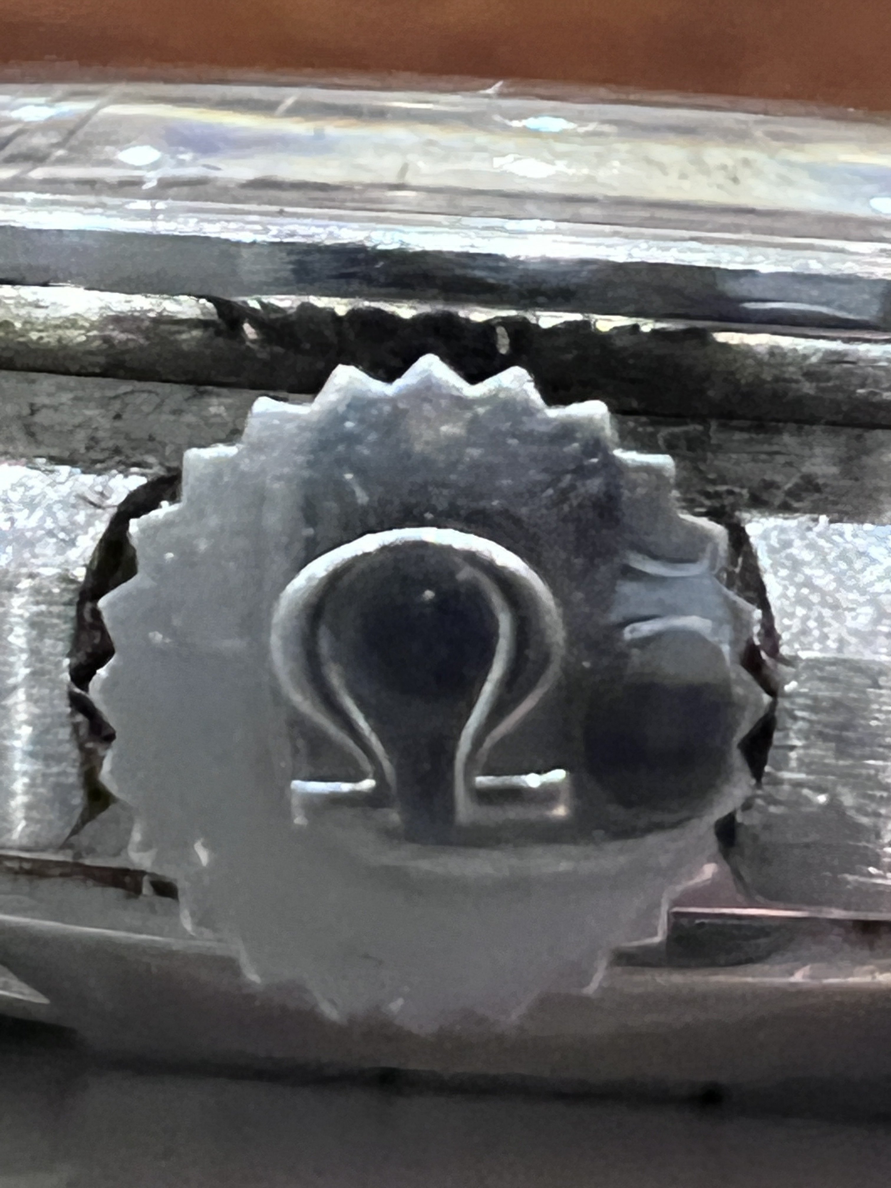

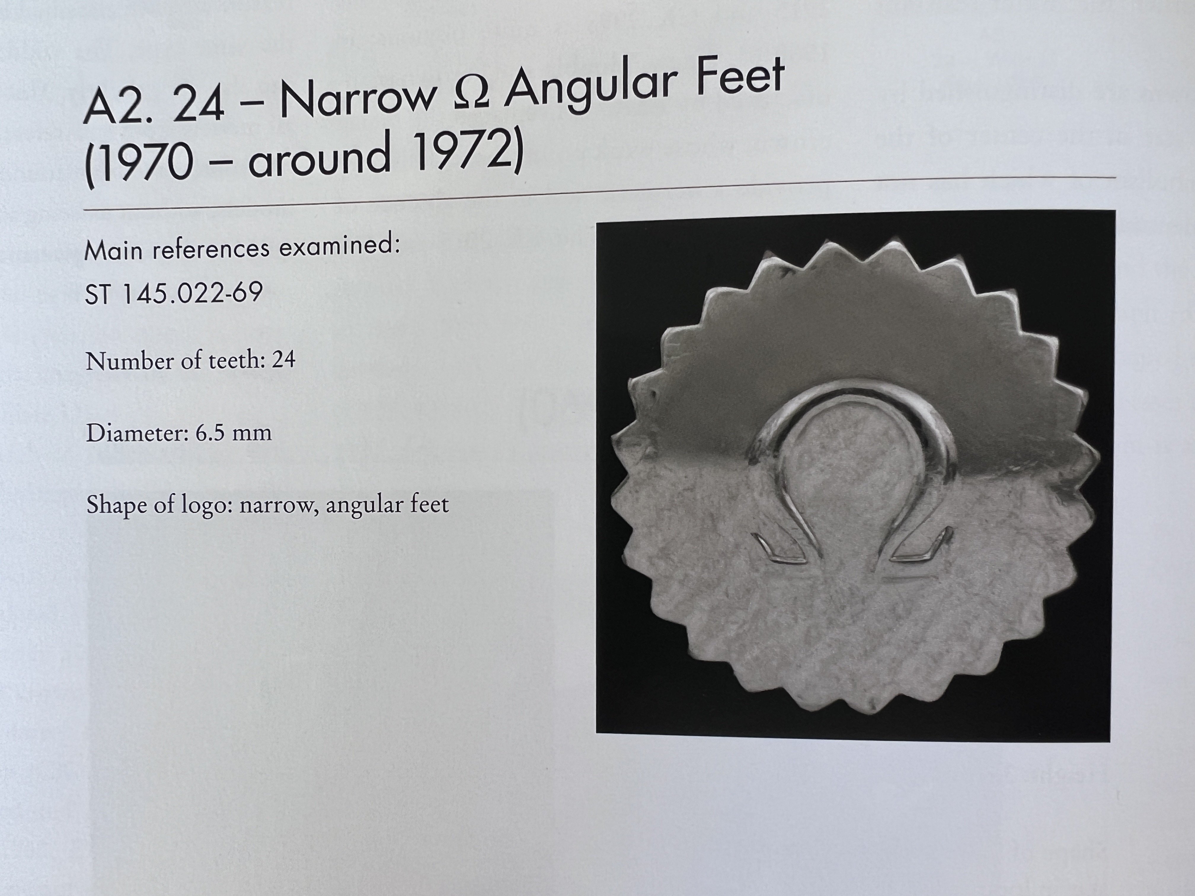

Trying to understand...
The picture that you posted looks likes an older one (A1.24)??
But then the watch that I wonder about is a 145.022-68...

I checked up my 105.012-66, and its got the A1.24 crown!
I am too Old for this shit!😁
Thanks for your help mate!👍

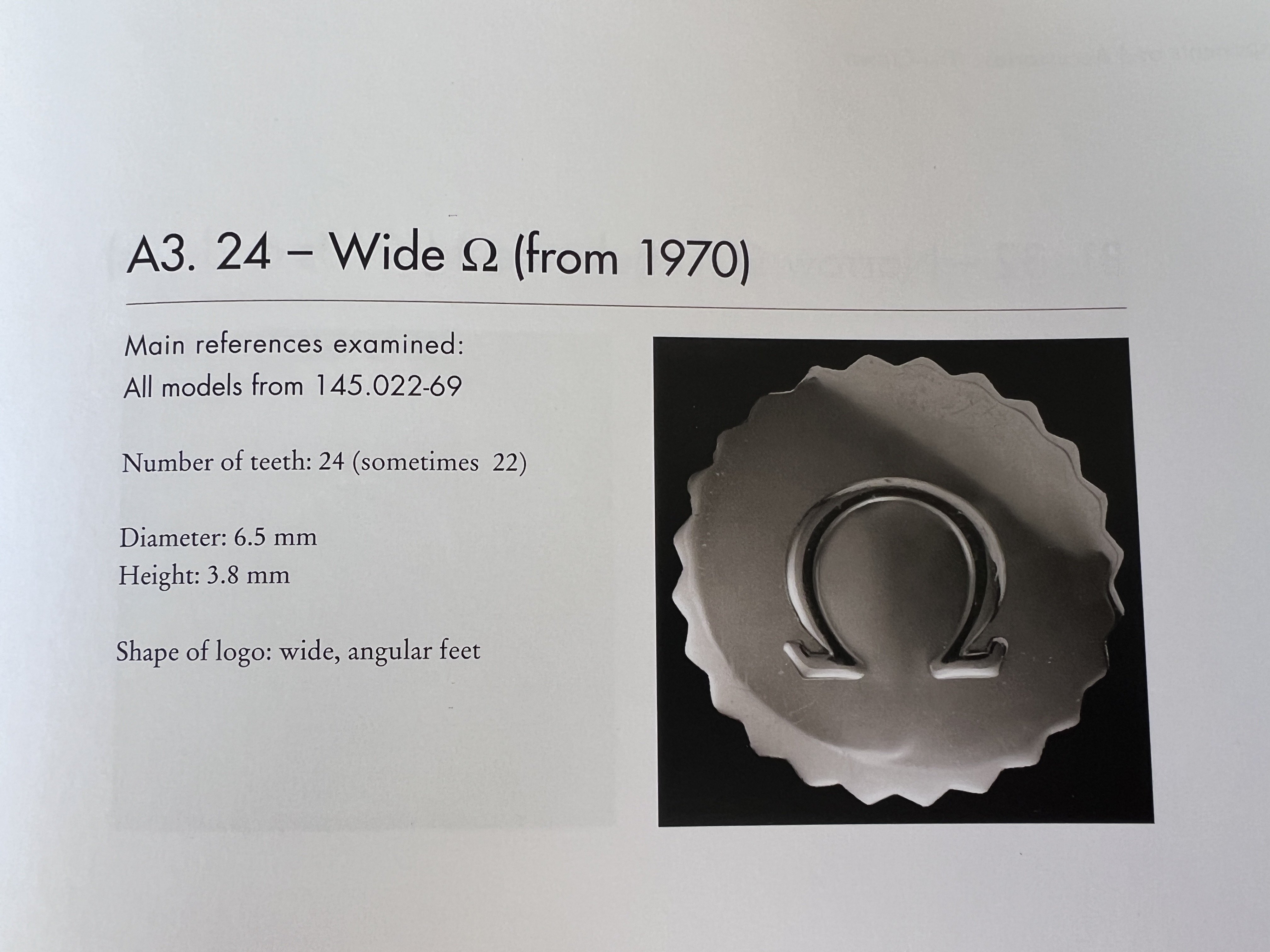

I started compiling a database of Speedmaster references with crown type a few years ago but never found the time to finish it.
Notionally, the 145.022-68 tended to come with A1, the 145.022-69 was where the transition to A2 happened and although it’s hard to tell do to The prevalence of service crowns, I think the A3 can be found on some of the last -69 Straight Writings.

Your first post has the dash 69 reference from the MWO but you are asking about tge dash 68. This confuses me.

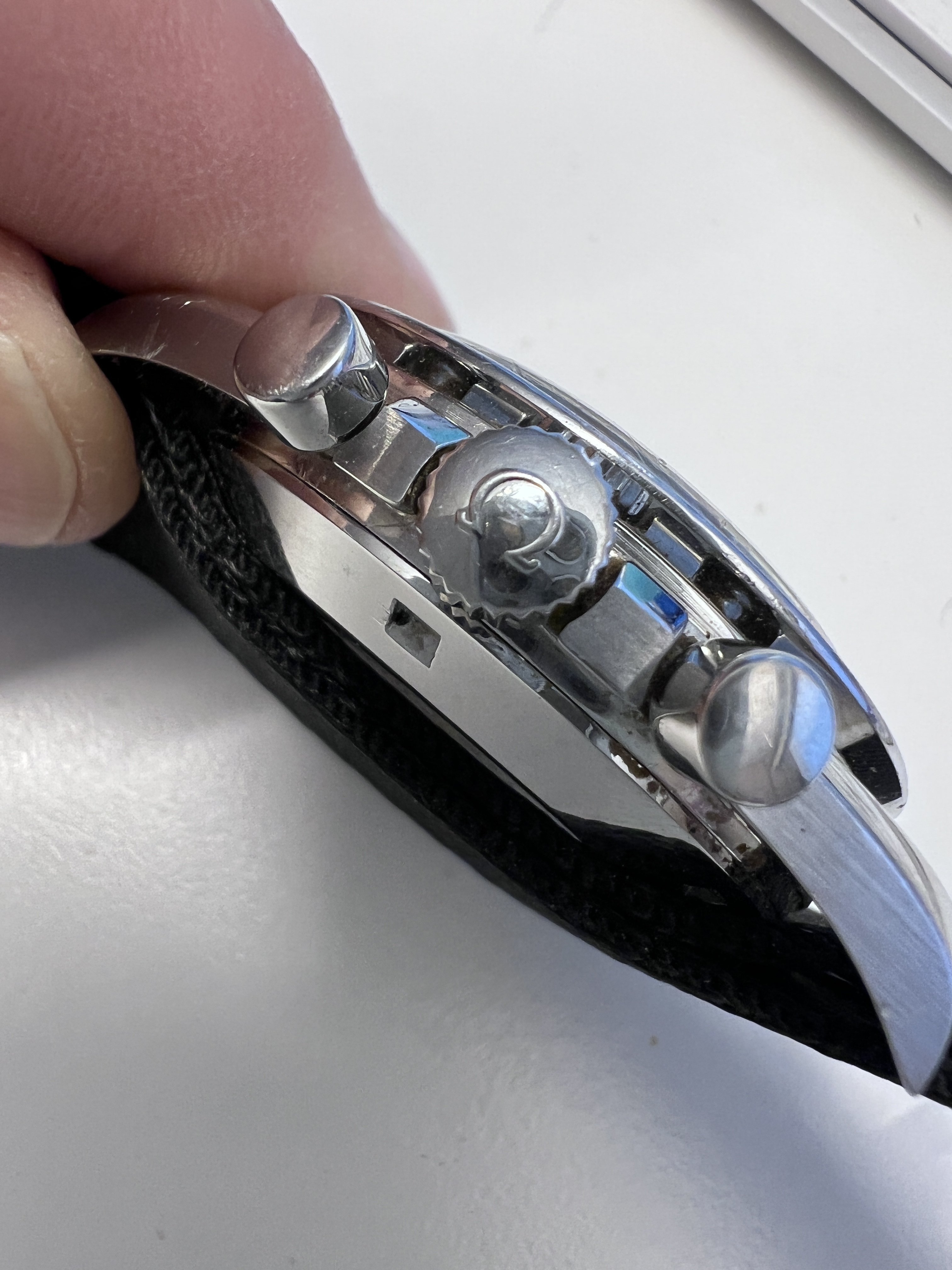

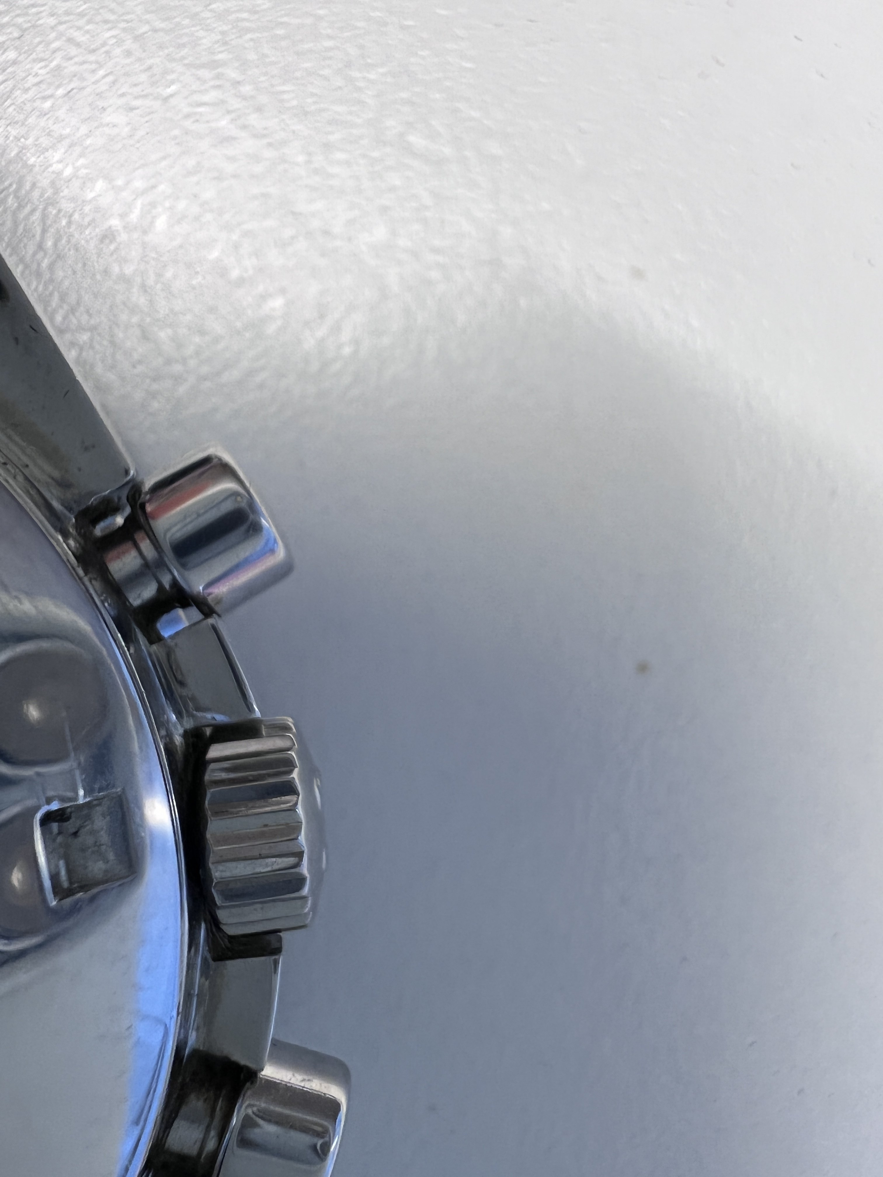

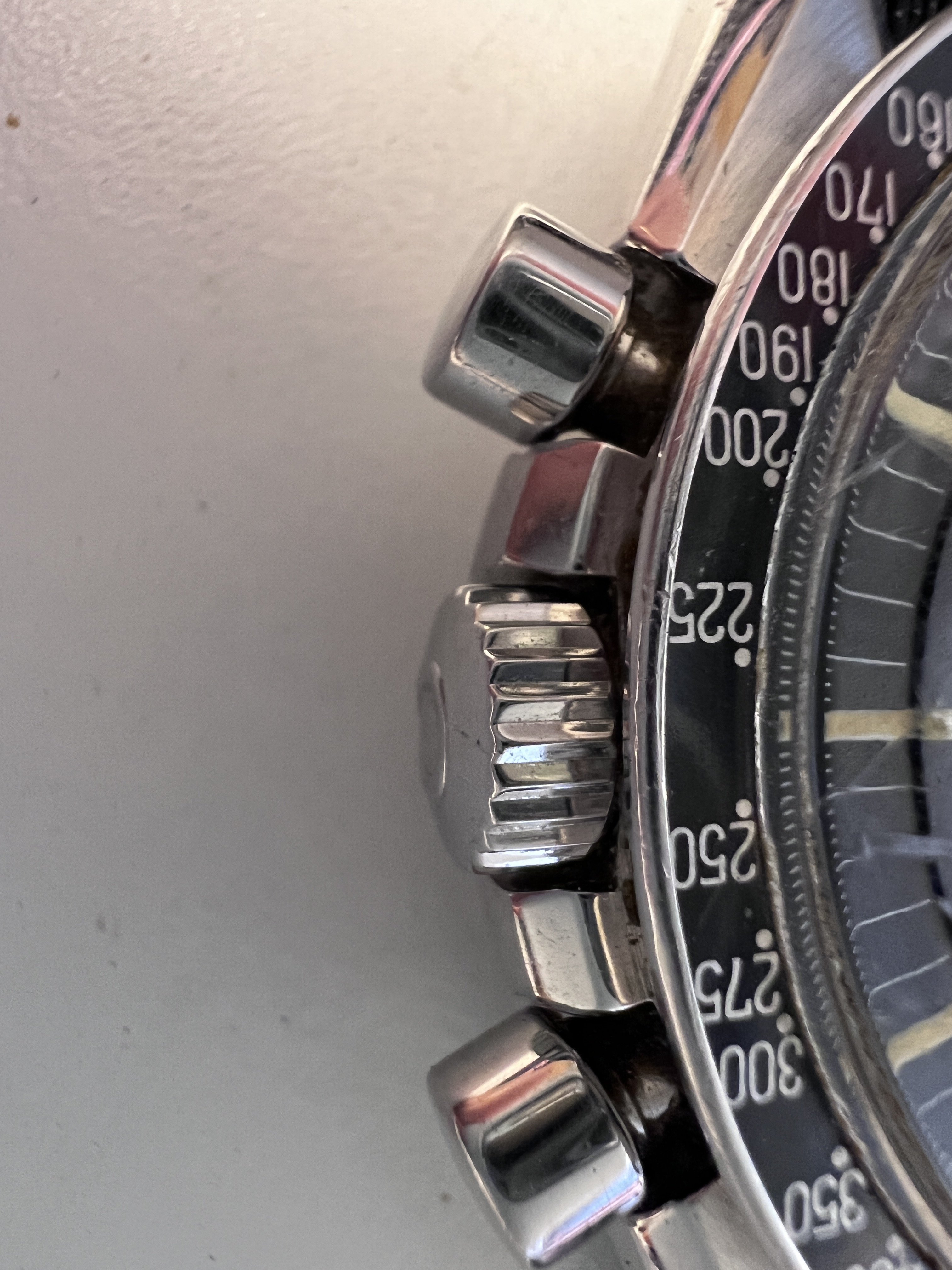

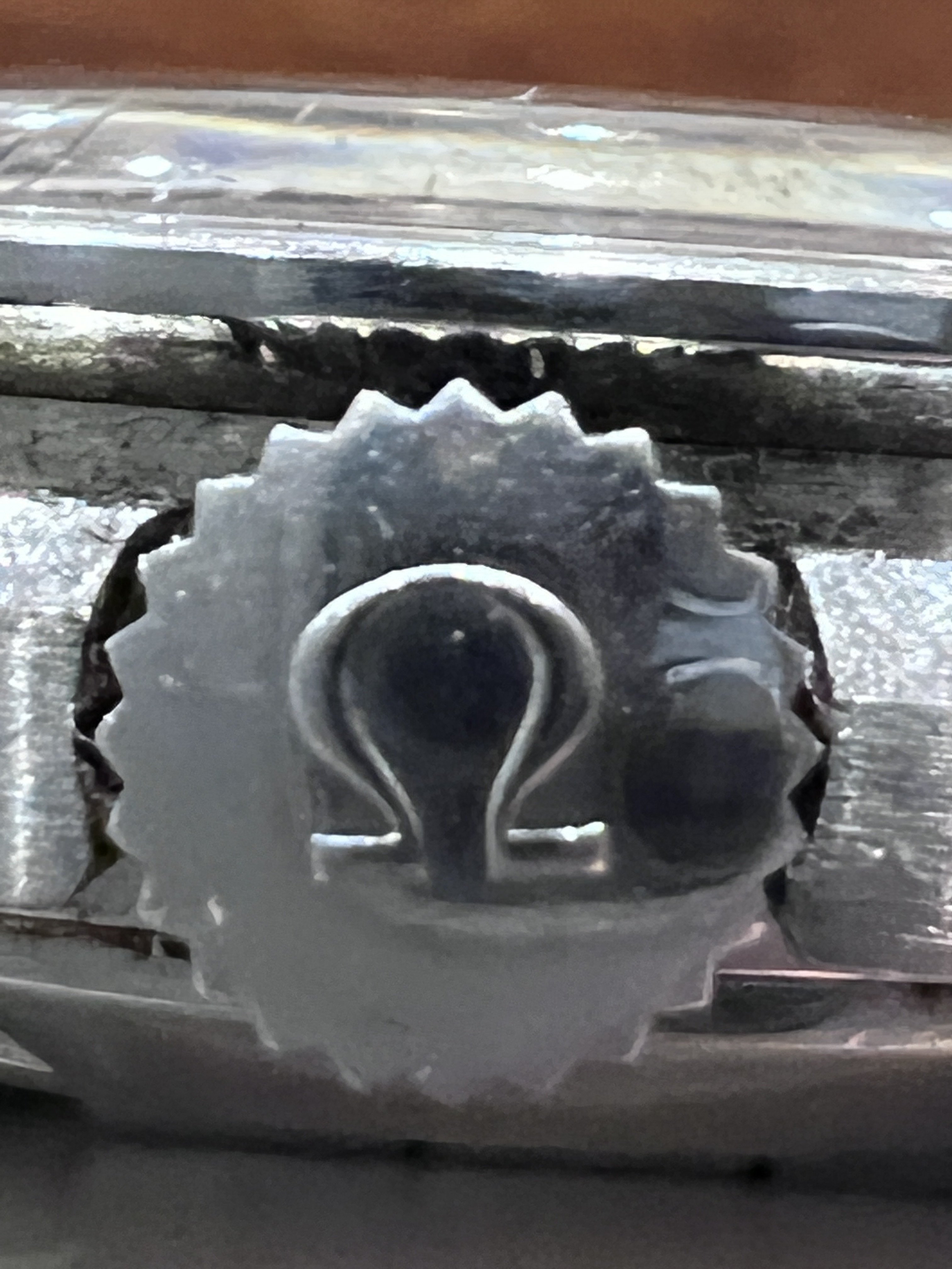

Well here is the final result!
Me Sooo Happy, and thanks with your help here Guys!

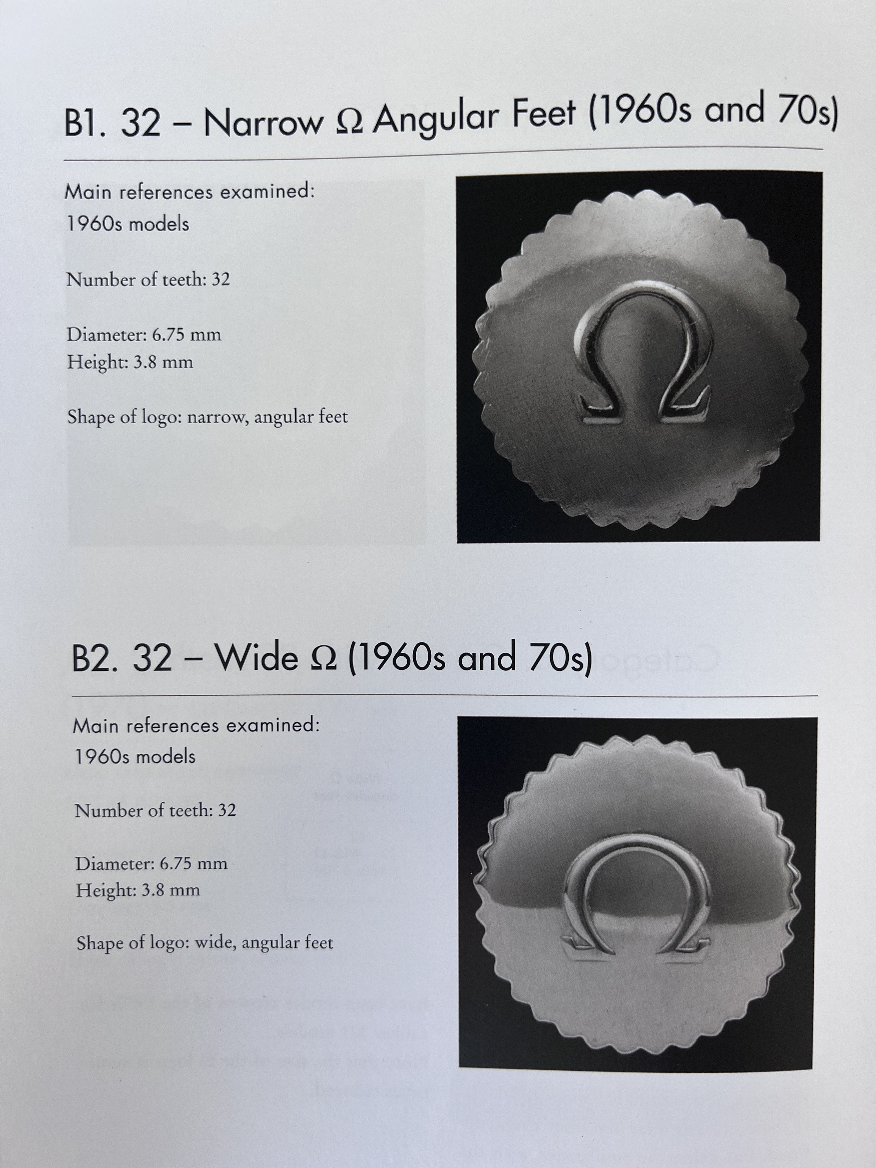

I have one related question. So, from 69 (1970) the original and now available new crowns are the same design?

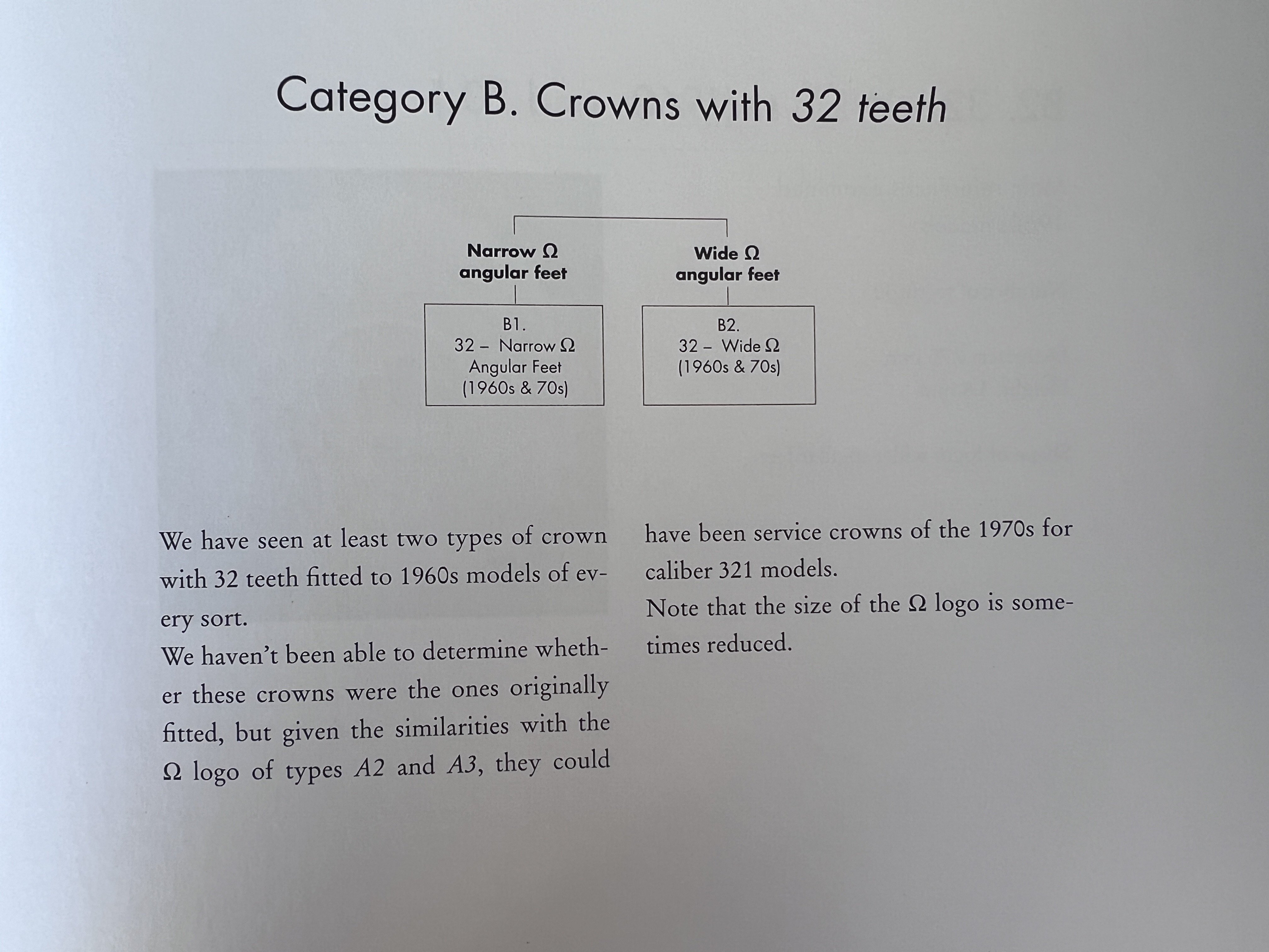

Here are some pictures I took from the MWO book, and to answer your question - its a jungle out there regarding crowns!

Looks like I have a B2-32 on my 105-012-66
... And that's not a good news...🤨
