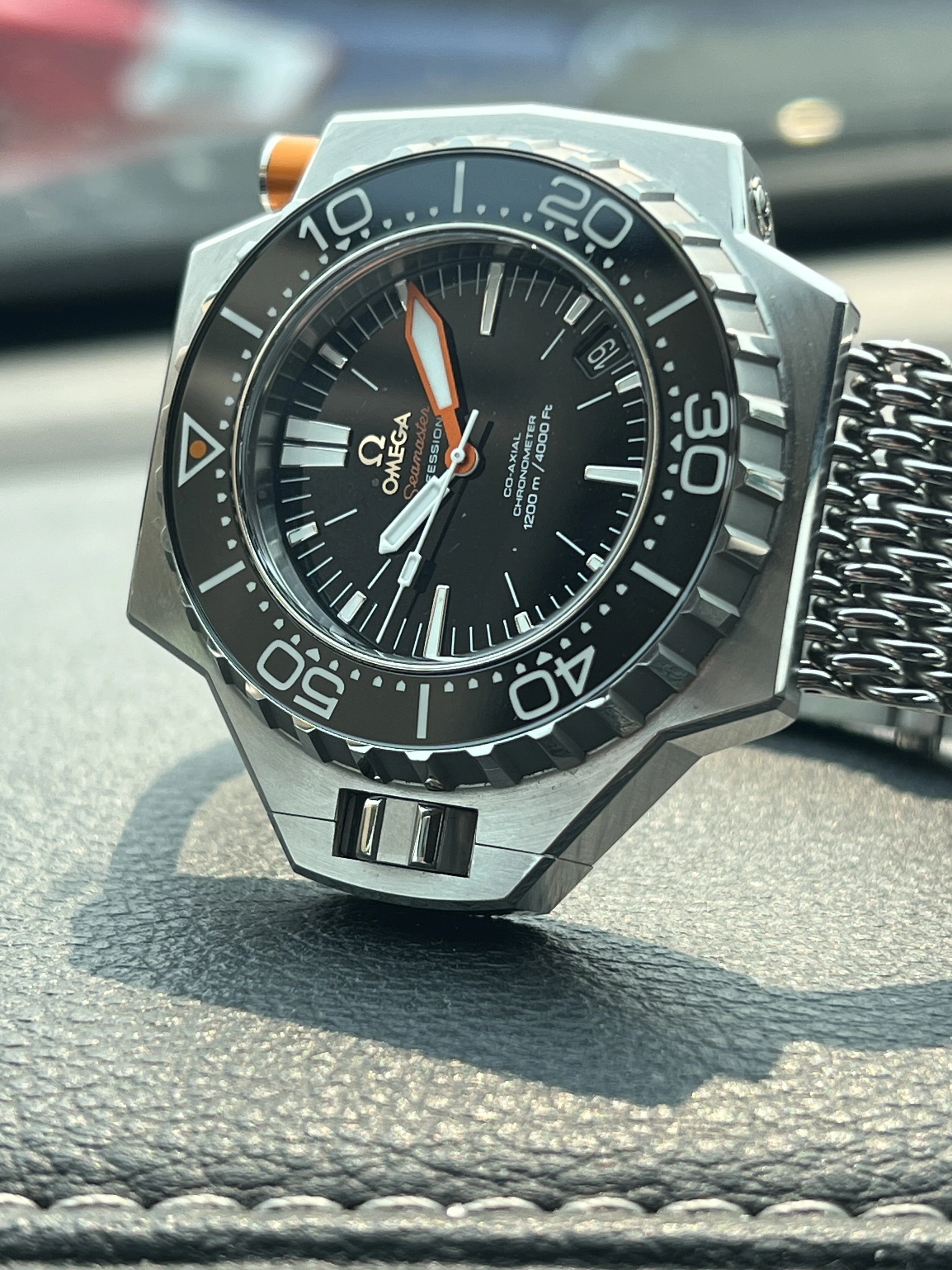

Good afternoon everyone. I wanted to introduce myself to the forum. I've followed the forum for several years, but this is my first post. I have several Omega timepieces including a Seamaster 300 (Watchco) and a couple of Flightmasters. Omega recently opened a boutique near me and when I stopped by, they were showing me their new Witschi ProofMaster. They told me to bring in my Omega timepieces and they would test them. I had to return to the same area this past Sunday and I took some of my watches along.
They tested my Planet Ocean chronograph, the Seamaster 300, the X-33 Gen1, and both Flightmasters. They all passed the 5-bar test. The only watch that did not pass the test was my PloProf.
I had the PloProf serviced a couple of years ago. I know this is not a guarantee of current water tightness, but it seems odd that all other watches passed while the PloProf failed. I know that the ProofMaster measures deflection under pressure to indicates water tightness. If there is no deflection that is an indication that increased air pressure has entered the case and therefore it is not watertight. I was wondering if it is possible that the PloProf is constructed such that under 5 bars of pressure there is no deflection and thus the ProofMaster indicates the watch is not watertight.
Thanks in advance for any comments.

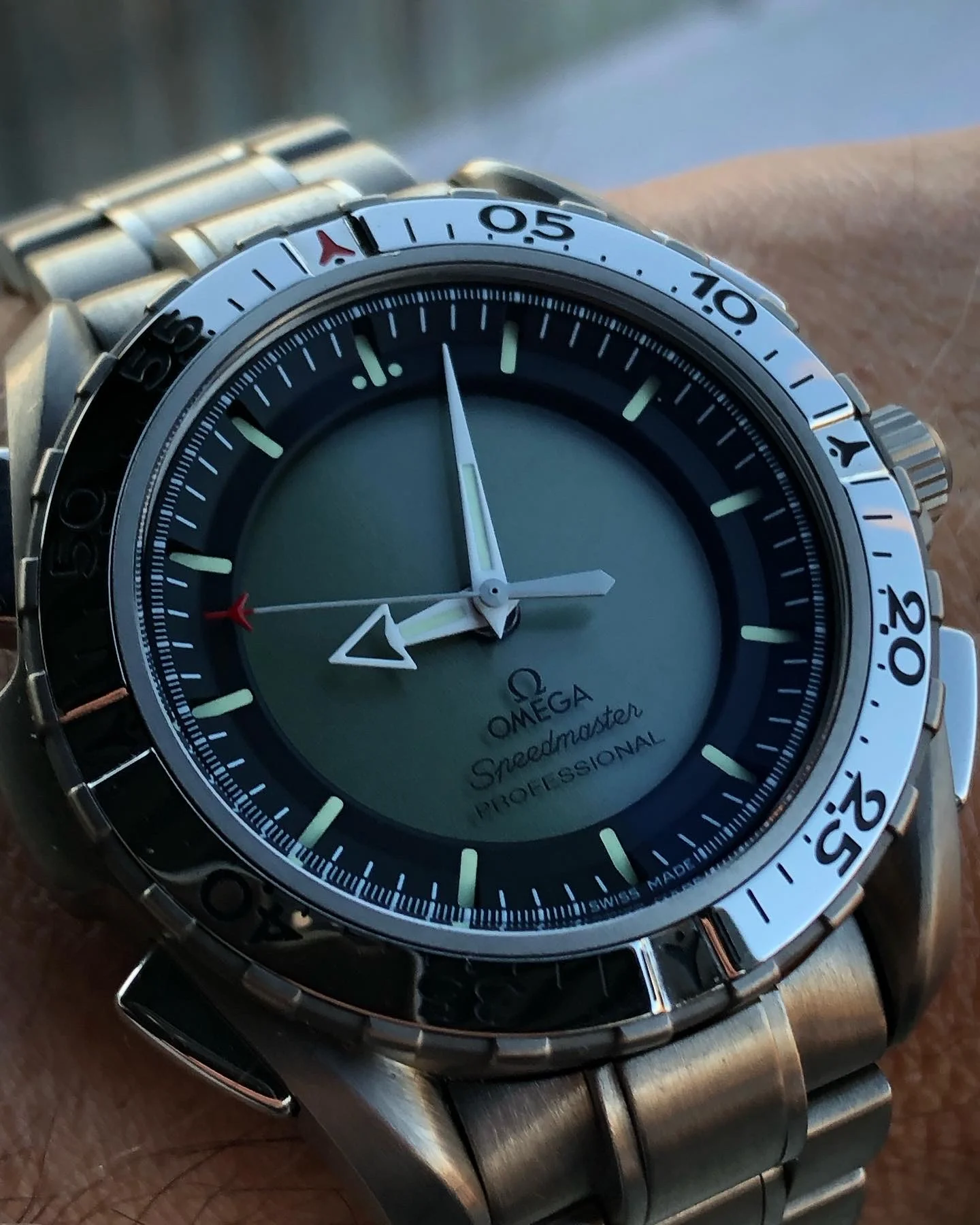

Can''t answer your question but how clean does that X-33 look, did it get a recent service?
5
5
No services, other than the occasional battery change. However I am careful when I wear it 馃榾

Welcome to the forum. Beautiful watches. Are you talking about the vintage PloProf (monobloc) or the modern one (screw-on caseback)? And if you have please provide a photo for our entertainment.
5
5
Apologies. I have the modern PloProf.
18,834
39,161
If they were doing a dry test I doubt it would have any deflection impact on that brick (brick in the nicest meaning).
For a 1200 metre diver, a specialised wet tester is required.
I think @Archer has demonstrated one in the past.
2,655
2,841
I too would be shocked if a 50m test would do very much to a watch capable of 24x that. It obviously DID deflect, but I could definitely imagine that it is too small of a deflection for the tester to notice. I would imagine THAT is more likely than a fairly new Ploprof would be sucking up water at 50m...

Typically when a watch fails the testing with no deflection, the machine will display a message that says "big leakage or not compressible watch"
I would not expect a 5 bar test to produce an accurate results, which is why Omega requires that a wet test is performed on these.
