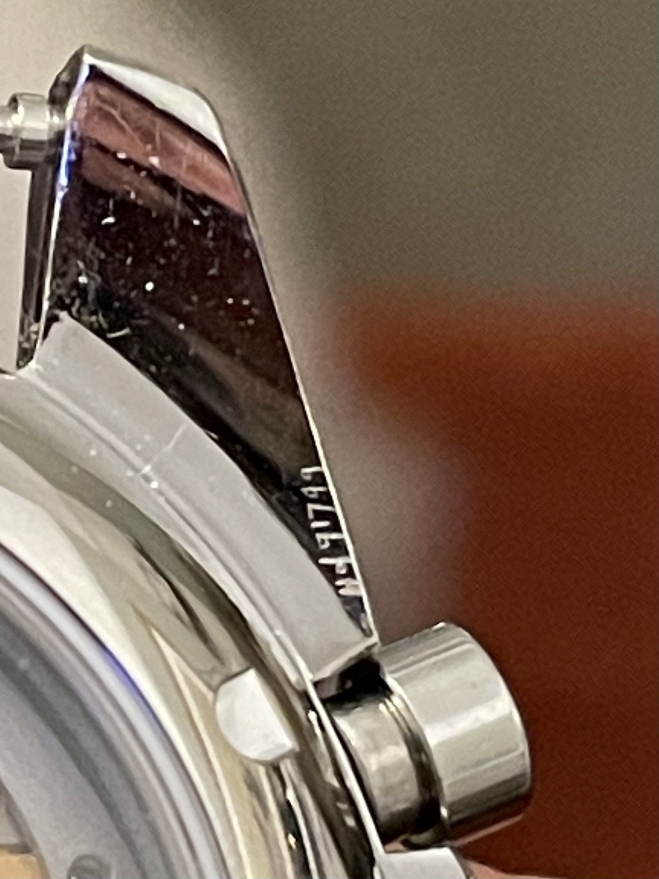

I went against the grain and kept it… I like the tritium dial, the slightly faded bezel and the freshly serviced movement is a thing of beauty.
With that said, I noticed this small engraving on the case and wondered if it meant anything specific or merely a reference for someone at point?

The number falls just outside of my observed range for the -65, but I have not revisited this for some time, and it may be that your number and case back are correct.
however I would be more worried it was a non speedmaster movement. No way to tell until the purge in Bienne is complete and all the witches are dead.
The dial is a rare service dial, fitted by omega regularly at some point. I have one. They are very uncommon and to me interesting. Not valuable though.
The number on the lug looks like a watch maker mark.
at £5000 you could have done a lot worse. Especially if it turns out the movement is 105.012. Just the parts will cover your cost.
I am actually a huge fan of watches like this, that is less expensive more correct than not watches - as long as you know what is right and wrong. Here we have correct pushers, a DO90 bezel, a movement that may or may not be speedmaster, but if it is the parts value is starting to add up - then the bracelet- it’s ok.

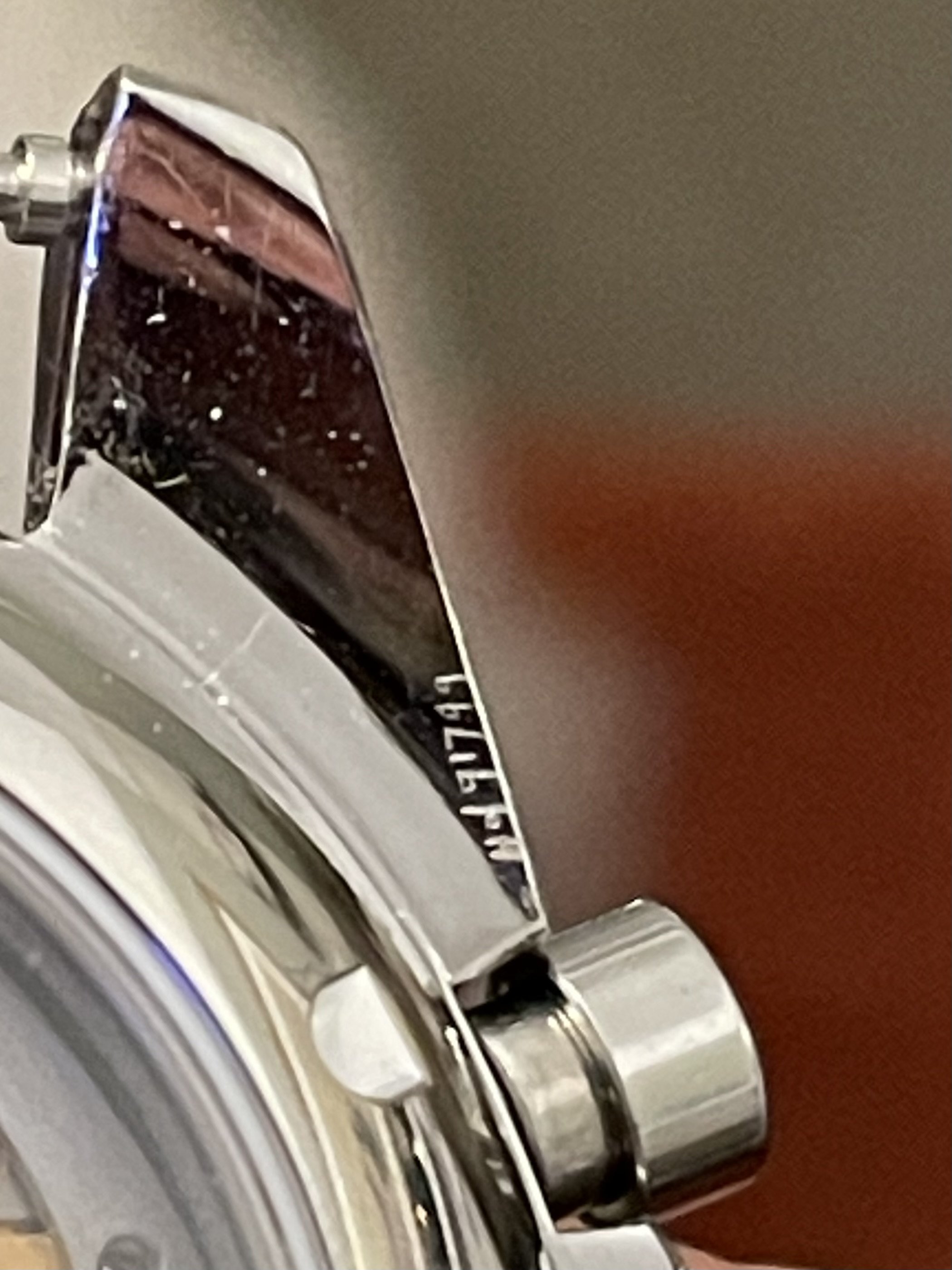

Thank you for the detailed reply! Yes I spent some time going over serial number ranges online, some had it just in at the end but most had it just after.
I think that would have been my deal breaker, but without the archives and them not having any information at hand I had to take a gamble on that one unfortunately. I’ll just have to keep my fingers crossed!
I came across very few when I was scouring the internet for information, but I like it. It looks quite nice without the professional squeezed in underneath, With the dial and hands patina matching, I can only hope this Speedmaster was serviced at some point and they were both replaced onto this movement.
You’re probably right on that one. I was trying to make out what the first few characters were, but I could only get the numbers at the end.
I’ve definitely kept this from a wearing point of view rather than a collectors. I get to wear a (hopefully) Speedmaster that has had some history and touch ups along the way, without worrying about murdering the value of an all original collectors piece doing something stupid,
