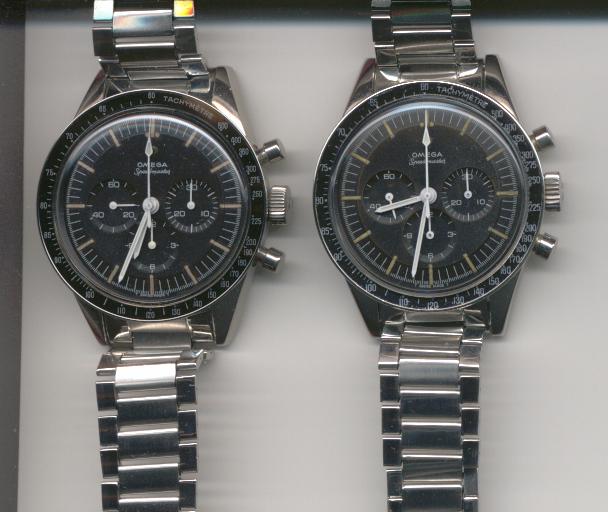

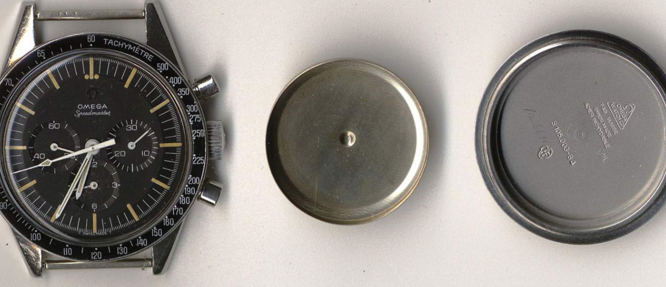

Tom,

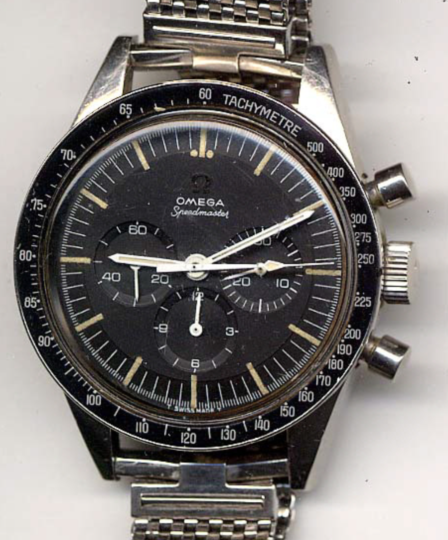

Your astute observations on the 64's got me thinking back, so I fired up the old computer and found this discussion from 12 years ago with a noted Omega collector from the past. Also, have included the original pic from that discussion, which was done on a scanner (were camera phones available then?). The differences between the two are subtle from the poor scan (64 on the left), but you can still make out the sharper edge there. One could argue that because the hands and bezel are not original, that the case was refinished as well. This is actually not the case, because I stupidly changed those items back in the day to make the watch look better...don't forget, this was WAY before they were super-valuable, and people frowned on replacement parts; case was untouched. Will continue to look for my exchange with Chuck Maddox. Don't know if it clarifies anything, but it might be of interest:

1,527
4,379
Bob
That's brilliant research, thank you so much, great looking watches BTW! I've reached out to some other friends who might be able to shed light and am waiting to hear back from them
7,355
23,822
Tom,
Many thanks. Will very much look forward to what you uncover. Uncanny that a nearly identical conclusion was reached almost twelve years apart!

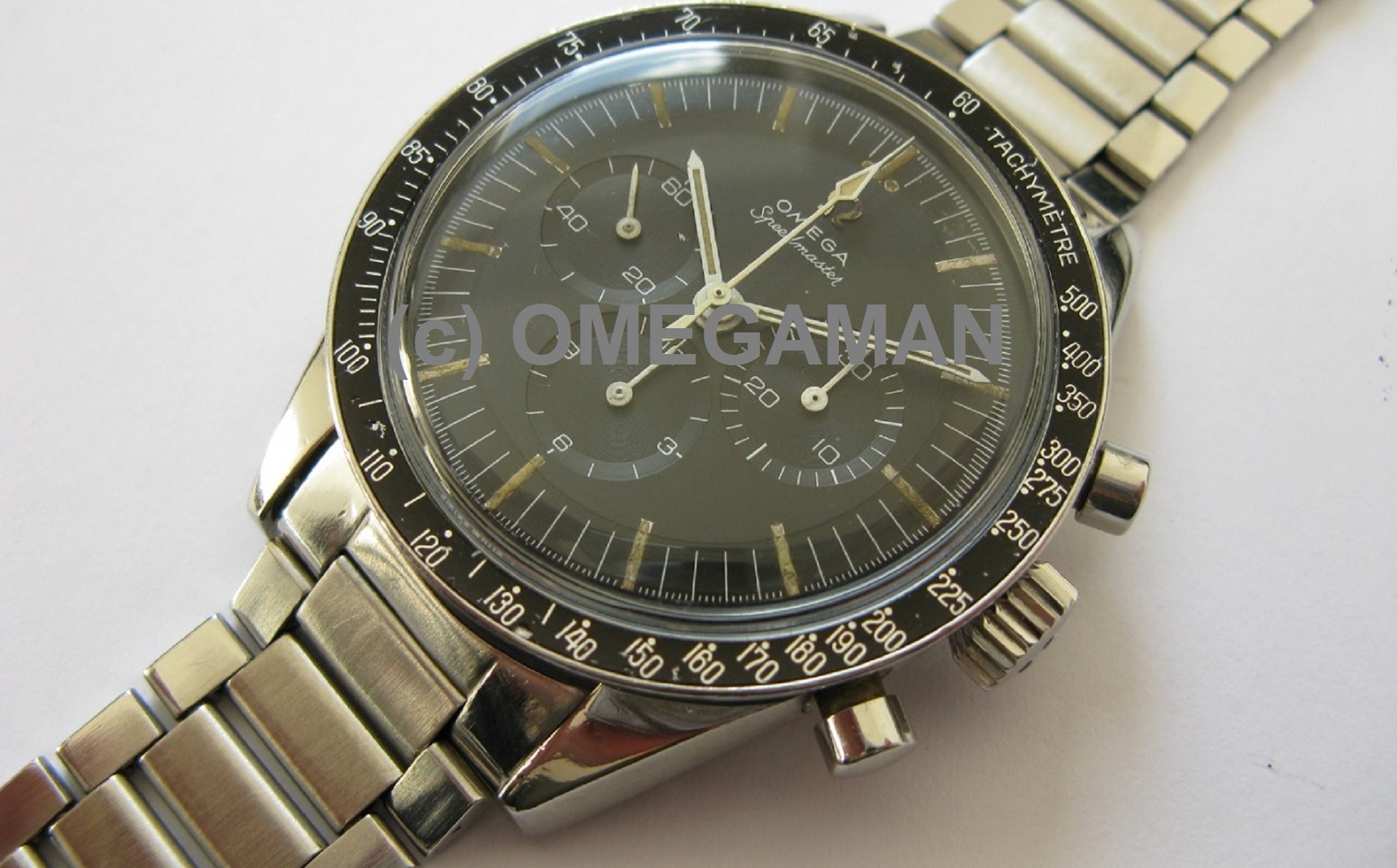

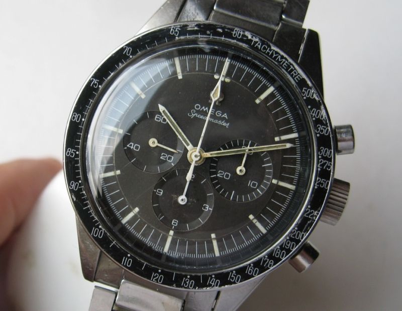

One just posted on ebay. It looks like it had a bevel at one time to me, but I dunno.

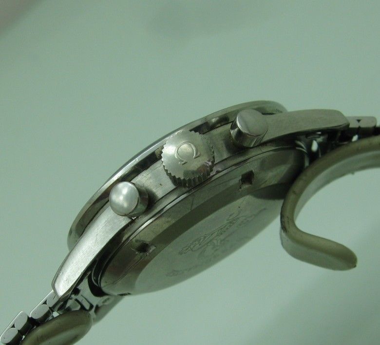

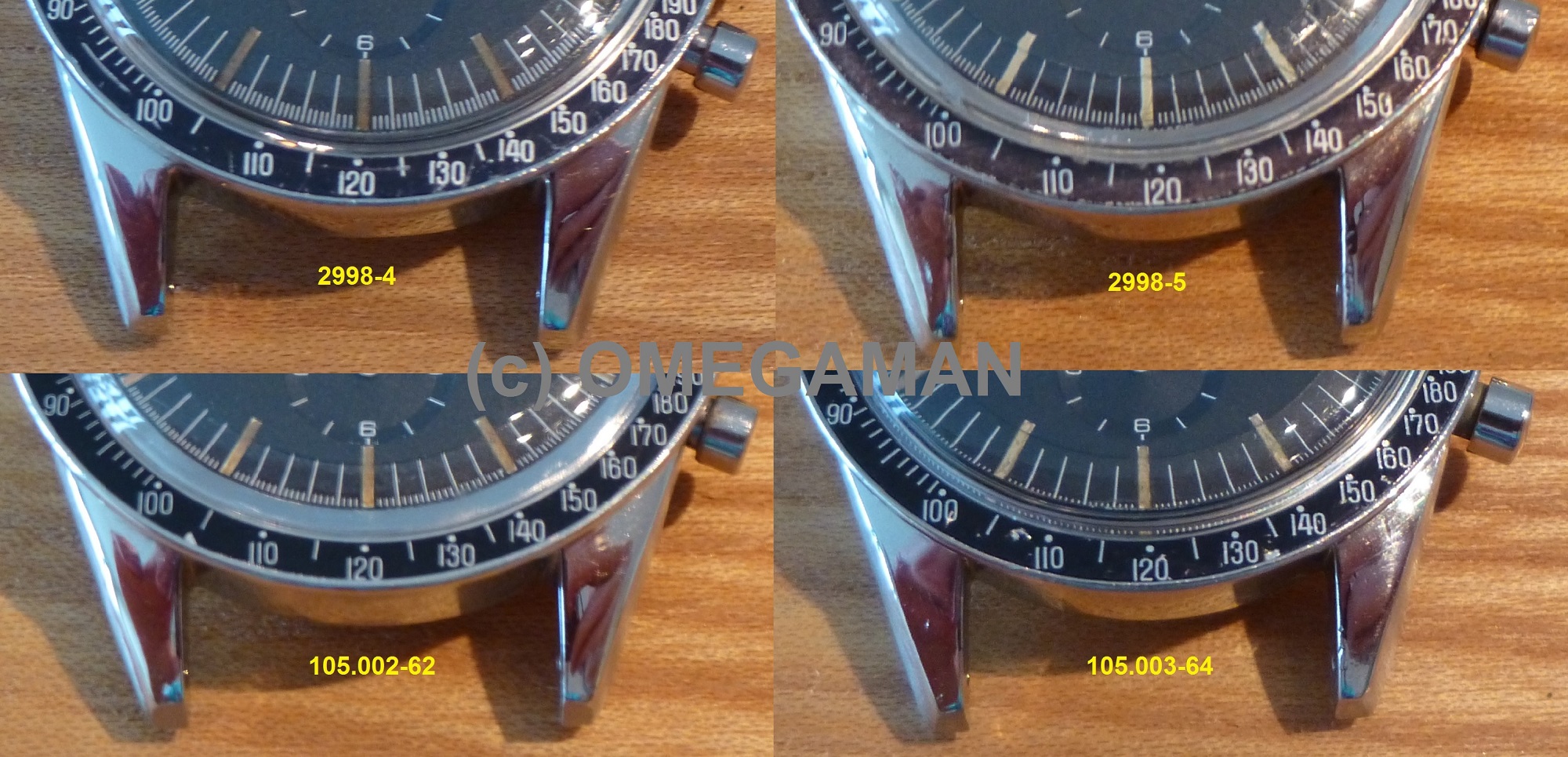

I've just put together some cutouts from pictures of my 2998-4, -5, 105.002-62 and 105.003-64. Unfortunately the 2998-5 is a little bit rocked, so can't be taken for reference, but the other look pretty good, I think. Although it's not that obvious to tell from that picture, I agree with you that all 105.003-64 have sharp edges and no facets.

Really useful images, many thanks, Im feeling quite confident about the 64 at the moment but still hoping to hear from other informed 'seedy aficionado's' on the forum

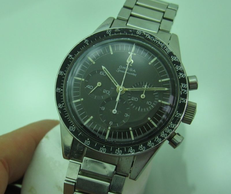

Here is another one of my 105.003-64 solo. The sharp edges are clearly to see.

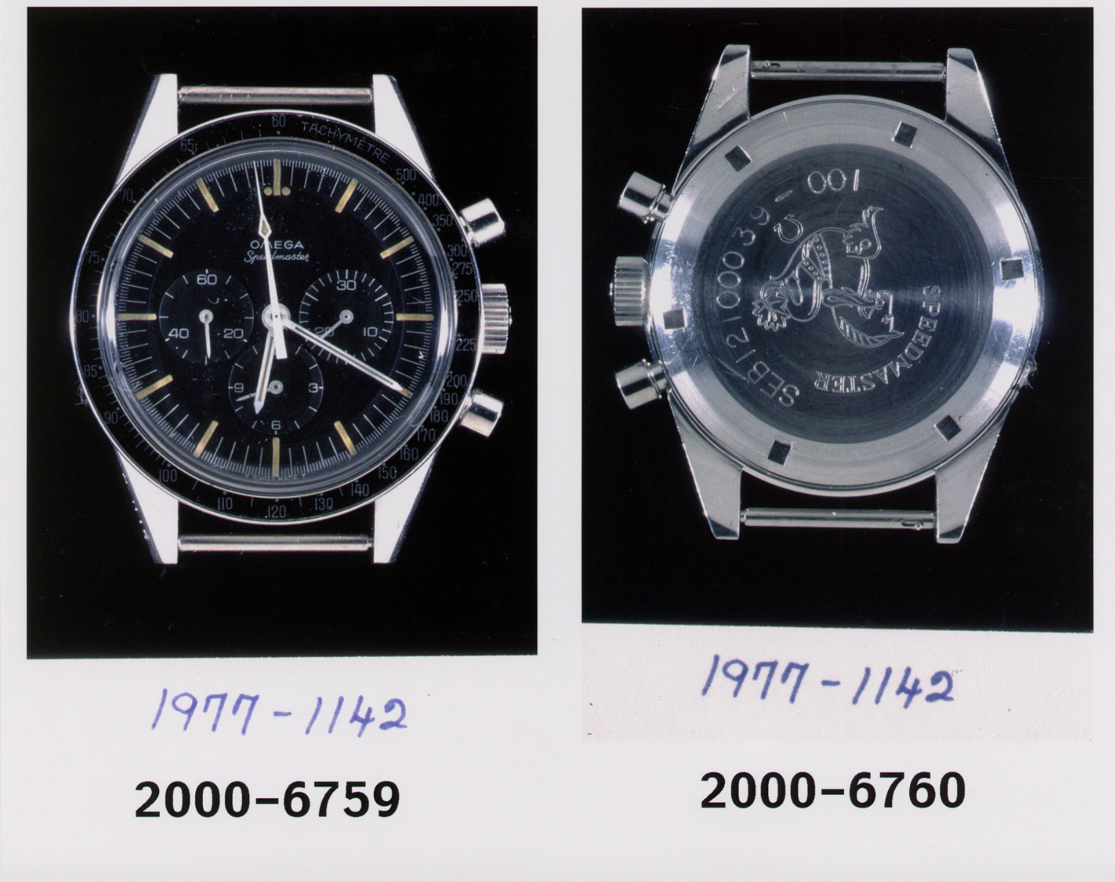

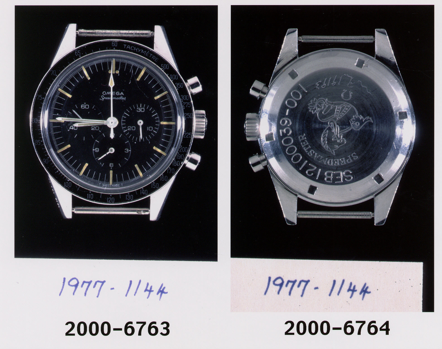

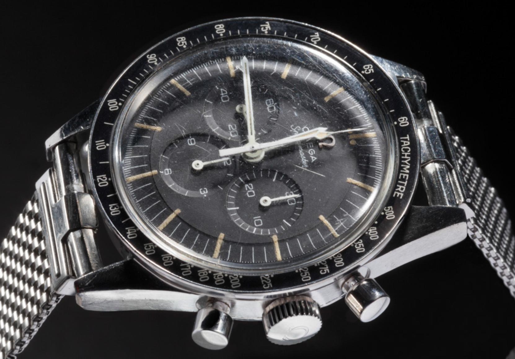

A fellow forum member gave me a link to a brilliant source I have not yet discovered, it is a collection of NASA flown watches at the Smithsonian research on these very special watches, amongst them Where some 64's Jim Lovell's untouched and unpolished 105.003-64 from Gemini 12 and Tom Stafford's 105.003-64 from Gemini 6
Note the untouched and near NOS case and the very sharp edges with a clear lack of facet............ looking more conclusive to me by the day and thanks again for the amazing like
(also as a side note its interesting to see how many of them have had replacement dials and in some cases 861 movements fitted)
Lovell Gemini 12 (105.003-64)
Stafford Gemini 6 (105.003-64)

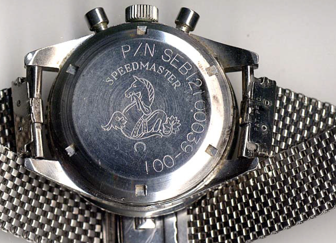

Gordon Copper: Gemini V 105.003-64
Again note the nice sharp edges, also on the reverse the flat area at the rear of the lugs is much smaller than the 105.003-65

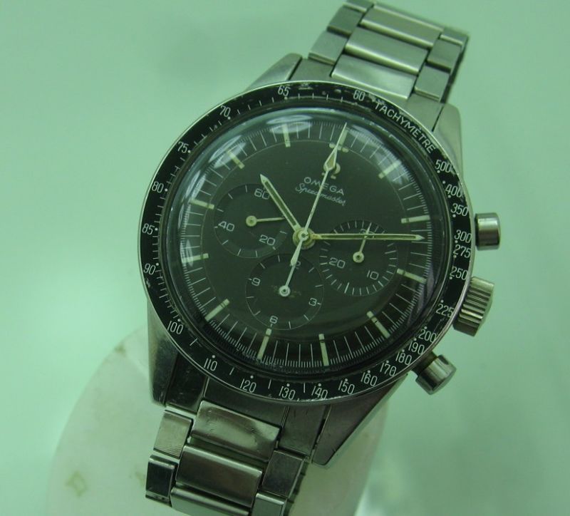

Found a few more 64's with exactly the same features and sharp lugs. Is there anyone out there on the forum who has a 64 with bevel edges. Really hoping to reach a consensus conclusion
