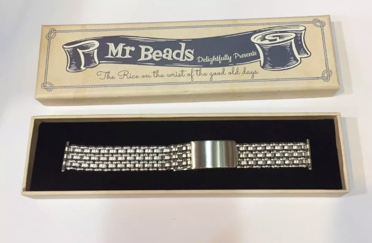

Hi, I recently purchased a 16mm aftermarket BOR bracelet for my 1953 bumper and the endlinks are a tad short (17mm lug width). I've looked for 17mm 5 line endlinks to no avail so thought about maybe filing down some 18mm ones.
Problem is the genuine omega ones are hugely expensive for this small project and I cant seem to find any reasonable costing after market ones.
Can anyone recommend a place that does these or think of an alternative.

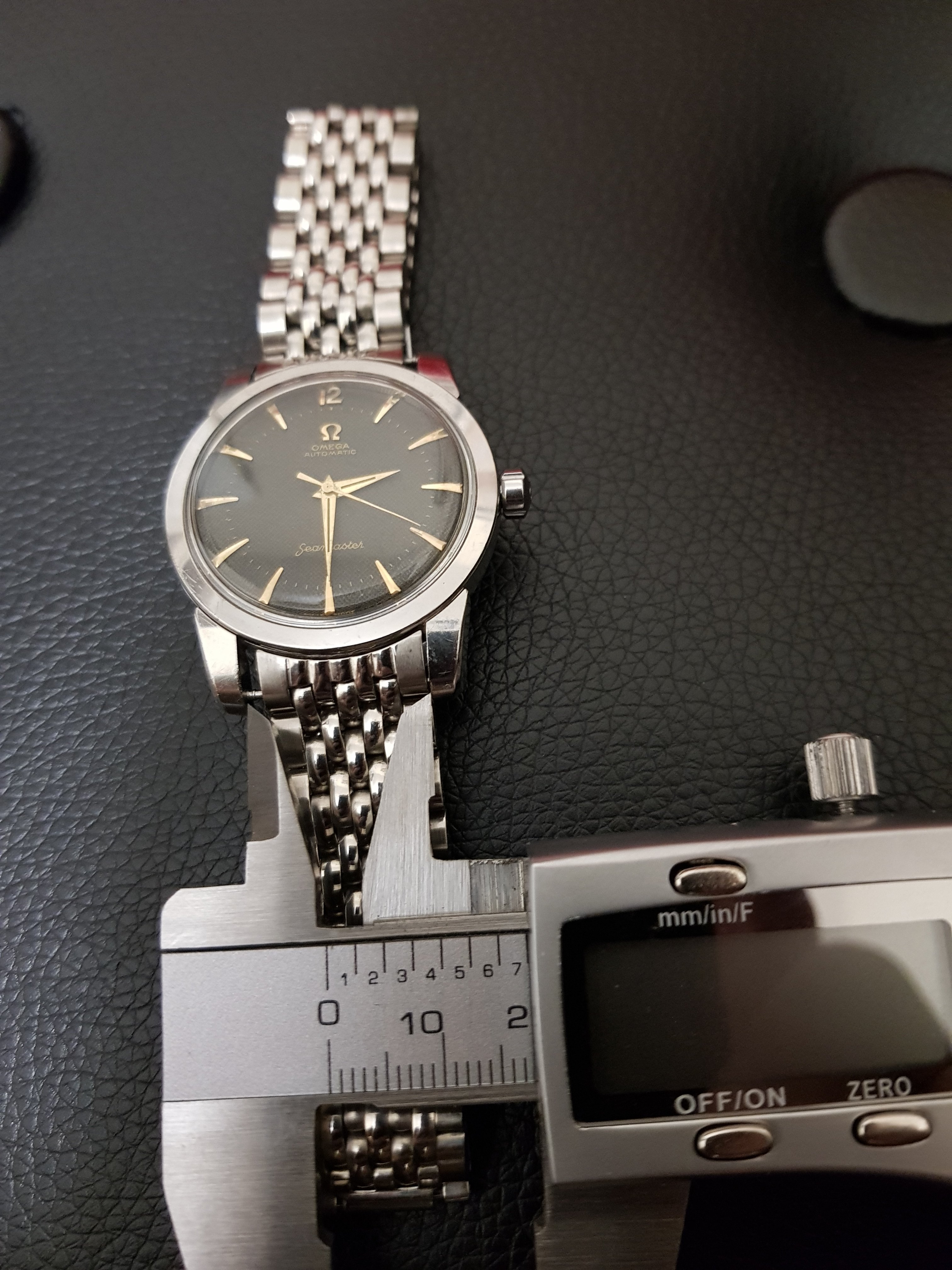

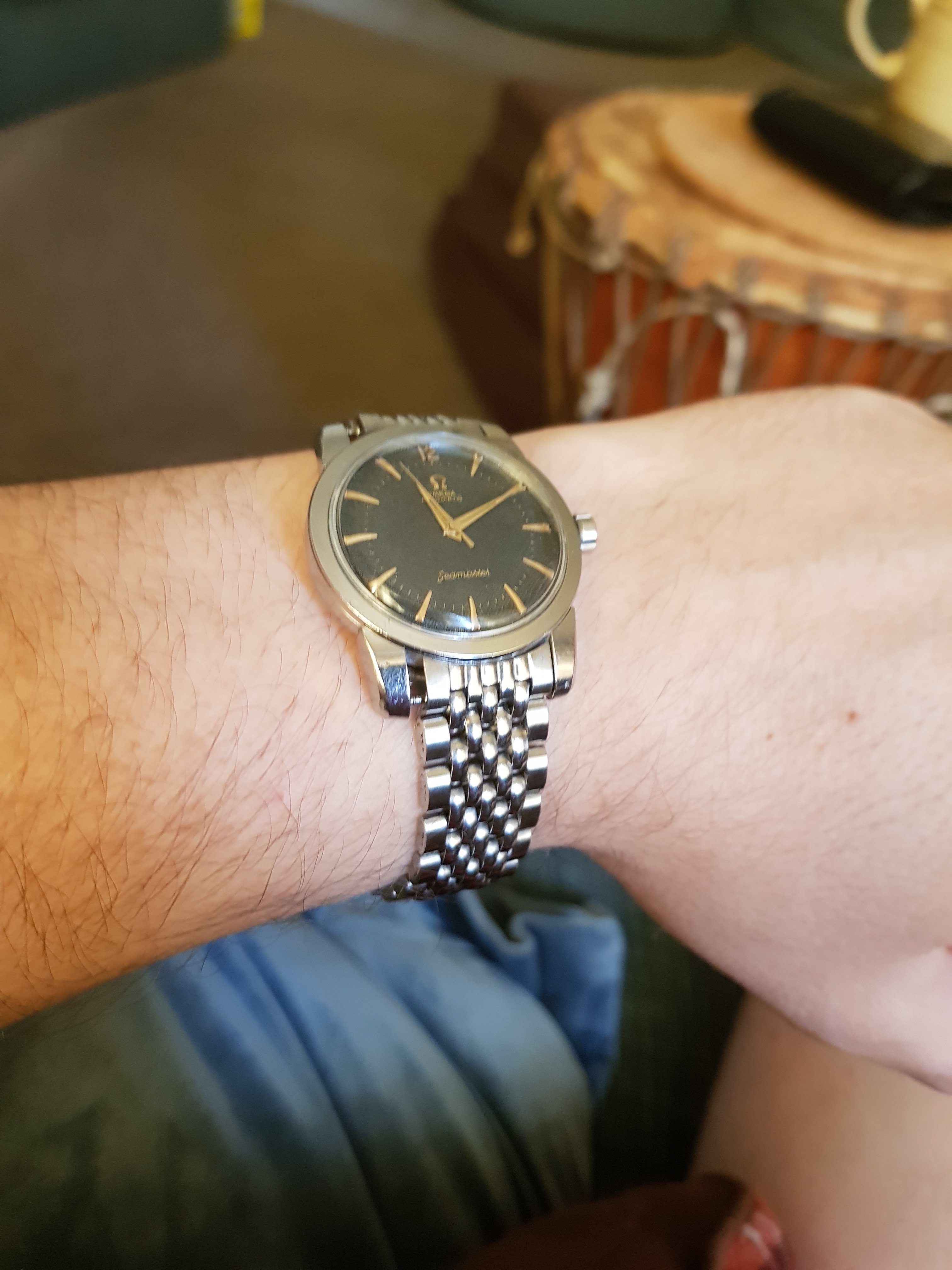

As you can see the gap in the photo...
Thanks

To my knowledge there are no 17mm 5row BoR Omega Endlinks. There are some OEM Omega endlinks which are 17mm, but they are all from later periods.
You can file down 18mm OEM BoR endlinks, and I am happy to give you the reference numbers if you need them with the bracelets. All in, I think it will be around 100-150 for the bracelet and endlinks with some searching on eBay.
Also there are also various suppliers of aftermarket BoR bracelets, perhaps instead of looking for endlinks you should have a look for just a flat end to the bracelet, similar to this one:

The watch looks to me like a 2577, or something like that. These take 18mm straps/bracelets, so maybe check your measurements again.

Thanks for the input, the watch is a 2767. Here is the measurement of 17mm.

I'd agree that filing original Omega parts would be a crime. I'd love to find an aftermarket one similar to what I bought but 18mm...the second hand orient one would be a great option.
I bought it from an italian vendor on ebay on item number 193017152620 for 30 bucks. And although it sounds a bit jingly I think it looks great, albeit improper fitting.

For the record, the ref 2767 is an international case and has 18mm lugs.

Yeah I've re-measured it with the electronic display on the caliper this time and it is nearer 18mm than 17mm..cheers guys for your input.
An 18mm endlink would definitely give me the desired fit.
