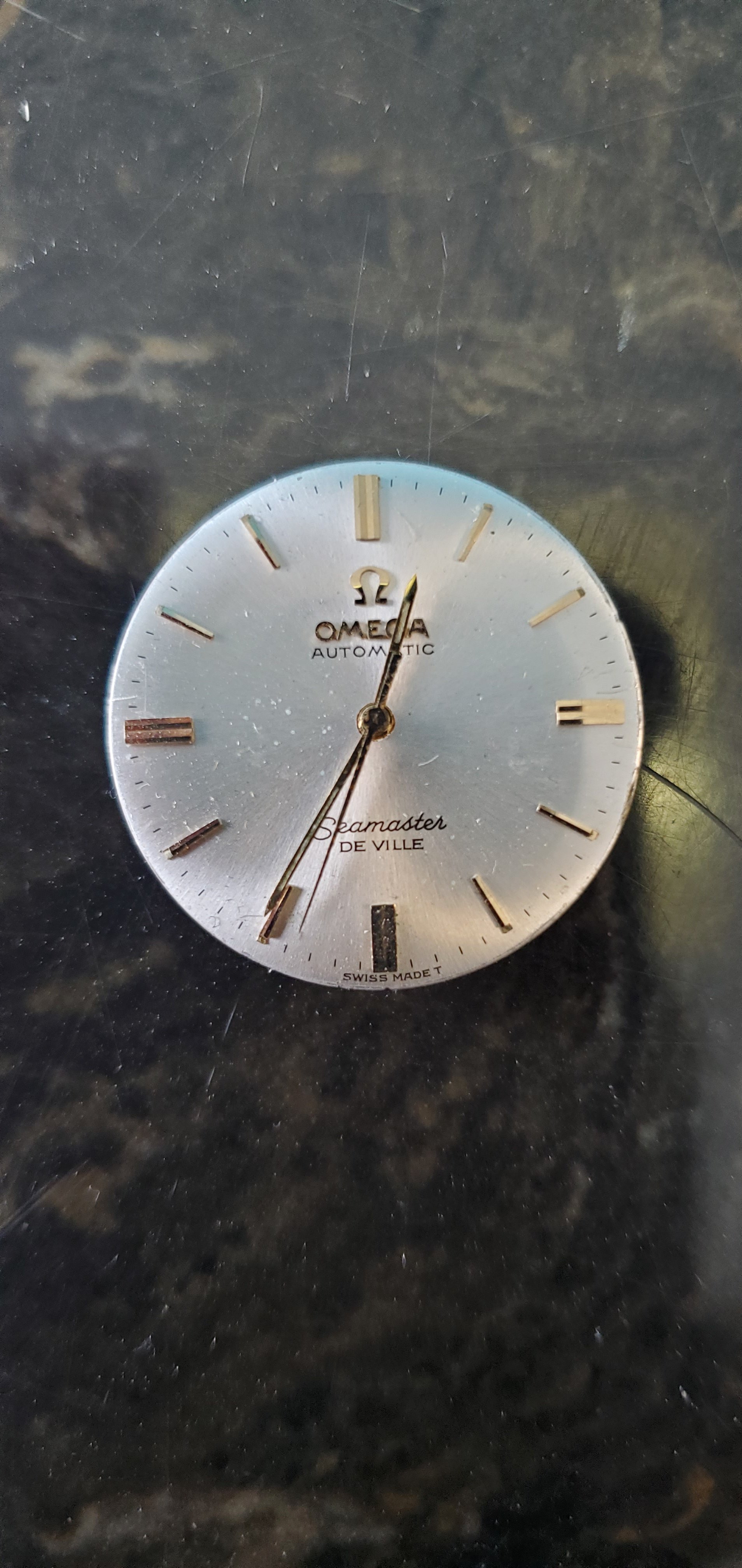

I am looking for help with a restoration of a 1960's Seamaster Deville which I bought for my small but growing collection. I also have a Panthere de Cartier, TAG Heuer Aquaracer, Rolex Datejust 16013 and a Hamilton Masterpiece "Thin-O-Matic". They are all in excellent operating condition with various levels of patina. So now it is time to get this Seamaster Deville restored and then I can find another project watch to work on 馃榾
Here are as many specifications on this watch as I can think of:
1. Model B6308
2. Caliber 670
3. Case diameter 31mm
4. 14K gold filled
5. 1960's apparent time of manufacture
6. 18mm between the lugs
7. Automatic
8. Runs and keeps fairly accurate time when wound and also runs automatically

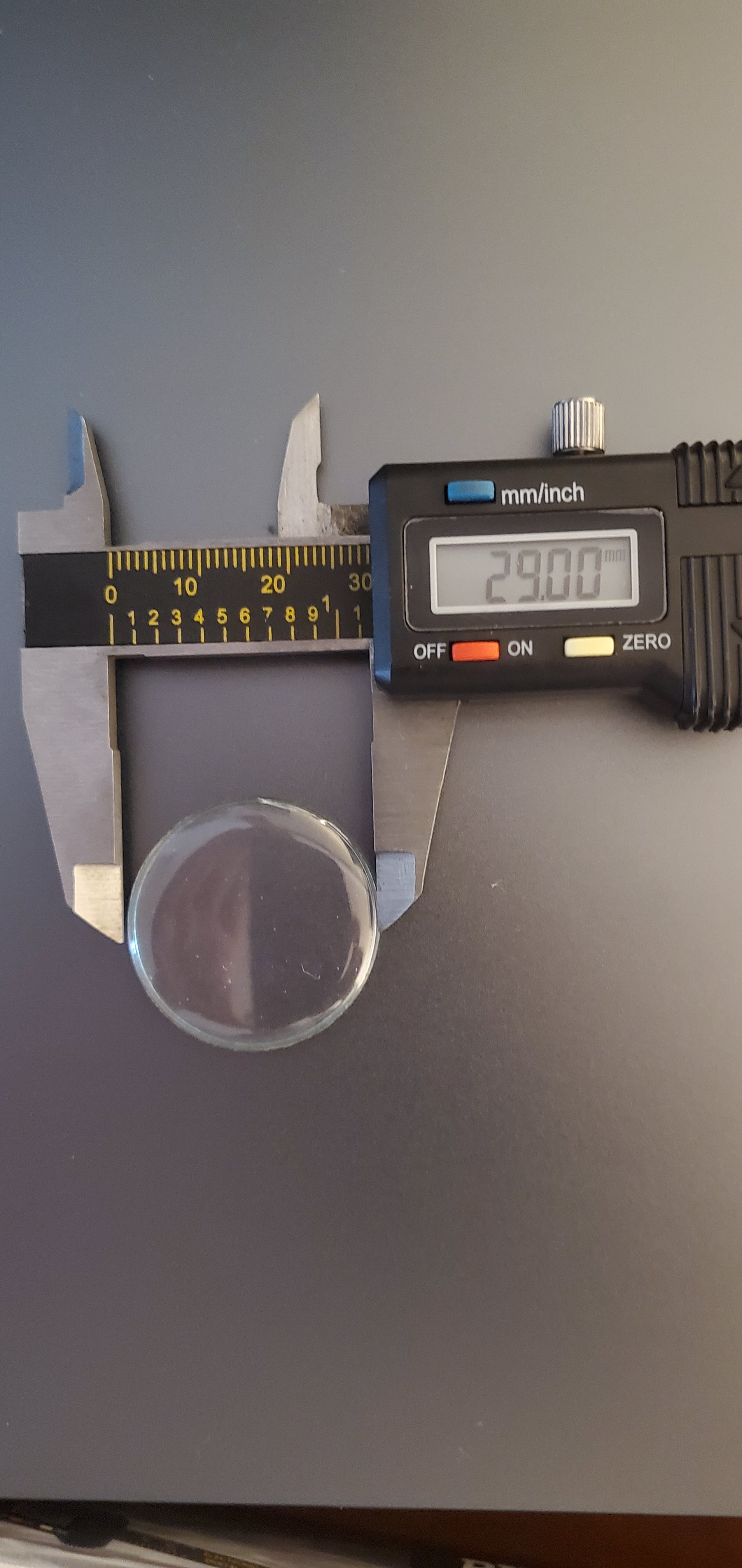

1. I want to replace the crystal with a genuine Omega crystal which is the proper one for this watch. I don't know what it came with originally; whether it was sapphire, plastic, etc. You can see from the photo that the crystal is 29mm in diameter. It also has a "step" or ridge along its circumference. FYI, I have the gold ring and it's in good condition. So I just need the crystal. Is there a part number I should be searching for so that I make sure I order exactly the correct crystal?

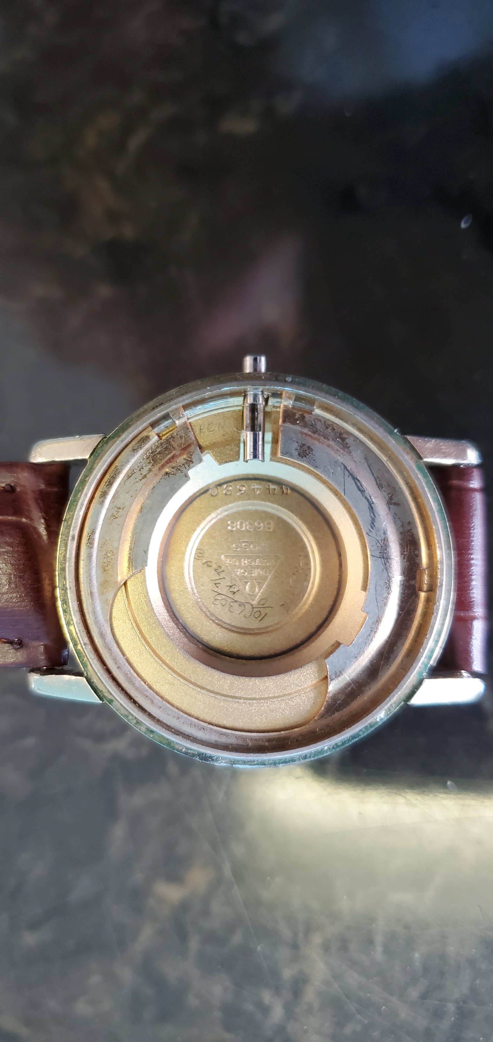

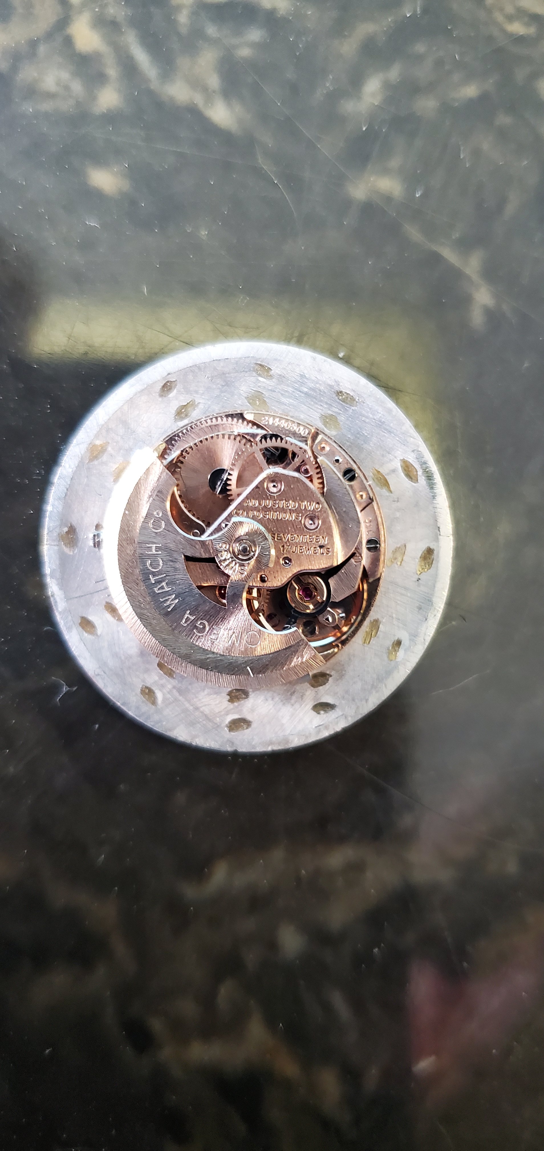

I have attached several photos of the dial, caseback, inside of the case, movement and crystal.
So, the bottom line is that I need to source the Omega brand crystal, crown and strap. I greatly appreciate any guidance available for this.

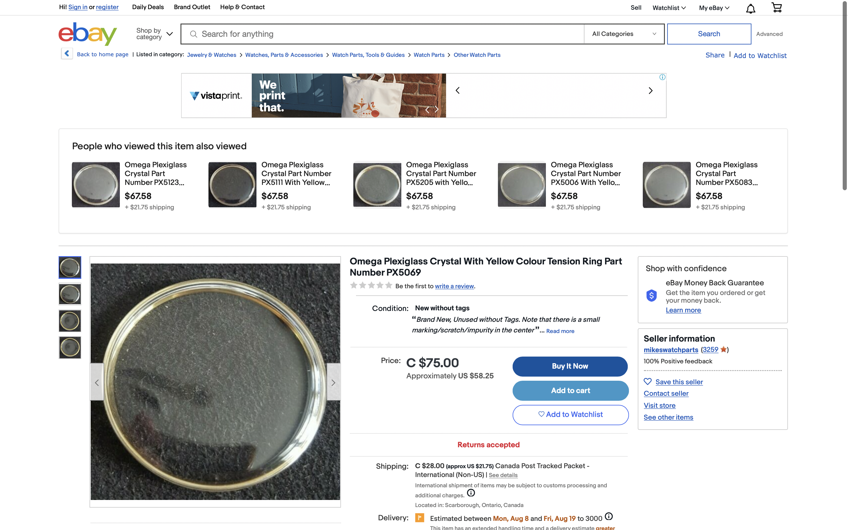

You won't have any luck with Cousins as it's a US production case made by Ross.
Start your search for Omega Crystal PX5069, good luck.

You don't say where you are, but use the case reference number to order the crystal, but mention ring color (just in case). Comes with the crystal.
Style might be available for the crown. However. Omega no longer sells gold filled/gold capped crowns. Gold plated only, so will not be a perfect match to case color. As I mentioned to someone else. People sell NOS crowns on Ebay, but majority are only a small number of years old and and still plated.
31 mm case. Maybe 16 mm strap? Just buy a nice quality generic. Older strap leather can dry out and show cracking if not taken care of after sitting around and 16 mm may not be the easiest to find

As Jim noted, it is a US-cased model, so the OP will probably not be able to use a reference number to order the crystal. Personally, I would just use a generic acrylic crystal for a watch like this. A professional watchmaker will have an assortment, and can fit one for you.

JimInOz, thank you!!
The part number is exactly what I needed. I appreciate it.
Do you happen to know the Omega part number for the correct crown?
