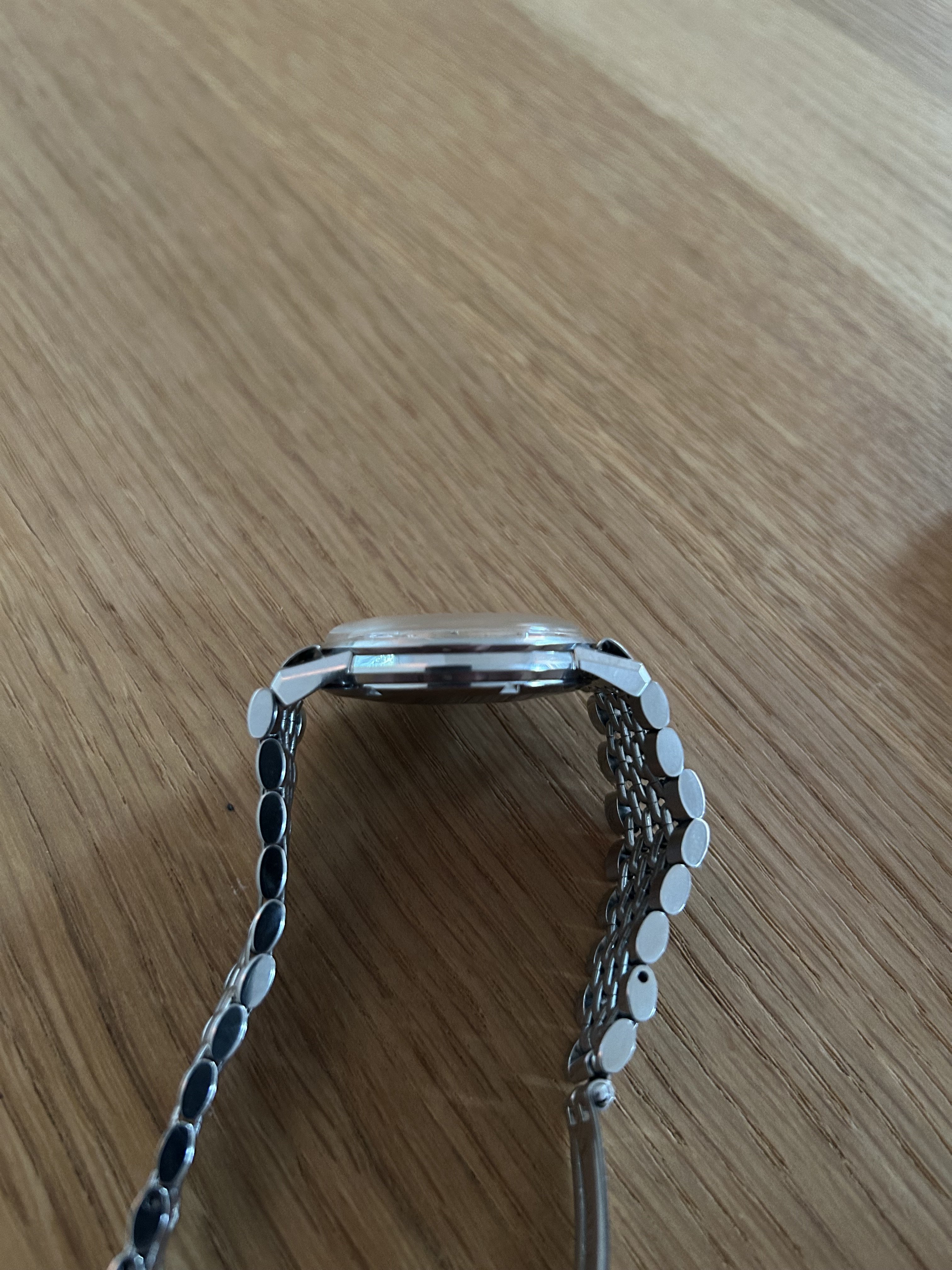

Hello,
Just received my first vintage Seamaster 166.003 with a BoR bracelet (1502), and I absolutely love it.
One question though, the endlinks (no 11) do not sit flush with the case. Is this supposed to be like this, or can I fix it?
10,154
58,275
You can fix it by bending them (not while they are attached to the watch) and then reinstalling. There's a bit of an art to it. An alternative solution is to try number 12 or 512 end links which often fit better when the tops of the 11/511 end links are higher than the top of the lugs as shown in your photo. Swatch/Omega still makes the 512s and any Omega Boutique or independent watchmaker with an Omega parts account should be able to get them for you.

Do you happen to know if this bracelet/end link combo is correct for this watch?
10,154
58,275
The 1502 bracelet is just a later version of the 1036, so that's fine. The end links, however, should be the 512's. That doesn't mean that your existing bracelet and end links can't be made to fit, but it takes a bit of work. You might want to consider having a watchmaker do it for you.

Sorry, correction to my last post. The 1502 bracelet is just a later version of the 1036, so it's fine for your watch, but the end links are incorrect and should be the 512s.

Where can I buy these? And what should I expect to pay?

The bracelet that you have is fine. You just need a pair of 512 end links. Any Omega Boutique or independent watchmaker with an Omega parts account should be able to order them for you. A pair should be around $80, plus tax and shipping. The part number is 026ST512.

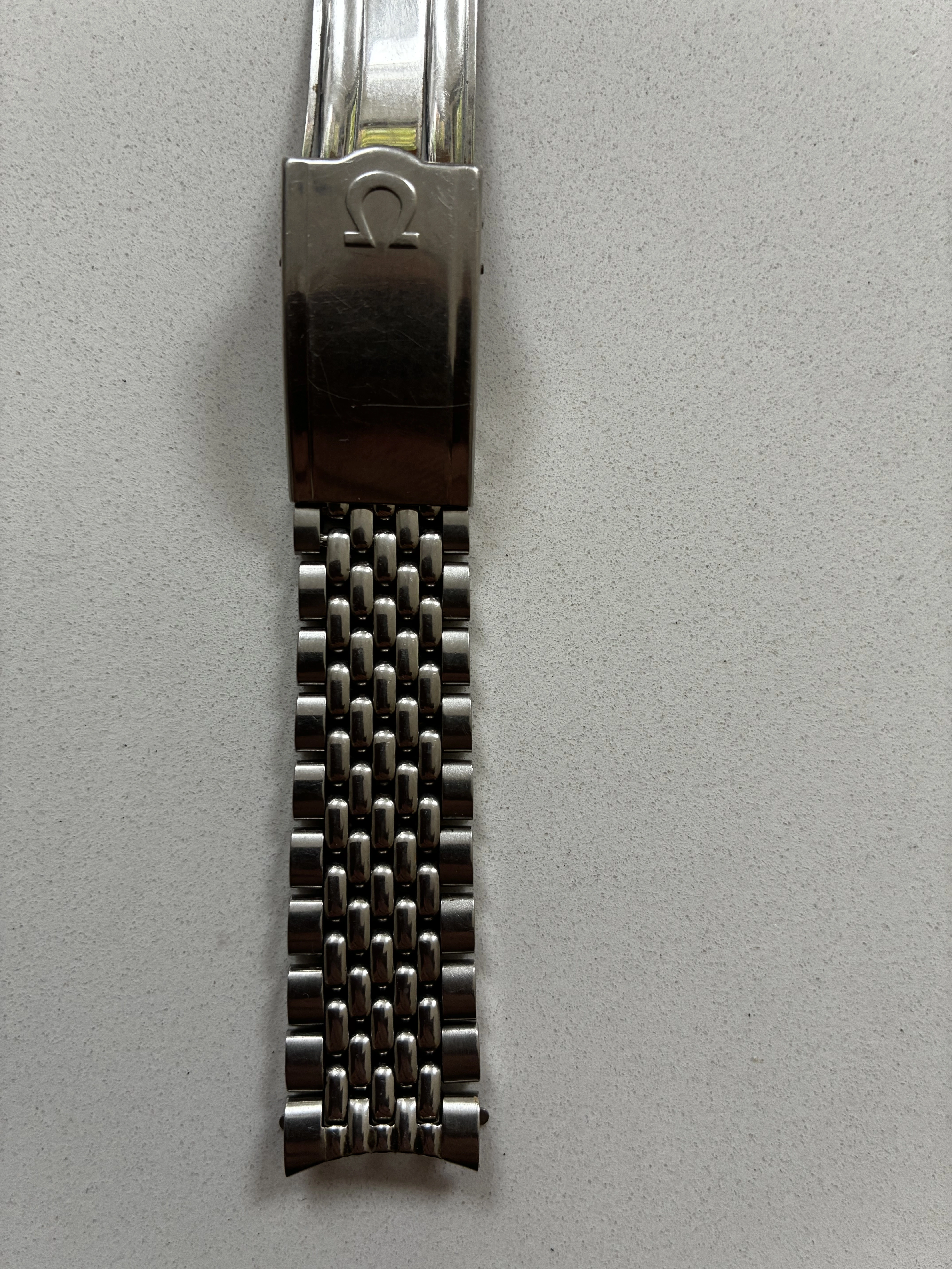

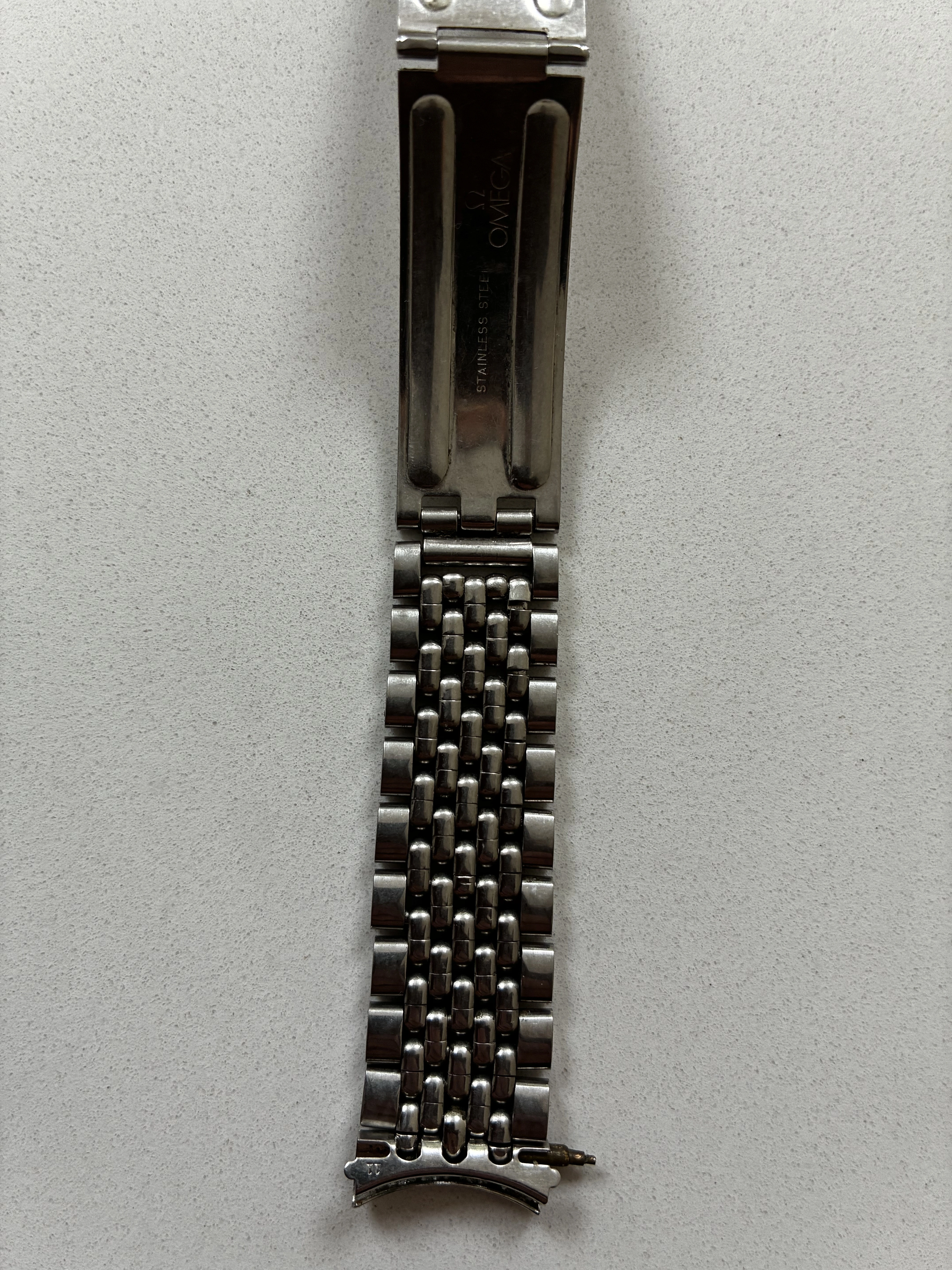

Thanks - I appreciate the reply. I asked the question because I have an unstamped Omega BOR bracelet with #11 endlinks and I can’t be sure whether it’s a 1036 or 1502 bracelet.

Attaching pics of the one I have - it’s been in my accessories storage for 15-20 years. As stated it’s unstamped - I’ve seen that’s common with the 1175 but I’m not sure how unusual this is for a 1036 or 1502.
