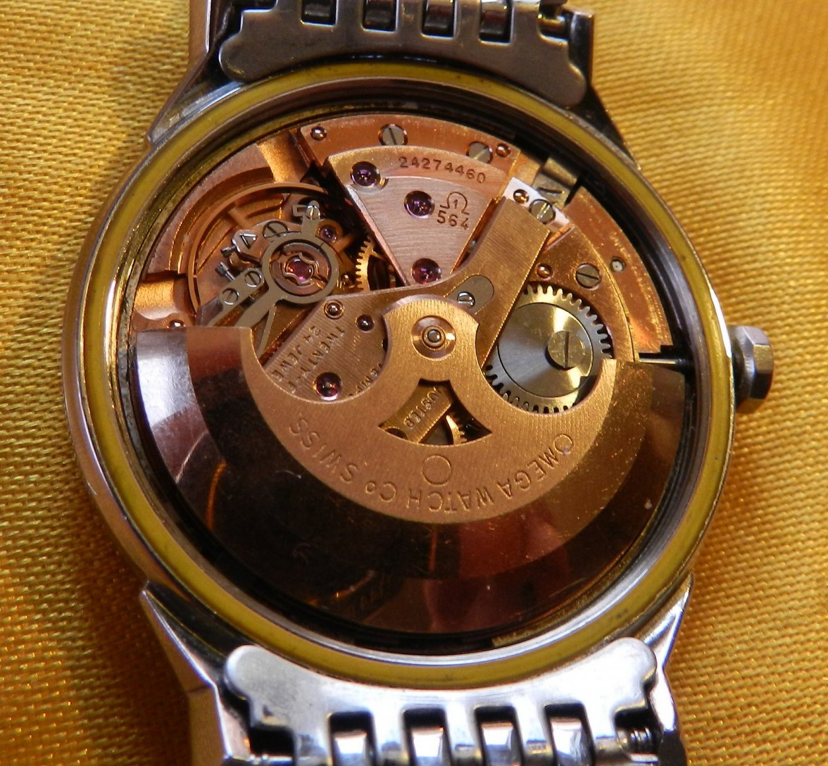

The dial looks original to me but the movement is not.
Right at 24 mil range Omega changed black onyx inserts to black paint.
Original movement may be a 561 in 22 or 23 mil range....? Not 26mil....(a 564 in 24 mil range is nice)
you sure about this 馃榾? Great information however, thanks.

While we're at serial numbers, when was the switch from 561 to 564? I have a 168.005 561 wil a 24mil serial. Should be at the switch between the two calibers?
3,788
6,446
Both calibers were used at the same time I believe. Some 564's with lower serial were seen alongside 561's with higher serial number.
What serial number is your 561?

People prefer 564 with quickset function and love to swap the 564 from a cheap C case into a nice 005.

@donkii The thicker print is not unusual and likely due to different batches or different dial manufactures all together. Thicker print also explains the smaller space between the L and the vertical line. The eBay's redial example doesn't have the same important characteristics like the serifs at the top of the letters M's and L's, and also the edges of the pie-pan are soft compared to the one you're considering.
@gatorcpa How did you see the Omega logo as off? I do not see anything off with it at all. About the wonky star, Hoi's cross-hair example also has the wonky star as well as ChrisN's example. This doesn't appear to be something unusual. Also the case back is just worn out, not defective or over polished. If you think the lower left area was flat, it was just because of the lighting angle, as the opening slot there is still recessed properly with its edges quite sharp.
@hoipolloi The situation with onyx markers is interesting but I think it's more fluid and depends on targeted markets than cut and dry like that. I've got a 561 in 24.3mil and a 551 also in 24.3mil, and both still have onyx markers, while other 564s in 25mil have painted markers. But in other references like 168.024 and 168.025 that only have cal. 564, many of them still have onyx markers, and they are in 26-28mil range. Unless there is an authoritative source, I think it is at best a guess as to when they stopped putting onyx on the dials.
I pretty much agree with that, which is why I didn't mention it.
Please understand that the medallion on these is recessed. That means normal wear shouldn't affect the stars if they were sharp in the first place. Wearing the watch isn't going to cause that type of fuzziness, since the wrist isn't going to be touching those innermost stars. The fact that I've seen very few poorly struck medallions on these watches tells me that there is something else going on here.
What it is, I really don't know. But I don't like it.
I agree with this also. In addition, I have a real hard time distinguishing the onyx and painted markers from even detailed photographs. I own a 168.025 and you have to look at it with a loupe to see that the markers are painted, not onyx. The 168.025 examples with two tone dials have onyx markers.

I've found that looking at the markers from an angle instead of straight on, I can better differentiate between onyx and painted ones. The painted ones are usually just a thin layer of paint, while the onyx ones are a block of stone of some shape.
TNT
We are talking about 005 here.
The Constellation 168.005 is in a higher class, more expensive than the Seamaster 168.024 and I don't think the lesser one would have more expensive furniture while the higher one would not. It's possible that they stopped or changed the markers on the 005 for a while and then added it back on later, maybe around 26mil like in the OP's watch, just about the same time the 024 & 025 were introduced. Or they may have done it for some markets, or according to demands only.

I do not assuming anything, just observe and speculate actually. I've already read a lot of your observation also, but respectfully, haven't found it much more than personal observation and speculation. (PS: Nothing wrong with that actually, just doesn't make an authoritative source out of that.)
And the pristine movement actually matches the case and case back quite well since there is no rust spot anywhere on the case or back. How do you expect the movement should match the case back? It should also be worn out or beat up instead of being well preserved?
