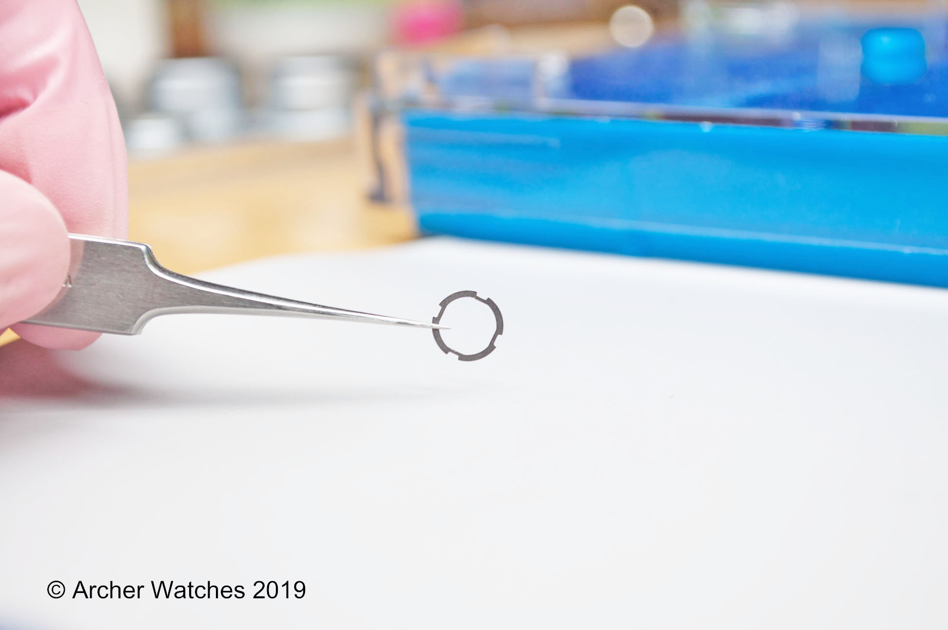

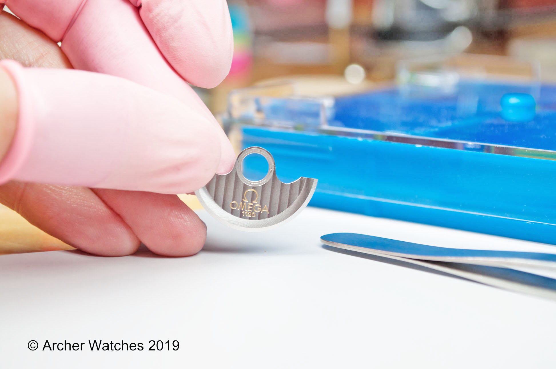

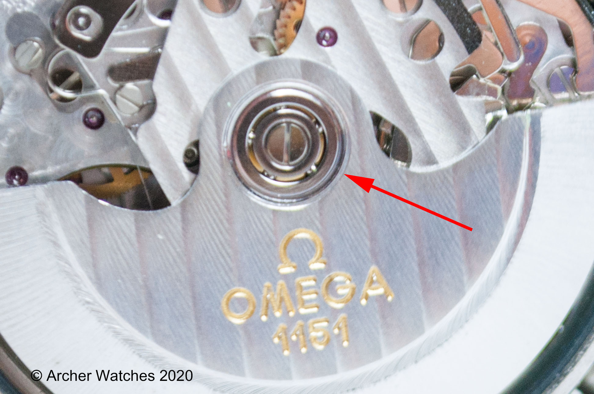

Unfortunately more and more companies that use ball bearings in the rotor, are not making the bearing something that can be replaced. In many of the older models, like the 1120, 2500, etc. you can replace the bearing and I do this often...here is how it's done.

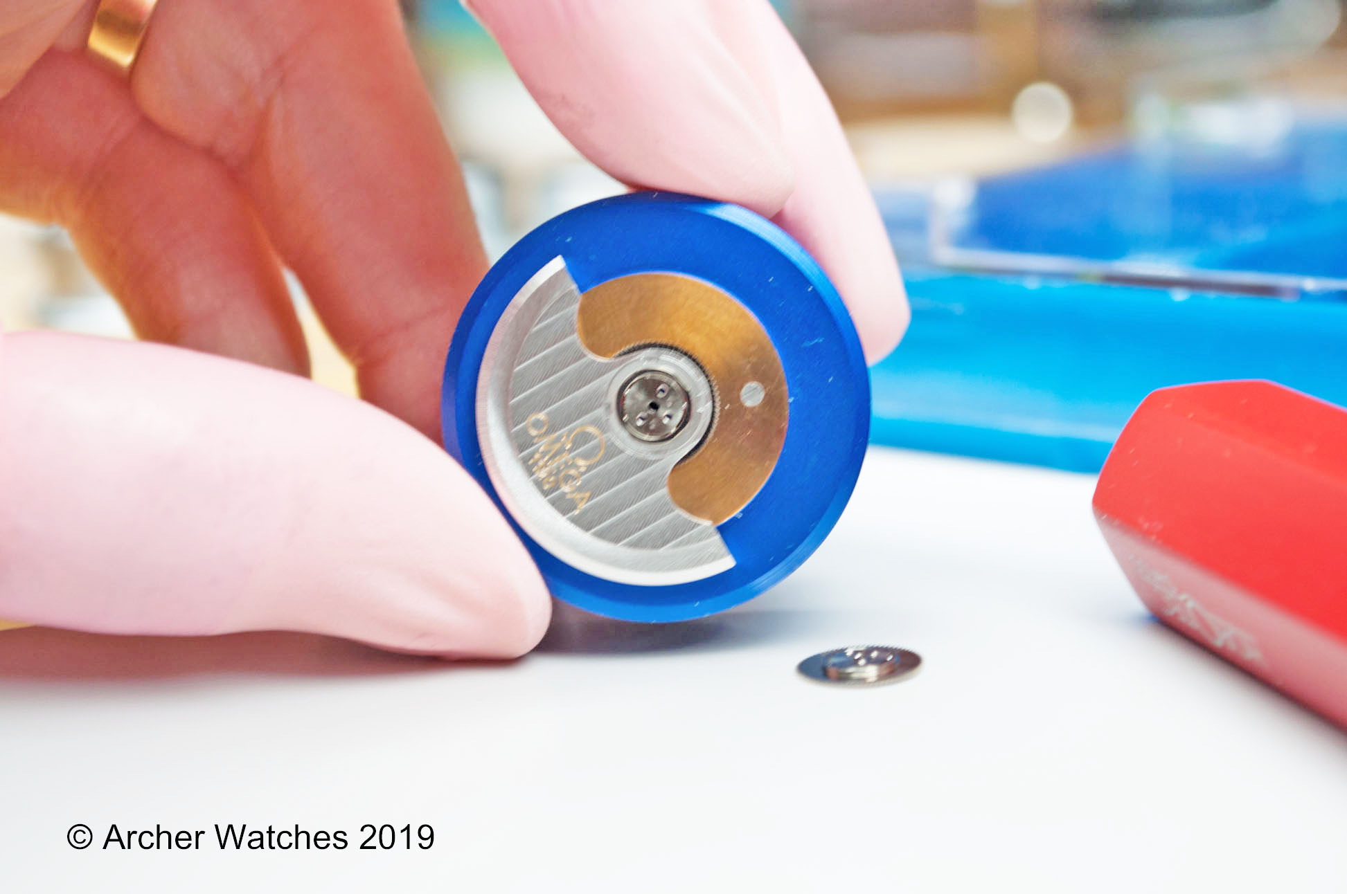

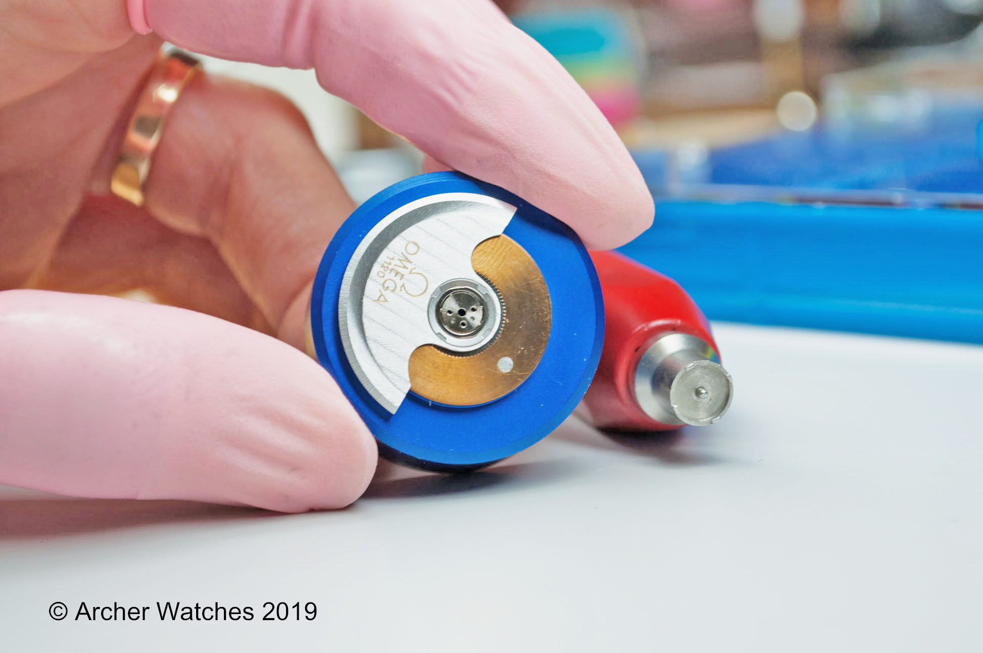

The rotor is mounted into a fixture that holder the bearing firmly:
A tool is used to rotate a locking ring - this ring is what mounts the bearing to the rotor:

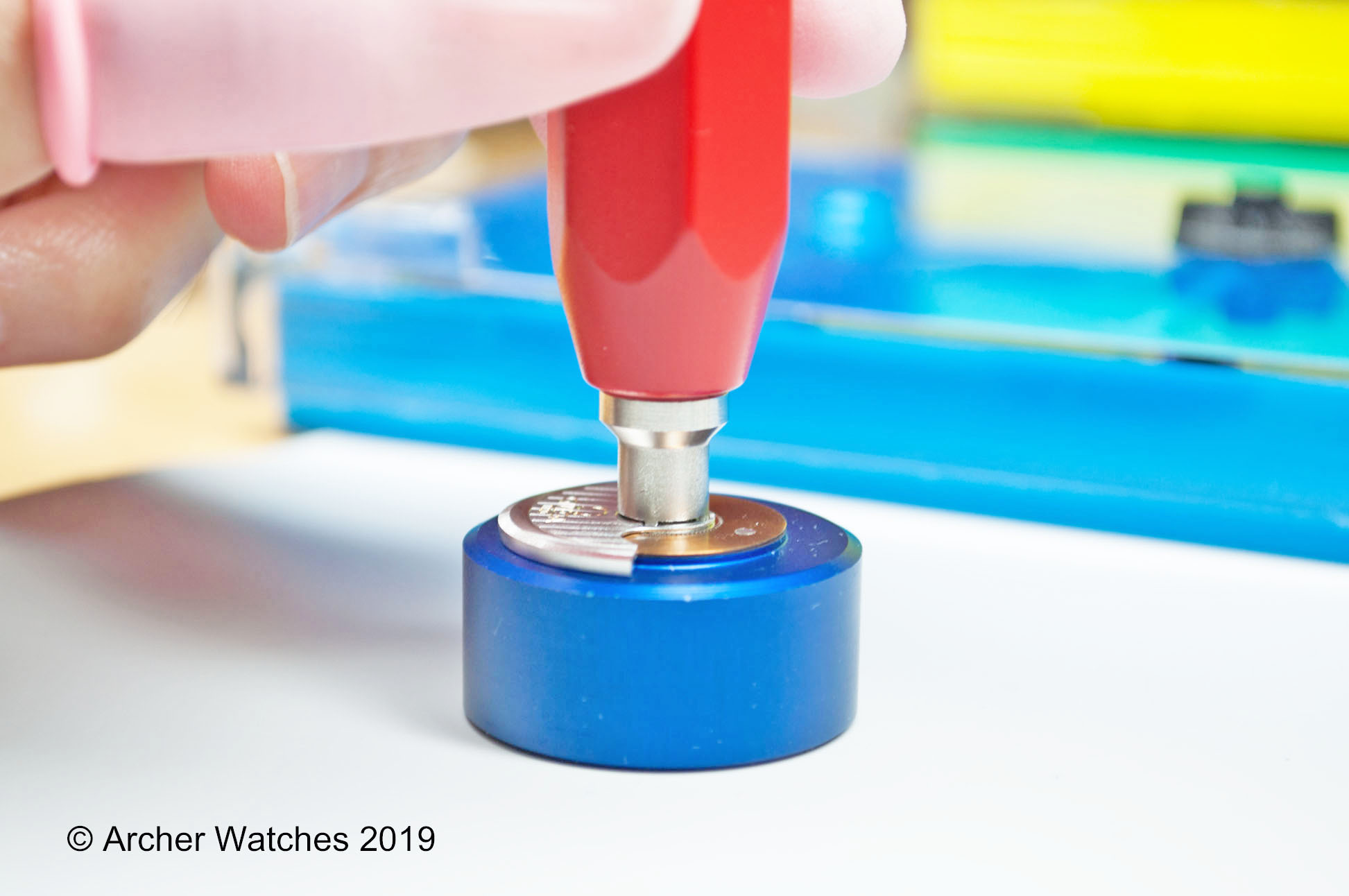

The new bearing is placed into the fixture, the rotor is placed on top, and the locking ring is installed:

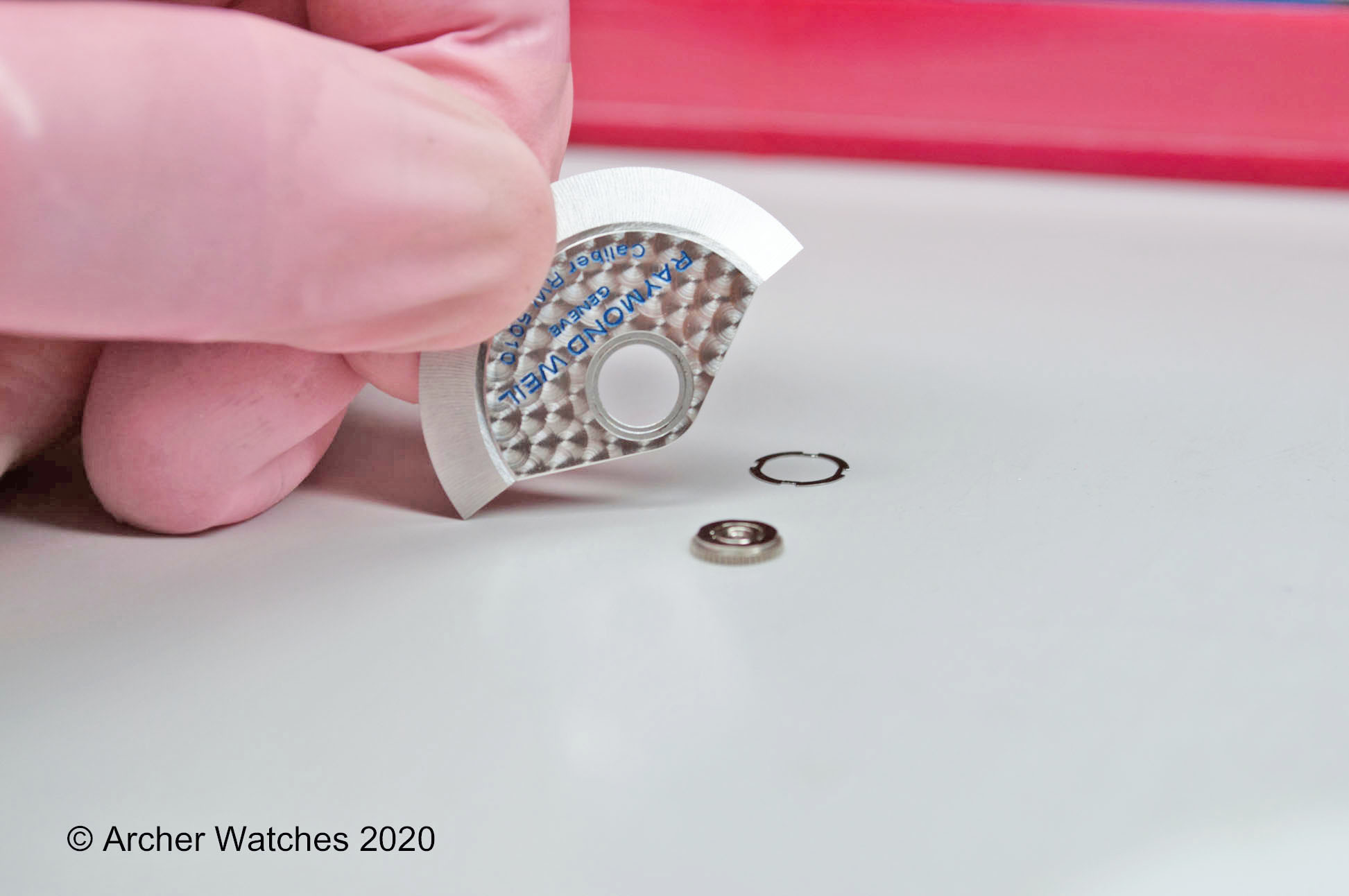

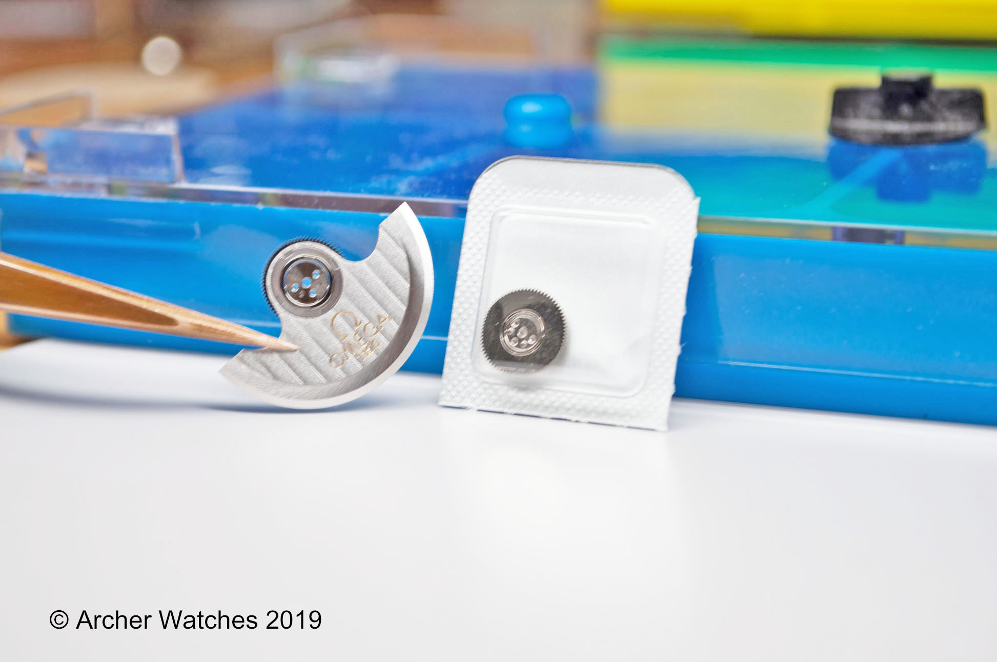

Just takes a few minutes. On some older Omega movements, you can't do this. For example on the Omega's that use the ETA 7750 as a base, instead of using the normal 7750 arrangement that has a locking ring:

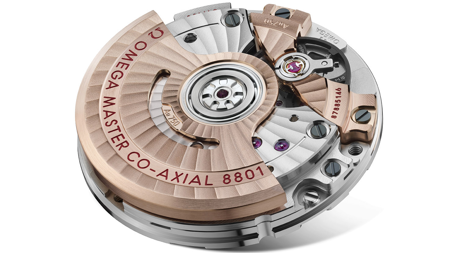

They burnish the bearing into the rotor, so the rotor is replaced in it's entirety:
The same is true for the 8800 series, as you can see here there's no locking ring - the entire rotor is replaced:
This is not a good trend, but it continues...
