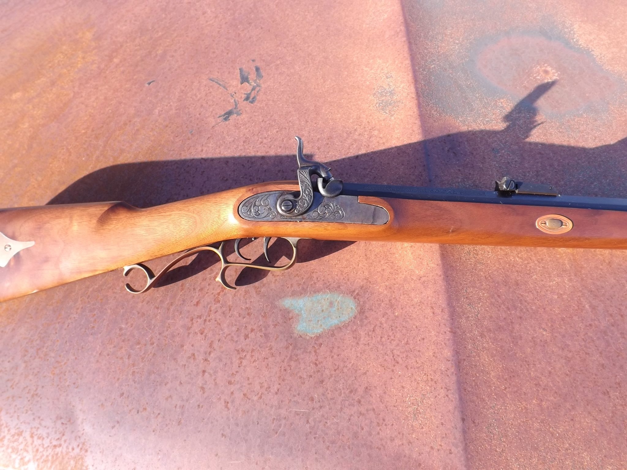

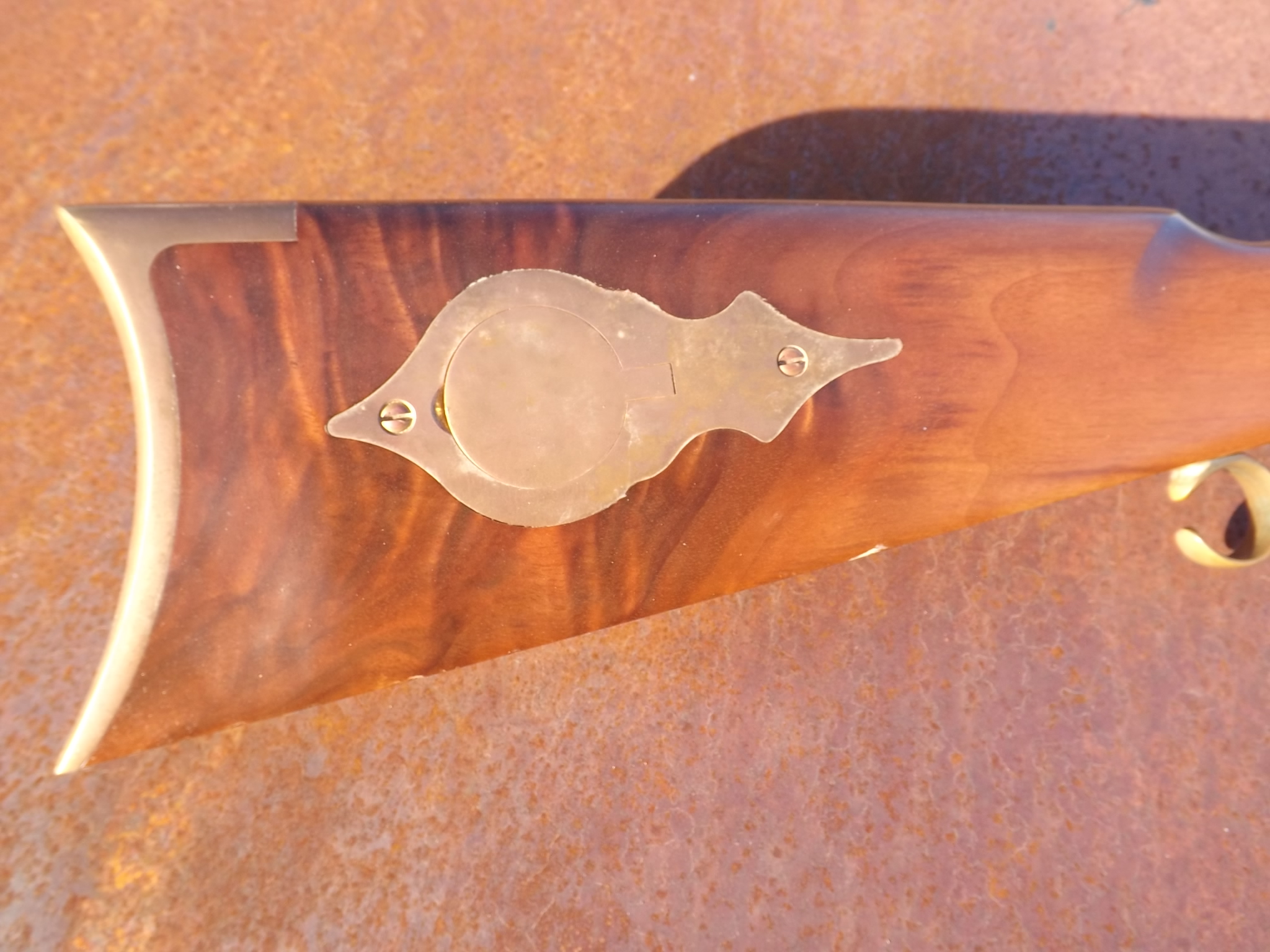

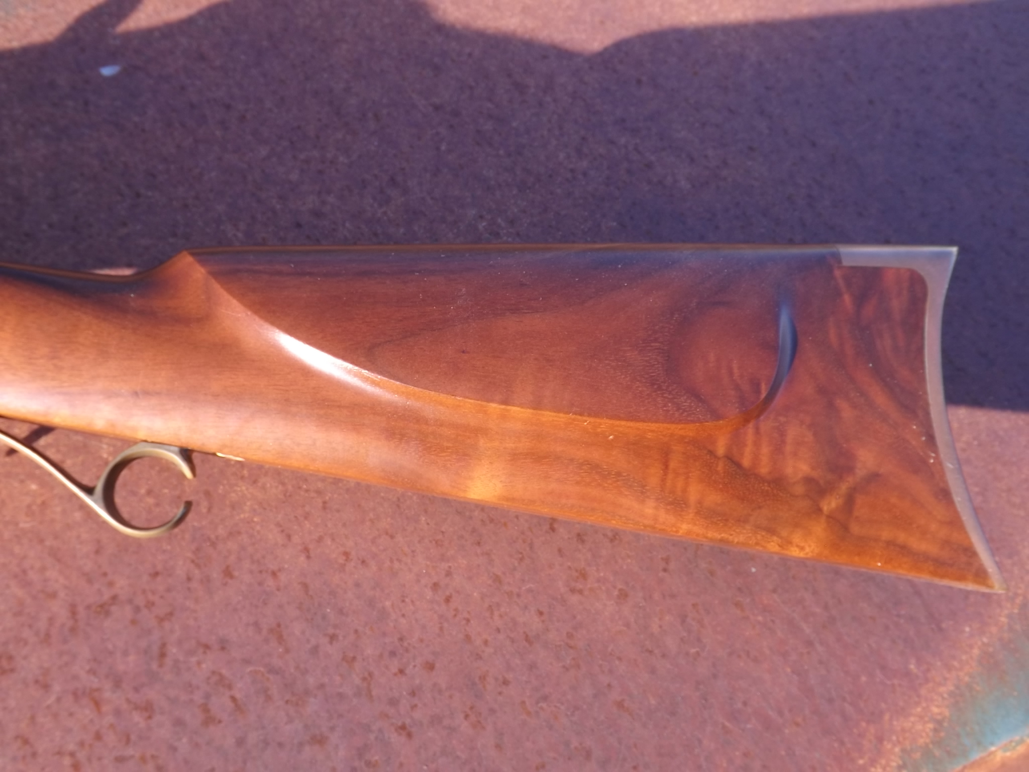

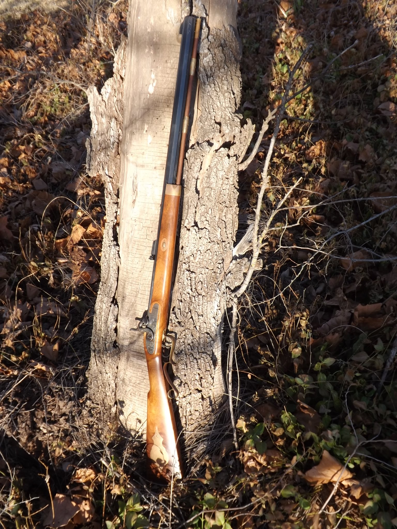

My sixteenth birthday present from my dad. T/C Hawken in .50.
I have a couple T/C's nice rifles Your rifle looks very nice.

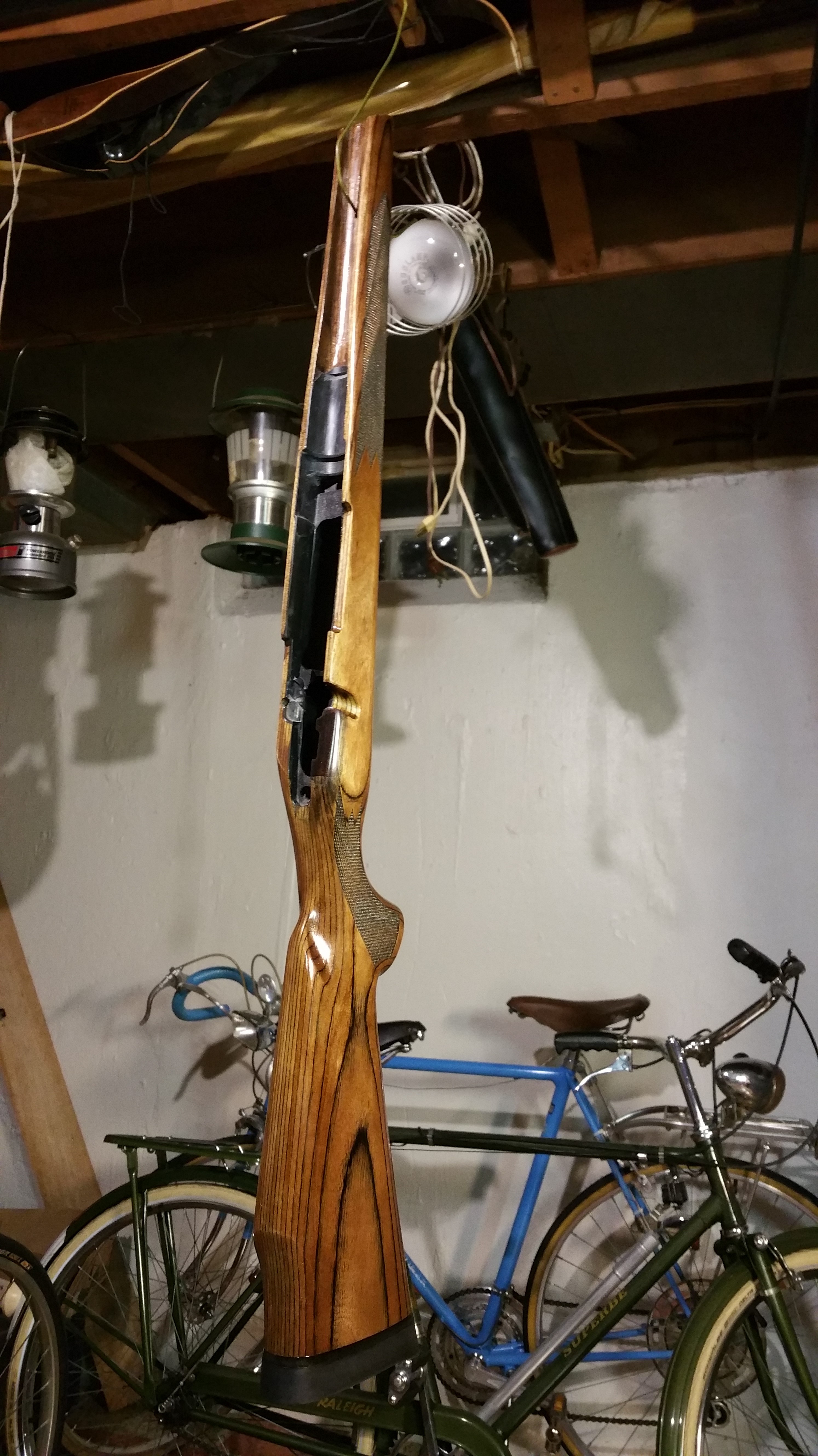

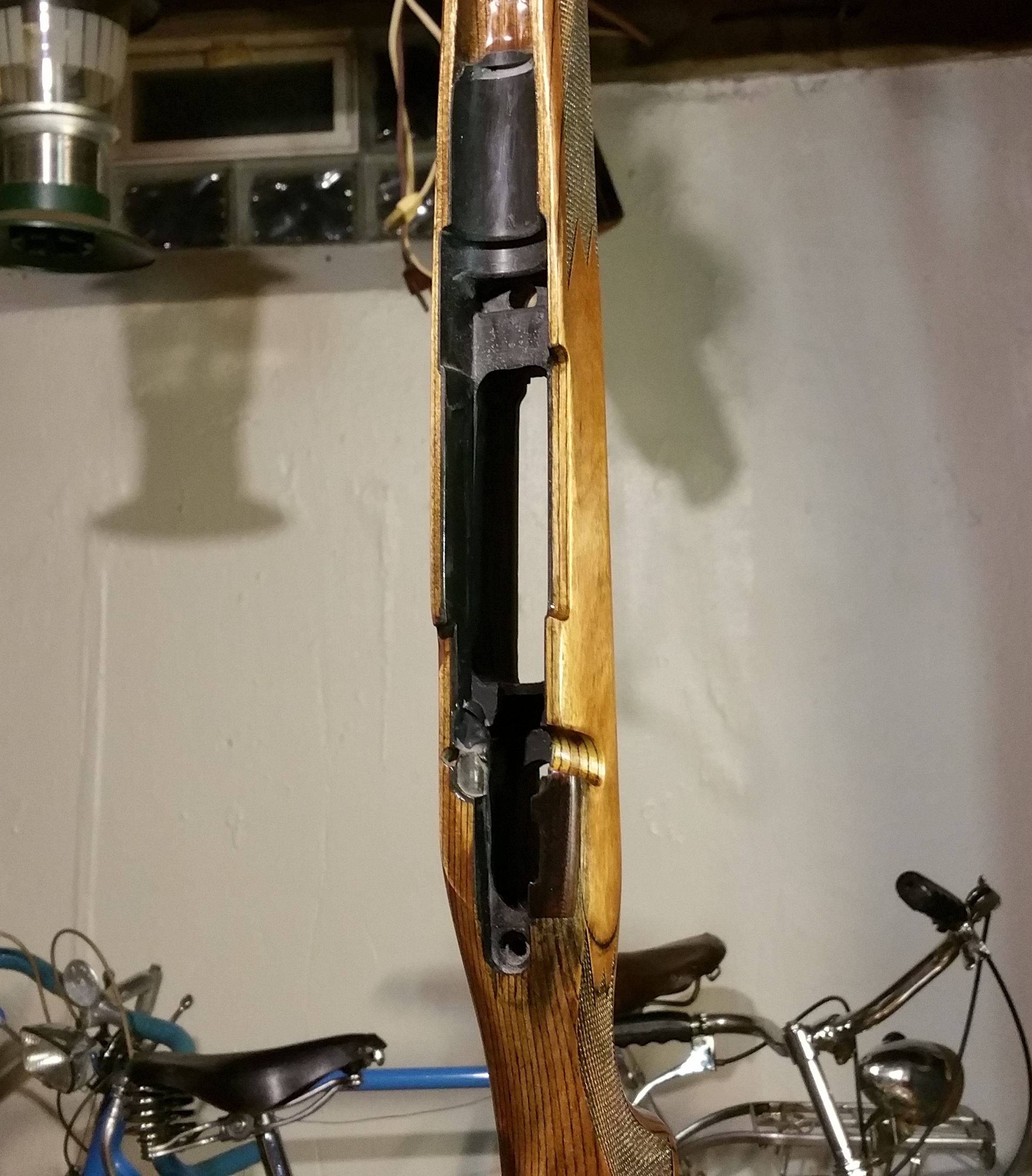

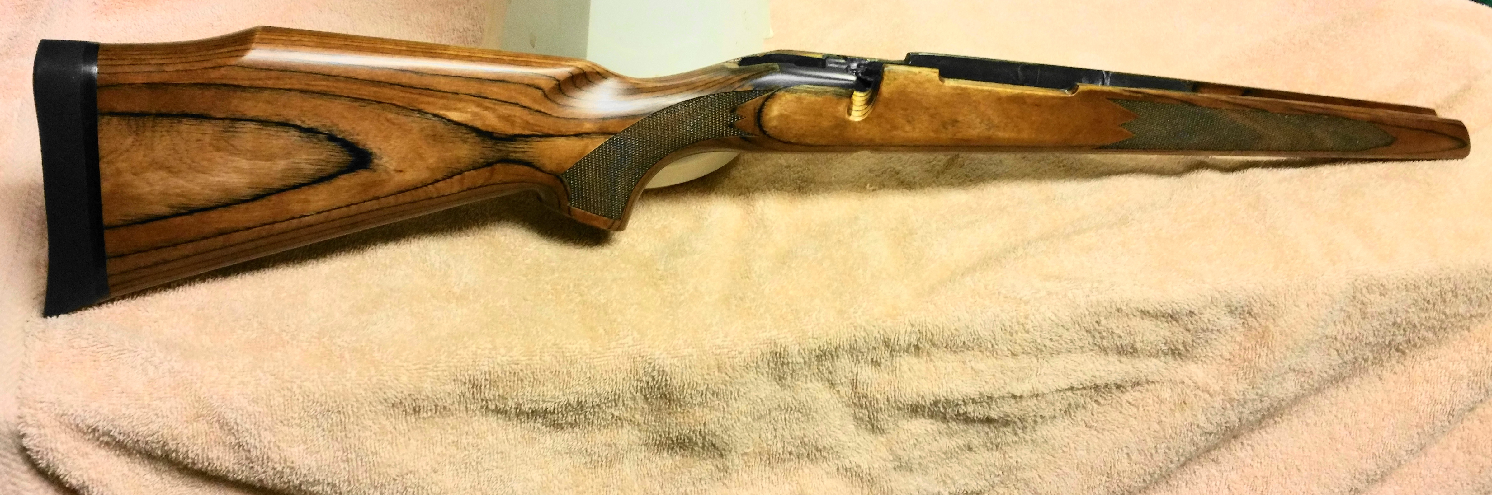

In my spare time I'm plugging away trying to get the stock finished up. I did not fully strip the stock just some touch up and coated the stock with tru oil so far four coats. When it dries I'll scuff the stock down with steel wool too much "gloss" if I do not break through the finish. I'll be good to go If I break through the finish. I will have to apply another coat.

I've read that they were/are very accurate but must have quite a kick for a 16 year old.

Thanks, I try to take pretty decent care of it.
Mine is very accurate, if I am in practice I can hit the 10 ring four times out of five at 100 yds. in the prone position. The practice part is the toughest. It was quite a kick for a sixteen year old and still can be for a thirty-seven year old. If you are looking for a good BP rifle and don't care about the construction being authentic to the time period go with a T/C.

For now the stock for the Interarms is good enough to use the rifle. I'm at a stage with the stock if I keep going with the finish it will be all down hill. The stock needs to be sanded down to bare wood then then the finish work. Now I'm in standby mode waiting on the refinisher to complete the metal finishing. Remington did not do shooters any favors with the butt pad on the laminated stock.
The butt pad and spacer is glued on along with two screws holding it on. I removed the two screws then tried to remove it no luck I managed to separate half of the rubber pad from the spacer half way off it started to tear. I stopped and spent about an hour repairing that BS. I had some epoxy and that worked to glue the rubber back on the spacer. When I refinish the stock. The Remington pad will go away.

That looks amazing. Just curious..how do you plan on replacing the butt pad?

Thanks
I have a Compound Miter Saw. I figure the easiest way would be remove the two screws in the pad and cut through the black plastic spacer close to the stock. Then sand the remainder of the spacer off to the wood stock with a belt sander, and grind and sand the new pad to fit the stock. Pain in the A$$, With the old pad removed it will be much easier to refinish the stock properly.

Voere, it is looking pretty good. I can't imagine how annoying that must be not being able to get that butt pad off.

Gotcha. Your eventually putting a new rubber on it or going with classic steel?

Since you are going to refinish the stock anyway a better method would be to cut away all the rubber and plastic you can then dissolve the glue with a solvent.
Epoxy can be dissolved with vinegar. You could use acetone but you'd have the problem of fumes. Acetone would dissolve the remaining plastic as well.
Extra care must be taken that you don't de-laminate the stock.

Let's just say I was flapping my jaws and a lot of four letter words were floating around.

I keep a rubber type pad on probably a pachmayr those work out good for me. Steel or a plastic butt cap is always an option

Thanks for the tips I'll figure something out.
One of my friends mentioned to get these glued on pads off. Is grab the plastic spacer on the recoil pad in a vice that the jaws are protected with wood. And then rock the stock back and forth. I tried that no luck for me. I was worried that I may take a chunk out of the stock.
I have a wood workers vise that has wood lined jaws no luck with that. When I had the recoil pad in the vice the rubber was breaking away from the spacer then I tried to cut along the spacer to get the rubber off no joy with that it stared to tear the rubber away from the spacer.
At that point I had to glue the rubber back on with epoxy and clamp that with a long wood clamp that worked out fine. However I had to deal with shaping the rubber to the spacer. All in all that was a in the A$$..
The finish I did is just a temp fix to use the rifle. I did not strip off the old finish off I just touched up the bare wood and coated the complete stock with tru-oil. Half A$$ fix but good enough for now.

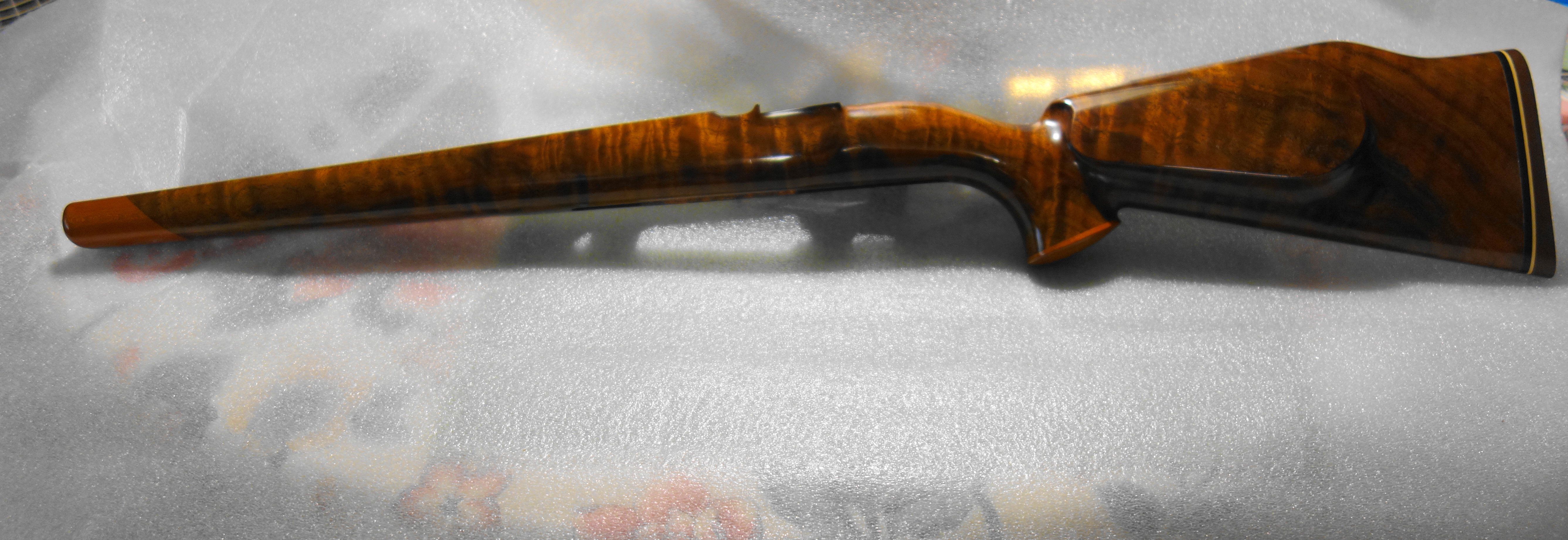

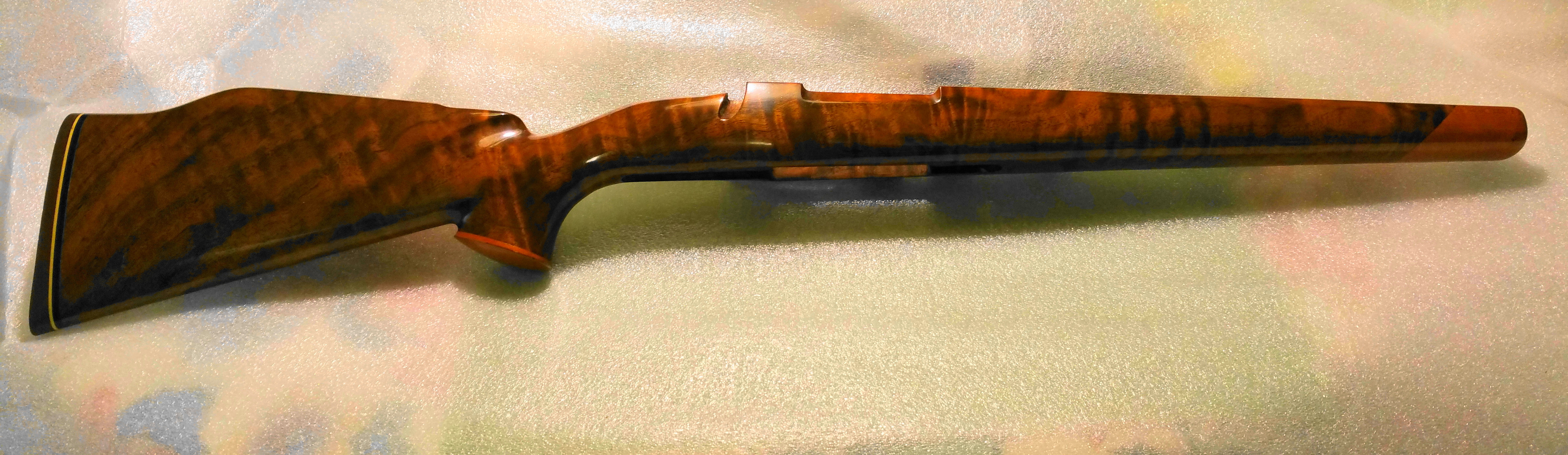

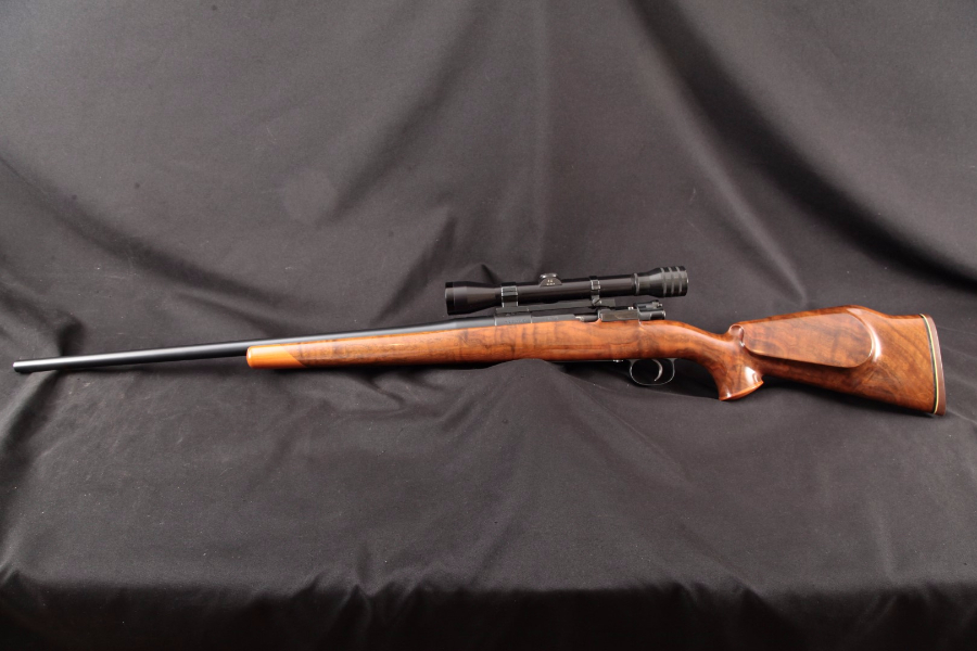

I'm thinking about my next project which is another Mauser. A 1909 Argentine This stock is awesome fits me perfectly. Not crazy about the high gloss finish that will be removed and I will do a high end matte/satin finish. This stock has a lot of figure in the wood. But the best part it also has straight grain through the wrist to the end of the fore end. For me is was much more cost effective and easier to start with a used stock vise buying a blank and starting from scratch.
This stock had a Mauser VZ24 in it. If I can figure out the barrel contour of the stock it should be close to a drop fit. I emailed the seller of the stock and I'm trying to purchase the barrel or barreled action that was in the stock the seller parted out the rifle. I'm sure to get the most bang out of his investment. Anyway I'm glad he did at least I picked up the stock.
Here's a picture of the original build with the VZ24 before it was parted out now that rifle is history
