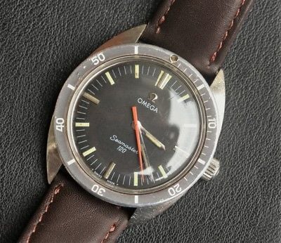

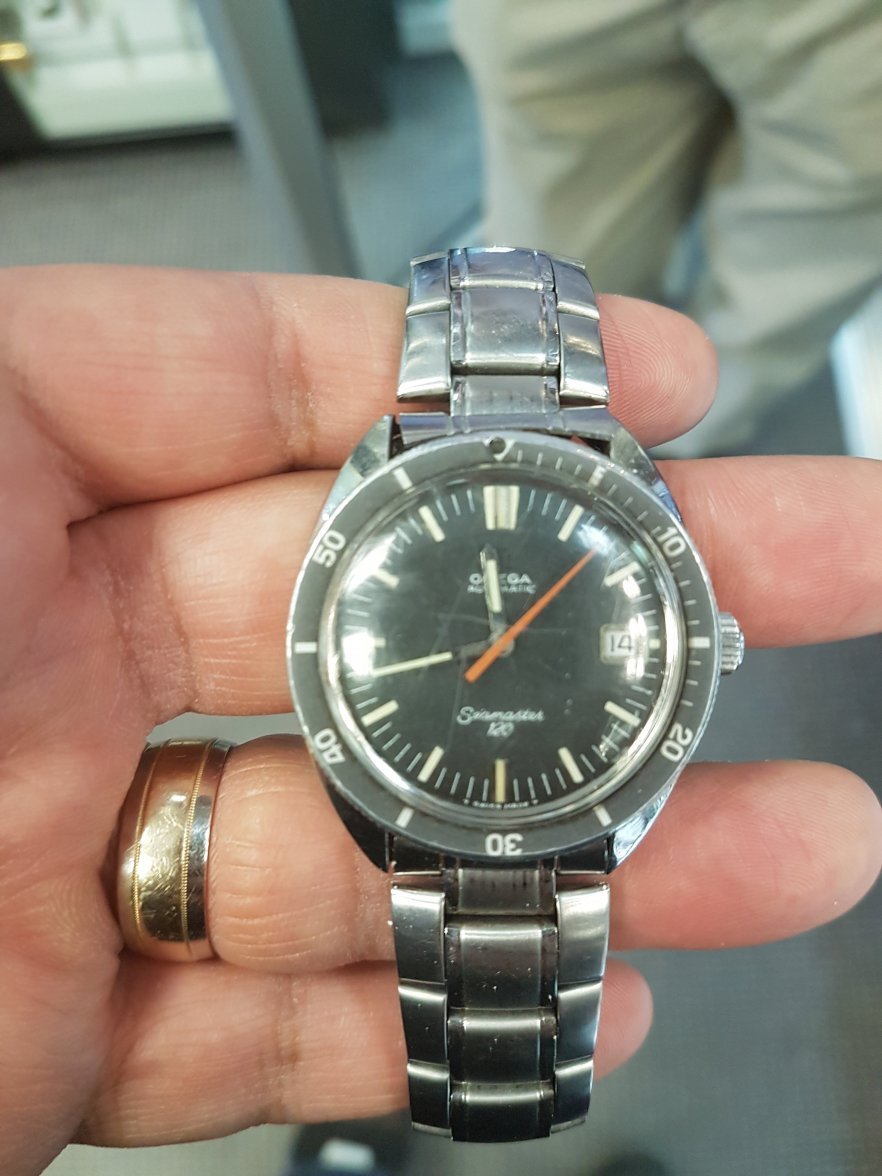

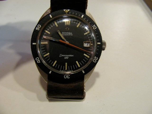

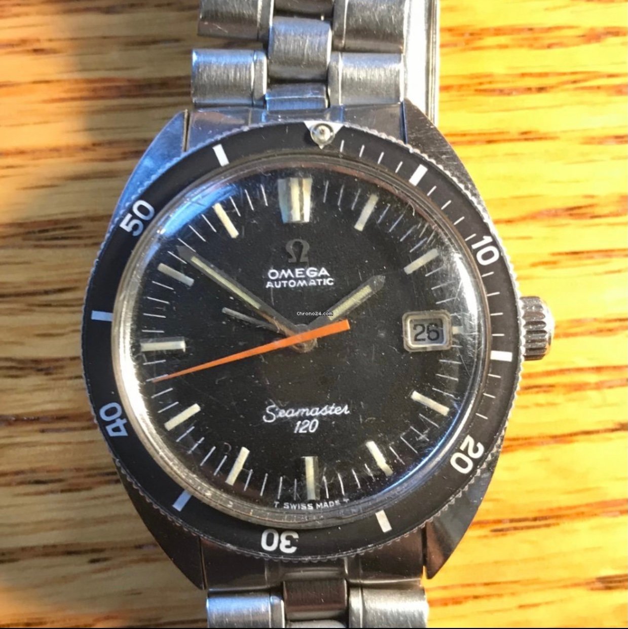

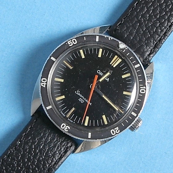

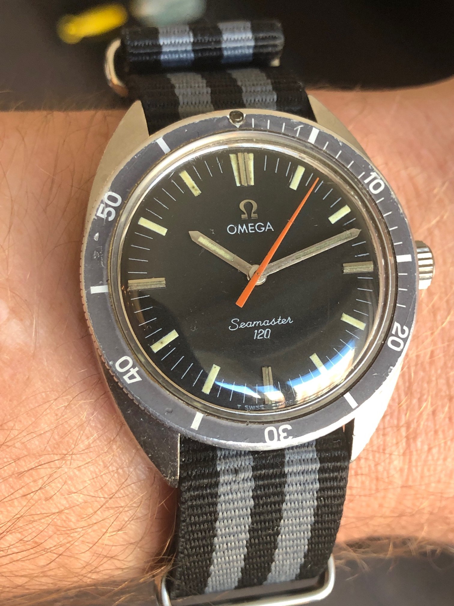

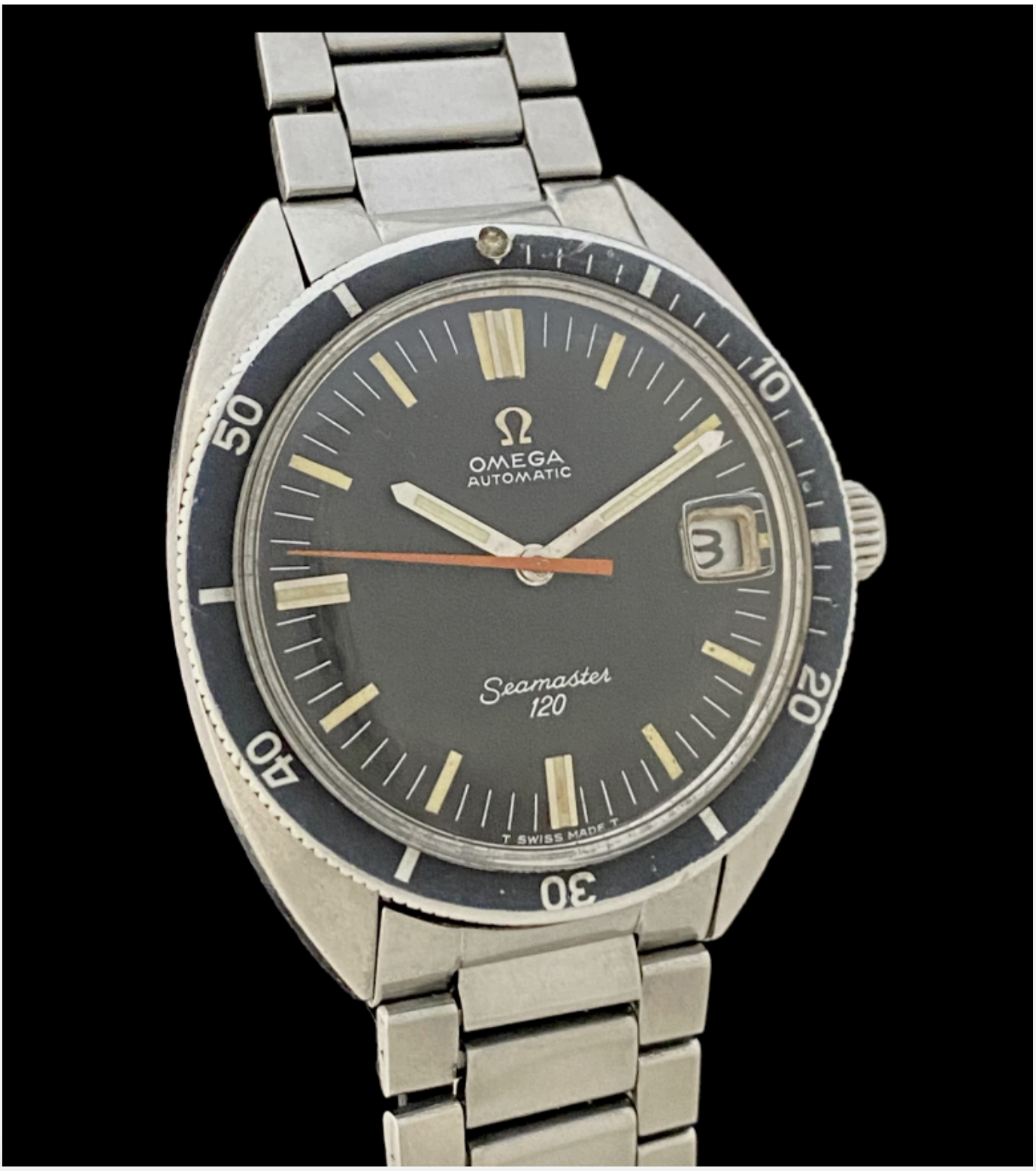

I picked up a 135.027 with an orange second hand at one point. I had planned to find a replacement white hand for it. However, I've seen quite a few examples of this watch with an orange second hand, so I'm starting to wonder why there are so many out in the world.

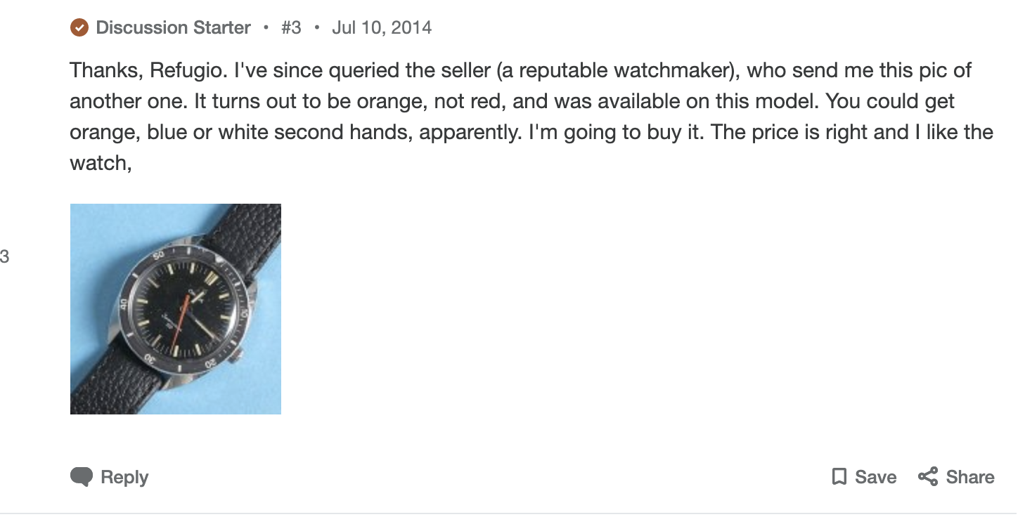

I saw a post on WUS where someone wrote that their watchmaker claims this model was available to purchase with an orange second hand. Maybe that is a possibility? I've also seen a poster positing (here on OF I believe) that Omega may have been out-of-stock on this part at one point, and replaced the original part with this orange second hand during services while the white second hand was unavailable.
I'd like to hear get people's thoughts, conjectures, angry shouting etc on how this could have happened, because it seems to me there are too many in the wild (examples below) for it to happen by coincidence that several watchmakers decided to replace the original part with this same orange second hand. I'm not trying to establish there is some rare SM 120 ultraman to line my pocket or something along those lines. Just curious to hear the thoughts and opinions of others who have been collecting and looking at vintage Omega vintage for much longer than myself.
So what do you think?
A. Orange second hand is original to some SM 120 in the 135/136/165/166.027 line
B. Orange second hand was used as a service part at some point while the original was unavailable
C. Rogue watchmakers did this you simpleton.
D. Alternate theories - Martians, pranks by collector spouses, time traveling part pilferers?

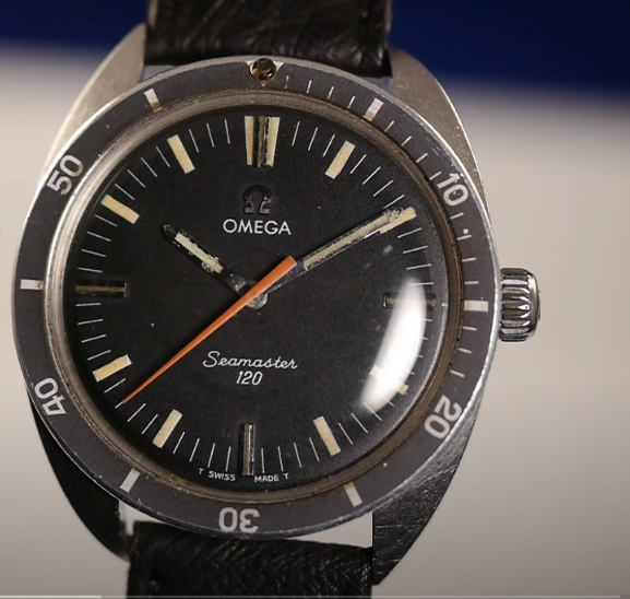

Examples:
And the WUS post I referenced above that the pervious pic is from:
I'm pretty sure the first image is the watch I wound up with, although I don't think it's from the auction I purchased the watch from (it came on a black leather strap). The second to last picture is from a YouTube video that comes up if you search 135.027. Not sure where I got the rest of them from. I saved these several months ago when I had been wondering about this for a while.
Here is mine:
Looking forward to hearing people's thoughts.

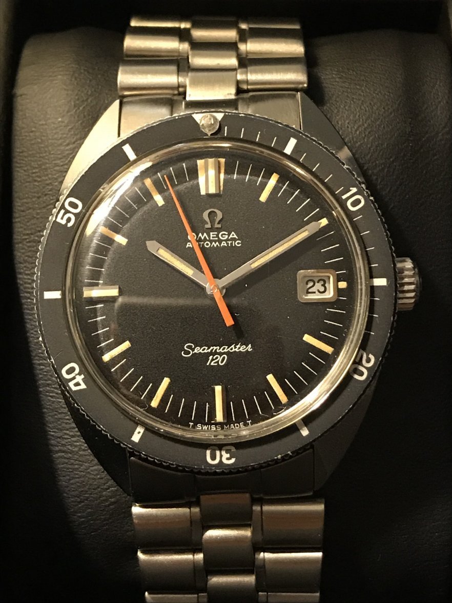

I know nothing of this reference. However, I do know, that usually when Omega (or any manufacturer for that matter) make parts for a watch, they will be sized correctly, and that hand to me on those watches just looks too short (I would expect it to come to, or slightly past, the minute track).
Here are some consistent examples (I think there are Dynamics with orange hands too...and most likely others).
a7b0289e-b972-4ea8-8b2d-1dc27fe8e33f-jpeg.572279
There are lots of Omega's from this era with that color/shape hand...so a common enough part to find and switch. All just my humble 2c opinion.

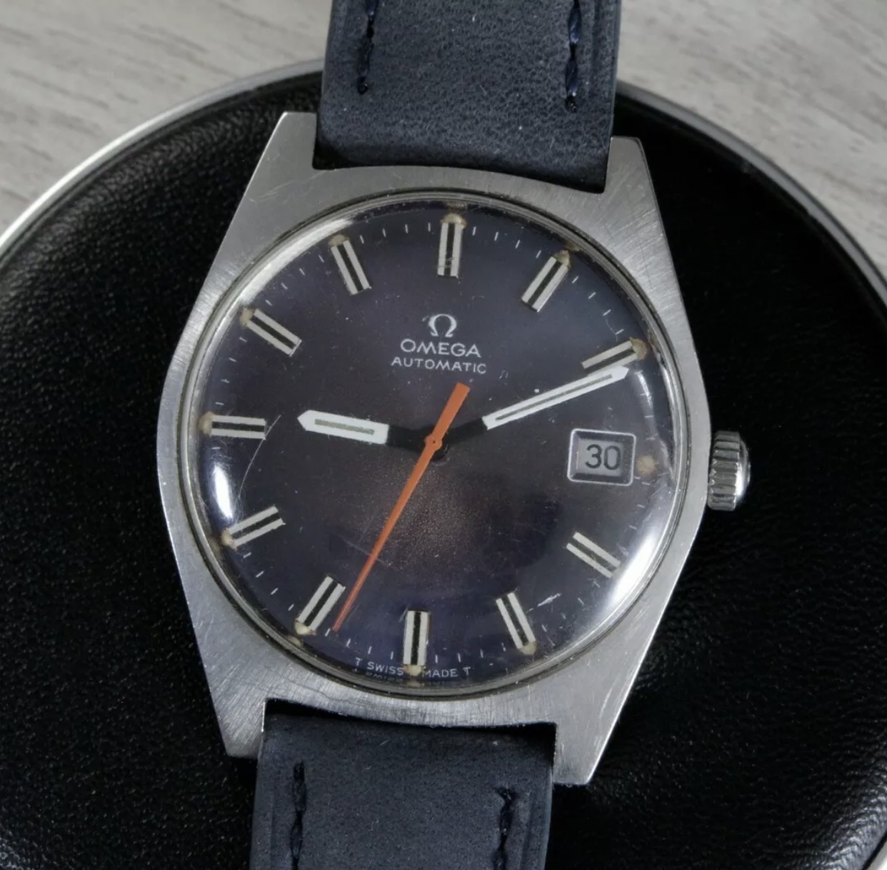

In addition to chronographs, the orange second hand can be found on a variety of Dynamic and Geneve models. I believe all of the Geneve Admiralty line had colored and often orange second hands, and there were also versions of references 13X.041 and 16X.041 (often branded Geneve) that had orange second hands as well.
Here’s a 166.041 example:
Although all of these watches featured hour and minute hands that were painted white and black, and I can’t think of any non-chronograph Omegas where an orange or colored second hand was paired with silver hands like that of a SM 120. The a colored second hand paired with silver hour / minute hands seems to be a rarity even in chronographs. I can only think of the white-dialed SM chronograph @eugeneandresson posted above as an example.

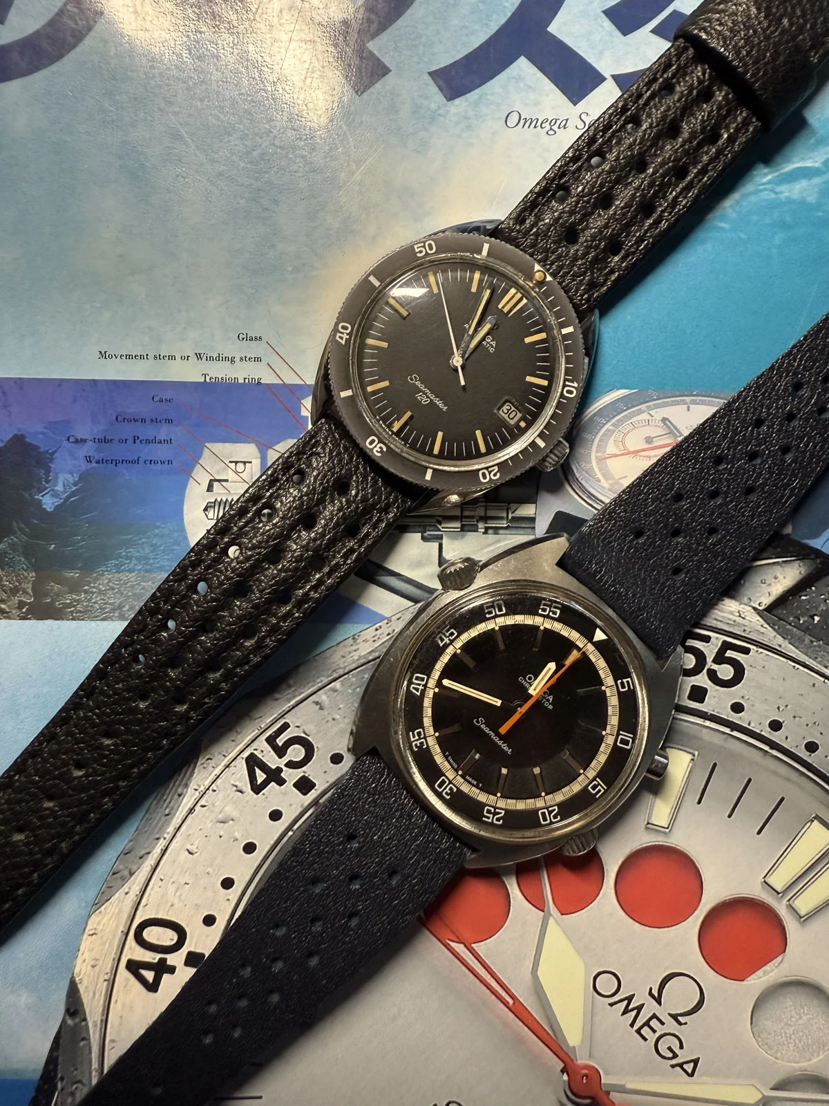

In January, I had found another example that I don't think have posted before:
And today @hmmmcamu posted this in the main Seamster 120 thread:
As fun as he oompa loompa theory is, this ad seems like pretty solid evidence that a version with an orange second hand was available from Omega at some point.

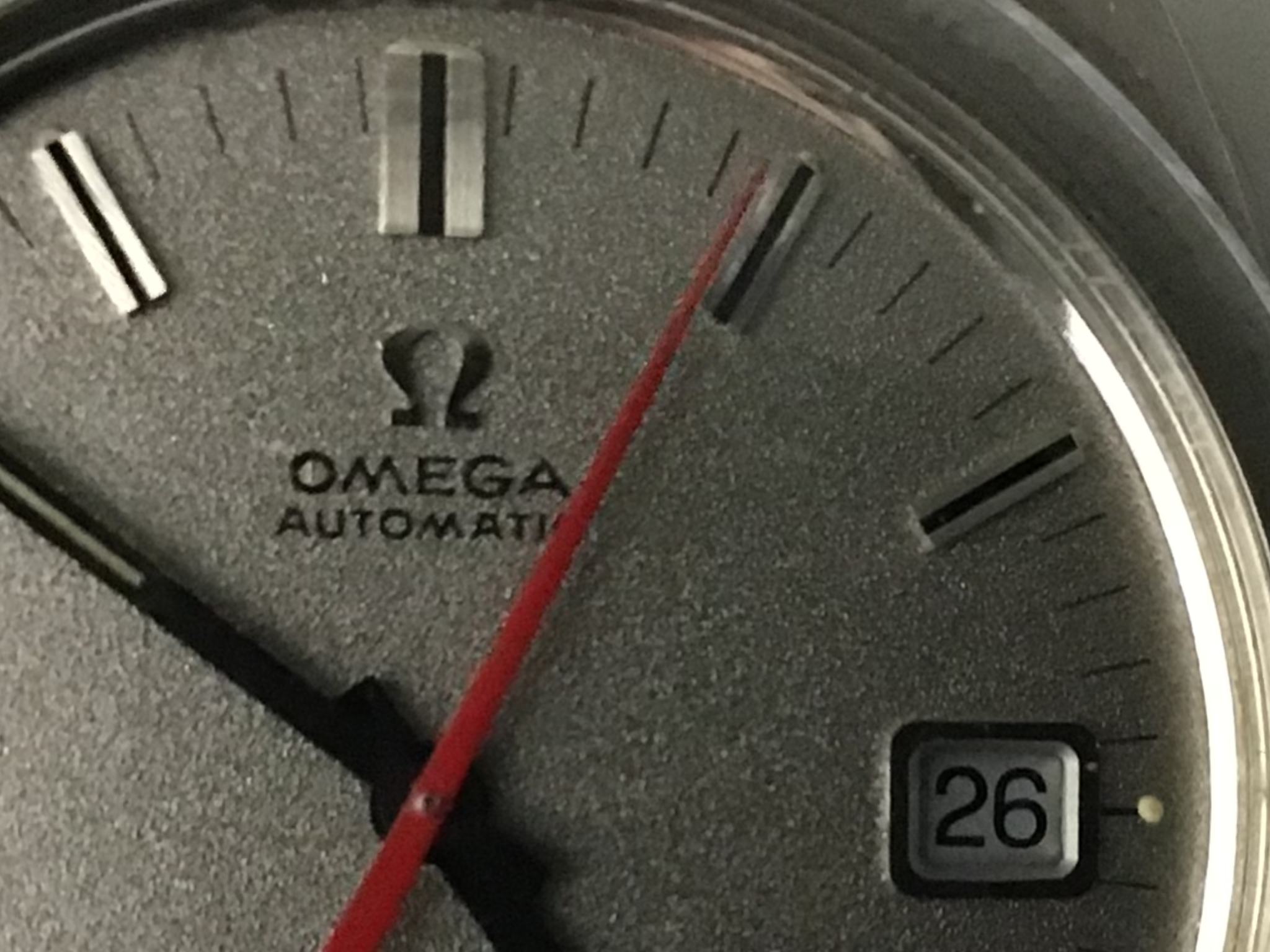

I can’t speak to the watch in question,but. My Seamaster has a red seconds hand that doesn’t quite make it to the outermost of the minute track. I know the red hand is original, I was with my dad when he purchased it.
