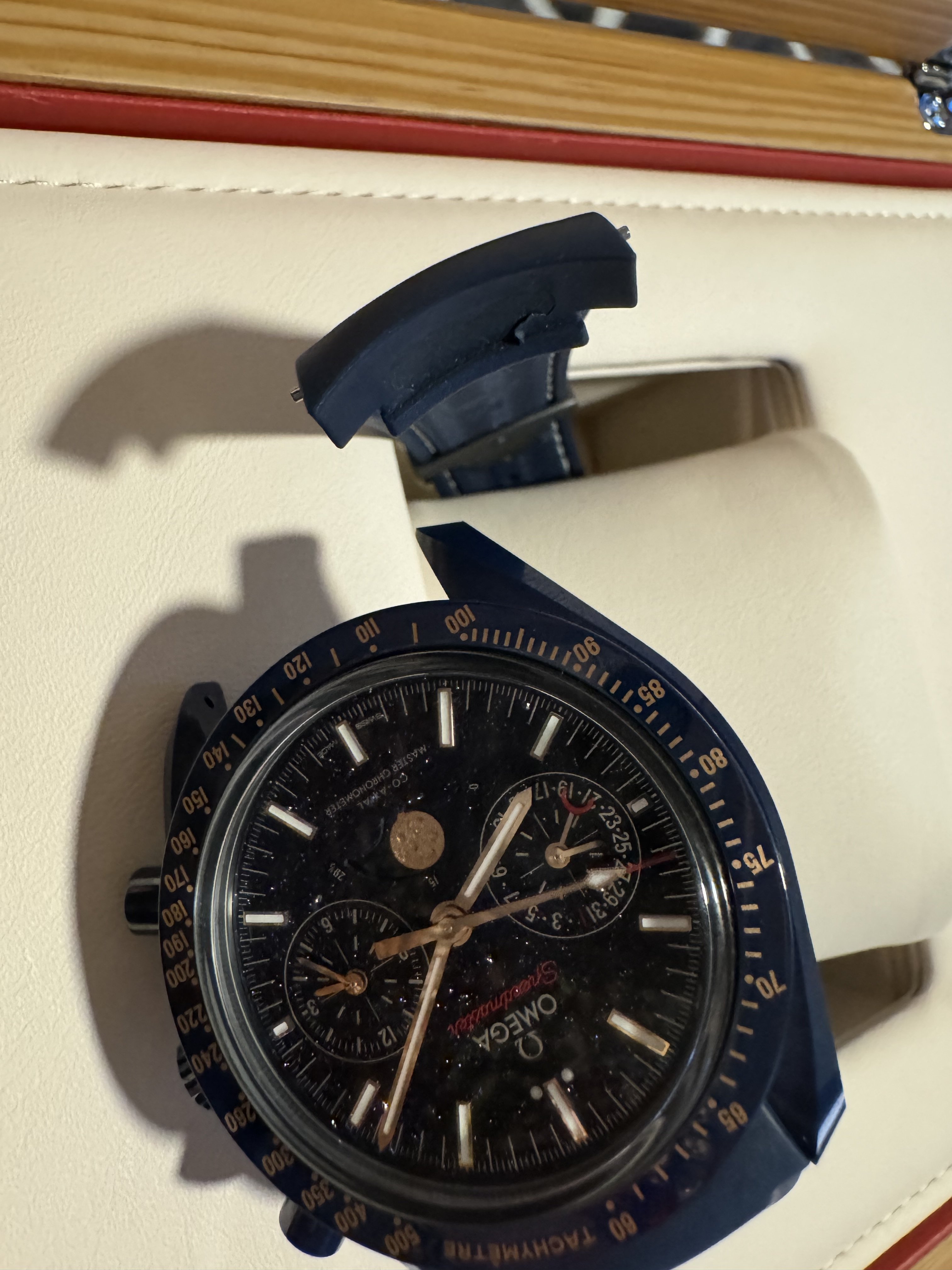

I bought a Speedmaster Moonphase and swapped out the leather band for the silicone band. I have worn it about 2 hours total. Today, the band randomly popped off. Thankfully I was sitting on the bed when it happened. The pin was intact and the watch just, literally, fell off.
At the boutique when they swapped the bands, they told me to always double-check the band is secure and pulled on it a couple of times (both sides) to demonstrate it was secure.
I jumped on Google and found similar complaints of the silicone band and the pin not staying inserted like this one. I’m concerned.
Anyone else here have similar encounters with the silicone band?

Ok, thank you for clarifying! But bummer, I’m even sadder now because it was the Omega Boutique themselves and not an AD. Based on responses and other searches, it seems to partly be a pin issue (maybe need a 21mm instead of 20mm). I’ll go up there this week and see what they say. Not wearing it until I’m confident… Thanks again!

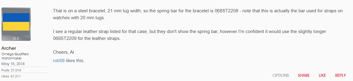

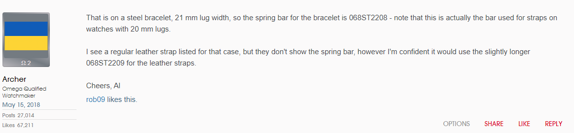

Your watch is a Speedmaster Moonphase Blue Side of the Moon, if so it has 21mm lugs so a 20mm spring bar is not big enough and the strap will always fall off. You need 21mm spring bars.

068ST2208 is used when you have 21mm lugs and want to wear it on a bracelet / OEM rubber strap and 068ST2209 when you want to change to a Nato/leather strap.

Your response aligns with much of what I’m finding online so far. Do you mind if I ask how you know this advice? Did you find this from experience yourself? Just looking for some credibility is all… Not trying to be rude or offensive.
Archer, an Omega qualified watchmaker contributing here on this forum has posted many times about the difference between springbars used for bracelets and leather straps and the partsno's associated with them.

Wanted to post an update. I went back to the OB today and spoke with their tech on staff. He was able to replicate the band falling off. He said when sales swapped out the bands, they did not set one of the springbars properly. He was able to replicate the issue with the same side. The bar was in “just enough” but it was not securely set. They were very apologetic. It’s been set properly and so far so good…
A special thanks to the community for all the feedback. I’m still a bit guarded. That could have been awful… I’ve ordered a jewelers magnifying glass to always double check after any visits with the OB.
I will post an update if anything changes. Otherwise, no news is good news.
