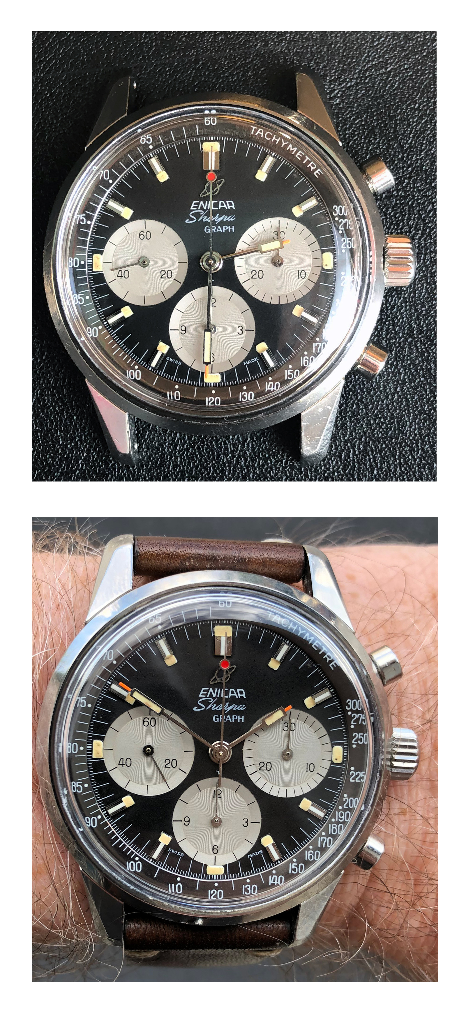

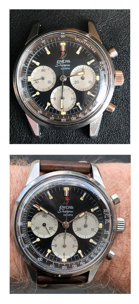

The two watches in question had each been recently serviced by a well know watchmaker. The damage on the second watch happened days after getting it back from service.
I was having a home built and the tradesmen inside had the AC cranked way up high on a warm humid day.
Seals will not always be enough.
If there is air in a watch, there also may be non-condensing humidity in the air inside. If the seals are good, this air may be trapped in the watch.
At some point, conditions may occur which will cause condensation to take place.
I am convinced that this phenomenon explains why, in some cases, we see watches with pristine dials and hands that have rusted.
If I hadn't witnessed it myself twice in a two-week period, I too would be skeptical. The two incidents happened in September of 2020.
One watch was a Gallet MC45 "Snow White with a pristine white dial and blued hands. I was shocked to see it completely fogged up and I was in no place where I could open the watch immediately to dry it out. As it turns out, no obvious harm was done.
The second watch is an Enicar Sherpa Graph with luminous tritium in the central seconds and minutes paddle hands. The hands had just been replaced with pristine NOS hands with perfectly uniform creamy lume. After the incident, a bit of iron oxide from each of the paddles lightly stained the hands.
Before and after, about a week apart:
The top photo was taken just after the watch was returned from service and is the best of three photos I have before the lume was damaged by condensation days later. The upper photo is a bit overexposed. The lower image more accurately reflects the color of the orange tips and creamy lume.
