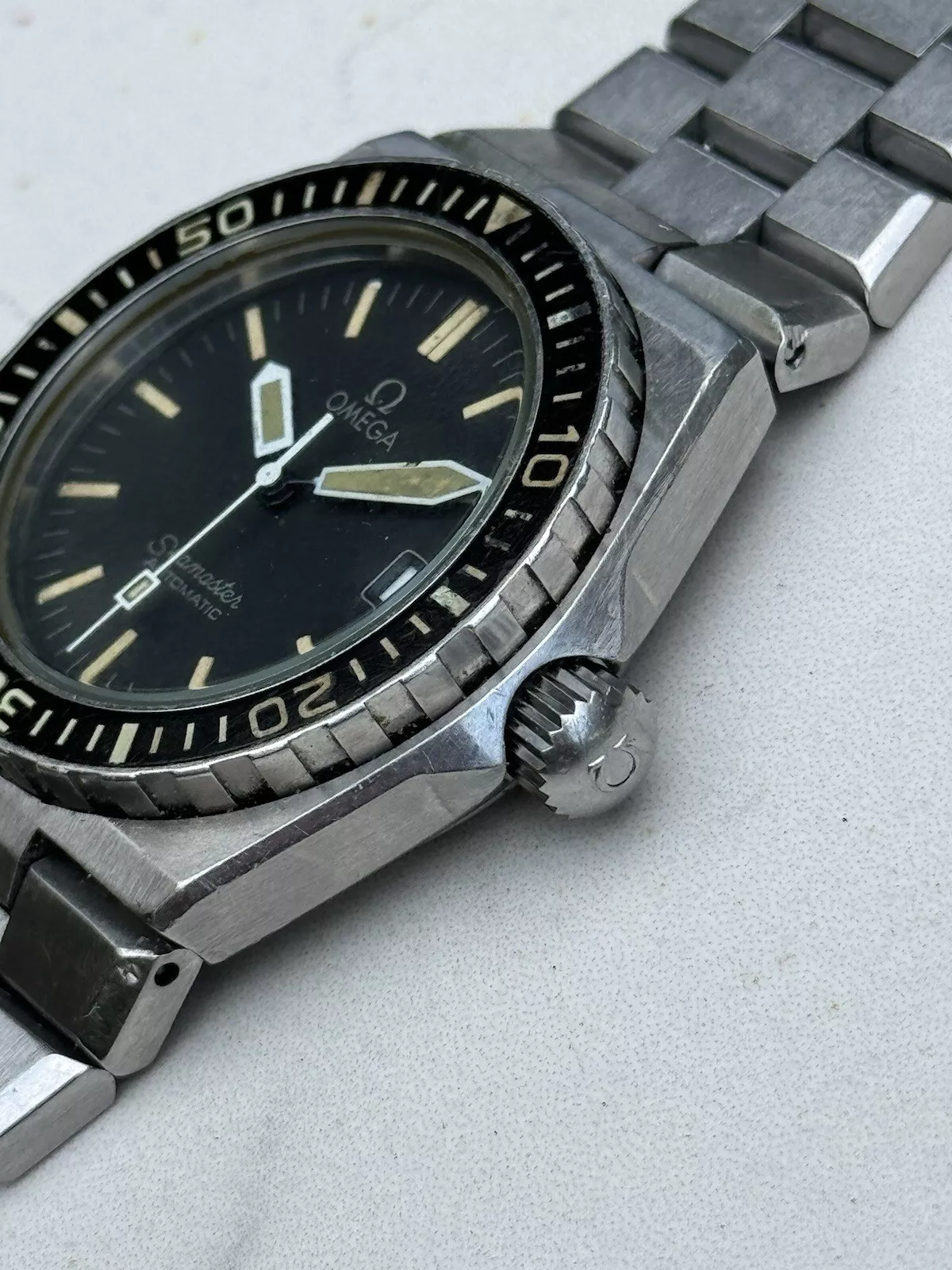

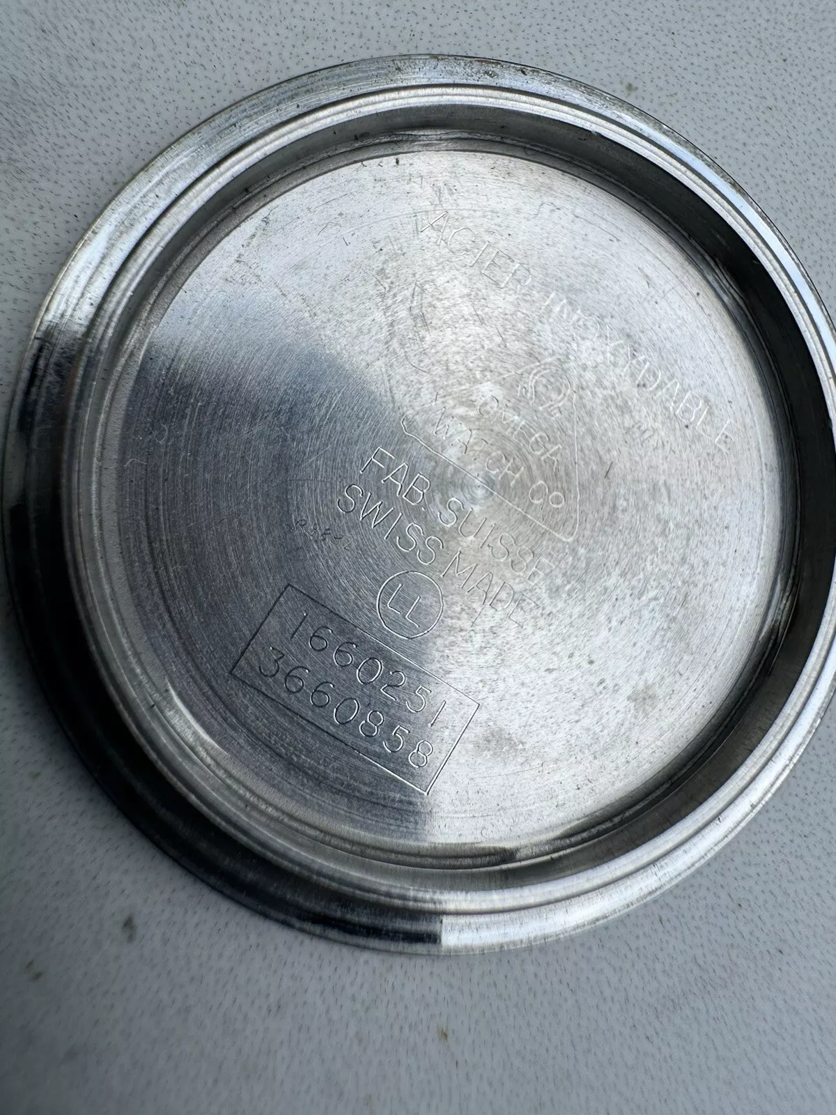

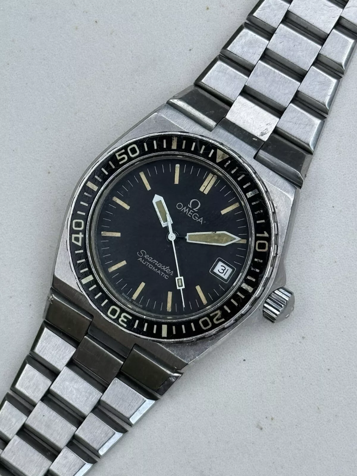

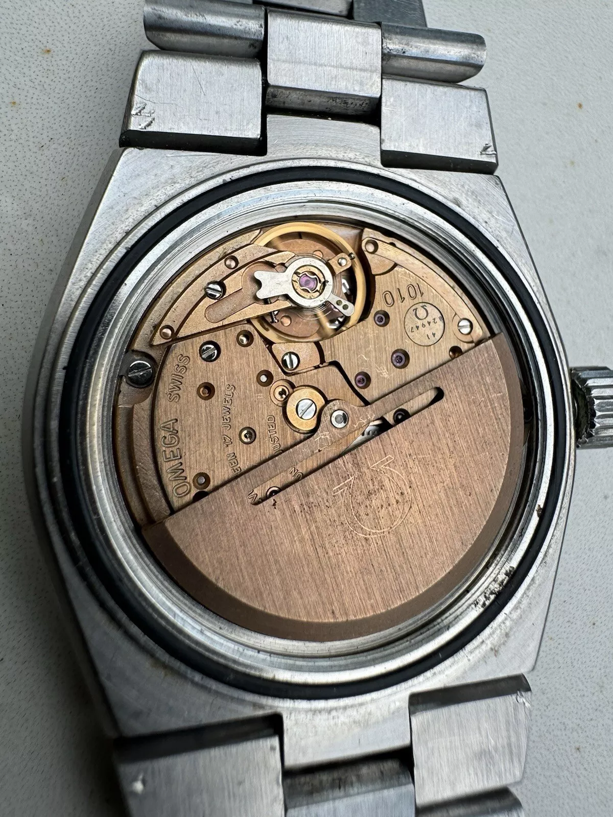

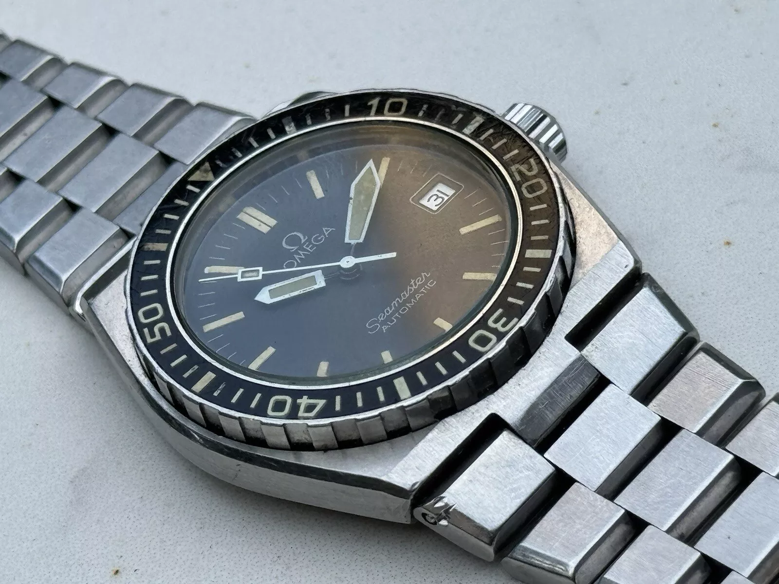

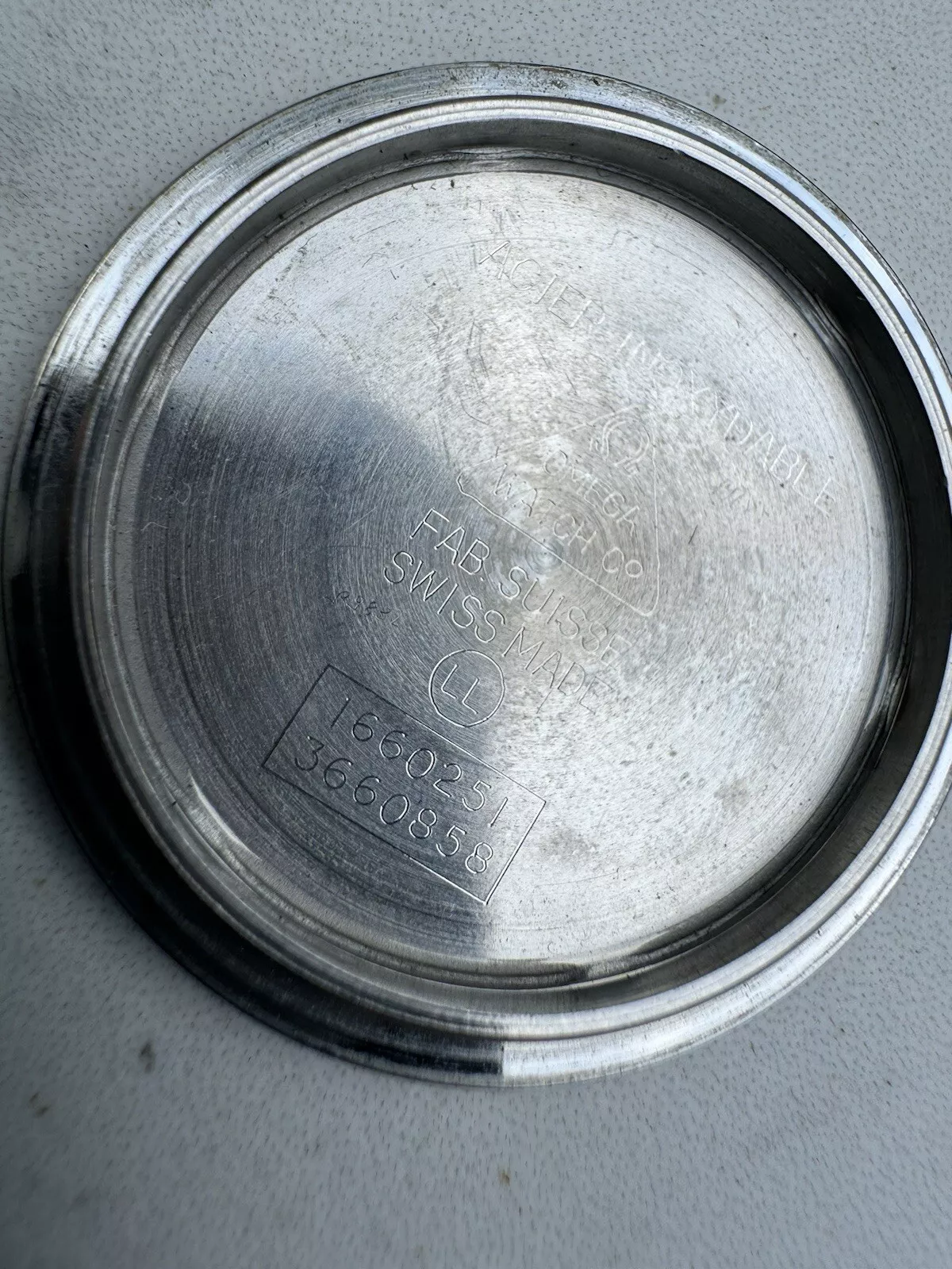

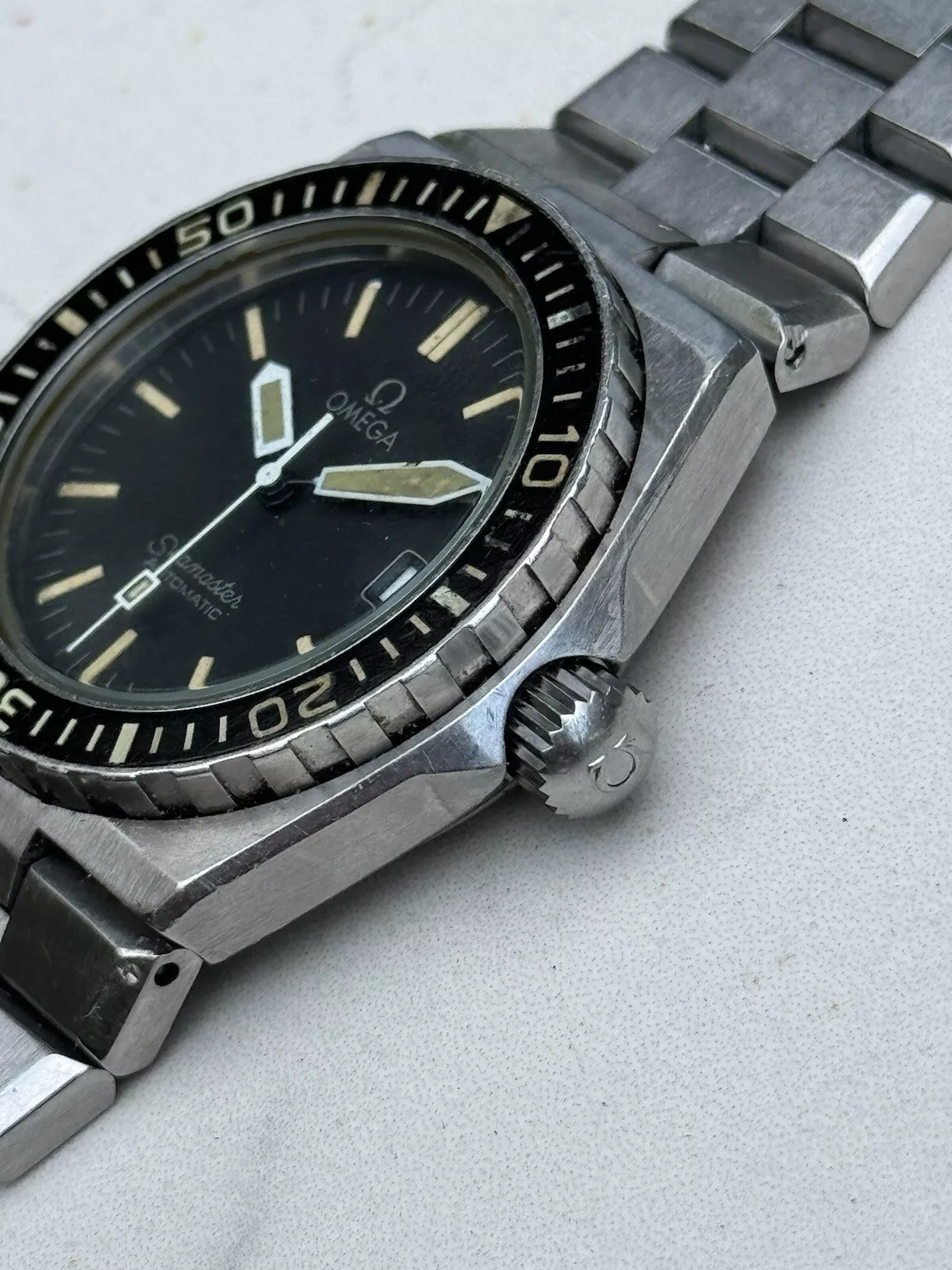

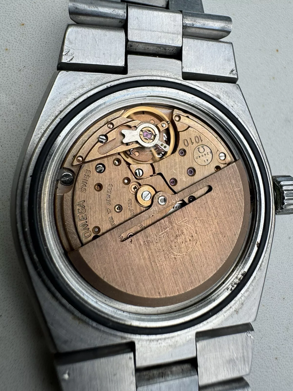

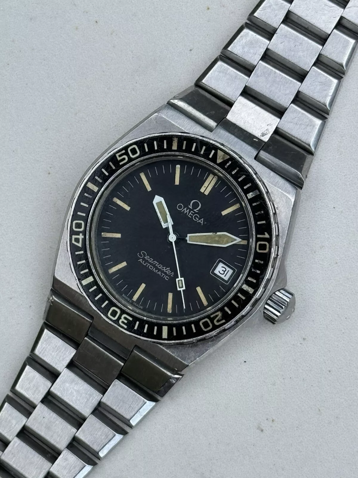

Dear Omega Enthusiasts,
This is my first post, though I’ve been following the forum for many years.
In fact, several of my watches are in my collection thanks to the insights I’ve gained here.
For a long time, I’ve been wanting to buy a "non-baby Ploprof", but as the years go by, the prices keep rising, so I think now is the time to make the leap.
I’ve found one that needs a bit of attention, but I’d appreciate your thoughts on whether everything looks correct.
My concern is mainly with the hands, which I suspect might be service replacements or even fake, though the rest seems genuine to me.
It may not be in perfect condition, but I’m seriously considering purchasing it. Do you think it’s possible to find original hands for it (not the luminova ones)?
I’d greatly appreciate your support and any feedback you may have.
Ciao!
MV

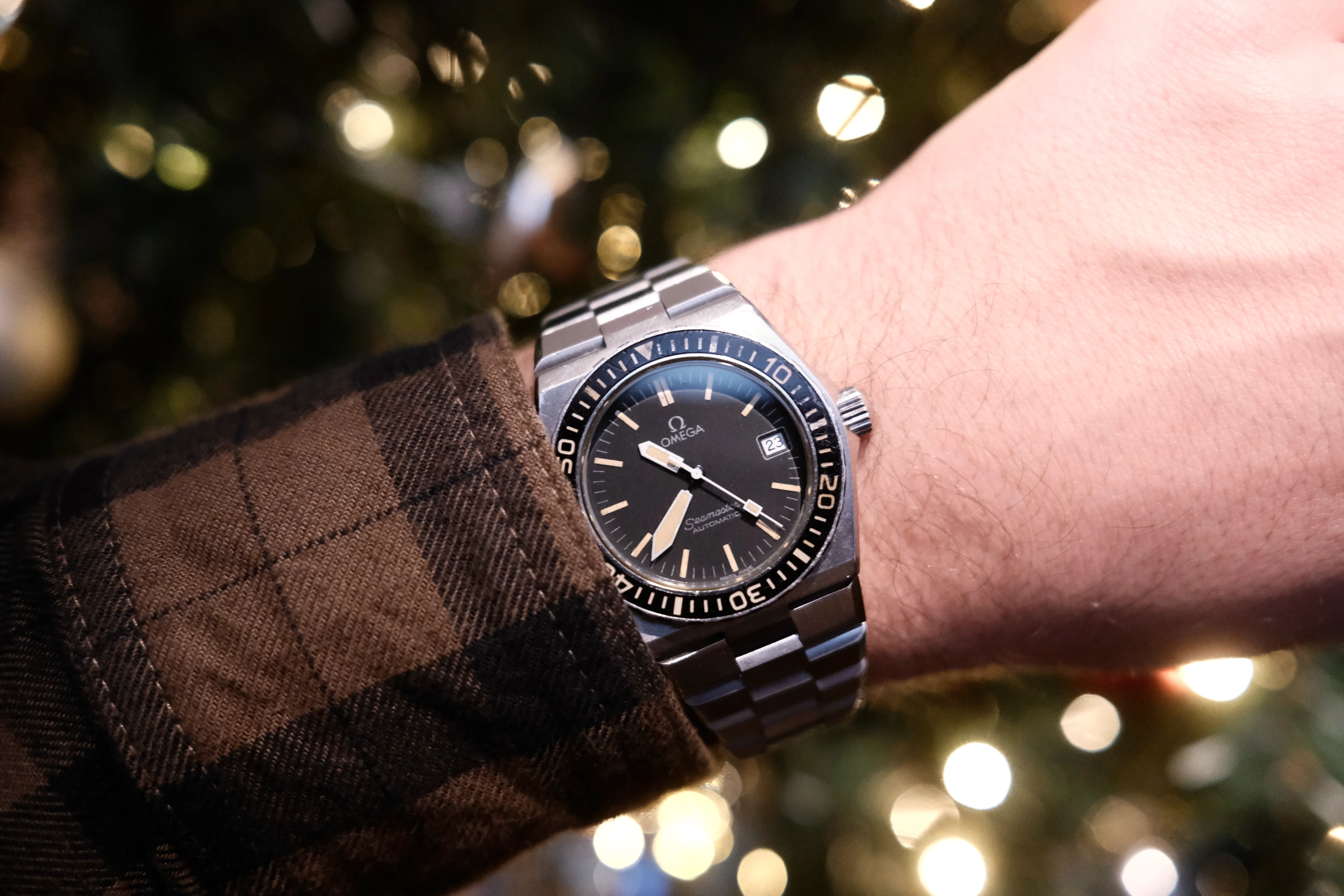

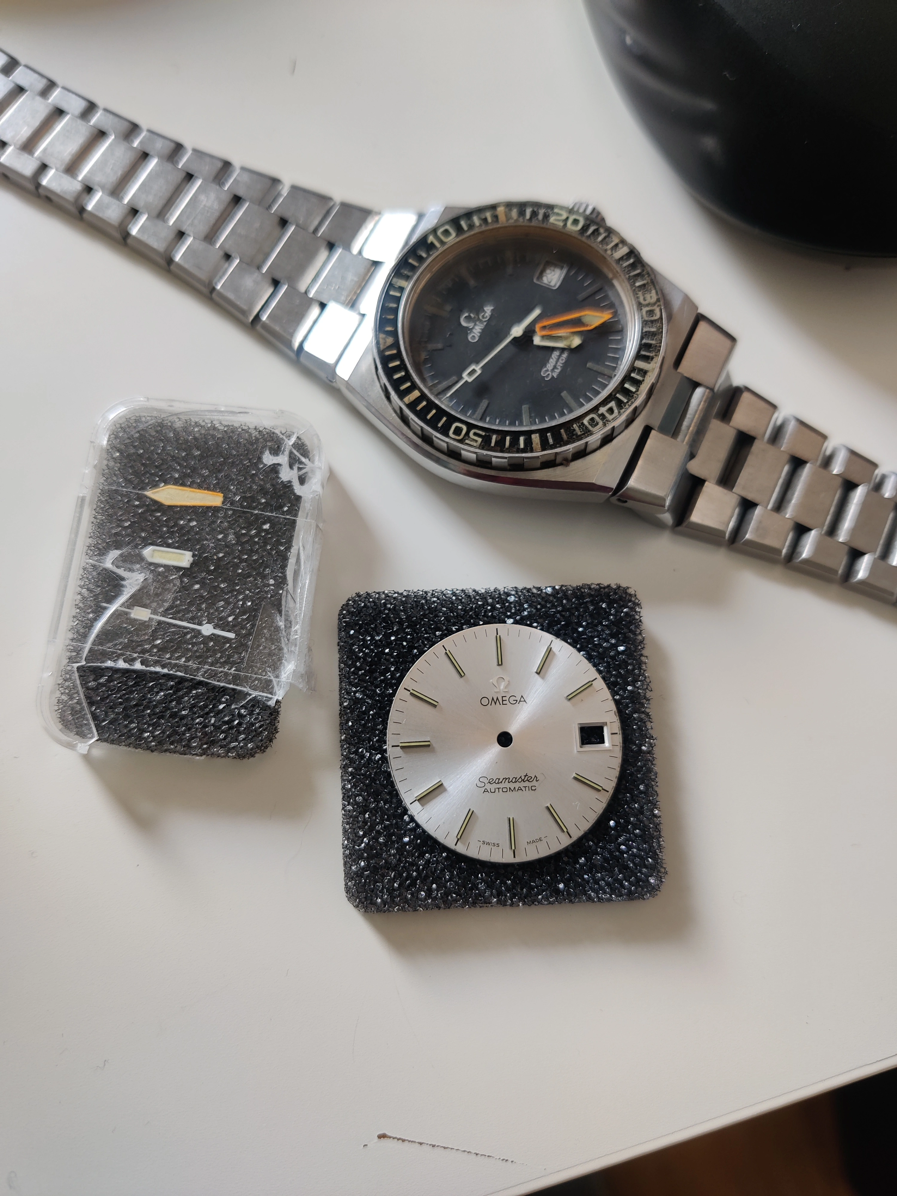

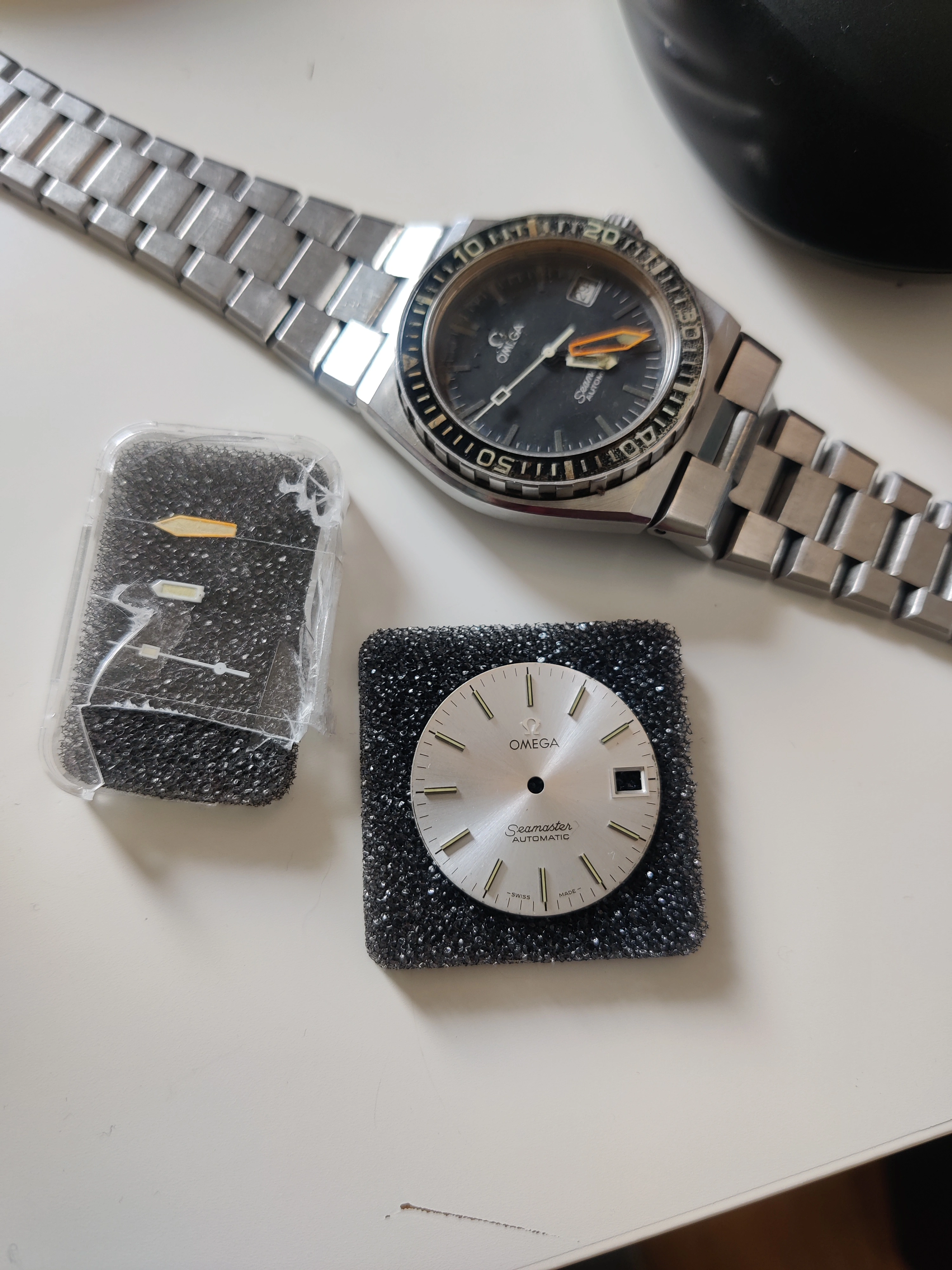

Quick check shows a couple with matching hands, but vast majority are orange minute hand
Production change early on?
The other similar models are 120 and your linked bracelet model using the same hand style, but both mainly orange minute
6
6
Hello Don,
Thanks for your reply.
Yeah I was wondering if the pale/white hands was due discoloration or just white from the factory.
1,121
1,727
Hello, that is a nice example, the minute hand is discoloured in my opinion.
240
293
I can confirm that your hands are original, the minute hands are just discolored.
1st choice you leave everything like that it's not surprising.
2nd choice you just relight with tritium so that they are happier.
3rd choice you buy luminova replacement hands, not nice
4th choice you buy new luminova hands but you have them re-lighted with tritium.
5th choice you are looking for vintage tritium hands in NOS or USED, it can be found but the budget is quite high and you will have to wait a long time.
