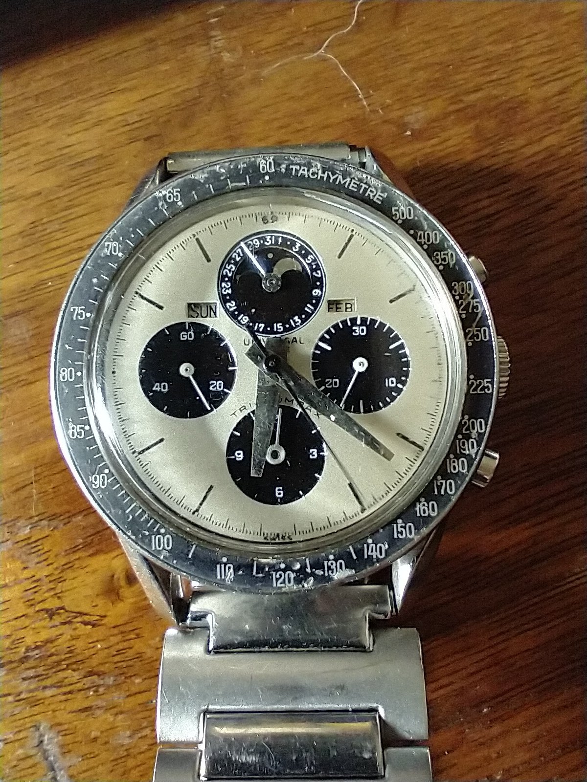

Hi everyone. I am not a watch collector. I received my father's Tri-Compax watch after he passed away in 2015. I have kept it in my drawer and have just recently decided to start wearing it. I cannot seem to find any information online on how to set the month, day, date and moon phase. I am assuming that they are set with the small 'button's" that are located on the left-hand side of the watch. Does anyone have any literature that I can reference or can easily explain how to set them, so they are accurate? I love the watch and think it is a beautiful piece. Any help or advice is appreciated.

My suggestions are first to ignore the instruction of turning the hands back to eight o'clock. This may harm the movement and also risks an expensive service. For such watches allways turn forward. Second, push the pushers p1, p3 and p4 only when the time is set to approximately 6 o'clock to ensure that the normal setting mechanism of the watch is not in progress. Otherwise, again an expensive service may be needed.
Enjoy your Tri!
