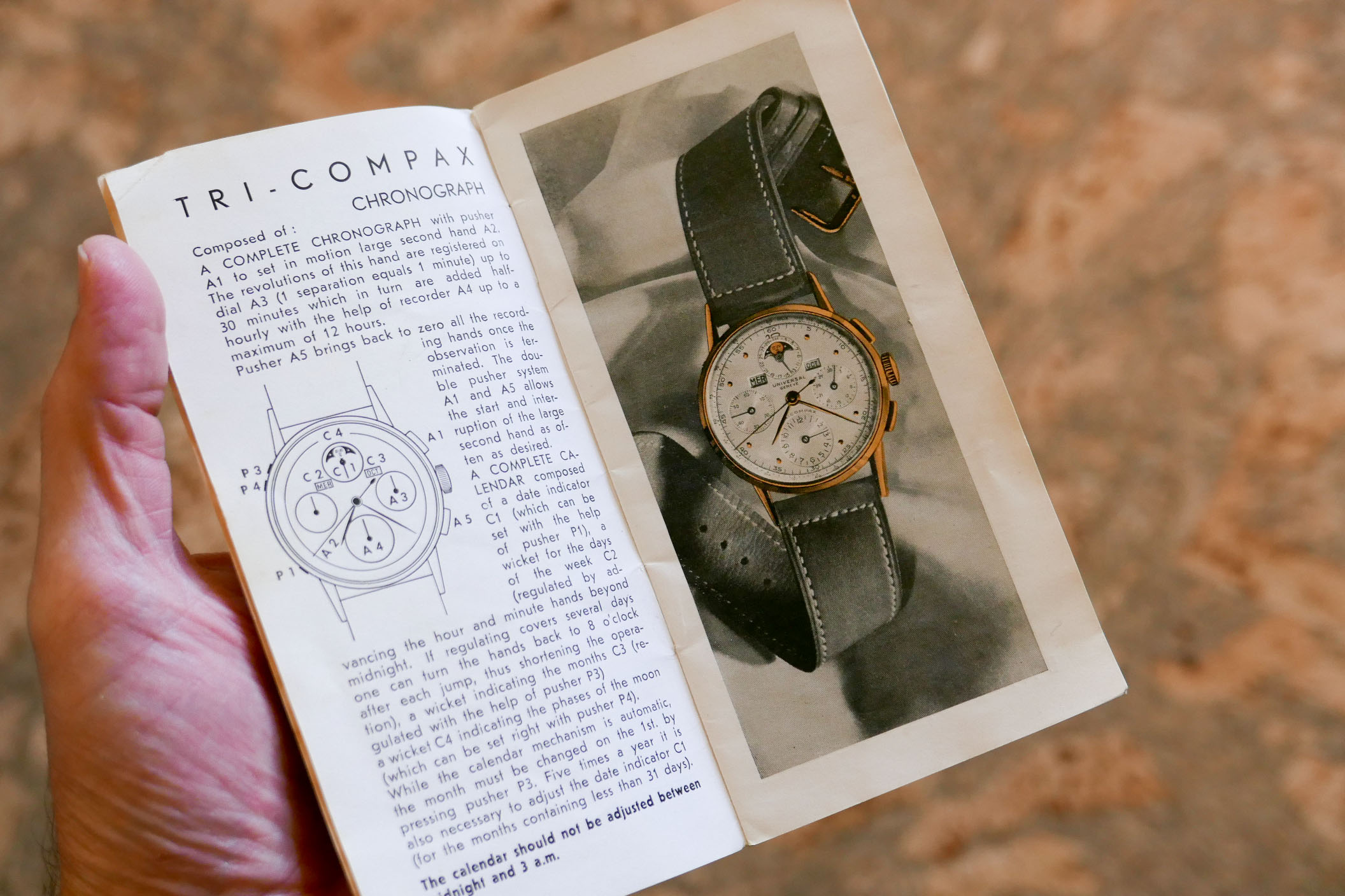

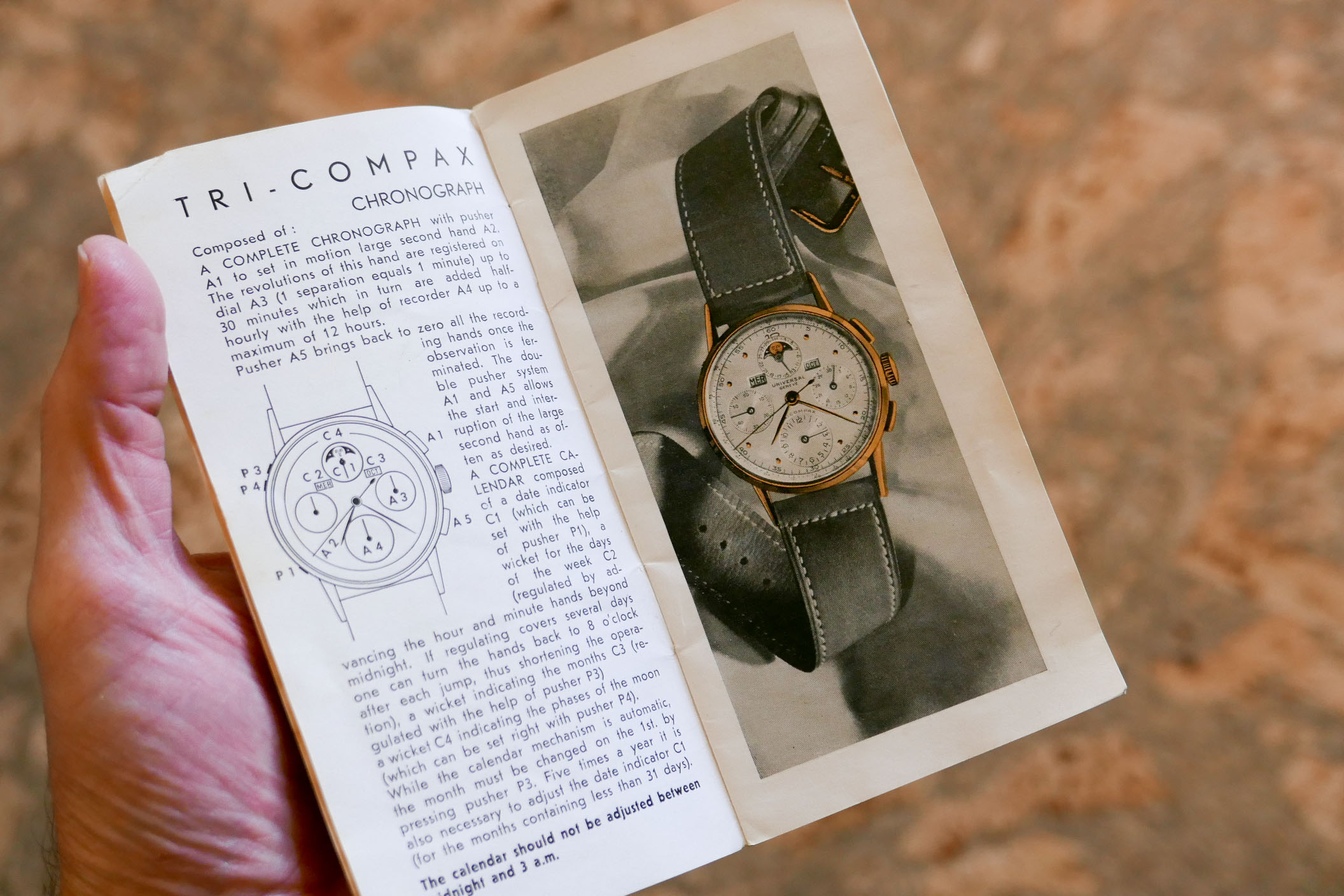

I haven’t seen an easy to follow explanation of this procedure anywhere on the webs, I believe it applies to all Tri-Compax references. Get your toothpicks ready…
1. Advance hands using crown until the day of the week is set / set the time to 4AM to avoid damaging the movement during the following adjustments.
2. Set the date using the pusher at 8:00
3. Set the month using the pusher at 10:15
4. Set the moon phase using the pusher at 9:15
5. Set the time using the crown
