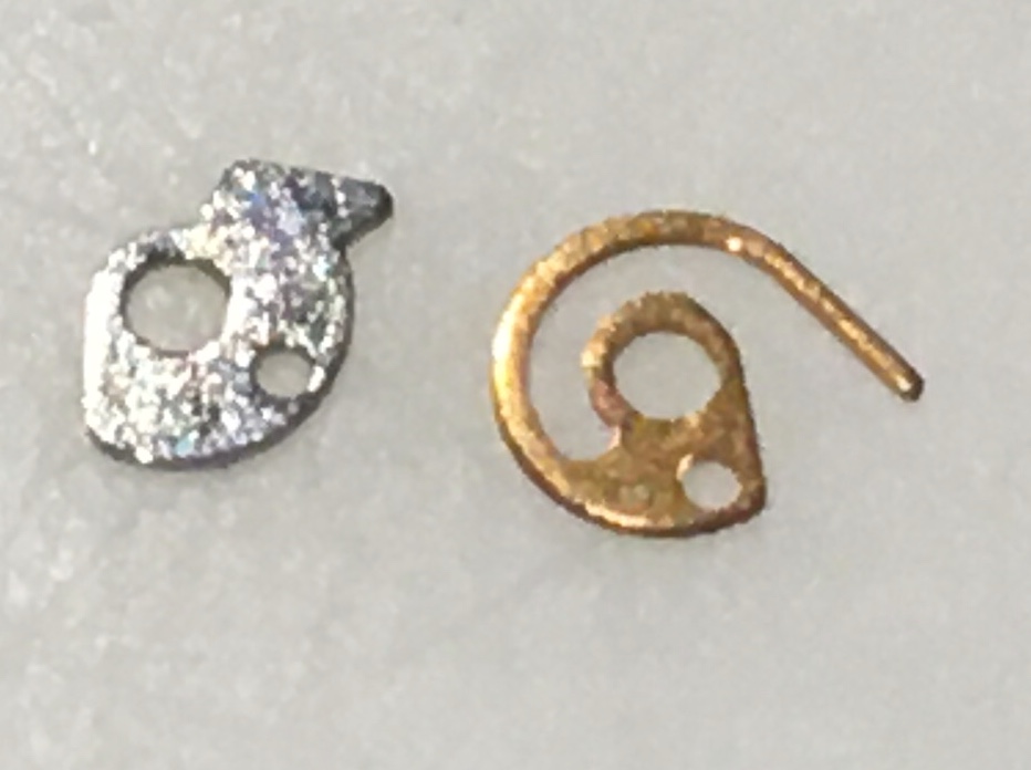

The quick set not working is probably the fault of the part on the left, the improved part is on the right which works much better.
I would need a case number to say which crown you need.
Cheers, Michael

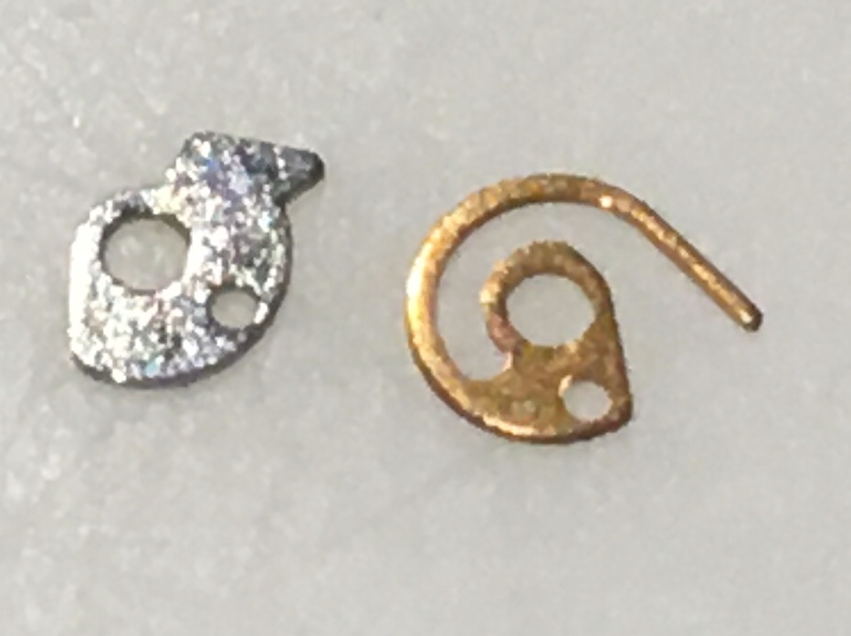

In case it's useful to anyone - I had this issue with my 751 and managed to fix it myself as a "tinkerer" (i.e. by no means a watchmaker).
Quickset suddently stopped working. To access the mechanism you need to take the dial off and remove the day wheel, then remove the plate underneath together with the date wheel. The part that breaks is on the underside of that:
I bought the part from here: https://urdelar.se/products/omega-563-1530-date-corrector-generic
A satisfying fix for me as a novice, the tricky part was putting the plate back on with the hole in the date corrector aligned with the appropriate knob in the keyless works, and making sure the day and date change were synchronised. Remember when testing it without the hands fitted that the crown winds backwards to move the hands forwards!
